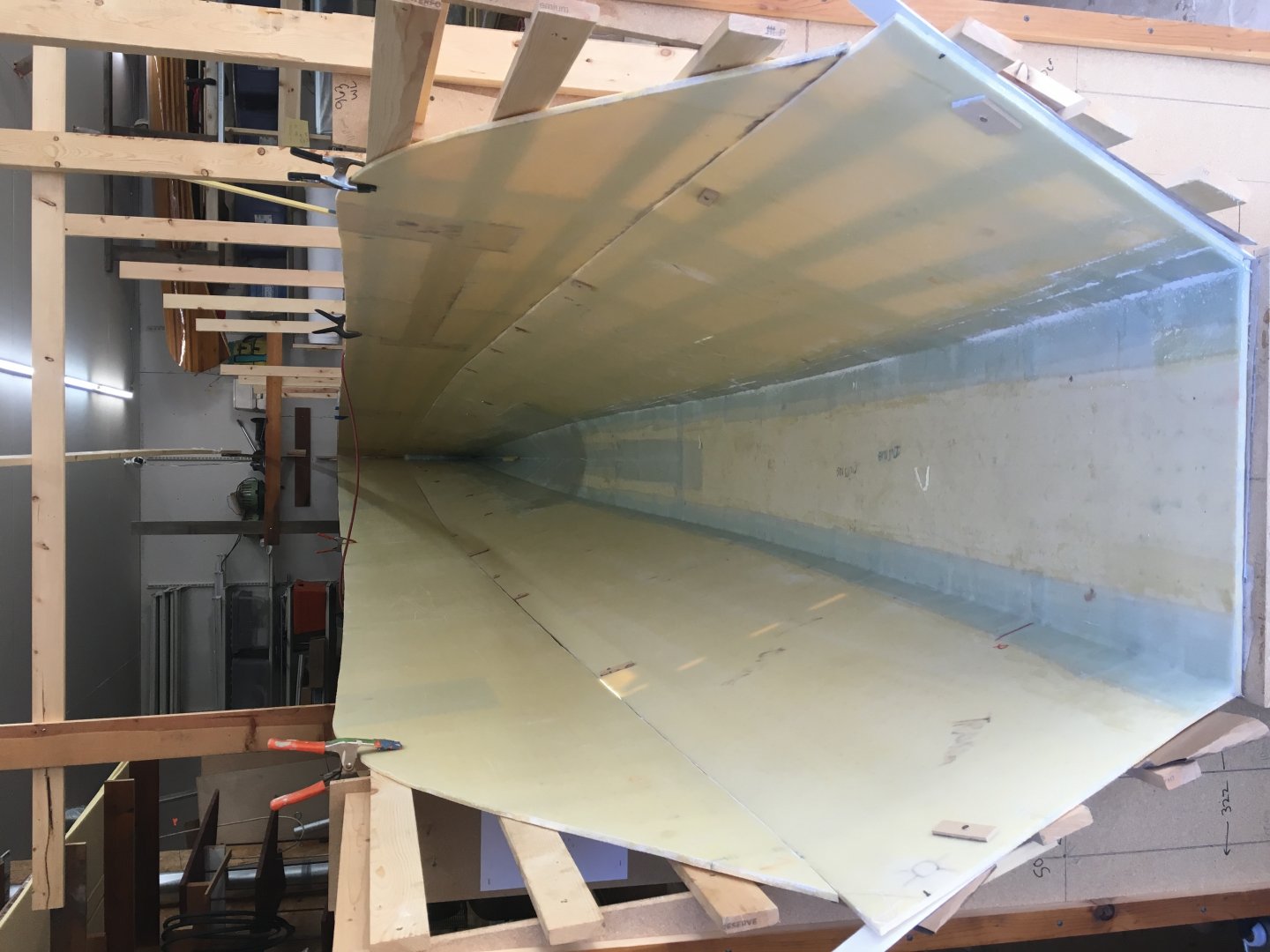

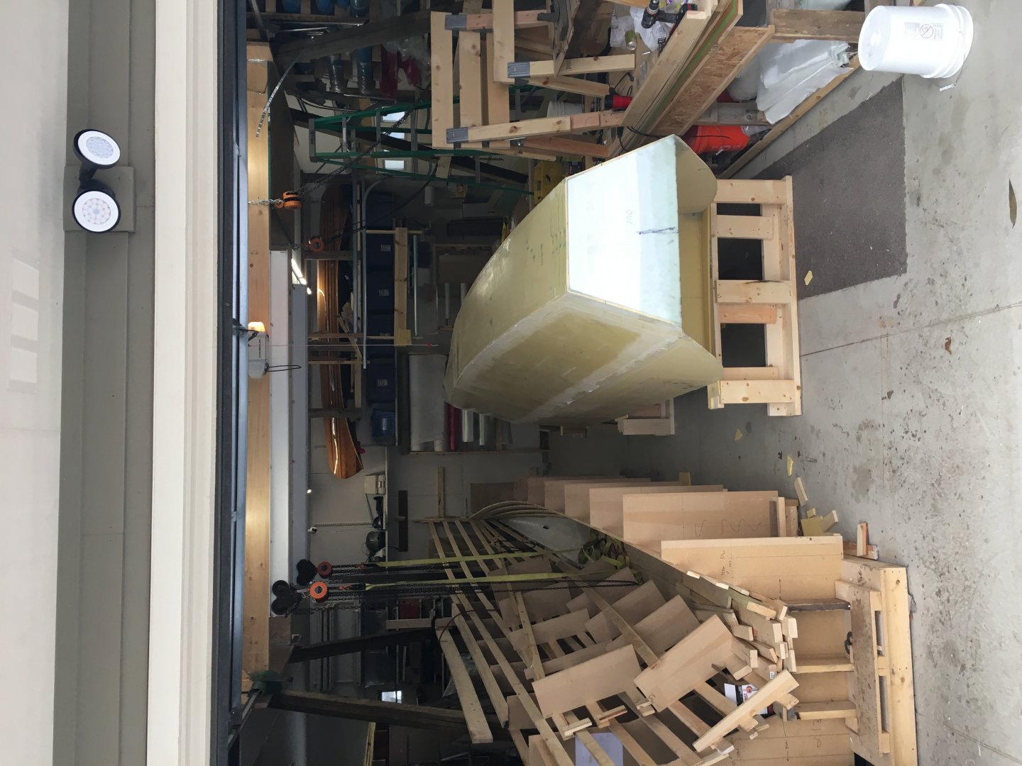

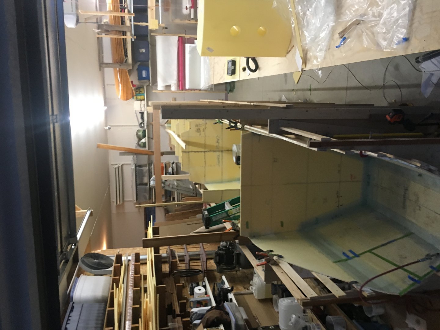

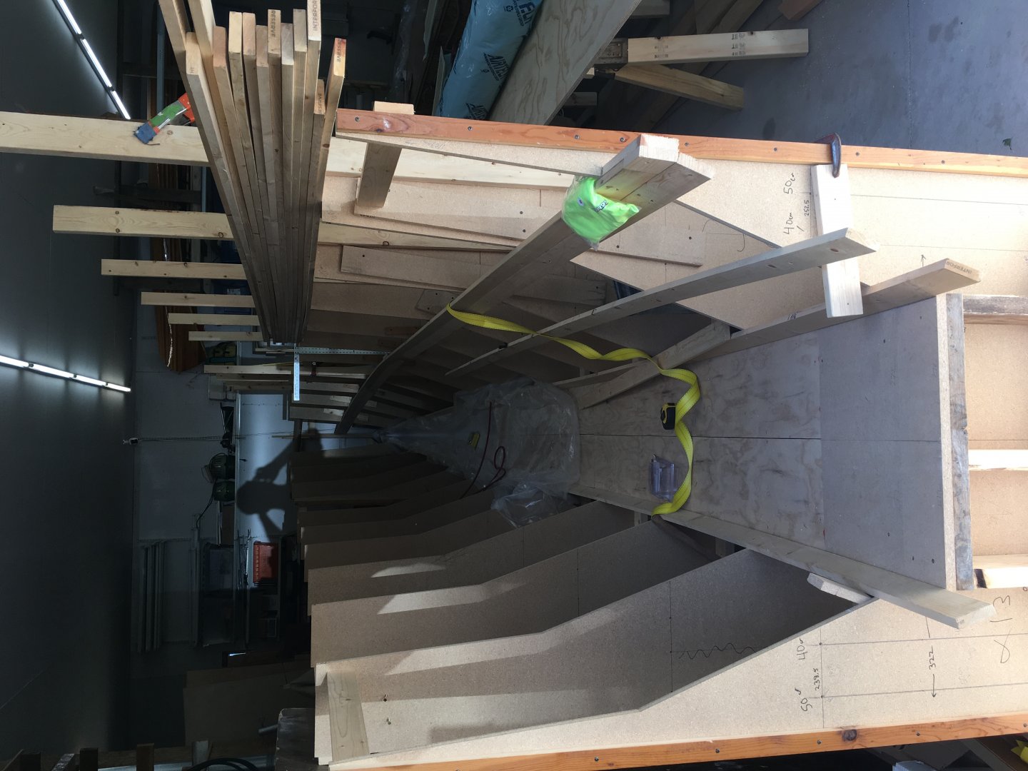

    F8AB6060-9466-41AE-AD8C-338ADCE5D80A.jpeg 57E488B0-66BD-402D-91C8-89B9EEF253A2.jpeg 43F3CC5F-84F2-463D-8C36-9CDA67294657.jpeg C4D682BC-AD90-4EC9-9E49-52665DCA1E94.jpeg 53A4C314-B574-4CA4-842C-F6FB081A269C.jpeg Here is a female jig in various stages and a vac table. The hull is lifted with a gantry as there are no pick points or places for humans and the size at 32’ is too heavy for safe man lift. This space is 24’ wide by 36’ long for 32’ cat. Only one hull at a time can be built with this space and method. The first hull is outside under cover. In order to facilitate this build; it takes several people to vac bag a large panel and two people to move them into the jig. You could use other methods, but the cost of one of the four main hull panels (8 needed) is about $600 for core and about $400 for glass and epoxy and consumables and &400 labor.
    You would be better off building in plywood if you want a cheaper boat that is easy to build. With plywood; you can build the boat and handglass it. The method I am using is 3000 man hours.
