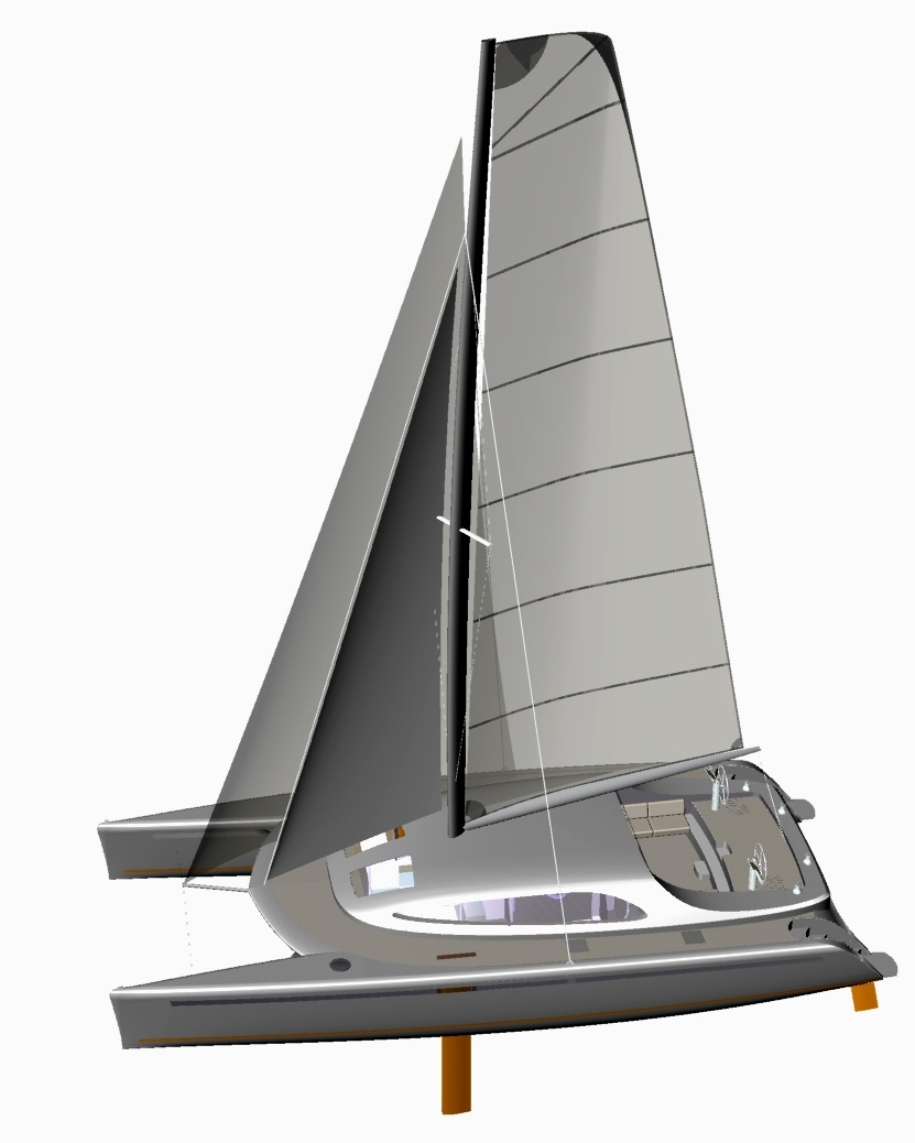

    Good morning all,
    A self tacking jib seems to be a good idea for the 60 foot catamaran I am building - especially because I'll be really ancient by the time it's finished.
    I'm doing everything possible to minimise upwind air resistance. Here are some of ideas I've been considering:
    1. The jib needs to overlap the wing mast a little bit, so the track should arc around the front of the mast and end a bit behind the mast
    2. The sheet should not go up the wing mast because it will disturb the flow through the slot between jib and main and possibly cause trouble with rotation
    3. Why does curvature at middle of the jib track matter, the sail will be fluttering as it goes across
    4. Can the jib sheet tension be eliminated? Maybe a jam cleat on the traveller which can be tripped from the cockpit. That way there will be less load on the traveller
    5. When tacking, the jib needs to "back" for a few seconds then fling across. So I'm thinking the traveller should have a latching system which releases when the back wind load changes the direction of the sheet to the clew.
    6. The traveller assembly will be made of carbon/epoxy, the bearings will be lots of little nylon wheels, the track will be laminated too with the inner
    bearing surfaces moulded over something smooth like aluminium extrusion.
    I would be very grateful for your opinions and experiences with self tacking systems. And by the way here is a picture of the Rhino rendered design to put things into perpective.
    Thanks
    Michael

    Why do you require the jib to overlap? It complicates the system enormously. So does the requirement of an automatic jib backing mechanism. It would have to self adjust for windspeed and other sailing conditions. A traditional jib boom can't be beat for simplicity and efficiency.

    I see the value of the slight overlap -it does wonders for sail interaction aerodynamics- but I think you are overestimating the aerodynamic interference by the sheet to the mast. I agree that the middle of the track could bump forward inboard of useful sheeting angles as long as it is back on the arc for sheeting.
    About your sheet concerns/desires, I have always wondered about not fixing the track to the boat. I always want a method to tune the tension vs position and it seems possible if the track is not fixed. I will give it more thought but I think the paradox is that it would be for sailors demanding optimal shape but too lazy to tack a jib -the null set.

    Funny, but not necessarily the case. Ones concerns depend on the circumstances. Tacking up a narrow channel with heavy traffic, selftacking is more than nice. Sailing off shore on one tack for a week, sailshape matters. But you can tweak things off shore with improvised sticks and string and bubblegum. Then clear it all away to regain selftacking. Integrated controls for tacking are available, such as coordinated sheet release and power furling.
    But I agree with Gonzo - the first thing you do when wanting to self tack is add a boom (or a long club). It solves the power problem. You have to keep both the leach and the foot tight, and there really isn't any other good way to keep the foot tight during self tacking.

    Thanks for the collective advice.
    Seems like it's a boom then, for simplicity, reliability and control of sail shape.
    Still need a track I suppose, probably about two thirds along the boom.
    Maybe the jib could have a stiffened or battened flap extending a bit past the clew so it could scrape across the mast and give a bit of overlap.
    Maybe since we now have a boom, we could eliminate roller furling around the forestay and roll the jib around the boom instead. Come to think of it, this means we could now use battens to extend the sail past the clew.
