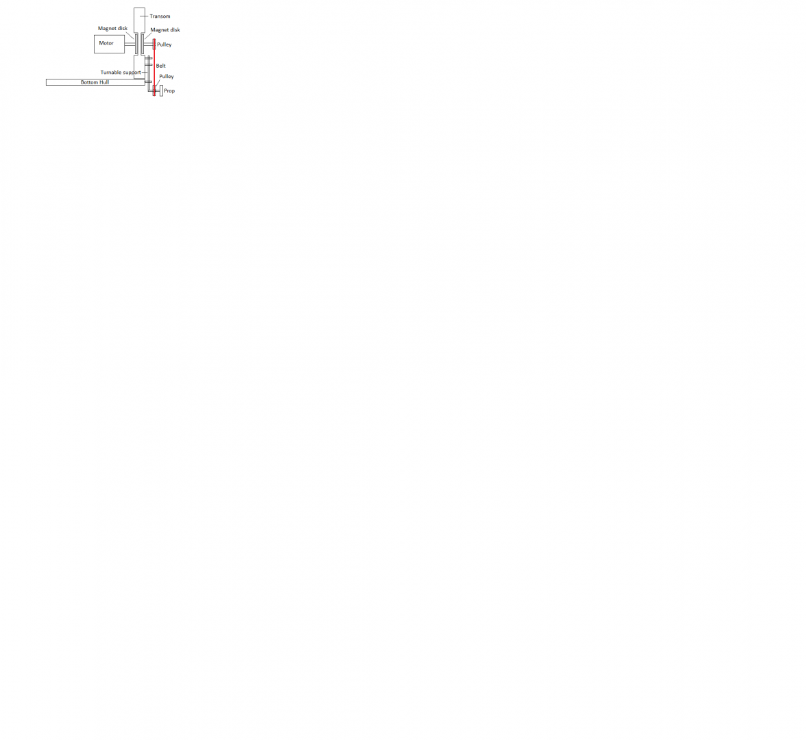

    I've been attempting to evaluate the use of solar charging on my electric/rowing skiff to make it independent of shore supply. The pictures show my setup in the garden. There were a few problems to overcome:
    Programming the MPPT correctly
    Finding that, once the 24v 110Ah battery was fully charged, I could no longer measure electric power generated from PV!
    Using the motor as a load in air caused the motor to get rather hot - 81 deg. C measured after two hours, which could have been resistive heating but also direct solar heating of the stainless steel can covering the motor.
    A dummy load in a bucket of water solved the motor heating problem.
    P.S. If you click on a picture you get a short description and a full size picture (no description for first picture).

    You're not going to see much return on your investment on that MPPT with only one solar panel.
  3. alan craig
    Joined: Jul 2012
    Posts: 395
    Likes: 135, Points: 53, Legacy Rep: 14
    Location: s.e. england
    alan craig Senior Member
    The panel itself is used, 260W peak and only £99. Briefly, the most power I saw was 150W and the most daily energy was about 500Wh. I am optimistically hoping for 1000Wh per day on a sunny river less shaded than my garden. The 10A 12/24v MPPT and programmer/display were about £90.
