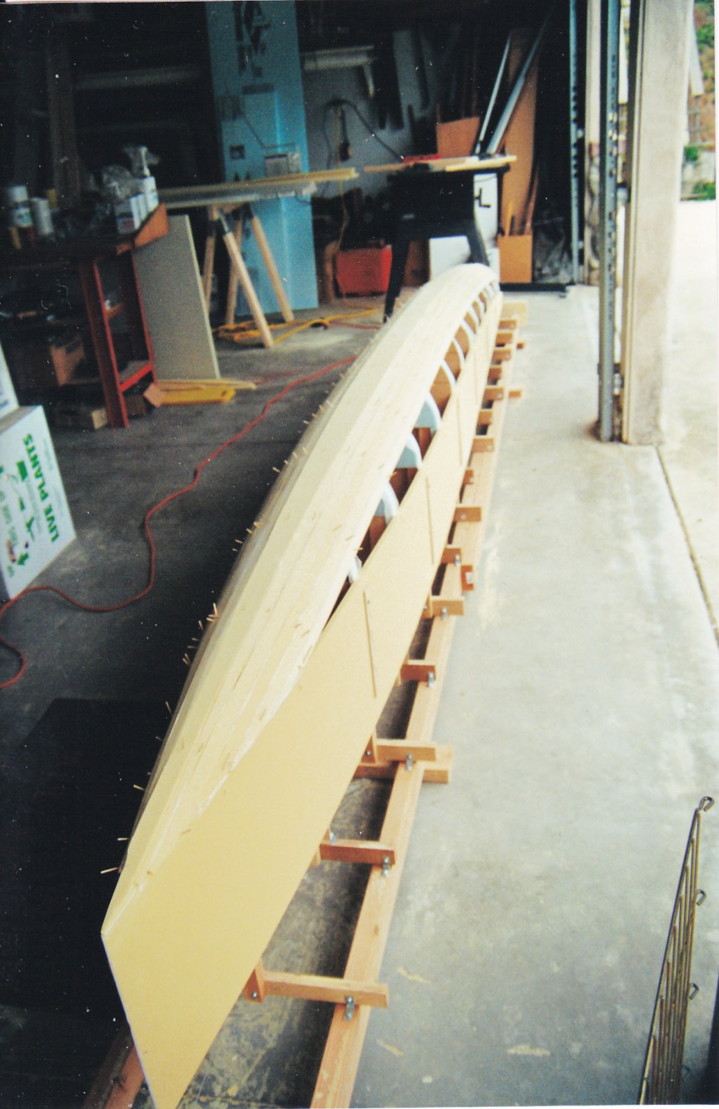

    I built the main hull of my 15' trimaran (Broomstick) this way.
    The shape had compound curvature over less than half the surface, but the fairing still took a lot of time. It would have taken even more, except I was unwilling to add more weight in filler.
    My original plan was to build all three hulls this way, but after finishing the main hull, I opted for a simpler ama shape allowing stitch & glue plywood construction.
