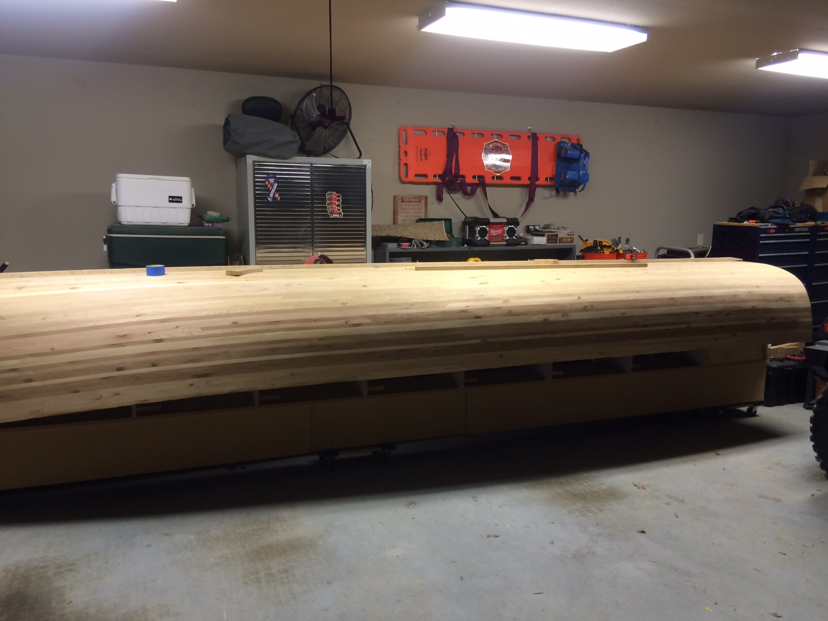

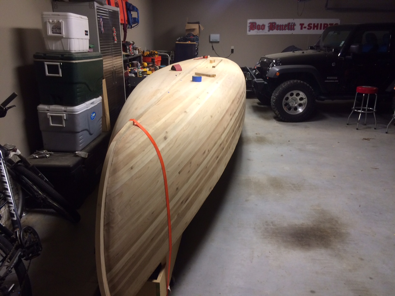

    I'm building a freighter canoe with the following dimensions (my first build)
    LENGTH-20ft.
    TRANSOM BEAM-43"
    BEAM-53"
    DEPTH AFT-20"
    DEPTH FORWARD-32"
    I'm ready to fiberglass the outside but not sure how many layers to use. Right now I'm thinking 10oz and putting one 50" wide piece down the middle, and then laying a piece from each side to overlap on the bottom. That way the very bottom will have 3 layers, some of the sides will have two layers, and at the top of sides only one layer.
    I plan to finish the boat clear and want to see the Cedar that I have spent so much time on. The canoe will have an outboard and be trailered so weight isn't an issue unless it gets so heavy it cuts down on what I can carry with me in the boat.
    Strength is what I am looking for. I want to carry lot's of gear a long way on river trips.
    I plan on installing a 51 gallon fuel tank. I hesitate to mention that because I'm sure it sounds ridiculous. As I said, I plan on carrying a lot of weight a long way.
    You Tube has brought me along very well on the build and shows technique for fiber-glassing, but I haven't found anything specific on how many layers to use.
    Any guidance will be appreciated.

    What is the construction?
  4. Lost Caddo
    Joined: Apr 2016
    Posts: 7
    Likes: 3, Points: 3, Legacy Rep: 49
    Location: Louisiana
    Lost Caddo Junior Member
    No freight. No cargo.
    The weight I am talking about is primarily fuel. My goal is 450 miles between fuel stops. The fuel tank I chose is 51 gals. and the dimensions (long and skinny) were chosen to distribute the weight. There will also be a 6 gallon reserve tank, some light camping gear and food/water for a couple days at a time.
    I agree the Hudson Bay was a great design but they are a little hard to come by, especially in Louisiana. I purchased a design from one of the members of this forum and I like it better each time I look at it.
    As far as loading it carefully, even my wife says I'm pretty careful when I do stupid stuff.
    I have attached pictures of my build.

    DCockey,
    Sorry I didn't include the construction info. I can see that it would be hard to make a helpful recommendation without that information.
    Strip built Western Red Cedar 1/2" thick x 3/4" wide.

    We have danced around the original question about sheathing. I'd think maybe two layers of 10 ounce glass/epoxy on the outside and one on the inside. Some of the other guys may suggest differently.

    The 0.6 sounds more realistic for a smaller outboard like the 25 horsepower 4 stroke, but you should be pretty much in the sweet spot at 15 mph. Depending on how well the 1/2" cedar went together I think anything more than the first layer of 10oz is insurance for your investment, but probably worth doing. Enjoy your travels.

    For a 25 hp and 15 knots, I'd go with 20oz skin of the bottom. I added a second layer of 10 oz to a boat with one layer on it when I upped it from a 5 hp kicker to a 25 hp. It helped quite a bit. That hull was 7mm okume and the boat ran about 18 knots. For the inside, I'd be tempted to go with a polyester fabric for maximum abrasion resistance and a bit more damage tolerance, at least on the tread areas. Ten oz glass completely filled with epoxy is plenty heavy for the interior and exterior topsides. I'd add a rub rail and sheer cap after glassing to absorb bangs and the worst of the UV. You don't want a glass-wrapped edge on the cap exposed to years of sun.

    With 10 oz. cloth, you will start to see the weave of the cloth, but it's not that noticeable. Your cedar will look nice with the bright finish. On the bottom, I feel a double layer of 10 oz will start to hide the wood so painted finishes in those areas would make more sense. Varnish doesn't like extended periods of immersion and so again more durable painted finishes are the logical choice on the bottom, inside and out. Maybe even some kind of non-skid surface on the bottom inside.
