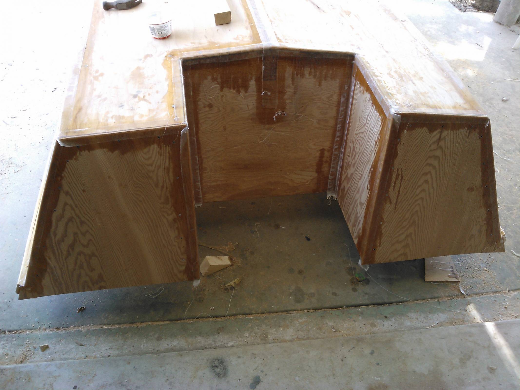

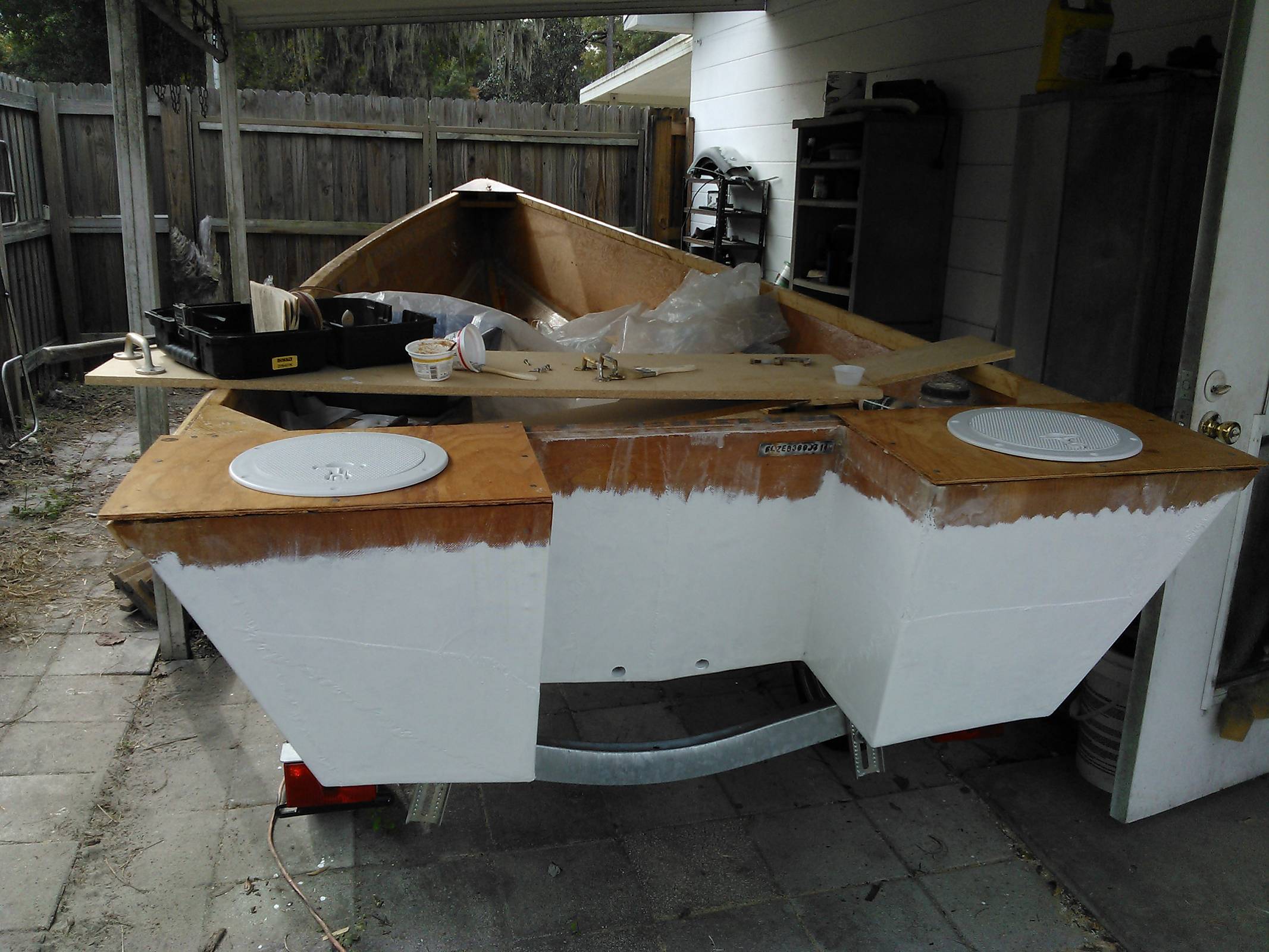

  7. hoytedow
    Joined: Sep 2009
    Posts: 5,769
    Location: The Land of Lost Content
    Here we call those pods squat boxes. Here is an example of how I built mine. I did put them a little too close to the motor so it bumps on sharp turns. Make sure to space them properly. Someday I will fix that with a little grinding work.
    https://www.youtube.com/watch?v=_BgLVS9CCCc
    Aluminum is outside of my skill set.
