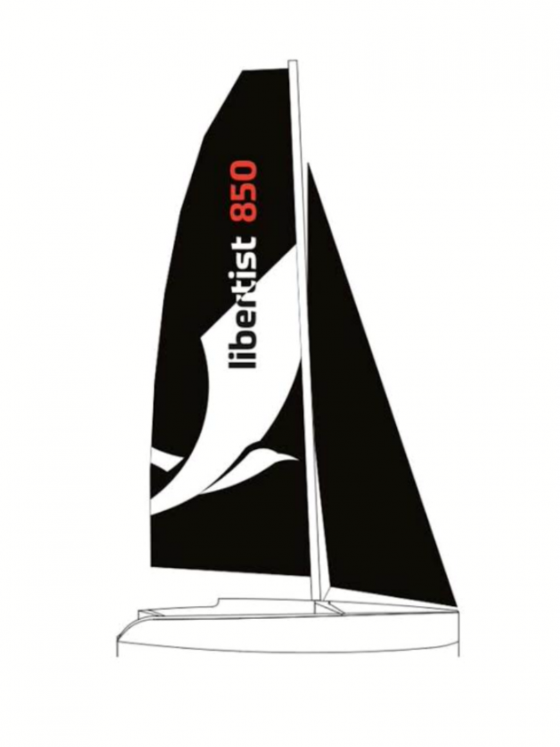

    Hi Guys,
    New here - Good Day!
    We are building new tri - Libertist 850 - Erik Lerouge bigger P26.
    Feel free to comment.

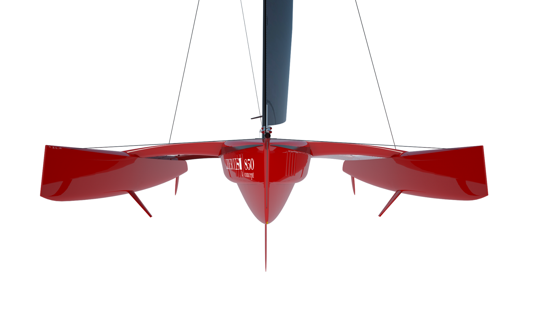

    Floats

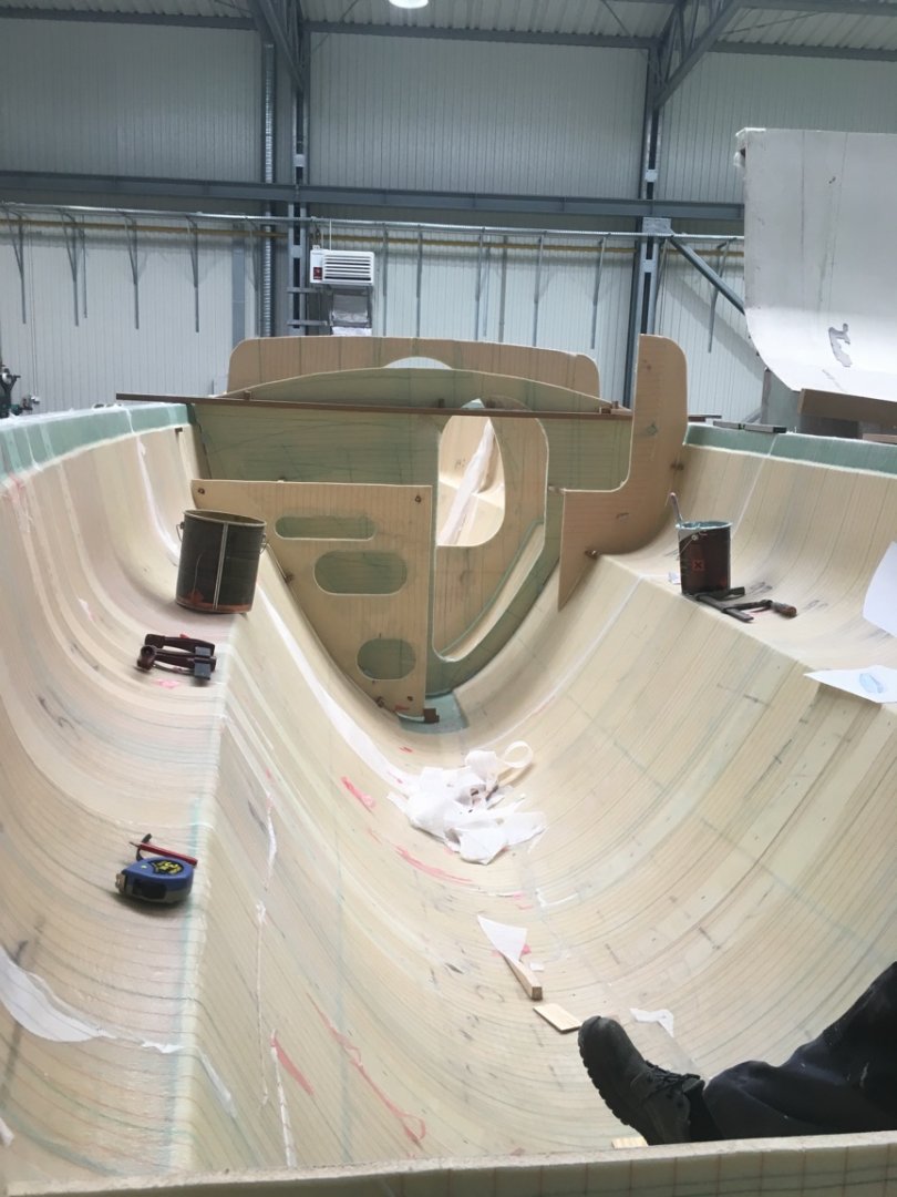

    Main hull

  4. Doug Lord
    Posts: 16,678
    Location: Cocoa, Florida
    Doug Lord Flight Ready
    Looks good! Are the ama foils retractable?
  5. Libertist
    Joined: May 2017
    Posts: 15
    Likes: 6, Points: 3
    Location: Poland
    Libertist Junior Member
    Thank you :))
    No. Fixed one. Easier simpler KISS

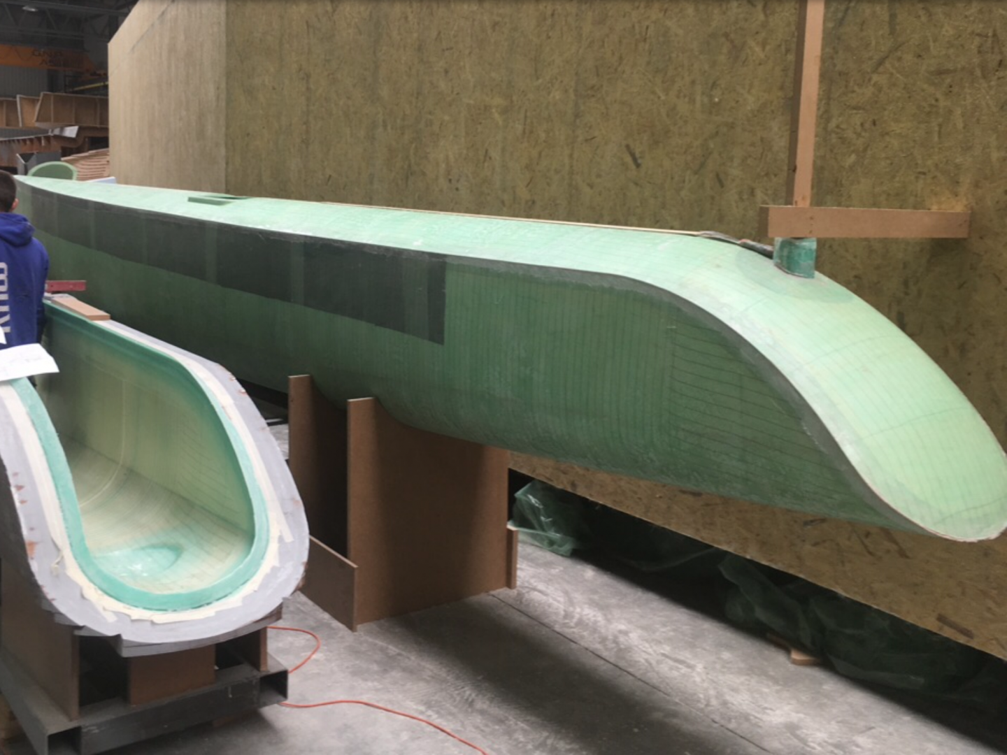

  6. Corley
    Joined: Oct 2009
    Posts: 3,770
    Corley epoxy coated
    Looks great Libertist, do you have a target displacement for the boat? Will it run a bigger rig than the P26?
  7. Libertist
    Joined: May 2017
    Posts: 15
    Likes: 6, Points: 3
    Location: Poland
    Thank you very much.
    Design one is 1400 kg and we aim for this. (Payload 700 kg)
    The main sail is 40 square meters, jib 19 and spi 78.
    But we are going to develope and research 6 additional, optional sails for her.
    Mast is 13,6 and 4 sq.meters.
  8. Corley
    Joined: Oct 2009
    Posts: 3,770
    Corley epoxy coated
    Sounds great, good luck with your project. I'm guessing it's strip foam/glass build from the photos? Is it going to be demountable for trailering?
  9. Libertist
    Joined: May 2017
    Posts: 15
    Likes: 6, Points: 3
    Location: Poland
    Female mould. Epoxy. Carbon beams.
    Demountable.

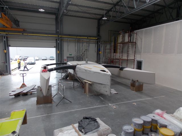

  10. Libertist
    Joined: May 2017
    Posts: 15
    Likes: 6, Points: 3
    Location: Poland
    Tadam :DDD
  11. Libertist
    Joined: May 2017
    Posts: 15
    Likes: 6, Points: 3
    Location: Poland
    The beast is born;))

  14. Libertist
    Joined: May 2017
    Posts: 15
    Likes: 6, Points: 3
    Location: Poland
    Finally ;)
