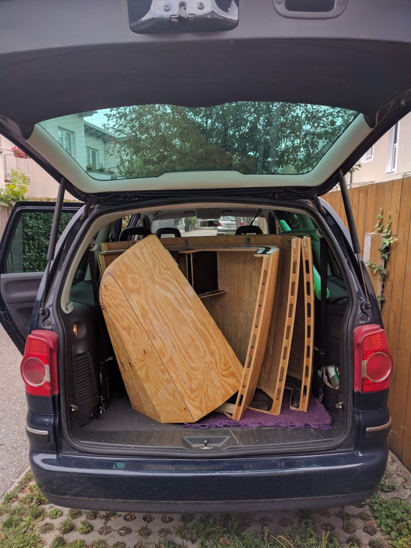

I need a new hull plan that I can easily transport in my car (4 sections).
I copied the PT-11 dinghy this summer and it basically does what I want but I need to simplify the design so that it can be built faster by anybody.

Have you seen this design?
Sailing Catamarans - Duo 10ft Sail/Row Dinghy (nesting option) http://www.sailingcatamarans.com/index.php/designs-2/46-beach-cats-and-dinghies/420-duo-10ft-sailrow-dinghy
scroll down and you will see it fits in the back of our car.
And this sailing trimaran version also fits in a car
Sailing Catamarans - Tryst 10 trimaran http://www.sailingcatamarans.com/index.php/designs-2/27-trimarans-under-25/428-tryst-trimaran
We drove all over the USA and then down to Mexico (over 8000 miles in total) a couple of years ago with it in the back, plus everything we needed for 4 months on the road.
