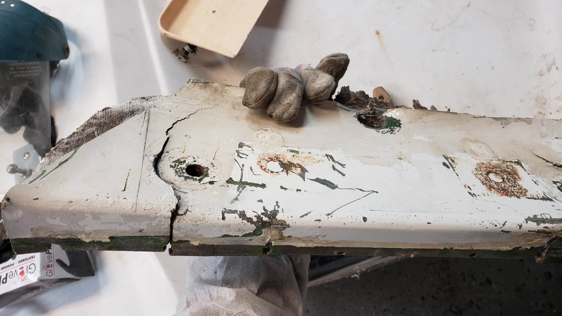

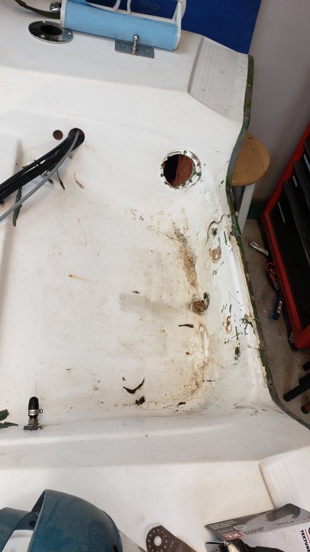

    I have a chain-plate relocation project ongoing.
    The laminating schedule I have from the designer specifies 7 layers of 600gm biax in epoxy for the patch on the inside of the hull.
    Patch will be 500x500mm wide and then each layer slightly smaller.
    Can I laminate all 7 layers at once, or do I need to break it up into two separate layups?
    Using West System, 205 hardener & working temp in the cabin will probably be around 15 degrees C.
    I was thinking if I can't do it in one go then to do the first 3 layers + peel ply. Followed by the last 4.
    Thoughts?
