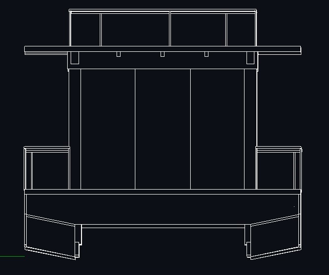

    I am an intern architect and I am building a houseboat on a budget. The houseboat is 14m x 5.5m (46ft x 18ft), including a balcony that goes all around. The interior space is 10m x 3.5m (33ft x 11.5), and the height is 2.85m (9.4 ft). The structure is a wooden deck with wooden walls. I designed it to be pretty small to help with construction difficulties. Please check the attachment for reference.
    Since I am on a tight budget, I was looking into the possibility of using these HDPE pontoons for bearing capacity. I contacted them and they said the maximum diameter they have for these pontoons is 60cm (23.6 in) with a length of 90cm (35.4 in): Hdpe Pontoon Fishing Buoy Floating Pontoon - Buy Pontoon,Fishing Buoy Floating Pontoon,Hdpe Pontoon Fishing Buoy Floating Pontoon Product on Alibaba.com https://www.alibaba.com/product-detail/HDPE-pontoon-Fishing-buoy-floating-pontoon_1600094070499.html?spm=a2700.galleryofferlist.normal_offer.d_image.648d3febgrixGK&bypass=true
    What would be the weight for such a boat? Can I safely use that HDPE pontoon with a wooden deck? I've seen people use aluminium for the base deck, but since my budget is very tight, I am thinking about using a timber base with sealants for protection.
    I would greatly appreciate any help!

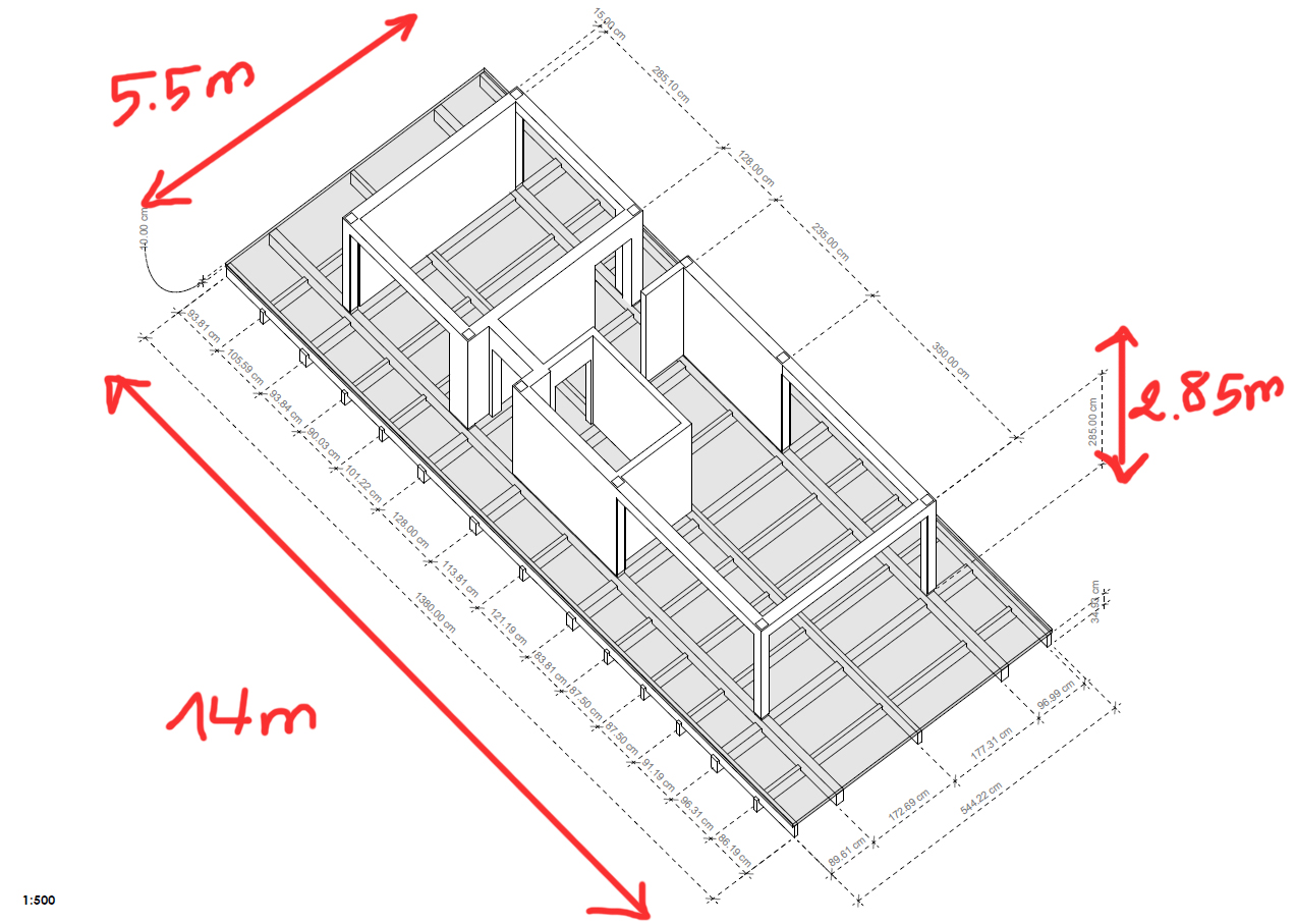

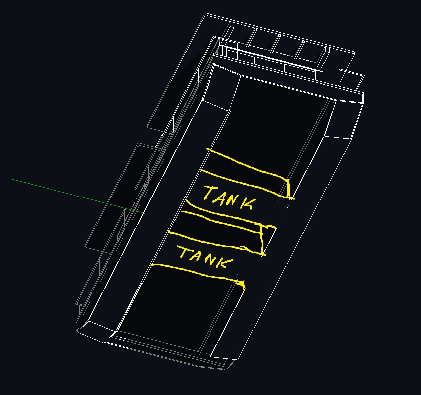

    After scrolling the forum some more for additional info, I am going to start referring to the houseboat plan as she. You guys are already conditioning me... Har!
    I updated the base to a barge and subdivided it into sealed compartments, after looking at how ship hulls are made.
    The barge framing is covered with marine plywood, epoxy resin, fiberglass sheets, and another epoxy layer, respectively. The midsection is larger on purpose; that's where the 3 tanks are going for freshwater, greywater and blackwater. What do you think?
    The native file uploader is not working for some reason... here the link to the updated barge pic. Each color refers to an epoxy-filleted compartment: barge-update https://ibb.co/qWjfvRx
    Edit: I still have not made weight calculations yet because I wanted to have all the structural members' positions/thicknesses refined first, then calculate their weight/placements.
    Edit 2: I figured the previous update was a little over-engineered. So I removed some farming members and replaced them with plywood cross-sections. The compartments labeled 'A' are made to be larger to fit the water tanks as necessary. barge-update-2 https://ibb.co/d4y51bW

    Apologies SNG, but I am a bit baffled by your 3-D drawings - do you have any plain 2-D sketches that you can post?
    In your first post you had mentioned "I am an intern architect and I am building a houseboat on a budget"
    Are you at liberty to disclose approximately what your budget is?
    And are you planning on building everything yourself?
    Be aware that there is a LOT of work involved in the hull construction alone, never mind all the outfitting later on.

    @SNGPSo You should already make an estimate of weights to verify if the volume of the barge is adequate or is too large. You must play with the necessary volume under the water and with the freeboard (distance from the water to the deck) that you want to have. Maybe, I'm just saying maybe, two pontoons is not so crazy because, maybe, a single barge supposes a very reduced draft. It will help you know where to place the various equipment so that the boat has zero trim and list. All these things should be checked before you make the final decision on what shape the float (s) will have.
    The weights and their Cogs are of vital importance, already at this moment.

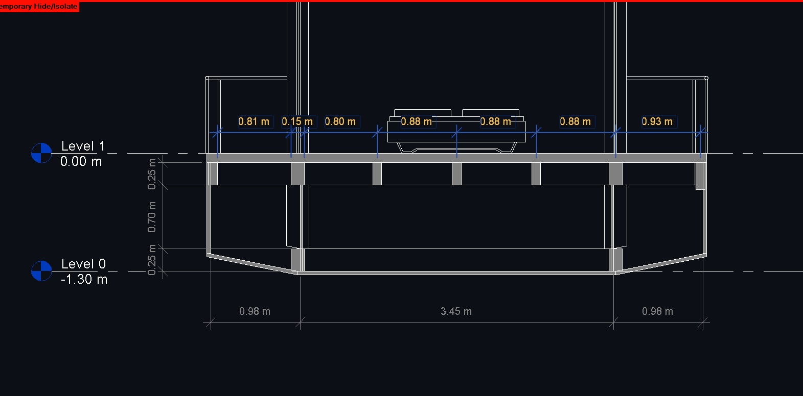

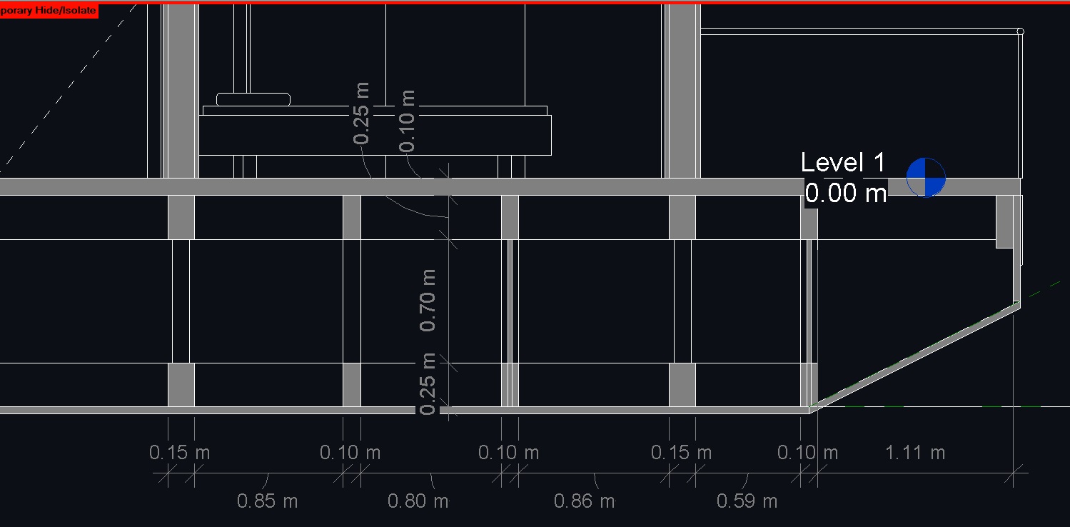

    Sorry about the quick drawings bajansailor. Here are 2 sections for a clearer picture:
    I would never be able to build it just by myself hahah. I have contact with someone who does wooden construction for a living, and some plumbing and electricity guys. My current budget is around 50kUSD, which I think should be more than enough to construct a small boat since everything is relatively cheap around here. I also have to take the houseboat for inspection before I am allowed to put it in water.
    Alright, TANSL. I will start calculating the weight asap. I am aiming for a 45cm (17in) freeboard. So, do you think I should open up the middle section to increase the draft distance?
    Thanks guys!
    Edit: Also, do you think that 2 pontoons connected in an 'H' would make sense (for tank placements)?

    I think there is no need to do the "H" configuration that you propose. Additionally, tanks can produce a destabilizing effect that is proportional to their width. For this reason, it is preferable to make tanks that are longer than they are wide, which will undoubtedly fit inside the two symmetrical hulls.
    Try the typical configuration of a catamaran: two hulls joined by a transverse structure. But beware, I'm not saying that the solution for your boat is the catamaran type.

    I think it is too easy to confuse what @TANSL is saying. He is saying calculate weights first, so you know the needed displacement. Otherwise, you are carting before the horse.
    Based on what I see, a barge will be needed, but how much barge is an obvious question.
    You determine the weights and then determine the hull. Not the other way around. Otherwise, you are designing the superstructure to suit the hulls which is very expensive. Consider this error...my hulls are too small and now I need to use exotic ultralight materials and processes to make the house light, etc.
