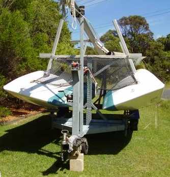

    Here is a Windrush 600 with a tent - mmm you're right it could simplify things
    http://www.lswsa.org.au/windrush/boathome2.jpg
