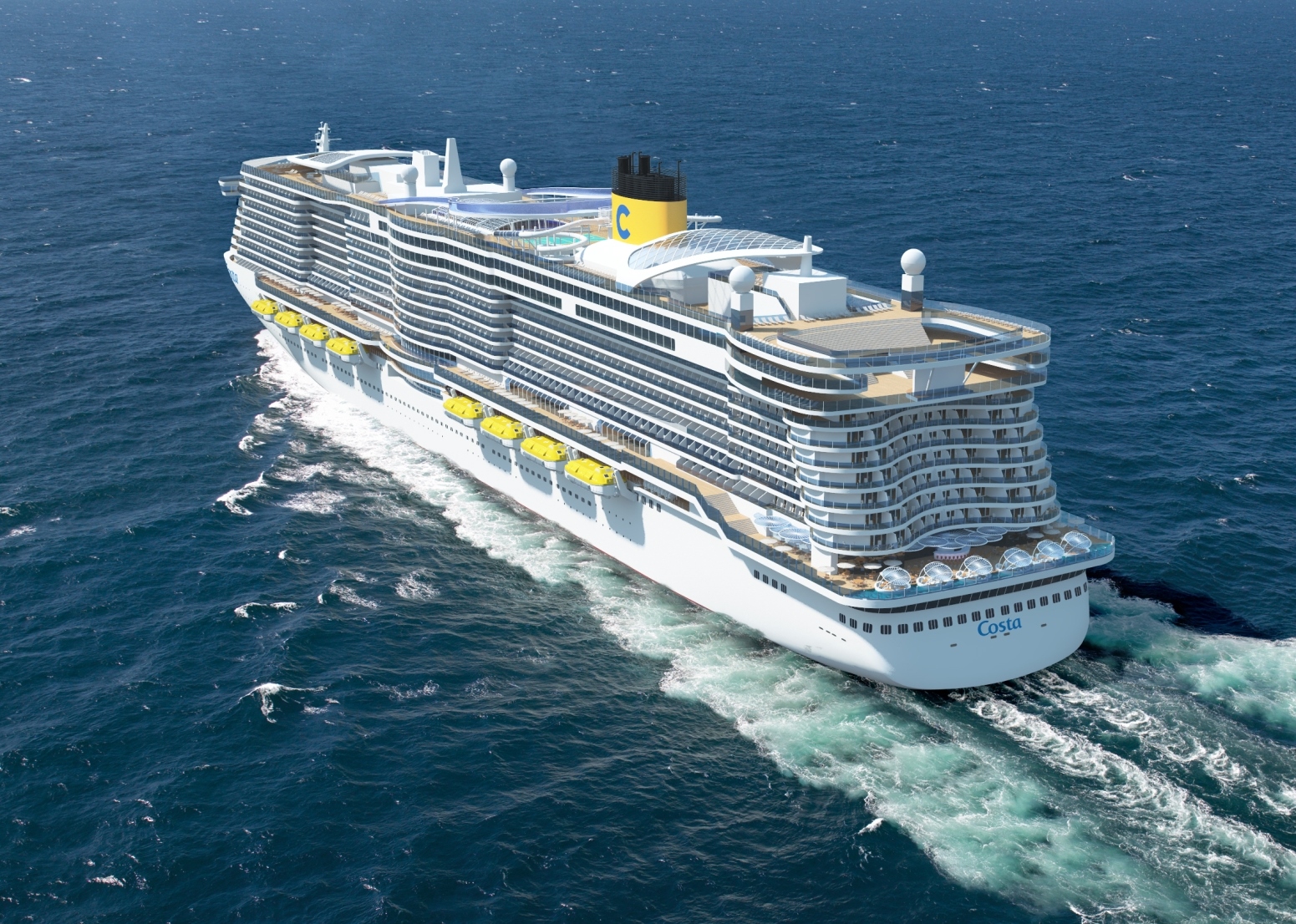

  14. OceanLinerFan
    Joined: Jan 2012
    Posts: 29
    Likes: 0, Points: 1, Legacy Rep: 4
    Location: Melissa, Texas
    OceanLinerFan Junior Member
    LNG Potential?
    Hey guys,
    So I noticed that my proposed nuclear plant for my ship raised some very good points of discussion. I'm still not sure on it myself, but I'm also looking at possibly using LNG as a substitute fuel, since many cruise ship newbuilds from this year on will have engines powered by this fuel (such as the new Costa and MSC ships).
    I attached a rendering of the new 180,000 GT Costa newbuilds that are to be powered exclusively with LNG. However, I still wonder whether the proposed horsepower of my ship (144,000 SHP) would still be achievable with such engines.
  15. mydauphin
    Joined: Apr 2007
    Posts: 2,161
    Likes: 54, Points: 48, Legacy Rep: 575
    Location: Florida
    mydauphin Senior Member
    It is a problem of economics, as far as I know bunker Fuel oil is just cheaper to burn than anything else. Sure you can scrub the exhaust. Look at the numbers below.
    Most ships produce their electricity using diesel engines. Others use gas turbine engines to generate electricity. Still others use a combination of the two.
    Diesel engines use heavy fuel oil (“HFO”) while gas turbine engines use marine gas oil (“MGO”), which is similar to the fuel used in jet airplanes.
    Queen Mary 2, currently the fastest passenger ship in service, consumes 261 tons of HFO and 237 tons of MGO a day when traveling at full spreed.
    Queen Mary 2 Fuel Capacity - The Queen Mary 2 (QM2) is currently the fastest ocean liner in the world. It weighs 151,400 tons and has a fuel capacity of 4,381 metric tons, which equates to 41 feet per gallon. Still, at a clip of 32.5 knots, the QM2 can sail for 10 days on a full tank.
    Norwegian Spirit Fuel Capacity - In contrast, the Norwegian Spirit is its fleet's smallest ship. It weighs in at just 76,000 tons and has a fuel capacity of 1,150 metric tons. This converts to 354,144 gallons.
    Freedom of the Seas Fuel Capacity - The fuel capacity for Freedom of the Seas, as well as all the Freedom class ships, is 3,533 metric tons - more than three times the capacity of Norwegian Spirit. It is also much larger. Freedom of the Seas has a gross tonnage of 160,000 tons. Clearly, a ship this size will burn fuel faster than smaller vessels, thus impacting any possible routes.
    Cruise Ship Fuel Usage - Size is key to fuel consumption and efficiency. A smaller ship will use less fuel than a large ship to travel the same distance. Both size and the average speed a cruise ship travels impact how much fuel it uses. On average, ships use 140-150 tons of fuel per day, which works out to roughly 30 to 50 gallons per mile. Similar to a car, traveling at higher speeds means an increase in aerodynamic drag, which directly impacts fuel use. Given that most cruise ships travel at 21-24 knots, this isn't often an issue.
    Queen Mary 2 Fuel Usage - In the QM2's case, the ship is huge at 1,132 feet long and a weight of 151,400 tons. This storied passenger liner is built for speed and is capable of a cruising speed of 29 knots and a top speed of 32.5 knots. Compare this to most cruise ships, which travel at 21-24 knots, and you can see that the QM2 is a water rocket. It travels at a brisk clip that requires more fuel. According to Cruise Ship Engine Power, Propulsion, Fuel by Chavdar Chanev, the QM2 averages uses six tons of marine fuel per hour.
    The Norwegian Spirit - At a petite 878 feet long and 75,500 tons this ship is much more fuel efficient. When sailing, the Spirit chugs along at an average speed of 24 knots and burns approximately 1,100 gallons per hour. Thus, it can conceivably remain at sea for 12 days without refueling.
    Freedom of the Seas - Freedom class ships are all 1,112 feet long with an average speed of 21.6 knots. The are rumored to have a standard fuel consumption of 2,800 gallons of fuel per hour. Their propulsion systems are state of the art, providing a 10 to 15 percent fuel savings overall.
