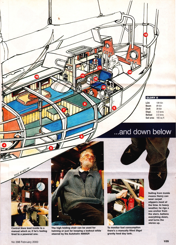

    DVV, you might find some interesting ideas in Glory, as shown in the attached article from Practical Boat Owner 20 years ago.
    OK, she is not a scow, but she has a very neat junk rig. Her hull is a standard 19'6" Colvic Watson design which Henry bought as a bare shell, and then he built the rest himself.
    He has been around the world with her, in addition to sailing from the UK to San Francisco and back (both times via Panama), and in his later years summer cruises every year from the south coast of England up to the Shetland Islands (north of Scotland) to visit his daughter (who lived up there).
    Re your proposed keel attachment - I think the easiest would be if you have a stub keel built into the boat, which you then attach the ballast keel to with sturdy through bolts.
