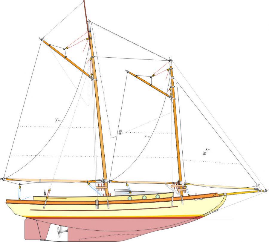

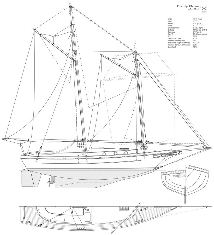

    I lurked around little bit because of curiousity and have noticed, that you keep your own "external designs" little bit in the tradition of Herreshoff, right ? (see attached thumbs)
    I like the filigranity of your rig and sails plans. Very beautiful. Where are your boats being built ? I suppose not many boat builders can realize your projects anymore, isnt ?

    There are no box beams in either of the NGH interiors shown above, nor the LFH cabin. Both Capt. Nat and the son treated the hull as a big box beam, with the deck and deck structures being the top web, the hull sides and bottom the rest. Since longitudinal stiffness is often key, localize stiffeners are employ, such as a keel, king planks on the deck, etc. most developing into a truss assembly. Both NGH and LFH designed with great care to just what was needed, no more, to save weight. A description of a dismasting on one of LFH's racers said the whole rig (mast and all) just exploded into little bits. This is the epitome of engineering, where the failure rate wasn't in a "weak link" but literally everything was sized appropriately and once this point was reached, everything came apart at once.
    I agree the above description sounds like a broker looking to make a sale.
    Yes, I've studied Herreshoff, it's foolish to not study one of the most prolific and talented yacht designer and builder the world has ever seen. He did over a 1,000 designs, this alone places him in the upper tier. Some of my designs have a Herreshoff feel to them, but not many follow his scantling rules, construction techniques, etc., simply because we have lighter, better ways of doing things now, though I've always enjoyed the raised panel look. Nowadays, I'd use a formed panel over plywood or a cored bulkhead instead, just for the look, but saving a bunch of weight.
    "filigranity" I get caught with the spell checker beast regularly too. I'll assume you meant "flagrantly", which is an interesting word choice. I don't know if I intentionally attempt to emulate HMC or simular, but I'm glad you like it. Currently there are only a 2 Emily Roses under construction, one in France and the other in Pennsylvania. It's not a common yacht type, for plan sales and it was a custom design, so subject to the client's wishes. The counter stern version was for a new client, that was interested, but with these changes. The Discrete design is one of my older ones and many have been built over the years. It's small enough to be a viable homebuild and it's charm is classic. Again, not a big seller for plan sales, but a small niche market that's reliable. If I wanted to move lots of plans, I design a bunch of 100 HP, outboard equipped, 18' center consoles, of course presented with a camo paint job and at least 16 rod holders around the side decks, next to the 8 cup holders.

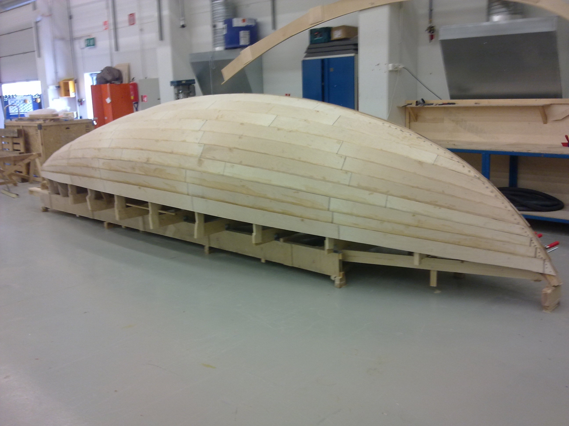

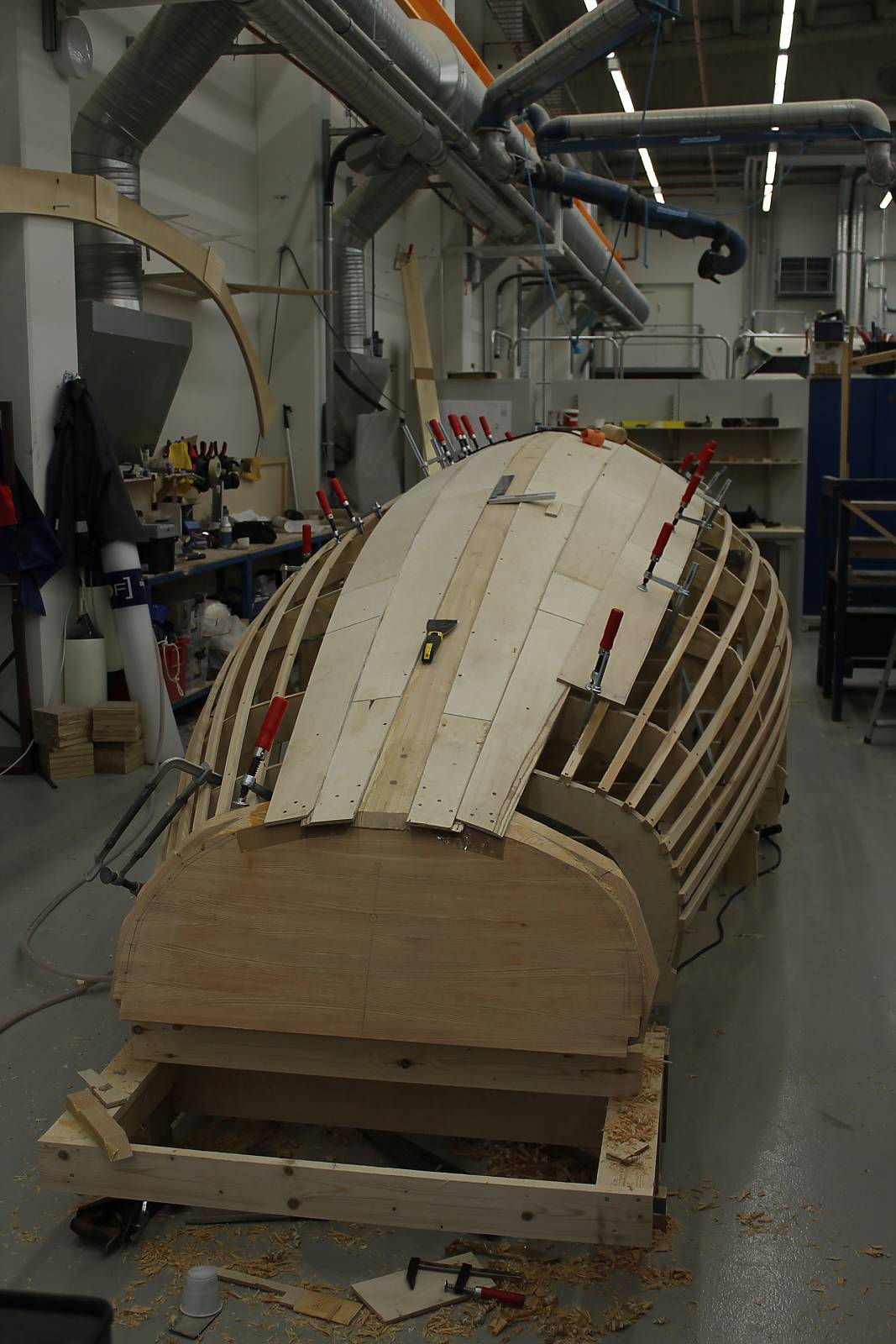

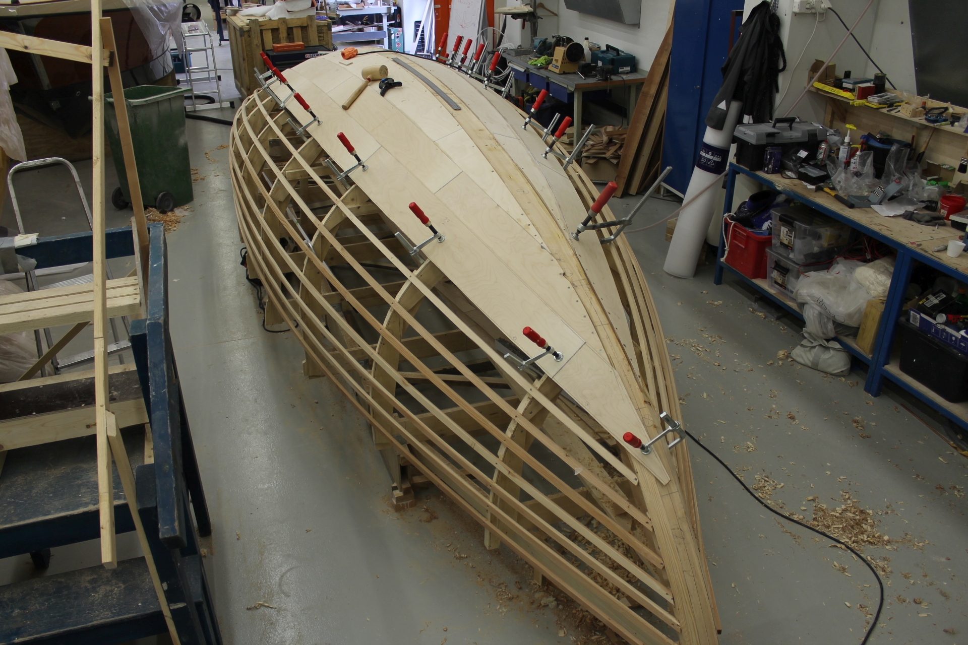

    Attached is one of the Discrete designs underway. It's a glued lap version and he has the spars built, the deadwood assembly, the rudder and now the hull is planked up.
