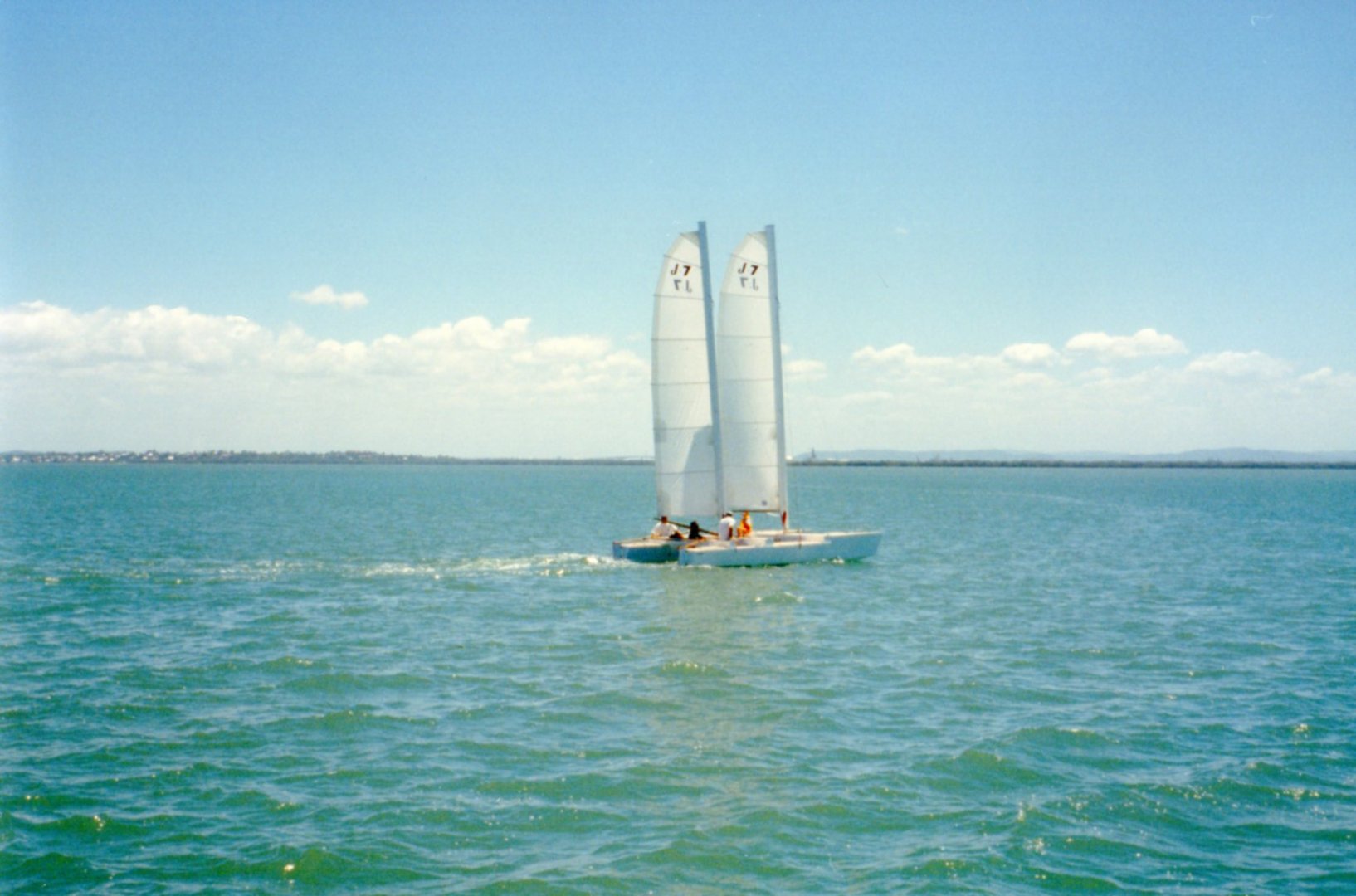

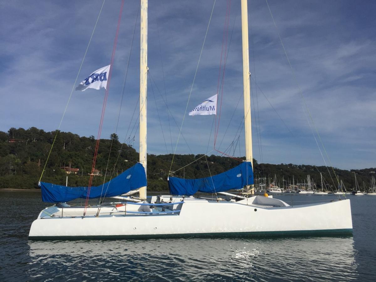

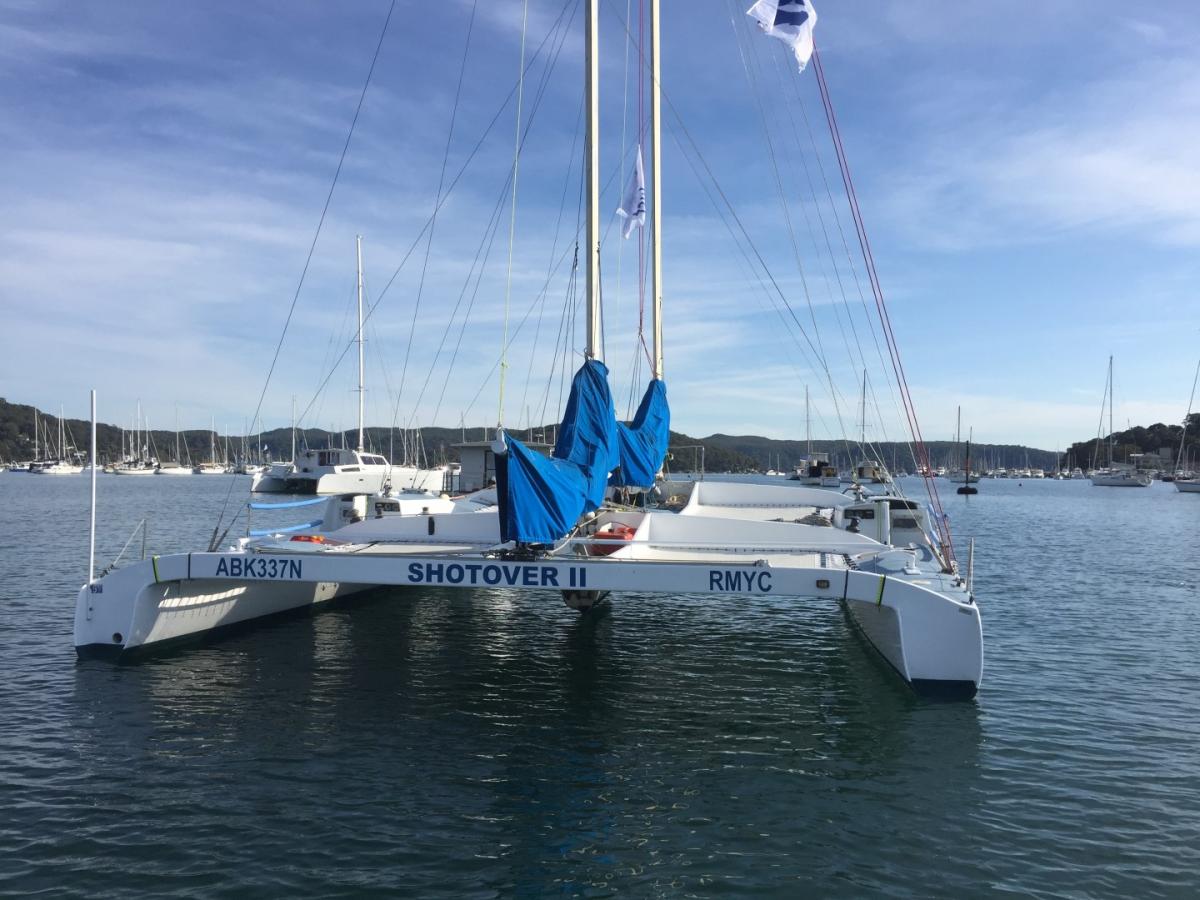

    Whilst we are talking about Shotover, the original builder/owner Adrian Rogers then designed/built a 40 x 25 foot light racing cat Shotover 2. This interesting part of this boat was its schooner rig. Shotover 2 has 2 equal high masts with fully battened mainsails. The 2 mainsails had big roaches when they were not normal and were placed close together. Before the boat hit the water many detractors predicted the rig would be slow due to interference between the sails. Shotover 2 was fast on the race track. Upwind was meant to be a weakness but proved to be good because the forward mainsail, when sheeted correctly, smoothed air flow onto the rear wing mast mainsail unit. On a reach this boat was fast. Another smaller home built version designed by Ross Turner the Jarcat 7 23 x 15 foot weighting 900 lbs carrying 300 square foot of sail (designed to be trailed) had similar characteristics to Shotover 2. Jarcat 7's can sail quite well across all points of sail. Wharram also was surprised at how well his 31 foot schooner rigged cats sailed. Again good design can surprise us all. The only problem is you have to build 2 masts, 2 rigs and deal with 2 mainsails. It is probably cheaper than multiple headsails winches etc but looking after 2 wingmasts whilst cruising would not be relaxing.
  2. oldmulti
    Joined: May 2019
    Posts: 1,294
    Likes: 692, Points: 113
    Location: australia
    oldmulti Senior Member

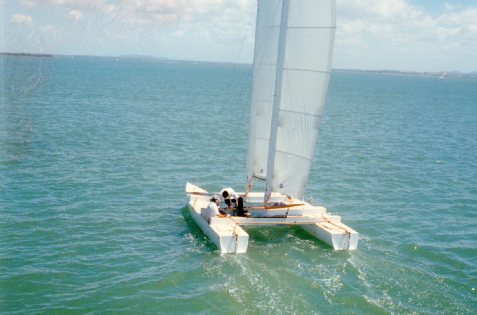

    A photo of Shotover 2 sailing.

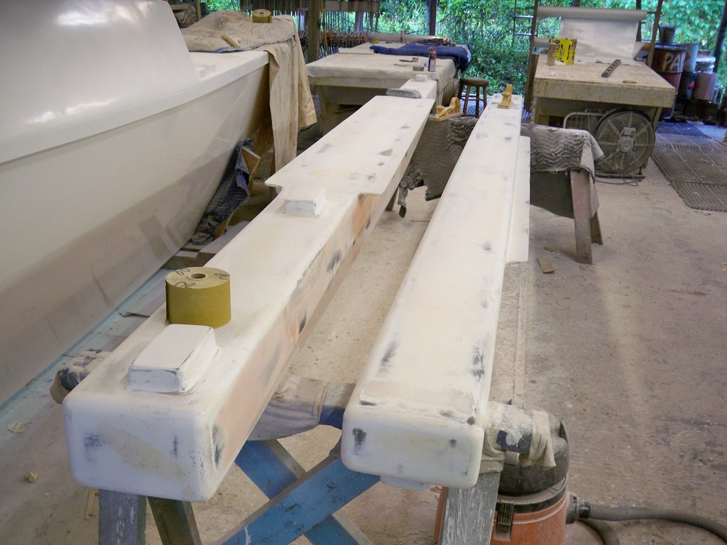

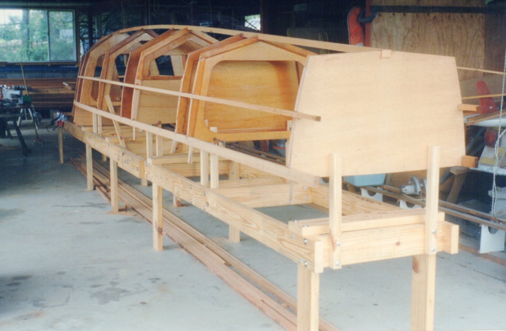

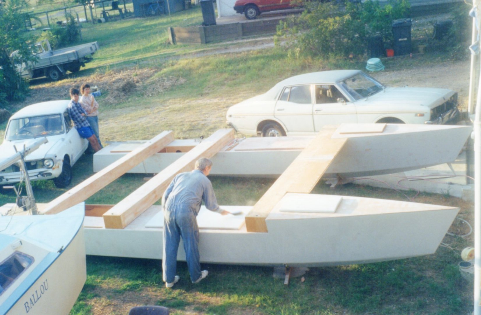

    I will start a small series about cross beams. I will start with the older style of cruising catamaran cross beams and work forward. The first crossbeams were plywood and timber (many designers still use them today), then they evolved to combination of timber, plywood and often unidirectional glass. Later versions had some timber, plywood, foam and glass. Later versions are mainly foam glass with some compression timber. Finally some designers are using carbon fibre and foam. As cross beams evolved they became lighter, often easier to build and more integrated into the structure. Now I need to specify the type of boat I will be taking about, They will be bridge deck cruising catamarans that have a main mast supporting cross beam and an integrated rear beam. The forward beam will have a forward wing deck which acts as a torque box to take care of torsional twisting loads through the wing frames and associated upper and lower decks. I will do something later on small tube cat cross beam calculations. I will give details about several cross beams, some I will not identify the boat as the design is still being sold commercially. On the first plan the forward cross beam structure can take about 4 times the load of the rear cross beam which was normal for the spindrift series of 37, 40 and 45 foot cats. All the beams were built with the same concepts just different sizes of timber and ply. The first plan is the forward cross beam.

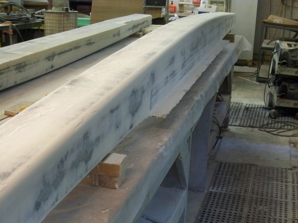

    Now we will jump ahead to how to construct a foam glass cruising catamaran cross beam structure. The following web site story_e1 http://www.saunalahti.fi/pekkajlh/boat/story_e1.htm is about the building of a Cosmos 1100 bridgedeck catamaran 36 x 22 foot displacing 9000 lbs. I will be giving structural details of other cross beams in a later post but please understand the overall process. The following web site Autumn01 http://www.saunalahti.fi/pekkajlh/boat/Autumn01.htm gives a very good idea how to build a strip plank forebeam. It also gives some details of the building of the main cross beams on Winter01_02 http://www.saunalahti.fi/pekkajlh/boat/Winter01_02.htm The unidirectional glass is simply compressed easy on one edge but will require a reverse mold for the reverse curve. The installation of the bulkheads is shown on this page spring_summer02 http://www.saunalahti.fi/pekkajlh/boat/spring_summer02.htm Please understand the process and the details shown, it will help later.

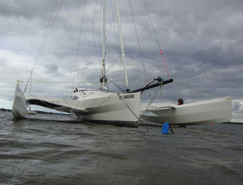

    We have mentioned Ray Kendrick as a trimaran designer who does a series of 16 to 32 foot tri's and 2 cats. Each of his designs cost $150 irrespective of size. Good value. His folding tri's have been built by many but the best home builder I have seen is a canadian who knows about Finite Element Analysis (FEA). He did FEA on the Scarab 22 design as he built it, strengthening and simplifying it as he went. His blog is Scarab 22 construction http://www.voile.org/trimaran/ Look thru the blog it will provide many hints on structure, building, vacuum bagging, resin infusion etc. The complete boat took 1500 hours to build. The cross beams pages give a good idea of how much work can be involved in building folding cross beams. The following page is the main beam page 4 cross beams! http://www.voile.org/trimaran/progress/Mars05/mars_10_2005.htm The guy sold his boat after a few years then looked around for another design to build. Designers were very interested in having him as a client as one designer wrote "he asked if any FEA had been done on the main cross beam of the design. I said no and welcomed his interest." The pictures are of the scarab 22.
