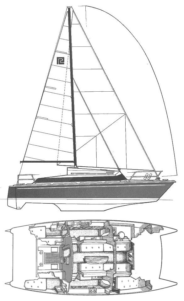

    We looked at Zingaro in 2014. What was interesting about her was the bridgedeck was glassed on the inside but not on the outside, just paint. Not sure if anyone took the time to glass the underside plywood on the bridgedeck but it would have been important to me. After many years of sailing would it have been possible for the underside of the bridgedeck to become waterlogged then have the bridgedeck to hull tabbing break loose?

    One aspect of this style of beam connective is the narrow beam of the hulls and the tight radius of the underwing to hull joint. Also Lock did not continue the bottom flange of the forward bulkhead right through to the outer hull side. So there are three pretty big issues with the design there. That is before you get to construction.
    A tight radius on a joint increases loading. Chamfer panels and trenches all increase the effective radius of the beam as it enters the hull, greatly reducing load in the area. Think of rounding corners to avoid stress concentrations.
    Spindrifts are very narrow and tall hulls. This give a torque that rotates the hull less "staying base" at the beam connective with which to resist the torque. Less length means increased load for same torque. Modern hulls are wider at the gunwale and reduce load here.
    Not carrying the bottom flange of the bulkheads across the hull is asking for the load to go somewhere but not giving it a pth to do so. So the load somehow makes its way into the hull skin. A better way is to carry the whole beam onto the outer gunwale or to locate a bulkhead here with a cutout and reinforce it.
    Then there is the huge advance in materials. A modern cat uses unidirectional or muli axial fabrics to cater incredibly well with loads around corners. If I went back in time, I could do a good job, but it would be heavier than today and people didn't know about using glass tow and unis they way we do today.
    I am sure Lock knew of these problems because he knew of them when Pennant had issues. He then drew boats that were very different, although none had chamfer panels, he used trenches at the side of the bridgedeck to deepen the beams at the connections on many cats. No Crowther cats I know of had similar beam issues and I think if I had a Spindrift I would do some work on it at the beam ends.
    These boats were designed 50 years ago (1970ish) and I am sure Lock would say that he could have done a lot better just 10-12 years later, with the first Windspeed and Catana cats being drawn.

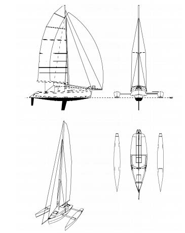

    This tri is designed by Paolo Lodigiani and Matteo Costa in 2005. Th tri called Trillo and is 24.6 x 19.5 foot weighing 1680 lbs. The mast is 32 foot high with an approximate sail of 225 square foot main and 125 square foot fore triangle. The length to beam of the main hull is 8:1. According to the designers “Compared to a catamaran a trimaran is more agile, enjoyable to sail, evolutionary and fast with light winds.” The numbers indicate the tri will have reasonable performance.
    TRILLO is a fast and reasonably comfortable day cruiser. The main objective in designing the boat was economy, ease of construction and simplicity of handling. Special attention was focussed on the tri’s retractable beams, with mounting, dismounting and transporting.
    The designers proposed two versions, one with a round bottom and one with a chine hull. The difference in construction time and required skill by the builder is not very much, but according to the designers, there is not even much difference between the two versions as far as performance is concerned. The round bilge should be just a little better. The flat bottom hull version will offer a number of advantages to internal space.
    The chine hull is flat plywood construction with stitch and glue taped chines and stringers on plywood bulkheads. The round bilge main hull uses strip plank construction with epoxy glass on both faces. Again, plywood bulkheads, deck etc. Crossbeams are aluminium and are telescopic sliding in tubes. It is according to the designers, the simplest and most functional approach for an amateur. The same logic applies for the centreboard, rudder and all other details. I do not know if any have been built but it looks interesting. Sorry about the lack of jpegs but little further information is available.

    I don't mean to be disrespectful but I don't get the engineering of this mast set up. The rear longitudinal staying base is so small that the load on the backstay and therefore the compression loads on the mast would seem to be huge with just normal forestay loads. Normal multi stays are swept aft by 30 degrees which multiplies the vertical vector by 2 to hold the mast up. So on a square run, to stop the mast being pushed forward by 1000 N you need 2000 N of stay tension. (But there are two "backstays" so each only has to take half the load. For the mast to stay in position the components of the mast load (X and Y) must be equal and opposite. The forestays are much better aligned at pulling forwards (X component) but the backstay is much less effective in acting in the X component so it has to increase load to get the same torque or load. By going to a thinner staying base (as seen from the side ) the compression and staying loads must increase greatly. The longitudinal staying base looks like about 10 or 12 degrees. This means that to stop a load of 1000N pushing the mast forward on a square, the stays have to be tensioned to 5000N (2500N each) (12 degrees) with a corresponding increase in mast compression. This is a lot more load than the normal type rig. Have there been any rigs like the one drawn that have been successfully sailed?

    I read through some of the thread and saw that there was a tri that used such a rig. Did it go well? I don't follow your rig analysis. It doesn't look the same as what I am used to in books like Skene's. It doesn't seem to deal with torque.
    My worry about the force on the rig comes from the substantially differing angles of the forestay and backstay. Both stays have to exert the same force fore and aft, or the masthead would move. The forestay has an angle of 33 degrees to the masthead. So the forestay exerts 53% of its force into a horizontal vector or X component. The backstays have an angle of (if I get the angles right ) about 8 degrees to the top of the mast (The torque has to be exerted at the top of the mast otherwise it will move so even thought the stays attach to the mast lower down the effective staying base is about 8 degrees). At 8 degrees the backstays have an effective X component of 0.14. So you need to increase the load by 7 times to get a set X vector. To get 1000N pulling forward you need just under 2000N in the forestay. To cater for this load in the backstay you need 7000N in the backstay and a sizable increase in mast compression. As the forestays are long and have two jibs on them there will be substantial torque on the rig pulling the masthead forward. This has to be opposed by the backstay or the masthead moves. There is no mainsheet tension to assist with the forestay tension. Jumpers and extra stays do not help with resisting the torque from the forestays, dropping the backstays down the mast increases staying angle, which lowers load, but reduces effective torque arm, which increases load, so there is no gain there.
    It is a bit like a monohull owner trying to reduce sidestay loading by adding large spreaders to the rig. It won't work because the sideways (heeling) torque is resisted by an equal torque at the deck. You can increase the spreader length if you want but as the only torque that resists the rig torque is produced at the deck, it is the distance between the mast and chainplate that matters. The same occurs fore and aft as well - increase the lever arm to get less tension. Torque = Force x distance. If you reduce distance then the force goes up, you can't get around it and that is why multis have such wide staying bases - to reduce load in the rig wires. Reducing staying base in any orientation increases load.
    A typical rig has extra sweep back on the backstays than this drawing and a more symmetrical arrangement of forces from forestays and backstays. Mainsheet tension helps deliver a tight forestay and a lower forestay attachment, which you get with a fractional rig, reduces the torque from the forestay.
    It would be pretty easy to make a simple mockup of the rig with spring balances and check out the fore and aft loads. Then we would not be debating, just observing data. Then again, this is probably not the thread for a detailed consideration of this idea but I would be interested in the mockup.

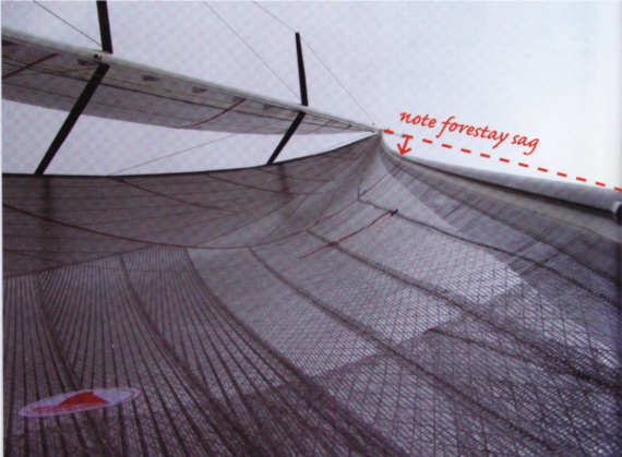

    Now we come to the problem of bendable multi’s. Multihulls bend in crossarms, hulls fore and aft etc. Even if you put hydraulic rams on backstays to tension forestays you can only go so far before the bending forces take over and things start to break. Monohulls generally have better keel line structures and broader continuous deck structure and can be loaded up by hydraulics more, therefore have more rigid forestays. Multihulls generally have lighter structures and cannot take the same rig/forestay tension loading.
    The reason for the very good sailmaker is if a forestay sags (slack) increasing fullness in higher winds, sailmakers can adjust the cut of the sail to compensate. The problem is the sailmaker either needs to know the characteristics of the specific boat well or they have to use their experience of similar craft to adjust the headsail cut to suit the forestay sag (slackness).
    Translation of all this, the longer the forestay the more sag (less taut) the forestay will be no matter how much tension the rig has in it. High load rigs with big headsails and small mainsails suffer the most. EG it can be a Prout cruising cat or Crowthers 60 foot Shotover racing cat. They all suffer the same problem in stronger winds especially upwind they do not perform as well as big main smaller headsail rigs. (Yes, Prouts have inefficient keels, high windage hulls and low underwings compared to Shotover daggerboards, but I can assure you Shotover hulls were fast, its rig was its relative weakness). Headstay sag can vary from inches to feet depending on the length of the forestay and the relative rigidity of the multi.
