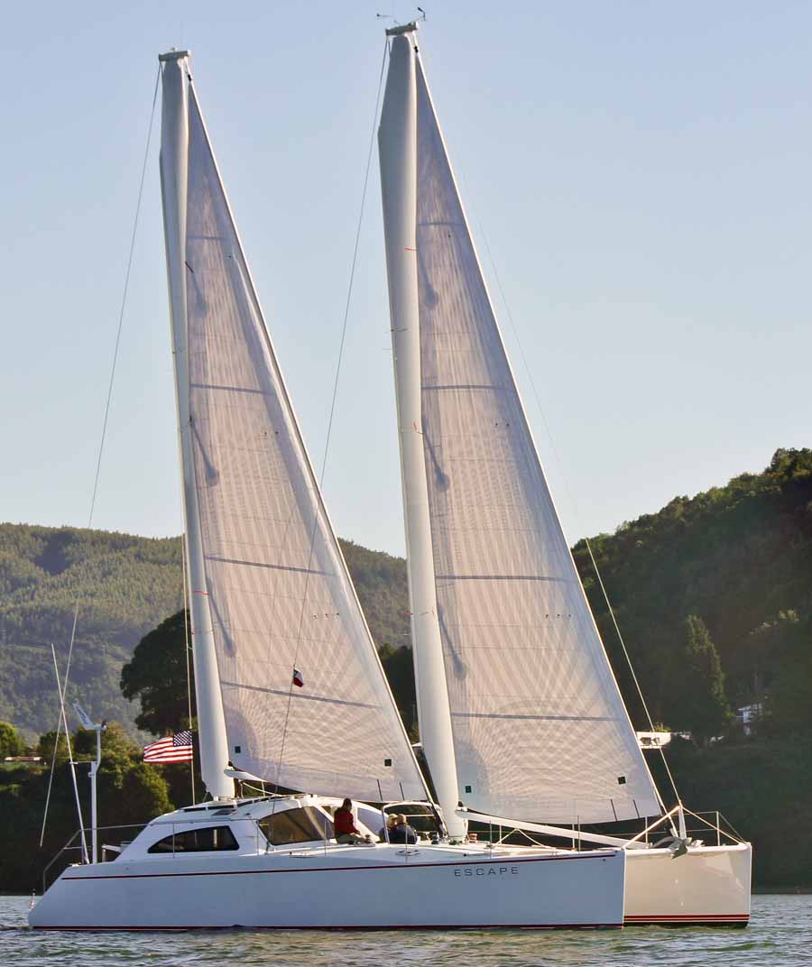

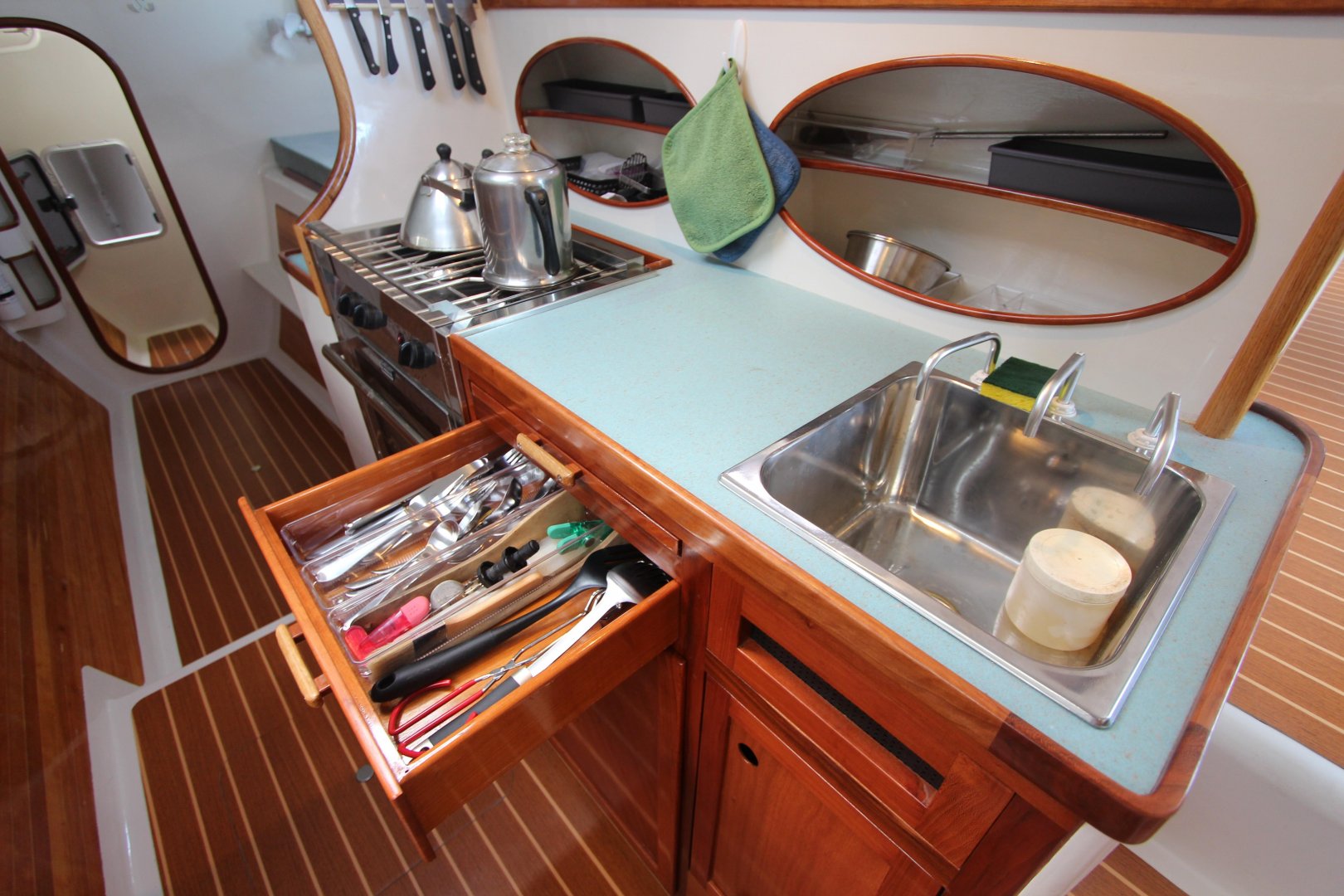

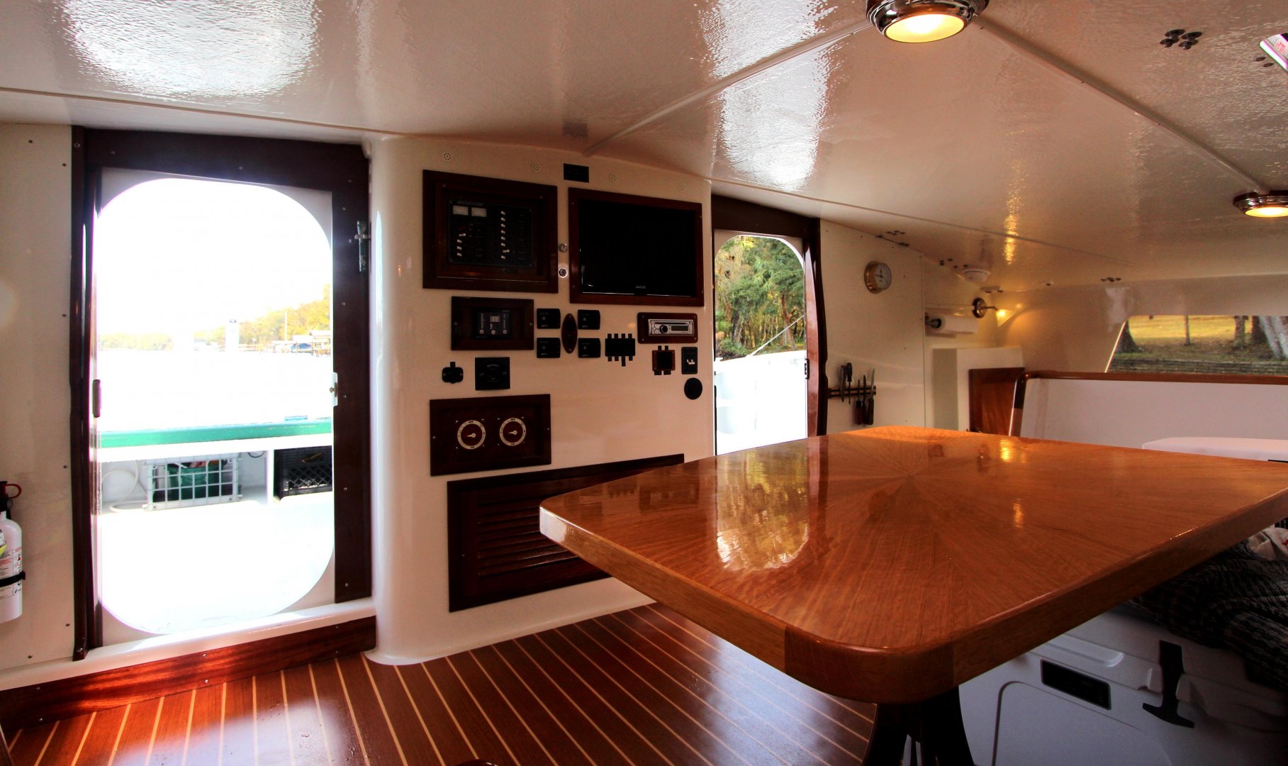

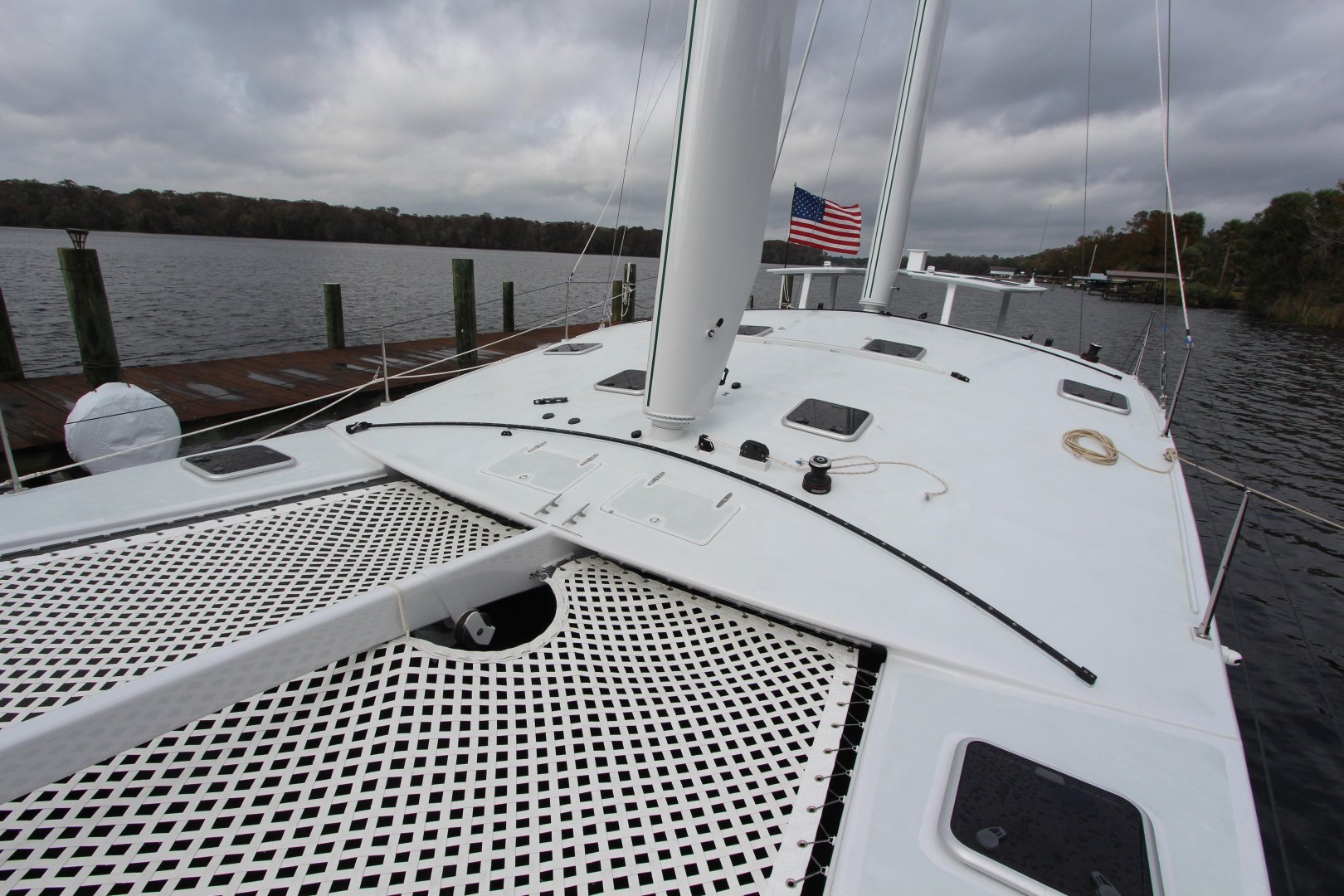

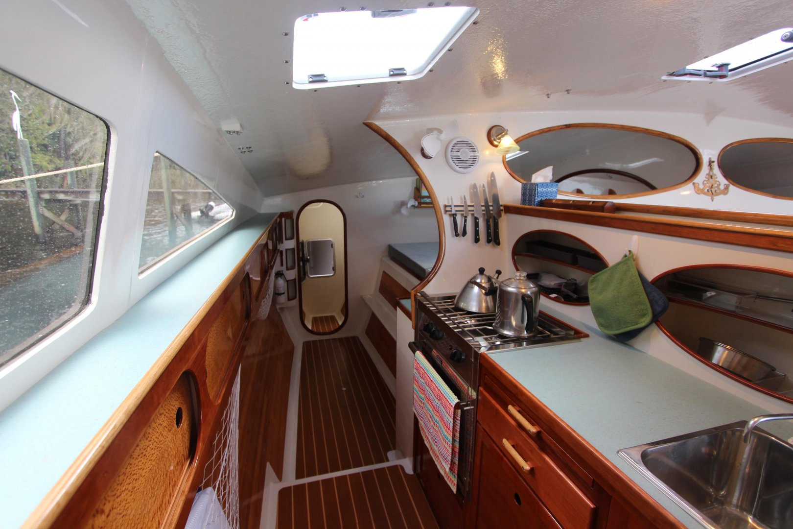

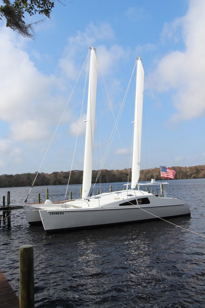

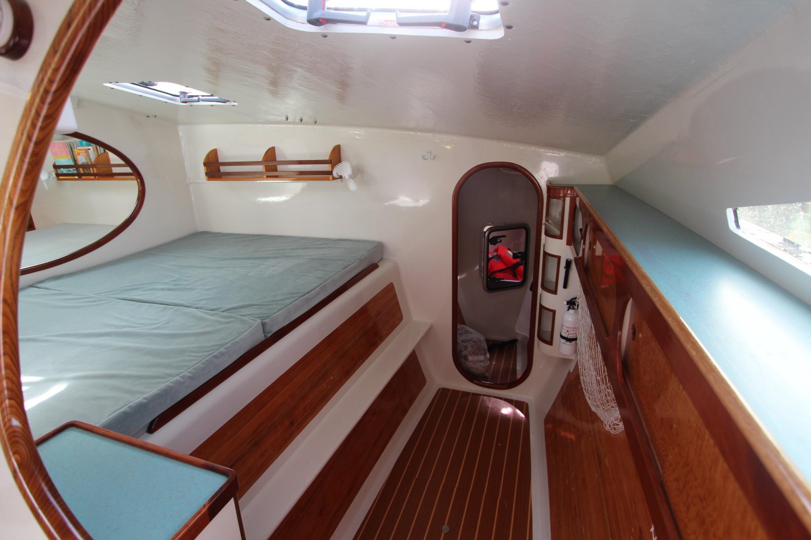

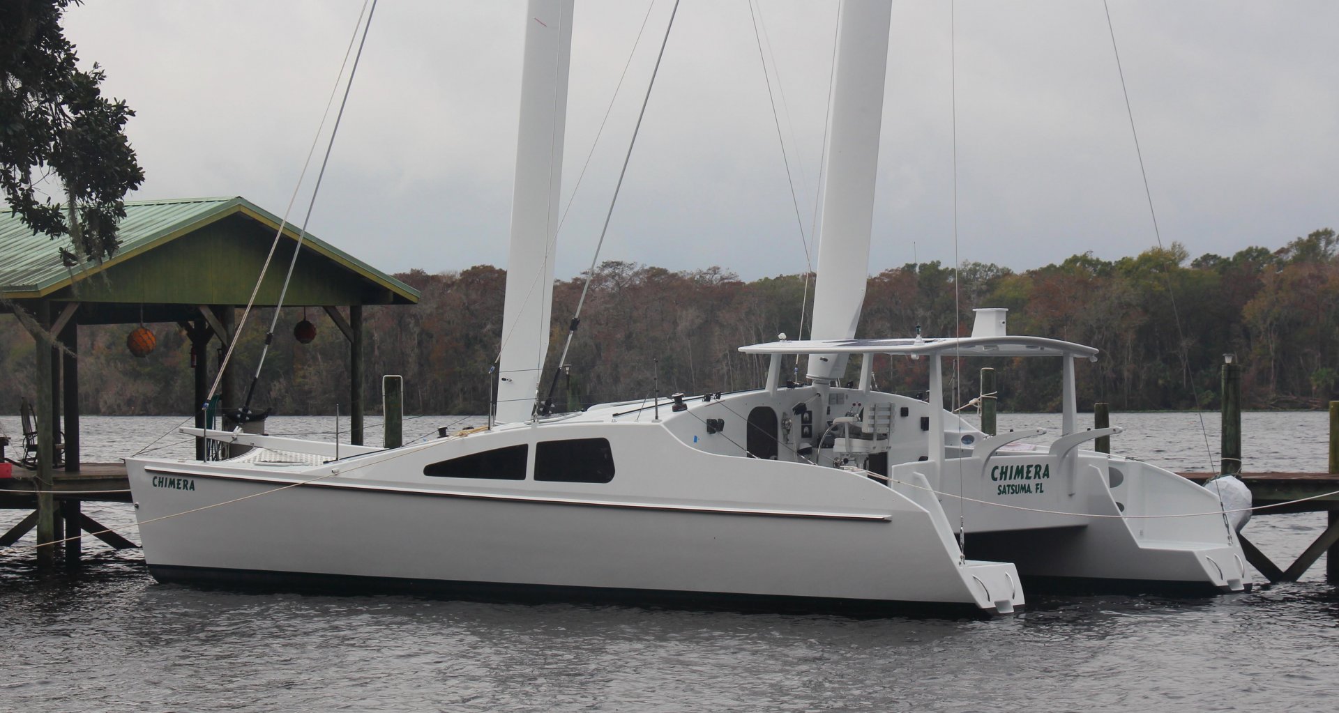

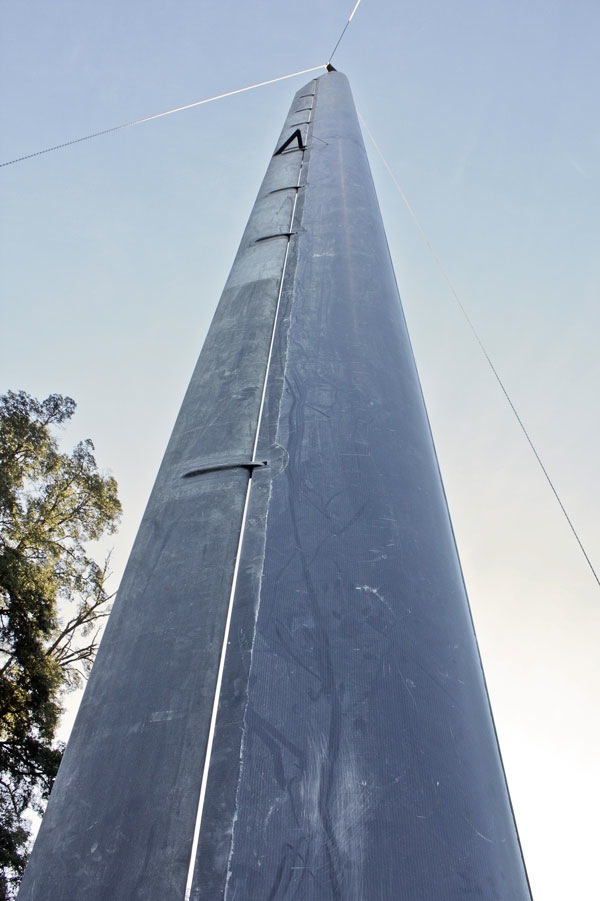

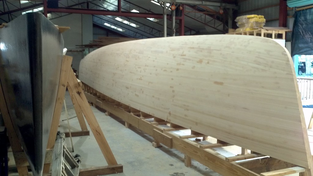

    A request for more Chris White information has led to the next design. A performance cruising cat of 40.3 x 18.8 foot displacing 11,000 lbs. The Low Aspect Ratio fin keels draw 3 foot and the forward freeboard is 5 foot. Now we come to the rig. The rig is claimed to be “A super easy to sail MastFoil (US patent) design. Layout features all controls led to cockpit for easy short handed sailing. No mainsail to hoist, reef and furl!” The rig is self-tacking and all sail controls are led to the cockpit.
    The sailplan composed of two roller furling, self tending, jibs supported by two 40 foot high MastFoils which are carbon fiber small rotating wingsail masts. This sailpan has been proven in 11 larger cats sailing approximately 100,000 miles. The MastFoil rig is all vacuum bagged carbon fiber/epoxy, built by Alwoplast. Reefing lines and furling are led to cockpit. Standing Rigging: All 1x19 SS wire, Running Rigging: Spectra double braid Jib halyards and Reacher Halyard, Sta-Set low stretch Dacron sheets and control lines. Jib Roller Furling: Harken roller furler with reefing line led to cockpit mounted clutch adjacent to winch. Sails Ullman Sails, Fiberpath Carbon/Vectran Laminate 2016 Harken Mk4 furlers Ullman Code 0 on bowsprit with Harken furling system.
    To quote Chris White: “Our experience to date with the MastFoil rig is that the windward sailing performance is about equal to a conventional sloop rig. A Computational Fluid Dynamics study by Doyle Sails CFD comparing a conventional rig and MastFoil rig in the new Atlantic 47 catamaran indicates a 1% performance difference, essentially no difference. Given the ease of handling and versatility of the MastFoil rig I gladly accept a moderate reduction in predicted aerodynamic performance. The ease of handling means the Mastfoil can be "dialed up and down" so quickly that the MastFoil is likely to be faster when actually sailing. This will be especially true when sailing shorthanded, where crew delays in responding to wind changes account for HUGE variation in performance. Make the rig easy to sail well and it will be sailed better.” At anchor, with the aft MastFoil locked on center, the boat will ride head to wind, eliminating the need to rig an anchor bridle.
    Construction: Hulls are epoxy composite with carbon fiber skin outside, white cedar core and high strength S-glass inside for a clear finish. Decks are constructed from foam cored carbon fiber/epoxy laminate cored. All exterior surfaces are painted with AwlGrip™ polyurethane coating. Rudder blades are fiberglass composite, high performance hydrofoil section with solid Aquamet 19 rudder stocks turning in low friction bushings. The build jpegs give an idea of the structure.
    In order to keep the profile low, and preserve underwing clearance, the standing headroom of the MF40 is located in the hulls where it is most needed - in the galley, the head, and the hull adjacent to the Queen size double berths amidships. The deckhouse consists primarily of the settee in the main cabin where people are sitting or lying down most of the time. The deck house height is low enough to not obstruct forward visibility from the cockpit. Cockpit: 14’ wide by 8’ long, 11' bench seat and cushions with stowage below.
    Propulsion Twin Yanmar 3YM20 (20 HP) diesel saildrive engines High output (115 amp) alternator on both engines. Propellers are bronze geared folding type by Flex-O-Fold. The range under power is 400 plus miles. Electrical: (3) Solar Panels, 100 watt output each, with deep cycle gel AGM 150 amp hour capacity each. Ground Tackle 35 lb. Delta anchors, each with 200’ ¼”chain. 22 lb Danforth , 50’ chain 150’ nylon Maxwell Anchor Windlass.
    This is a light fast boat built with strong lightweight materials, resulting in lighter hull and deck laminates and better performance under both sail and power. An interesting cat and rig.

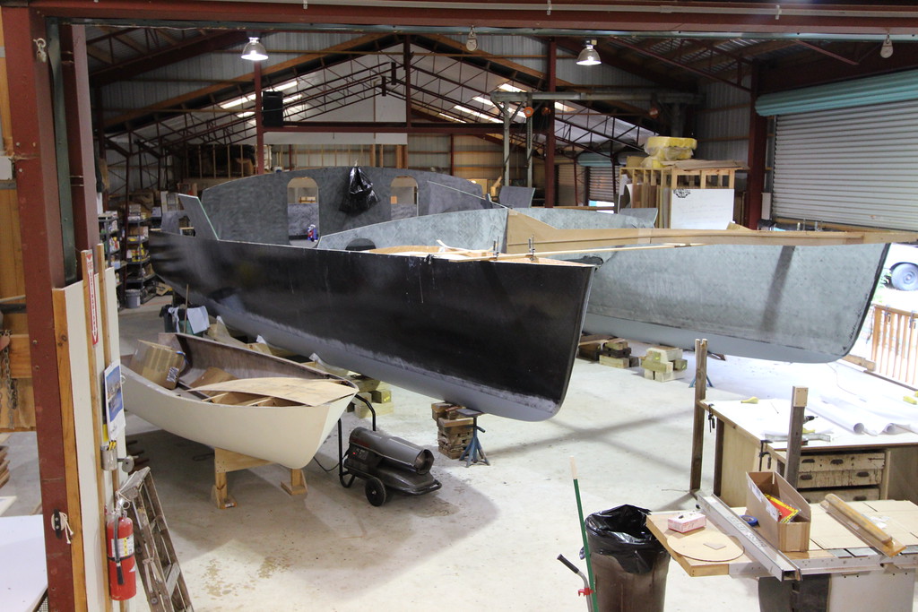

    The construction photos of the Chris White cat are really informative. What a clean design and build.

    I just recently got referred back to some older issues of ProBoat that had stacked up unread on my shelf,...And I found that article on Eagle. ...VERY INTERESTING rig design there. I'm sure Chris White has taken notice of it.
    1) 'cable rigging all the way to the very top (only 3), attached to a swiveling cap that would allow the wing mast to rotate a full 360 degrees'
    2) the very rigid carbon fiber, foil leading-edge mast section that accepts big compression loads without addition of spreaders, etc. "The solid D-shaped leading edge of the foil acts as the mast that holds up the entire rig, while the trailing edge is covered in a fitted cloth cover..."

    A few extra jpegs from Chris Whites 40 foot mast foil cats. I forgot to mention the basic sail area of the cat's 2 headsails is 700 square foot. Another White tri in an hour or so.

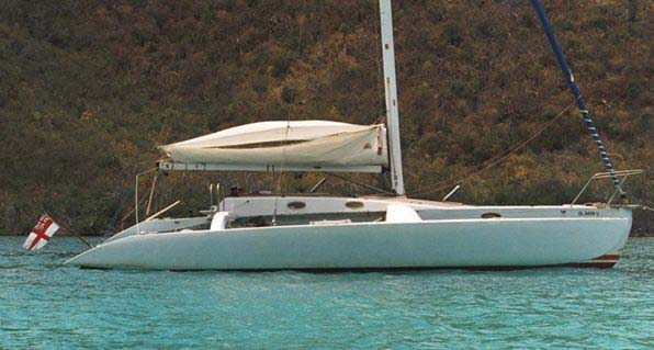

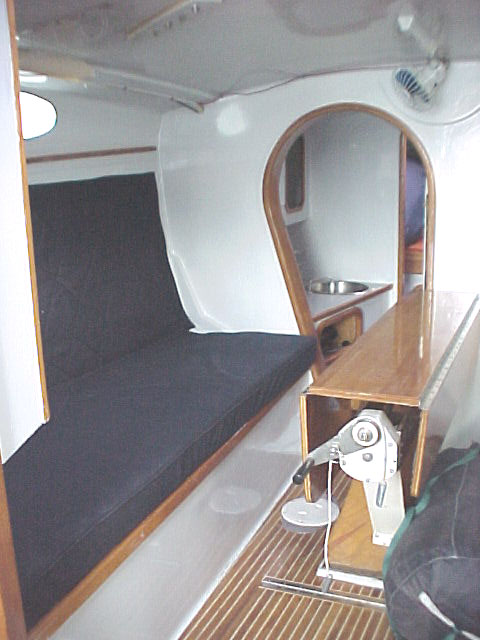

    The Chris White 39 trimaran is 39.75 x 28.3 foot weighing 7800 lbs with a 50 foot aluminium mast with a 550 square foot mainsail and 330 square foot jib. The tri has a small stub keel and a daggerboard. The floats are removable for overland transport.
    The tri was designed and built in 1995. Construction is epoxy composite, cedar core with unidirectional glass/epoxy skins. The engine is under the cockpit a Yanmar 3GM30 (27HP) Diesel Fresh cooled with a Martec folding prop. The ground tackle is a 33lb Bruce anchor, 20’ 3/8 chain, and 5/8 nylon rode.
    The Chris White 39 is a high-performance, comfortable cruising trimaran for two to four people. Designed to be owner-built, she is dismountable for easy highway transport from one cruising ground to another. The fractional rig has been set up for short handed sailing, with all controls leading to the cockpit. Performance is high on all points of sail due to an efficient underbody configuration and sail plan. This is a light and fast with a clean, liveable interior. She is very fast, seaworthy and easily handled and has sailed at 17kts the length of Biscayne Bay.
    Chris doesn’t sell this design any more but it looks a good fun boat. The jpegs give the idea.

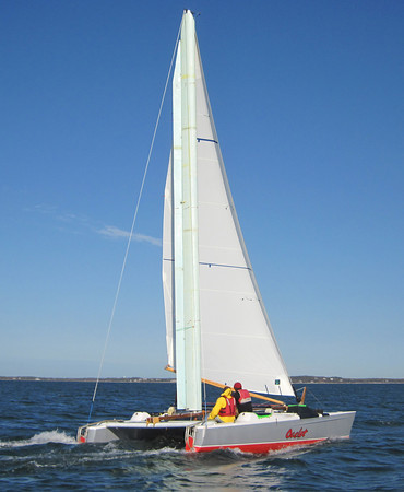

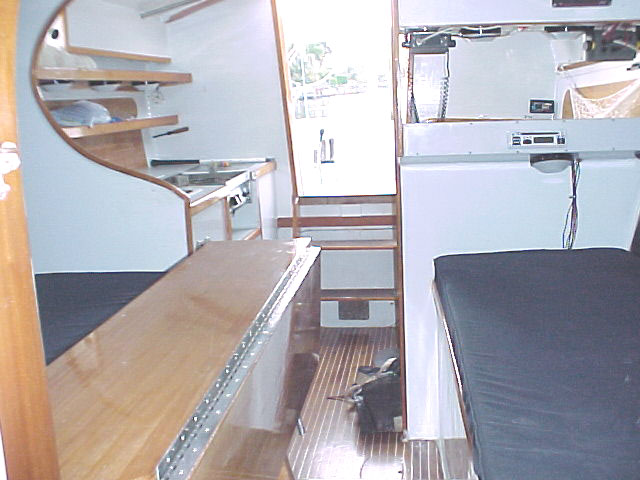

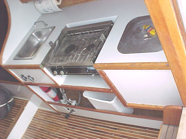

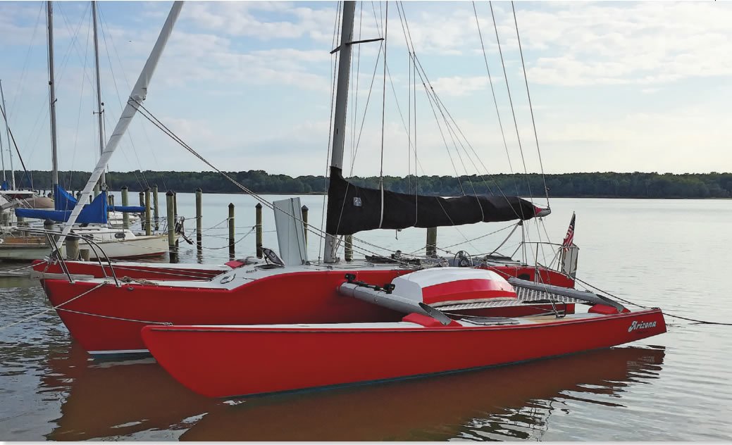

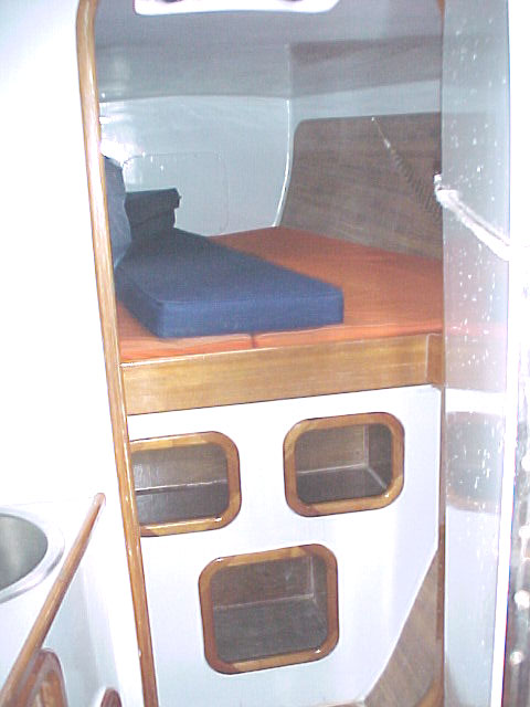

    There is a certain type of boat that frustrates the hell out of me. They are smaller simple tri’s like the Seaclipper 28 by John Marples and the Explorer 34 done by Chris White in the early 1980’s. Both are simple, easy to construct tri’s that sail very well from reports (I have sailed on a SC 28) BUT they have accommodation for one or 2 really good friends. This is the type of boat that Catsketcher has problems with also, the light long lean “cruising” boat where you buy all the things you would need to build and fit out a 28 or 34 footer but end up with accommodation of a 23 foot cat. Sorry about that. Both of the tri’s are excellent ocean capable boats, that as I said, sail very well.
    The Explorer 34 is 34 x 24.3 foot weighing between 3200 to 3800 lbs depending on construction and capable of carrying 1200 lbs to 1500 lbs of payload. It carrys a 360 square foot in main with a 205 square foot jib and up to 800 square foot with genoa’s etc. The mast is 40 foot aluminium tube carrying the fractional rig. The main hull is 9:1 and the basic boat has a Bruce number of 1.52. This is a potentially a very quick boat if it has a good rig on it. The engine can be an outboard or EG Westerbeke 12hp inboard.
    The 34 is built with constant camber (variation of double diagonal ply). The hulls are 3 layers of 3 mm western Red Cedar or ply with minimal stringers as it uses the internal furniture EG shelves, bunks, seats, floors, cockpit etc act as the support structure. The bulkheads are 9 mm ply that are filleted and taped to the hulls. The gunnels are 75 x 19 mm. The cross beam tubes are aluminium 250 mm outside diameter. The floats are bolted to the cross beam and the beams are held in place by 2 shear pins. The tri can be disassembled for transport. The original 34 was built in 8 months part time. A well organised builder who had a good simple design to build.
    As you can see from the jpegs this is a simple boat that will serve you well if you have simple cruising requirements.
