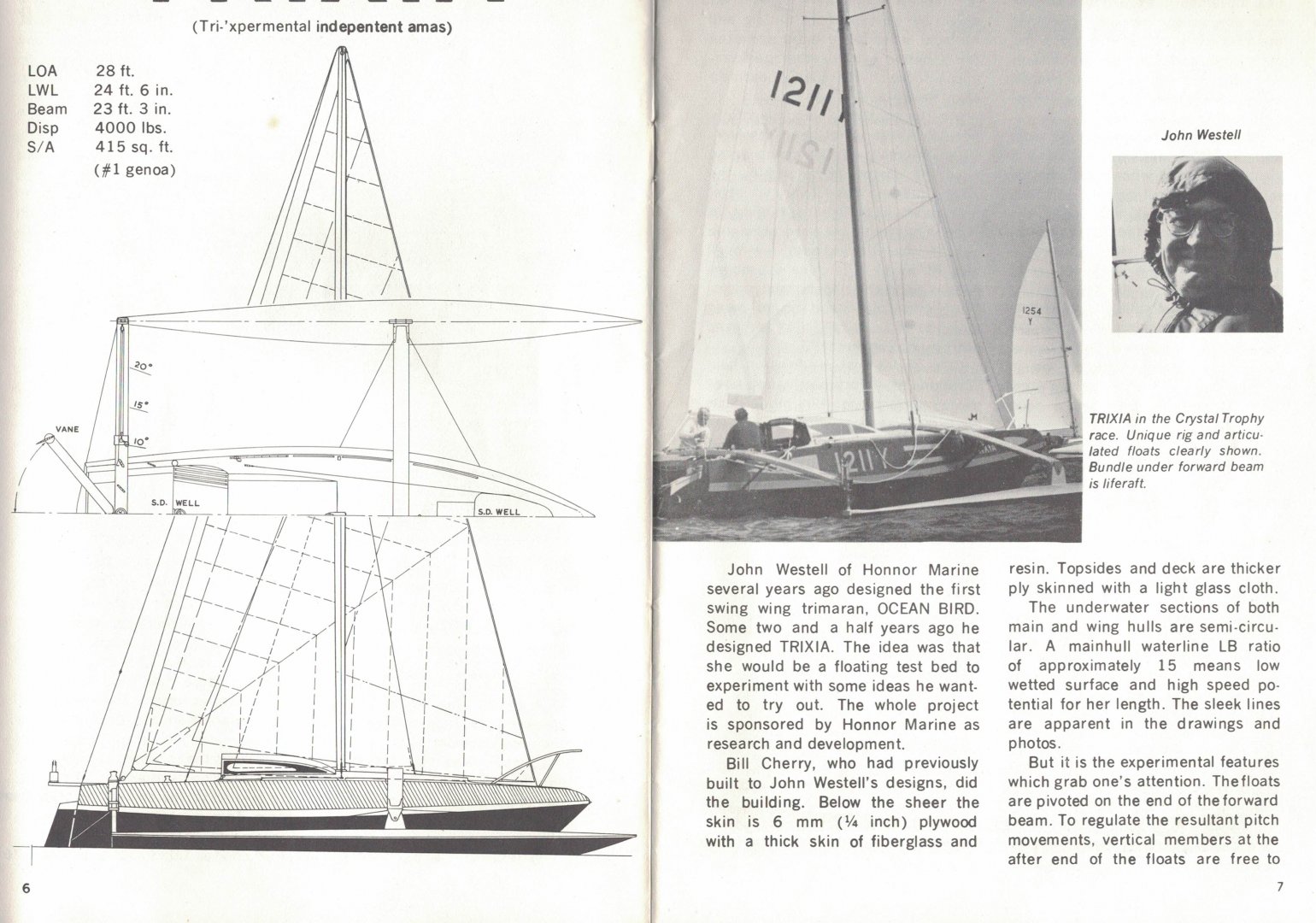

    Trixia is a John Westall design (designer of the 30 foot Ocean Bird swing wing tri). The tri is 28 x 23.25 foot displacing 4000 lbs and carrying a 39 foot mast with a 415 square foot genoa in a headsail only rig. There are 3 headsails and a storm jib to reduce sail area. The headsails can be sheeted from 8 degrees to 23 degrees on the rear cross beam by sliding track blocks. The main hull length to beam ratio is 15:1 with semi circular underwater hull shape. But the real interest in this design is the articulated floats. The floats pivot on the main cross beam and have a slide arrangement on the aft crossbeam to allow the float to partially pitch independently of the main hull. The same concept was used by the Gougeons later F 40 trimaran Adrenaline.
    In the 1970 Crystal Trophy Trixia finished fourth and in the 1970 Round Britain Race the boat was fast but suffer structural problems and a backstay failure on the second leg. John found a single headsail rig was fast as long as you could use wide sheeting angles for reaching etc. The rig requires rod rigging and a stiff mast to minimise sag in the forestay. The articulated floats worked well but needed an interesting wrinkle. The aft end of the float required soft “springing” (control) in light weather but hard “springing” in heavy weather so the floats could respond to waves as required. If the float has rapid response to small waves in light airs it created more drag than if the float moved over the seas at the same rate as the waves. Adrenaline also had a “wooden” variable spring to control float movement.
    Trixia is built from the sheer down is 6 mm ply and double diagonal ply for the lower hull of 6 mm with a heavy glass cloth covering. The deck is thicker ply with a lighter cloth skin. The cross beams are multiple layers of timber with water stays to add strength.
    The final jpeg is of Trixia after it had been modified to a more conventional float and rig configuration.

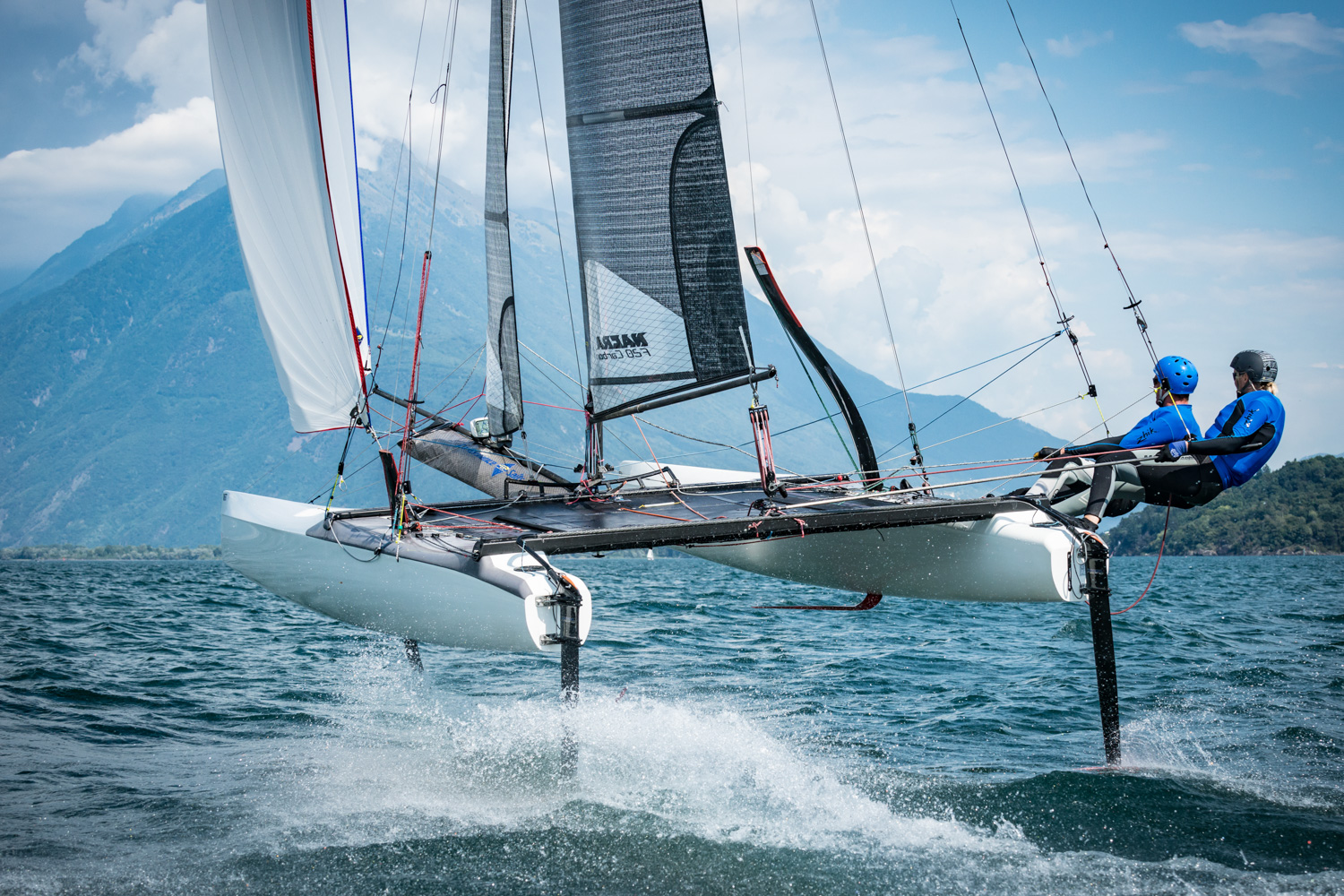

    A short one. The following PDF is an owners manual for Nacra's 20 foot foiling catamaran setup, maintenance and sailing. This is the "foiling" PDF which is in addition to an owners manual. This is a serious foiler and the manual gives many safety warnings about your health if you don't sail the boat correctly. Page 22 has warnings about how to care for carbon fibre foils which include lines like do not allow them to heat up to much as above 65 degrees C the foils can potentially deform or have CF degradation etc. Informative.
