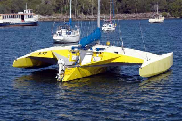

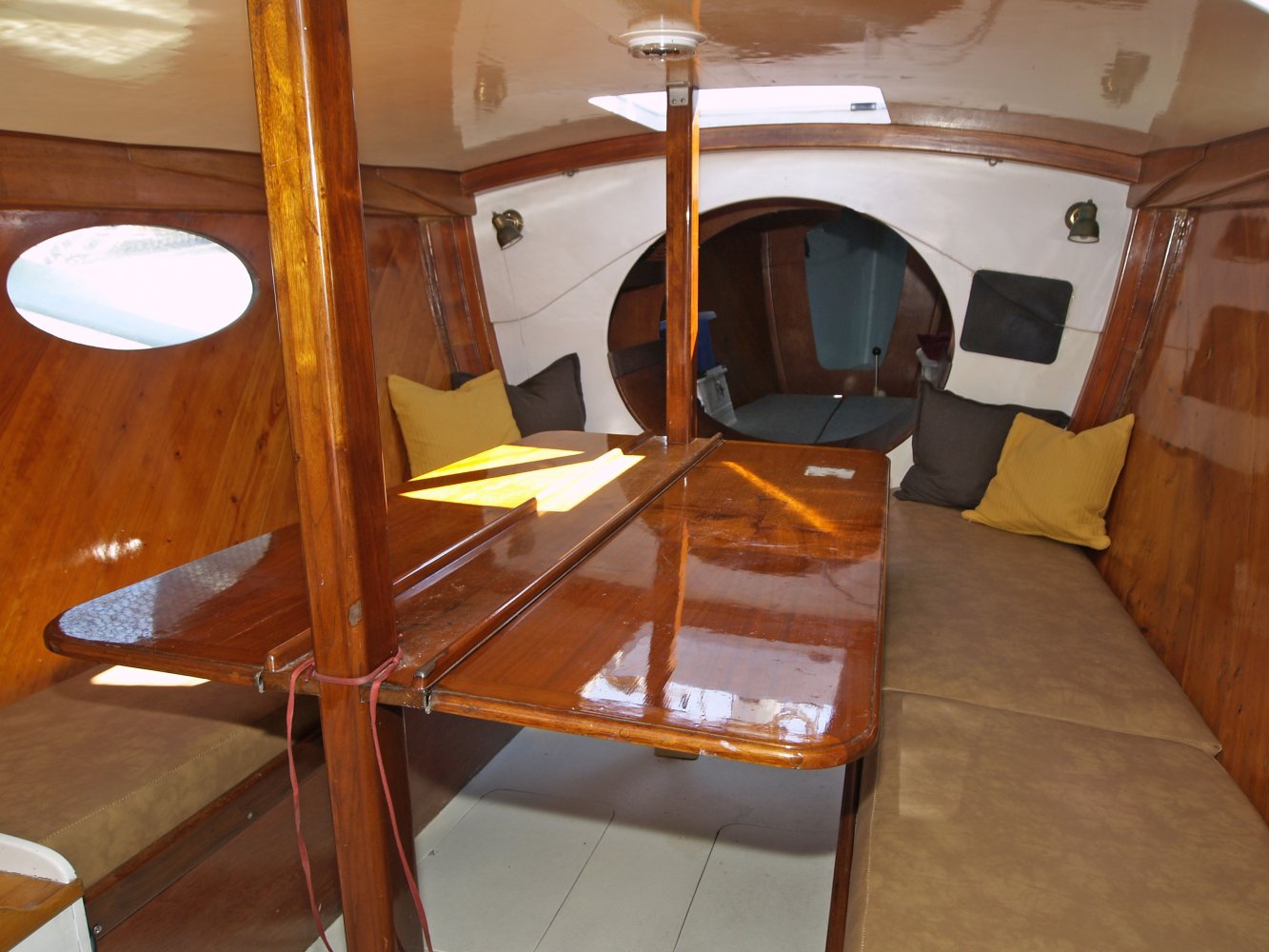

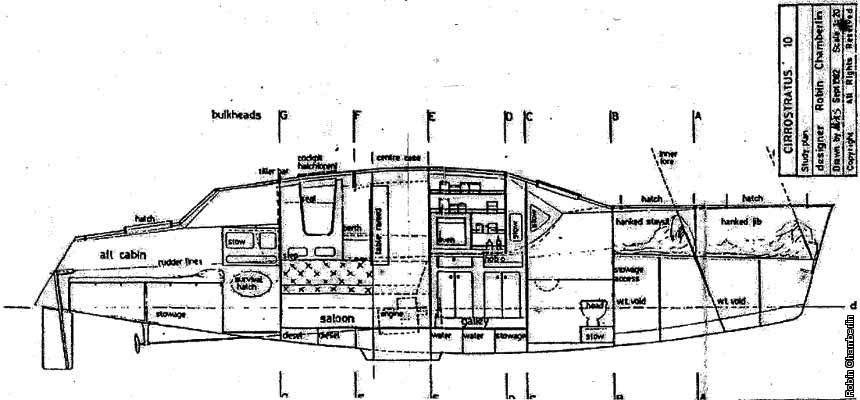

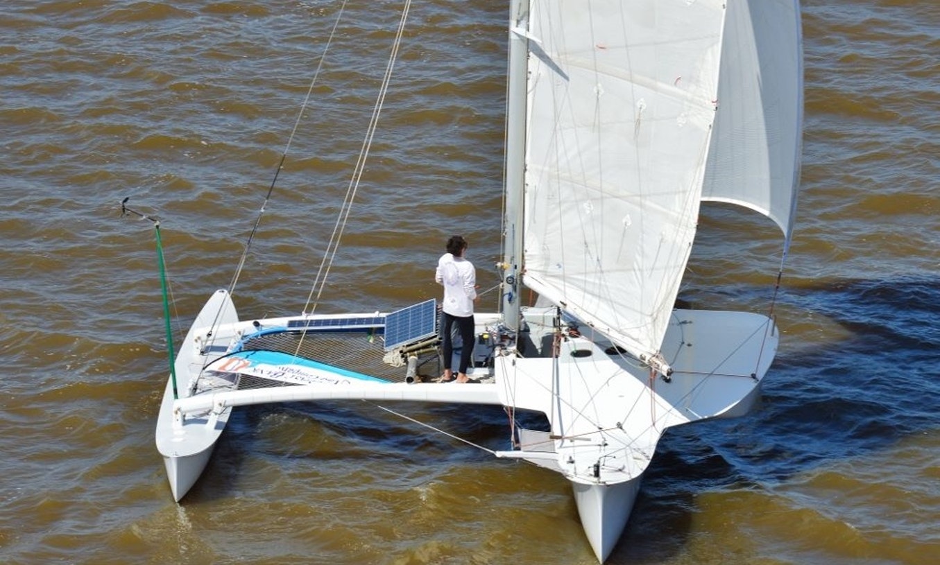

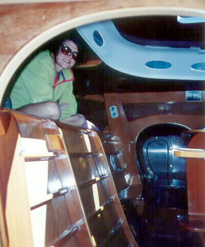

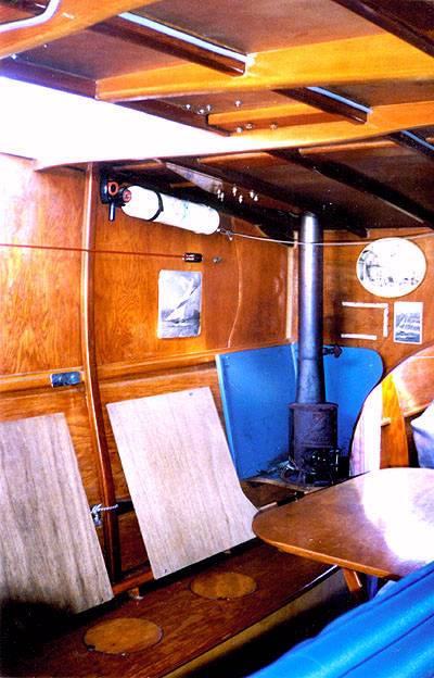

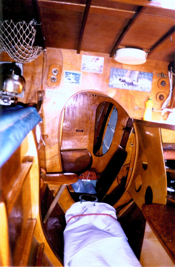

    Cirrostratus tris is interesting because its interior room is is quite surprising for such a small tri. The accommodation is also liveable mainly due to the 2 separate cockpits either side of the saloon seating on the wingdecks. This tri is 32.8 x 26.3 foot weighing 3100 lbs and displacing 5500 lbs carrying 590 square foot in the main and foretriangle. The tri sails well having done many sea miles. Many have been built some in ply timber others with foam glass hulls and ply decks. The ply versions are mainly built with 6 or 7 mm ply on 36 x 19 mm stringers at 150 mm centrelines. Frames are 75 x 19 mm backed with 6 mm ply in many instances. The crossbeam structures are fully integrated with the wingdeck structure which provide excellent rigidity for the overall boat. This is a well thought out design, structure and accommodation layout in a tri that sails really well. Only one boat has had any real problem when a float fell off. The boat and float were recovered, repaired and is still sailing. No clue what the problem was. 2 people could really live in this boat and it would be a more comfortable cruiser than a Buccaneer 33 due to the extra internal space.

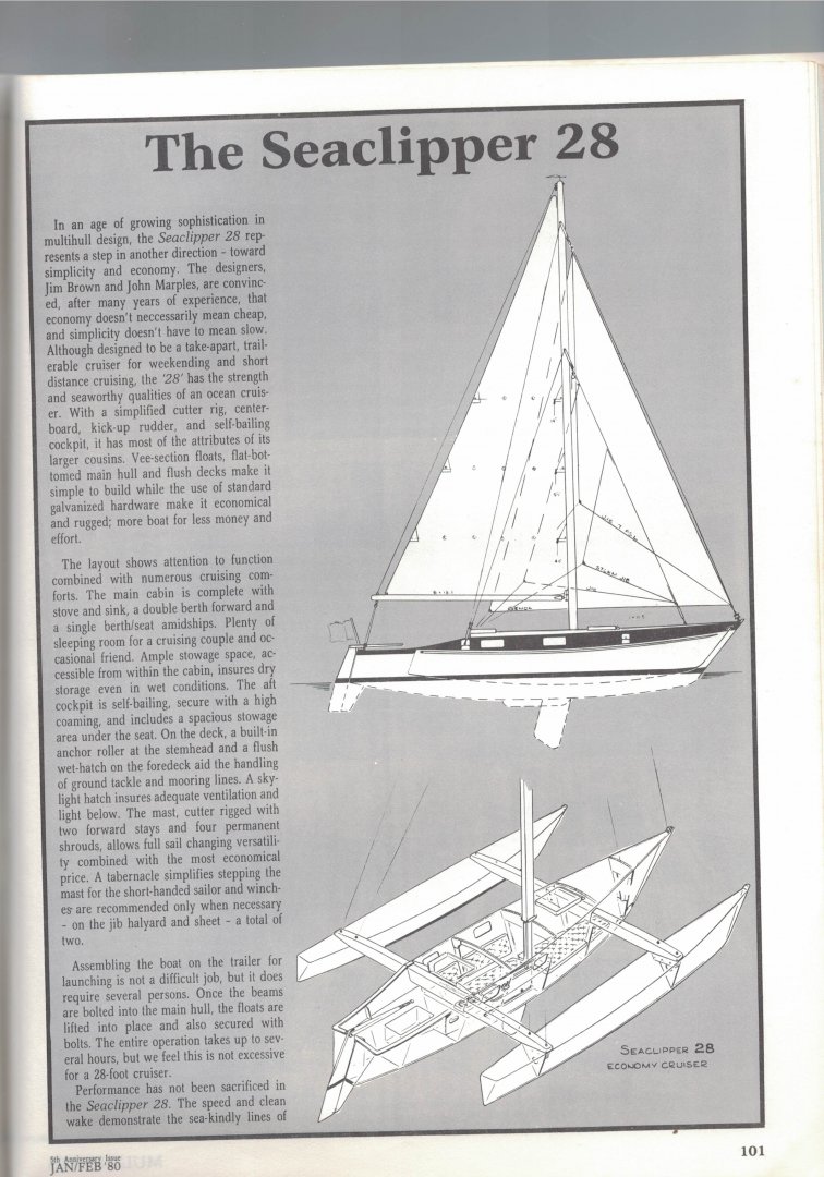

    A follow up on the Seaclipper 28 with a more detailed description and some build photo’s. Another item will be coming in an hour or so.

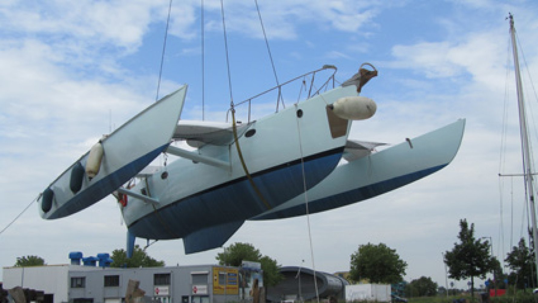

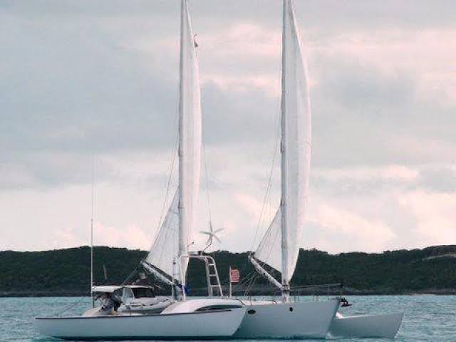

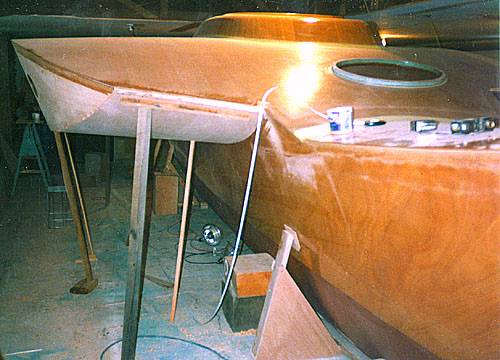

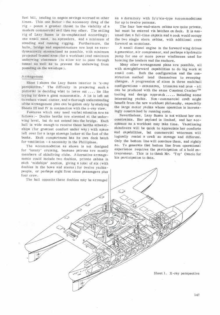

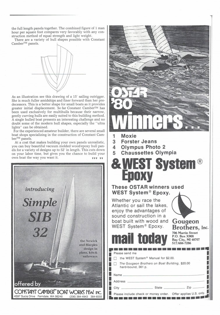

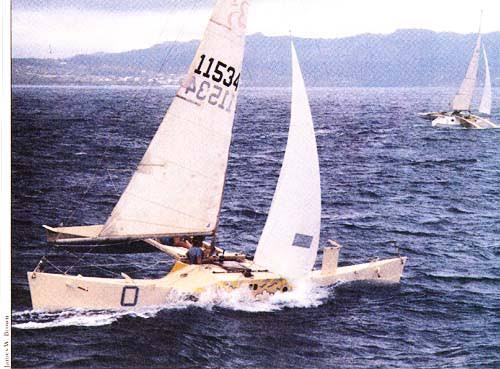

    This is the first of 2 items about one of my favorite sailing boats. Juniper is a 52 x 30 trimaran that was designed to weigh 13500 lbs and carry in its original free standing ketch rig 975 square foot. Chris White the designer commented that “Juniper is long in order to provide comfort sailing in the ocean, wide for stability in extreme conditions, but simple in construction, accommodation and systems. She’s an excellent performer, and has a very comfortable motion in waves”.
    The concept of the Juniper 2 is a new design incorporating several refinements and improvements from her predecessor. She is wider overall, has a longer and finer bow, and uses a balanced spade rudder instead an outboard hung rudder. Aesthetic details such as the crossbeams and their fairings and the sheer line were refined. The hull underwater shape has less wetted surface than the original and the fin and rudder sections were refined for less drag. The interior layout was refined to increase elbow room and now incorporates a dedicated shower stall. Incorporating a ketch rig that is an absolute joy to handle, tacking is a matter of just turning the wheel. The crossbeams are very high above the water and there are no cabin projections beyond the hull sides. These features eliminate pounding in rough seas, contribute to her comfort underway, and was designed and built for safety and survivability offshore. Her interior and exterior finish is excellent. All systems and equipment were installed and have been carefully maintained and upgraded with an eye for simplicity, reliability and serviceability.

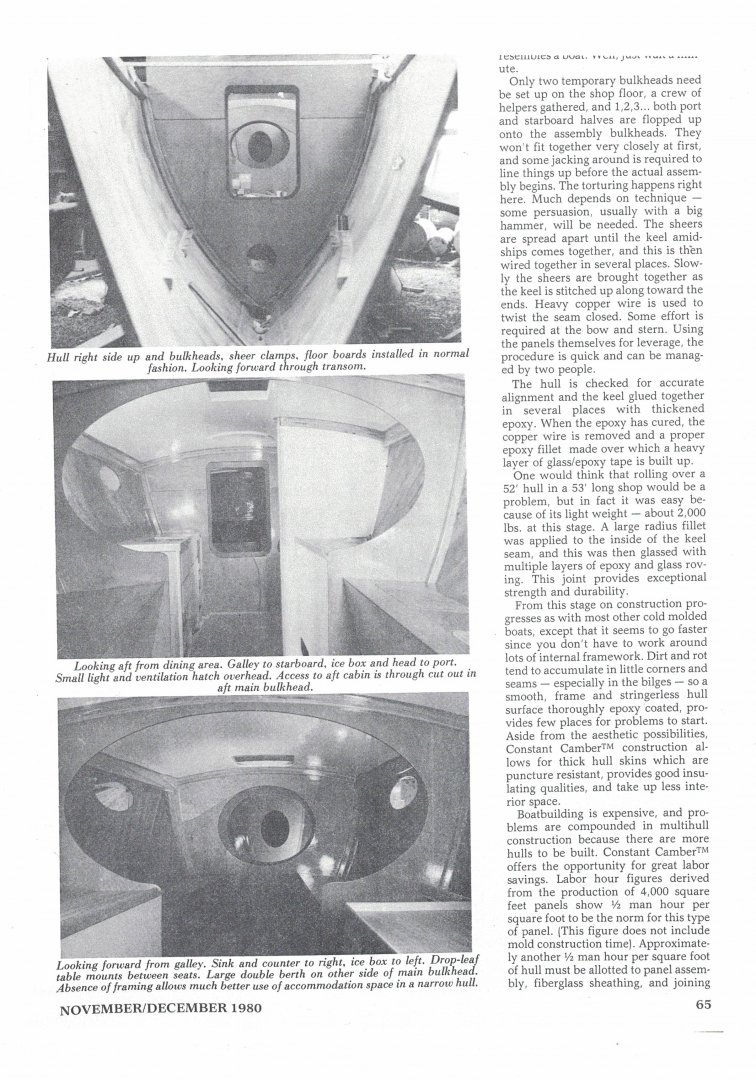

    The original Juniper was built using constant camber approach which is a thick hull panel with minimal hull framing. How thick, 25 mm of moulded cedar (more details in next item). This produces strong long lived hulls. Juniper was built in 78/79 and circumnavigated the globe 6 times without any major or minor repair. Its rig was replaced to improve its performance not because of any issues. Again Chris White comments "Two different rigs were tried on Juniper 1. An unstayed cat-ketch rig and a more powerful stayed ketch rig with rotating spars. Each has its advantages, but in a nutshell, the stayed rigs can be more powerful although they are more expensive and require more attention to sail".
    When Jim Brown and Mark Hassall were invited on Juniper's maiden sail, here is what Mark wrote about his experience with the flexible, unstayed rig: "Though we spent the better part of the day trying to find wind. Late in the afternoon, the wind found us. The free-standing masts suddenly bent at an alarming angle and then twanged upright again. Juniper shot forward at such an incredible speed that we all grabbed at whatever was handy to keep from falling overboard! "17 knots!" yelled Chris. "My God, she went from 0 to 17 in a couple of seconds! Have I got a boat or have I got a boat?" ..........."It's no boat," I yelled. "It's a goddamned slingshot!"
    Juniper is a sensible fast boat that is relatively easy to sail but it is a very big boat with limited accommodation. It would be a good live aboard for 2 people. Chris White owned Juniper for 17 years, lived aboard for years and sailed it far and wide.

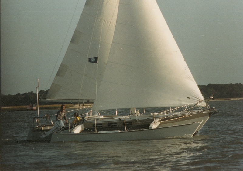

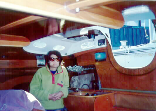

    Carisa is the second version of Juniper known as Juniper 2. It is 54.5 x 31.5 weighing 14000 lbs and carrying 900 square foot of sail. As one person said ”Carisa is HUGE on the outside & small on the inside. They never got it all painted at once, it was so large. They would be back in the yard doing more painting, every other year. Also, the free standing mast were Chris White's originals. They required sock sails that were VERY hard to raise, and the mast required reefing early due to bend. (a spinnaker was risky too for this reason). Carisa easily sails 9-10 knots with wind speeds of 15-16 knots. With decent sail conditions she will easily make 200+ mile days. In a flotilla she will out sail every boat except performance catamarans and 65'+ racing mono-hulls.”

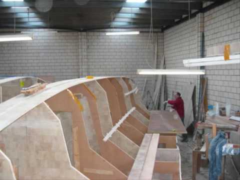

    Hulls and decks are vacuum bagged triple diagonal Alaska Yellow Cedar 6 mm, 12 mm, 6 mm constant camber using WEST System® epoxy resin with glass/epoxy exterior skin. Crossbeams are epoxy laminated Douglas Fir and marine plywood. Freestanding ketch rig provides effortless tacking and superb offshore reliability. Tapered hollow wood/carbon fiber epoxy masts 55 foot high of deck, 310 mm diameter at deck tapering to 105 mm at the mast head. Mainsail and mizzen (450 sq ft) by Haarstick Sails, 2008, Dacron cloth. 3 x reef points, fiberglass battens, rugged construction details, sleeve luff. Mizzen staysail (500 sq ft).
    More details of the original build of Juniper is in the attached jpegs. The most important aspects of this sort of building is it does not require quality timber just light timber as the vacuum bagging and epoxy will fill any voids in the moulded timber layup. Second it leaves a clean interior without any stringers and minimal frames. Thirdly once set up the process of building a large boat hull structure is relatively fast. But the rest of the fit out electric’s etc will take the same time. The photo’s will give an idea of how clean the interior is. Finally this boat is light for its size, the reason it is fast with such a small sail area.

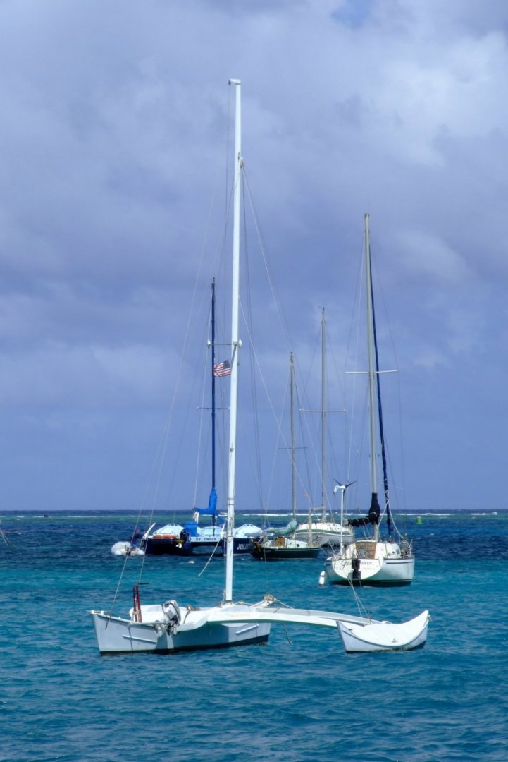

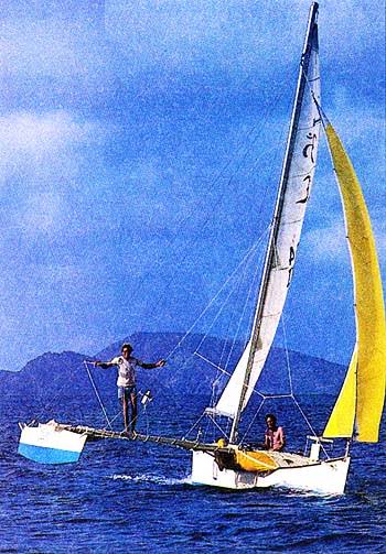

    A proa is a controversial boat not helped by the difference of opinion between Atlantic and Pacific proa types. Rob Denny has heavily promoted his version of Atlantic proa’s, the Harryproa. They are fast, light and effective. The major voice for modern Pacific Proa’s is Russell Brown son of Jim Brown. Russell built 4 Pacific proa’s. His first was a 30 foot $1000 (yes $1000 for the complete boat) Pacific proa called Jzero. According to Russell it was a 1000 lbs displacement pile of junk built from 6 mm ply, stringers and frames lightly filleted and taped together at chines and joints in pods etc. The crossbeams are 5 layers of 19 mm x 90 mm fir tapering at the float end. It has a second hand rig etc. Not much room but a fast proof of concept. This “pile of junk” is now 30 plus years old with improved cross beams and as still sailing a few years ago.
    Next came Jzerro a 36 foot ocean crossing (USA to Australia and return some single handed) Pacific proa. Russell Brown comments on the 3250 lbs weight Jzerro. “One major attraction for me of the Pacific proa is that the concept is, in my mind, as close to structurally perfect as a multihull sailboat can get. In flat water, a proa can be sailed as hard as possible and the structure stays very lightly loaded. Yes, there’s a bit of mast compression (but not much, because of the wide staying base), and a small amount of bending load on the beams, but most of the sailing loads go to the shroud lifting the outrigger. Adding water ballast in the outrigger doesn’t load up the structure very much, and because it is so far to windward, it doesn’t take very much ballast to keep sailing flat.” Russell rarely used the water ballast option.
    Jzerro was built in Port Townsend, WA and launched in 1994. This boat has many similarities with my previous proas, but was lightly and carefully built. In the fall of the year it was launched, Jzerro sailed a sustained 22 knots on the way to a race.
    Jzerro will reach at 17 or 18 knots in 12 knots of wind. On an Australia to New Zealand trip Jzerro did 1050 miles in 6 days with 750 miles of it to windward. When going downwind in lots of wind, the main is down and just a jib or genoa up. This makes the steering easy (autopilot) and plenty of power. I averaged better than 10 knots this way from the Cook islands to Fiji with just a working jib.
    Jzerro is now available for charter in New Orleans and its current owner on May 8, 2018 raced in a 555 mile effort along the coast of the Gulf of Mexico. Starting in Pensacola, Florida to Isla Mujeres, Mexico, which is just off the coast of Cancun. After being neck in neck throughout the race, he beat a Corsair C31R Trimaran winning line honors and his class (MultiHull). He was the first to finish with a finishing time of 71:43:08.
    The only real weakness for the average sailor is its rig. The rig is powerful BUT if the boat is caught aback due to its minimal staying on one side of the boat the rig can be blown of the boat. This is a problem with most wire rigged Pacific proa’s. This is the reason why Harry proa’s have free standing rigs. So why didn’t Russell use a freestanding rig, his words “Yes, a cat ketch rig with free-standing masts has appeal. A rig like this would be easier to tack (especially with wishbone booms), and less vulnerable to being caught aback, but the compromise in performance, especially upwind, is not attractive. Jzero raced against Azulao, a 42’ Atlantic racing proa, and was about 18 hours ahead at the finish. Azulao was faster reaching in breeze, but didn’t come close upwind.”
    After Jzerro Russell built a 37 foot proa Kauri and a 38 foot proa called Cimba for friends. Russell is not interested in doing any designs of proa’s and leaves that to others. We will discuss their construction in the next item. Jpegs give idea’s of the boats.

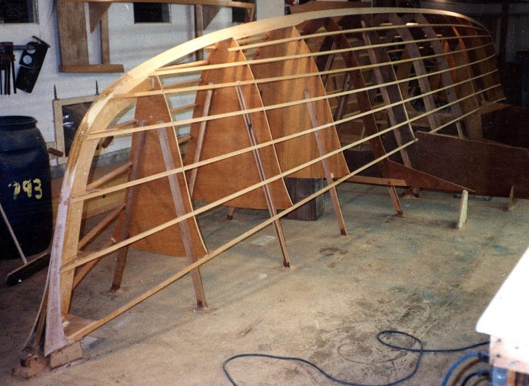

    Jzero the 30 x 19 foot 400 lbs weight, displacing 1000 lbs, carrying 175 square foot of sail proa was Russell Browns first “modern Pacific proa” built in 1978. This boat survived three 100 knot hurricanes during Russell’s ownership and at one point they used a pair of pants weighed down to slow the boat in heavy seas. Not bad for a junk boat. There is a Jpeg of its “interior” enough for a 17 year old when Russell built the boat and a jpeg of the boat in 2000.
    Next came Kauri a 37 x 21 foot boat built in about 1985, weighed 3600 lbs. Kauri’s hulls were 9.5 mm sheet plywood tortured into shape over stringers and frames. The internal room of this boat was a significant improvement over the 30 foot Jzero.

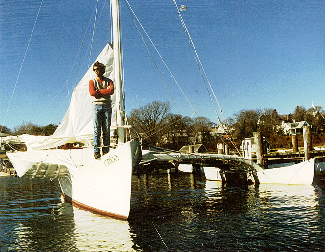

    A friend Lew McGregor asked Russell to design and build a proa for him. Russell in about 1989 designed and built Cimba. Cimba is 38 x 26.25 foot weighing 4350 lbs carrying 600 square foot in a main and genoa. The main hull length to beam is 13.5 to 1 and is symmetrical. The hull halves were built of 4 layers of 3 mm WRC covered with 200 gsm 90/0 cloth in epoxy. The hull halves were slightly tortured into shape. The keel line is carbon powder/epoxy fillet glassed over inside and out. Gunnels are placed in the hulls. There are no stringers or intermediate frames, only bulkheads at crossarm points and fore and aft crash bulkheads. Cross arms are timber plywood box structures. According to Russell if Kauri and Cimba have very similar performance. Cimba was sold and renamed Pacific Bee. The new owner, who is an exotic racing monohull builder, was planning to design and build a 53 foot version from 5 layers of 3 mm WRC.
    Russell then in about 1994 decided he would build what was his final version of a Pacific proa Jzerro. Jzerro is 36 x 21 foot weighing 3250 lbs. The main hull is slightly asymmetrical and more rounded than Cimba’s requiring a wooden keel structure. It carries a 36 foot rotating aluminium wing section mast 95 mm x 190 mm (another report says 200 mm), and weighs 160 pounds with all standing and running rigging. The sail area of main and genoa is 600 square foot. Jzerro was built from 2 layers of 4 mm ply covered with 200 gsm cloth in epoxy over 19 x 32 mm stringers at 150 mm centrelines, frames and bulkheads at point of cross beams and crash bulkheads. The pods on all his 36 foot plus designs carry a double berth and serve the very important function of providing stability to 90 degrees if the proa is caught aback. The cross arms are timber plywood boxes. The cross arms were strengthened with carbon fibre in Australia after Jzerro broached on a bar entrance flexing the cross arms as it was pushed down the waves float first.
    These boats are very fast in the right conditions (22 knots plus is not unknown) but need good seamen to sail them offshore. The jpegs give an idea of the structures and internal space.

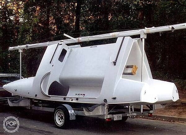

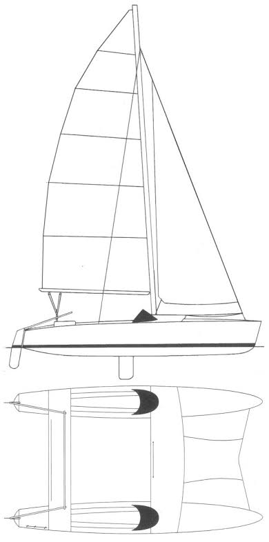

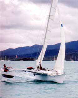

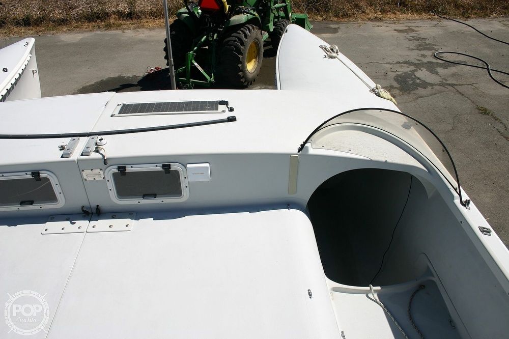

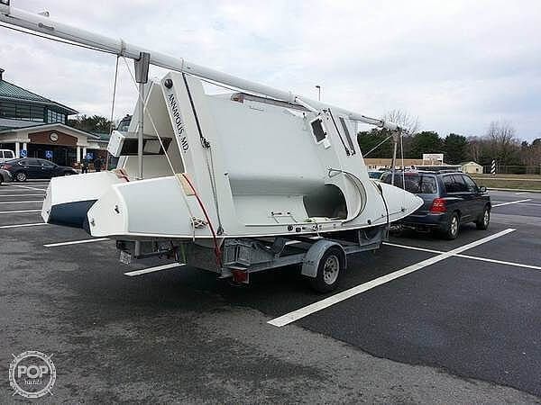

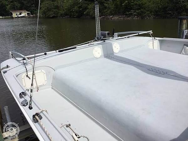

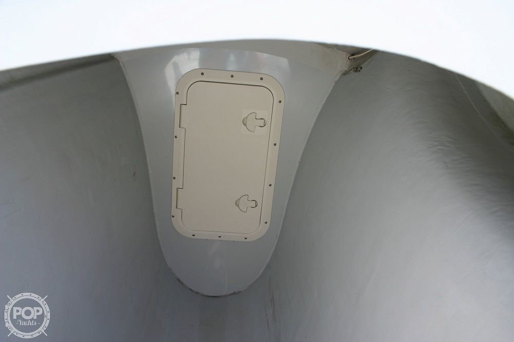

    A small discussion about the Mainecat 22. There were only 16 of these boats built in the mid 1990’s. The trailable cat is 22 x 13 foot capable of being folded to 8.5 foot. The cat weighed 1750 lbs and was capable of taking a maximum 1200 lbs payload for a total maximum displacement of 3000 lbs. The rig is a sloop with 270 square foot of sail. The headsail is on a roller furler and tacks to a wire bridle. The jib is self-tacking. The designer of the boat is Richard Newick and was assisted by the builder Dick Vermeulen of Mainecat. Richard Newick also built the plug for the Mainecat 22.
    The Mainecat 22 has both pivoting centerboards and rudders. Draft, with all appendages up and the boat loaded, is 11 inches. There are four watertight compartments accessible for stowage. There is a Porta Potti located in the port hull, exposed but convenient. The biggest feature that separates this cat from other small cats is the rigid bridgedeck, which gives the 22 the feel of a bigger boat. The cockpit extends down into the hulls, providing comfortable seating for daysailing. The cuddy cabins are ideal for storing the camping gear and keeping it dry.
    The Mainecat 22 has a light helm and is capable of holding 15 knot speeds for short periods. It is an allrounder according to various owner reports. The cat can be setup or retrieved in under an hour according to owners. The trailers for carrying the boat require special beds to support the boat but they can be created at home. I do not have any build detail beyond it is foam glass and is structurally good. The folding hinges are on the bridgedeck and look very strong. A very nice idea that provides a great daysailer.
