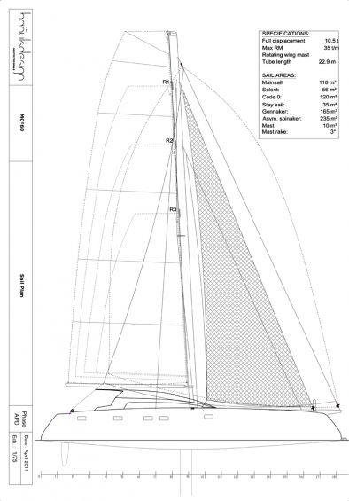

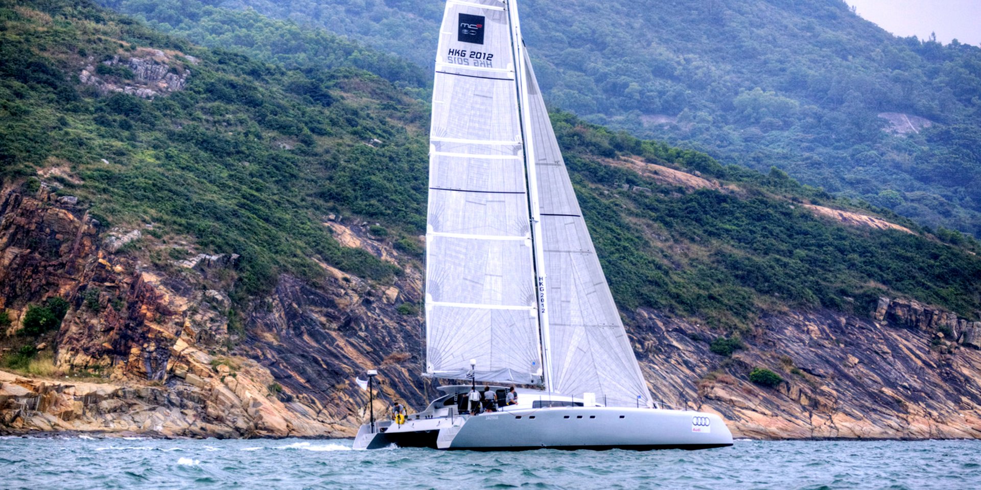

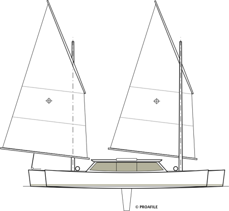

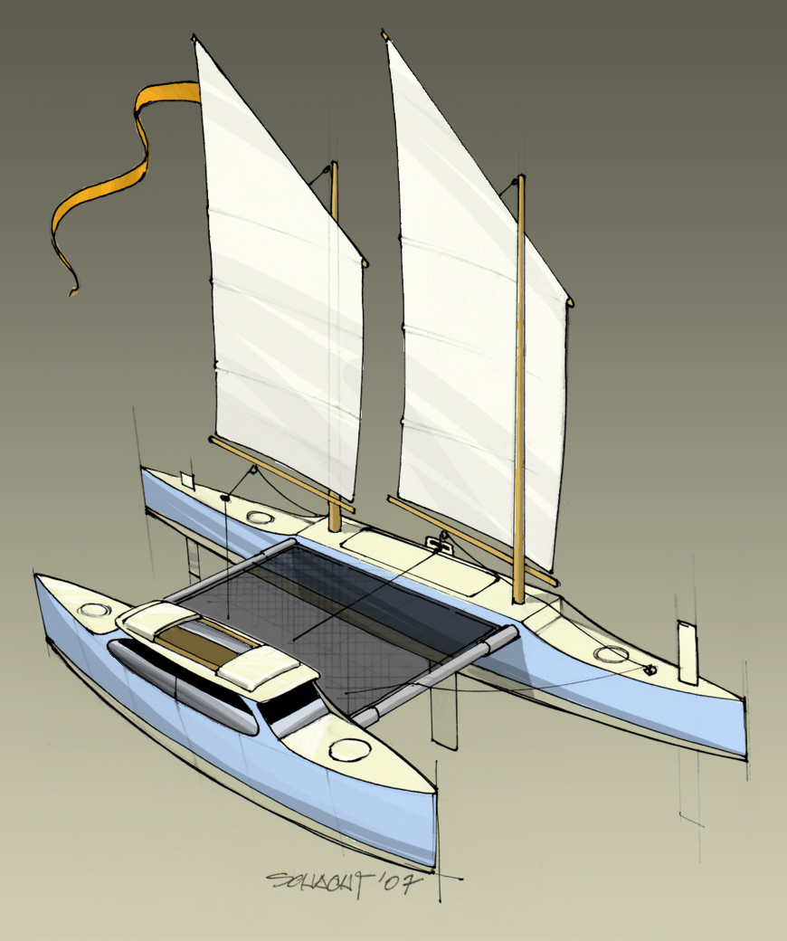

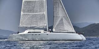

Old Multi, I'm not convinced that a tall single rig is lighter than a lower double rig, especially so if set up on a catamaran, because as you say, a single has to have beefed up base and dolphin strikers for main and forward beam - whereas the double rig is mounted on simple ring frames with carbon in the secure and stiff main hulls - which is considerably lighter than spread metal/stainless/carbon dolphin striker setups. But major point is that the double rig carries considerably larger sail area than tall single rig, and it is lower so masts do not have to be reinforced to the same extreme. More power is good?
Talking from experience with smaller scale 5.5 metre Cox's Bay Skimmer, (a wide and very light monohull with rudder and dagger lifting foils) the small chord wing masts weigh much lighter than you would think, can't remember exact figures at moment but I can mount and hoist them on my own - and they are probably lighter than a tall single rig, but not by much. The old argument that double rigs are less efficient to windward is incorrect - especially so if your double rig has aerodynamic and rotating masts. And again especially so if comparing to tall FIXED setups ... plus off wind the double rig is faster, large sail area carried lower. Common knowledge?
