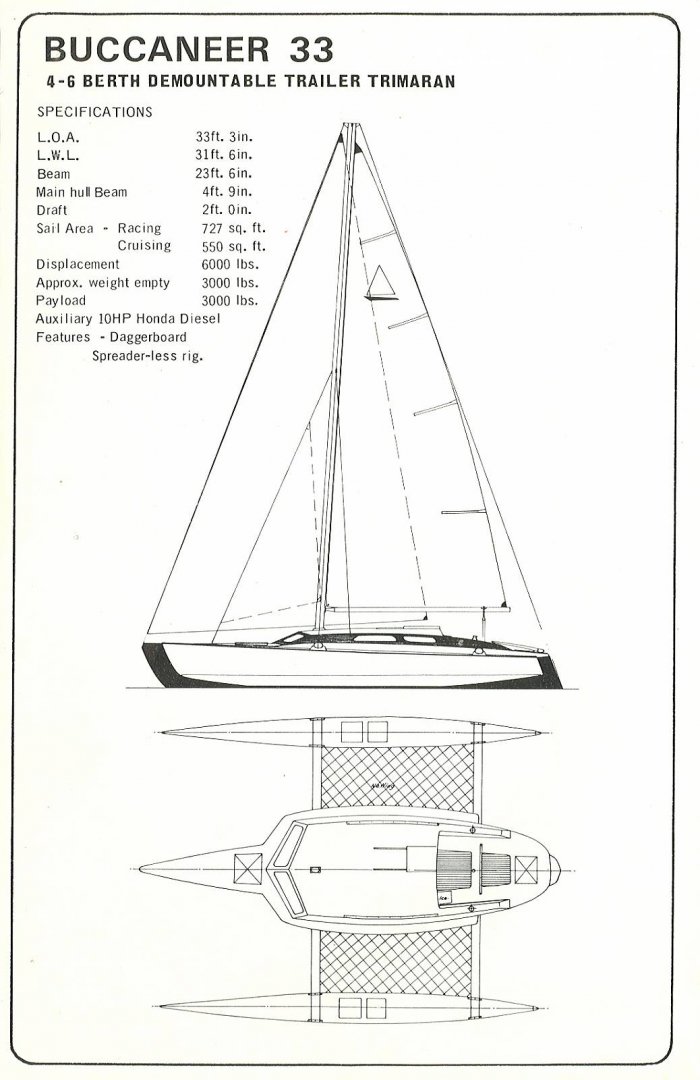

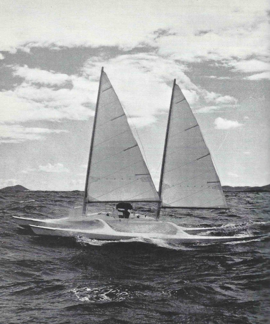

So, let’s talk about the Buccaneer 33 trimaran by Lock Crowther which displaced between 6000 and 8000 lbs depending on who built her. The option of choice for home builders was the Canberra light post section (E8150) which was an oval shape and was 203 x 140 mm with a 4.8 mm wall and ribs inside (it was used for lamp posts and was cheap) and a weight of about 5 lbs/foot. You then had to add a sail track for the mainsail which added more weight. The mast head rig of the 40 ft mast was stayed from the mast head and mid point of the mast.
Lock allowed owners to use lighter yacht mast sections with an integrated sail track if they put diamonds on the mast. The yacht mast could be EG a 202 x 122 mm section with no ribs that weighed 4 lbs/ft. The diamonds added weight but the lighter masts were still 50 to 60 lbs lighter overall.
On another 42 cat, that displaced 16,000 lbs, was originally specified with the E8150 203 x 140 mm mast, 55 foot high, with a 3 spreader rig. The final launch version mast was a 60 ft Alspar LP6 section of 210 x 122 mm section with an integrated sail track that weighed slightly less.
The Buccaneer 33 had a righting moment of 84,000 ft/lbs. The 42 foot cat had a righting moment of 176,000 ft/lbs but both boats used the “same” mast sections. The difference was the amount of additional support on the cat of the 3 spreaders and EG inner forestays and runners used to support the mast and reduce unsupported mast columns. Translation, the E8150 mast section is used in the tri as a strong mast with minimal stays carrying 727 square foot when racing. The E8150 mast section is used in the cat as a fully supported mast with spreaders and stays carrying over 1100 square foot when racing. PS. The 42 foot cat eventually had a 65 foot carbon fibre wing mast with increased sail area put on it. It averaged over 22 knots for over 4 hours in one ocean race.

The limited jpegs are of the Buccaneer 33 and the 42 foot cat original mast and modified wing mast.

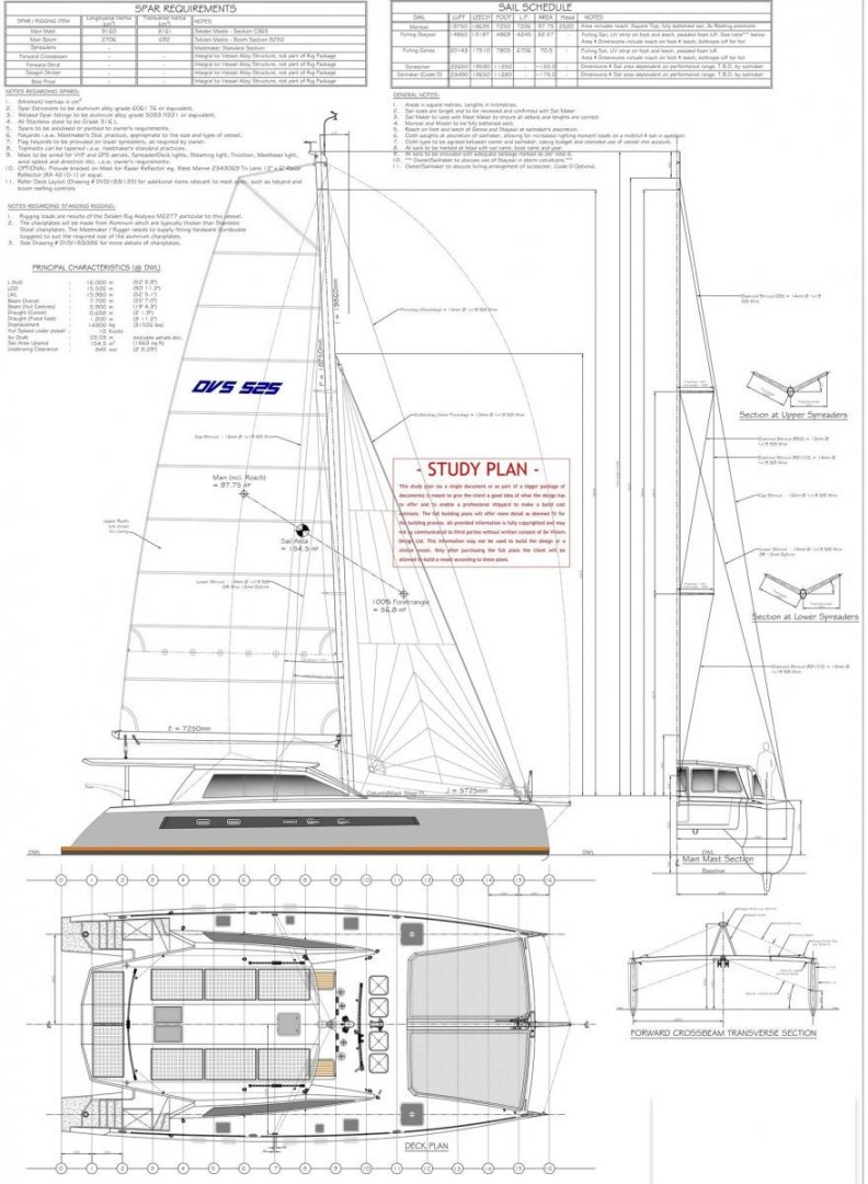

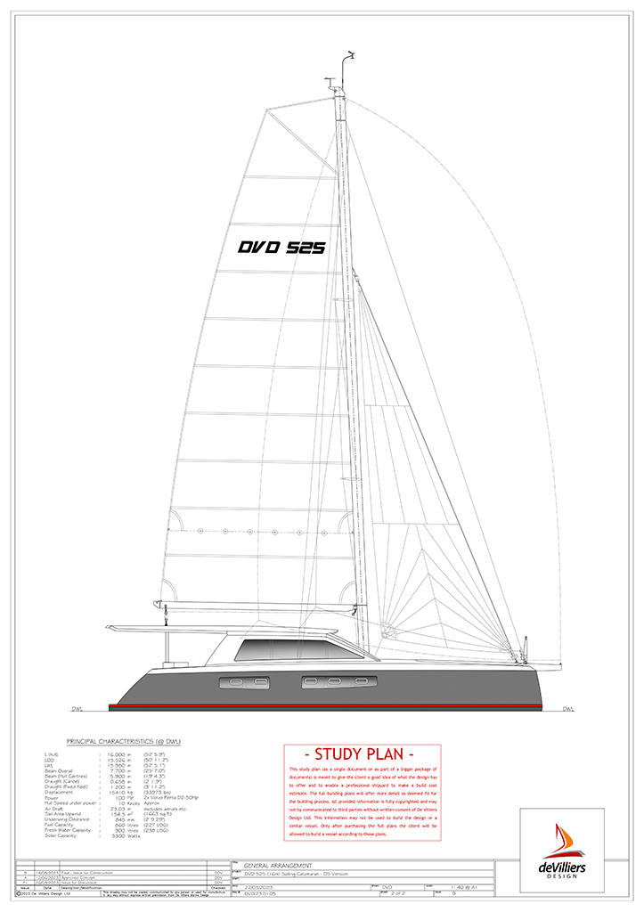

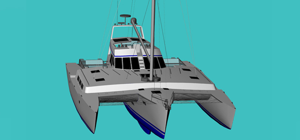

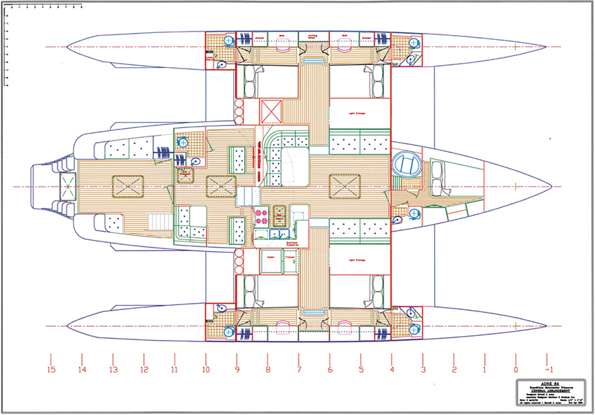

The David Devillars designed (from New Zealand) DS 525 is a development of the 525 cruising catamaran. The term DS refers to features incorporated such as diving facilities and a huge Solar Array on the deckhouse roof are added. There is a new fixed platform on the aft side of the seat backrest/bulwark, inside which is dedicated storage for a 6 dive tanks plus related dive gear. The liferaft also fits neatly into this space. The roof extension allows for integral lifting beams and once raised the 12’ dinghy is stowed in retractable chocks as well as subtle modifications in the deckhouse area plus the longeron now houses a single anchor with internal channel for the chain leading to a recess on deck for the windlass.
The 525 DS is 52.5 x 25.7 foot with a displacement of 33,973 lbs. Mast 65 foot carrying a total of 1,539 square foot upwind. The mainsail is 1050 square foot, the staysail jib is 560 square foot, the genoa is 755 square foot, the screecher is 1,610 square foot and the code 0 is 1,830 square foot. The length to beam on the hulls is 10.4 to 1.The draft is 2.2 foot over the hull and 4 foot over the low aspect ratio keels. The underwing clearance is 2.75 foot. The engine power can be twin Yanmar 6LY 57 Hp Diesels (optional two 50 HP).
The accommodation is very good. In the port hull is an aft double berth cabin, a head shower and forward a triple berth cabin. In the starboard hull is a master stateroom with a double berth aft and a full ensuite forward. The main saloon has a large galley, a dinette and an inside helming position. There are forward and aft cockpits of the main saloon with seating and tables if required. The main cabin roof carries a large solar array of 3300 watts. This cat can be independent of generators when anchored as the batteries and solar arrays will run the majority of the vessel overnight.

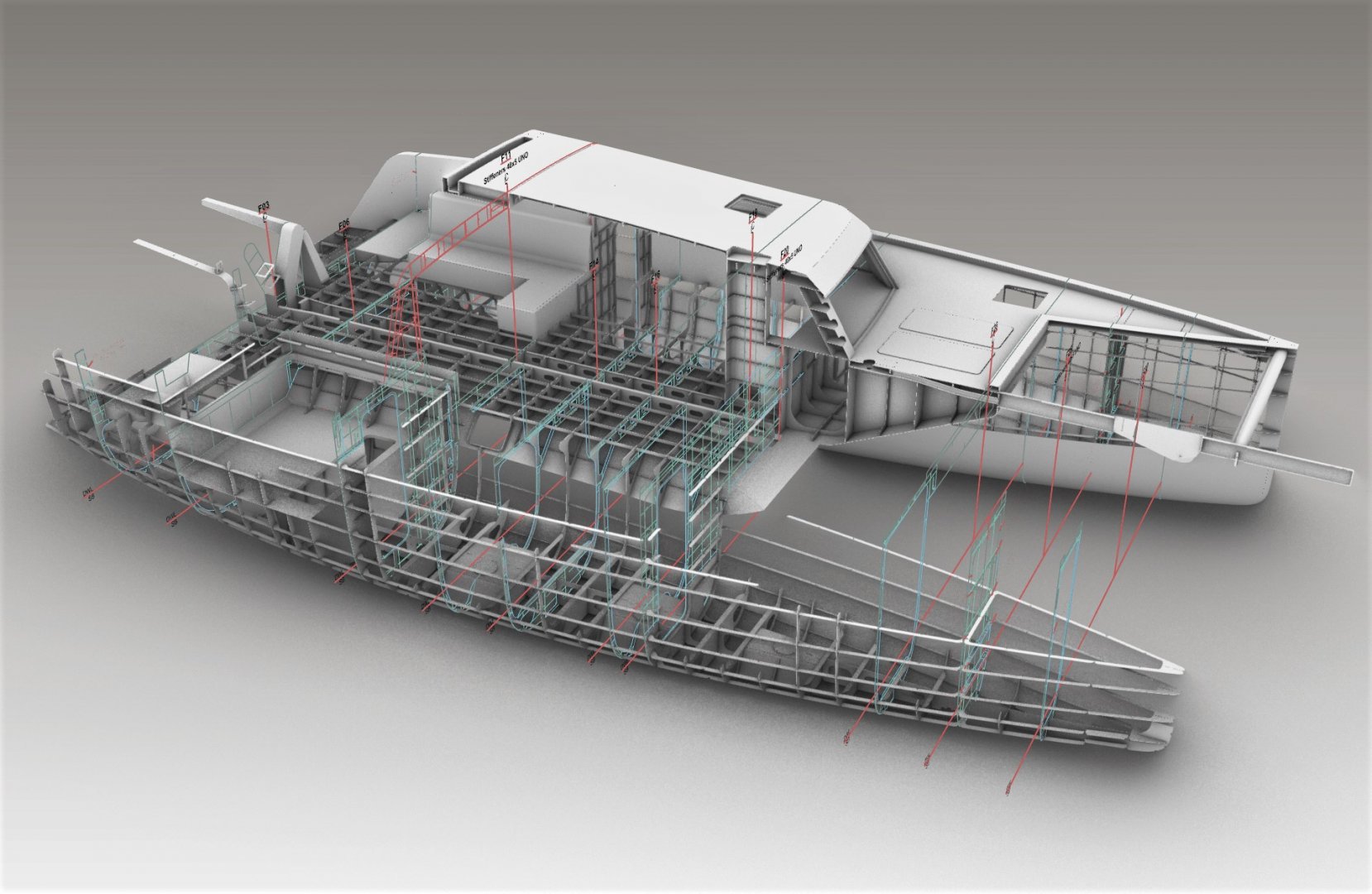

The build material is aluminium 5083 H321/H116 with the rig 6082. The plan packages are detailed and together with the comprehensive build kit information (assembly drawings and nested CNC cutting files) most skilled yacht-builders will have no trouble putting together the cruising cat. The cat can be home built (if you know how to weld) or professionally built. A company in Cambodia will deliver the built vessel for $910,000 US.
This cat will deliver 10 knot plus averages and peak near 20 knots.
If you want a strong long term offshore cruiser this cat is worth consideration. The jpegs give the idea.

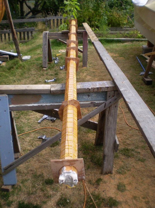

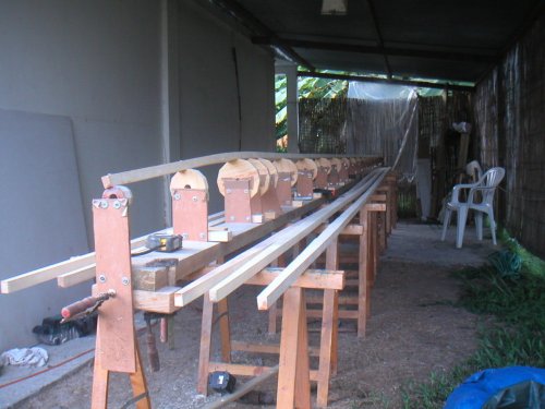

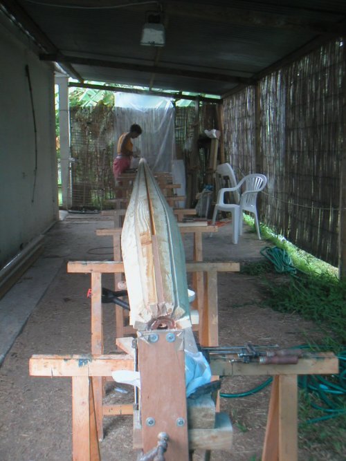

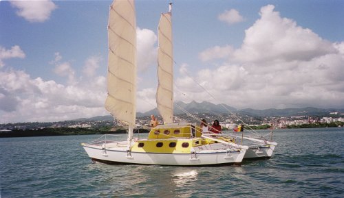

The final mast item will be about unstayed masts and materials. The reason for this combination is many unstayed masts are done by home builders on boats below about 30 foot. Denny’s Harryproa’s are an exception, as Rob has build approaches that have allowed boats up to 60 foot have home built freestanding carbon fibre masts.

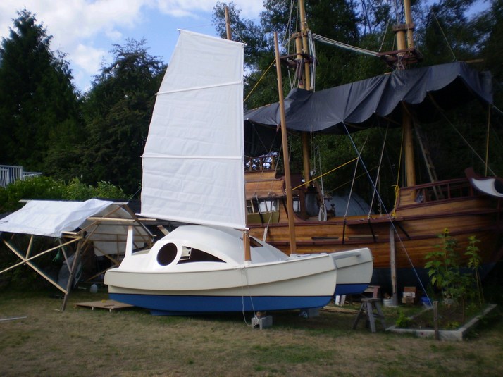

The below 30 foot crowd can have solid wood, fabricated hollow wood, strip plank cedar with EG carbon fibre on both faces, solid fiberglass tubes, foam glass tubes, carbon fibre tubes, composite carbon fibre tubes, aluminium tubes or in one case I know literally a steel lamp post tube. I am sure other have tried many options EG there are inflatable rigs around.
The junk rig crowd often build their own hollow wooden masts with success using the Hasler Mcleod formula specified in “Practical Junk Rig” book (or if you look in the Junk Rig Association site you will find the formula) or Derek Van Loan “Design and build your own Junk Rig” book formula. In each case the masts diameter specified at the deck level is suitable for monohulls but multihulls often need slightly increased size to compensate for multihulls greater stability for a given weight.
Now we get to warnings. Unstayed masts on multihulls suffer from 2 issues. Shock loads on multihull unstayed masts can be greater than on monohulls due to greater stability and often greater pitching cycles in a seaway. Secondly as the wind increases the top part of the mast flexes or lays off which opens the leech (depowers the top bit of the sail) but also creates more fullness lower down in the sail. In short, you need a good sail maker who understands the mast characteristics at various wind strengths to get the best results. This is not easy when you are creating the first sail. Get a “local” sail maker who is prepared to spend time with you or learn how to make cheap sails (EG Sailrite) upfront then order the real thing later. Expect reworking of a sail to optimise it.
The alternate approach is to create a “stiff” mast section to minimise any mast flexing. The problem is a really stiff mast will also likely be a relatively heavy mast.
There are only a few cruising multihulls (exception Harryproas) that have unstayed masts done by home builders. The most successful is PHA a 30 ft Tiki cat (4400 lbs displacement) with a freestanding mast on each hull that measures 33 foot high is 200 mm wide at the deck 100 mm wide at the tip and is built from 12 slats of 25 mm white pine, rounded and wrapped in 2 layers of biaxal cloth with a layer of carbon fibre from the mast base to 1 meter above deck level.

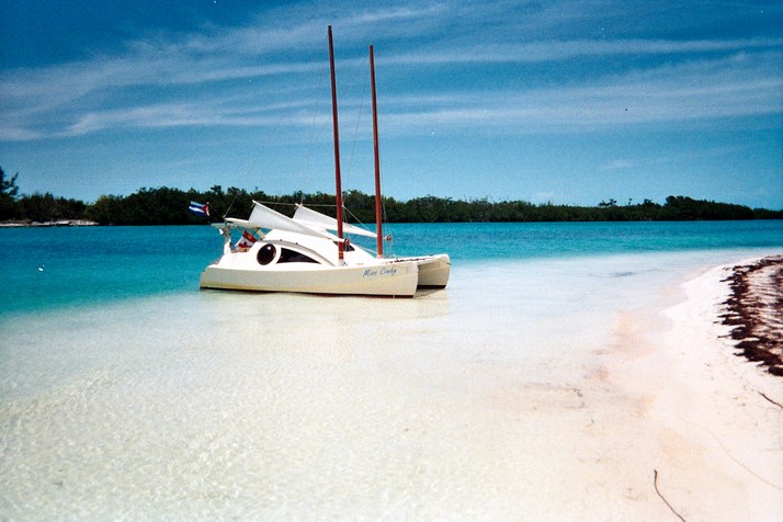

There are many smaller designs about 16 foot that use a “strengthened” windsurfer mast for there freestanding masts. This suite light boats (EG less than 400 lbs weight) but if you are doing serious sailing like trans ocean Miss Cindy 16 foot cat (1,100 lbs displacement) biplane 17 foot wooden masts that are 105 mm at deck level and 60 mm at tip of the mast with 18 mm timber walls.
Evergreen 21 open wing cat (1,350 lbs displacement) 21.5 foot has a 120 mm mast at partner (deck) 70 mm at mast head Birdsmouth (hollow timber) timber or carbon fibre.
Duo 660 open wing cat (1,800 lbs displace) biplane has a 26.5 foot aluminium 106 mm at partner with 2.8 mm walls constant section.
Dragon Wings 32 foot cat (10,000 lbs displacement) biplane 29.5 foot high, solid fir (yes literally a tree trunk) of 250 mm at deck and 100 mm at tip, junk rig.
Tangaroa Wharram 34 foot cat (8,000 lbs displacement) biplane 32 foot high spruce birdsmouth 225 mm at partners 165 mm at tip 50 mm spruce walls.
Radical Bay 1060 35 open cat (9800 lbs displacement) biplane 37 foot high carbon/glass 214 mm at partners and 100 mm at tip.

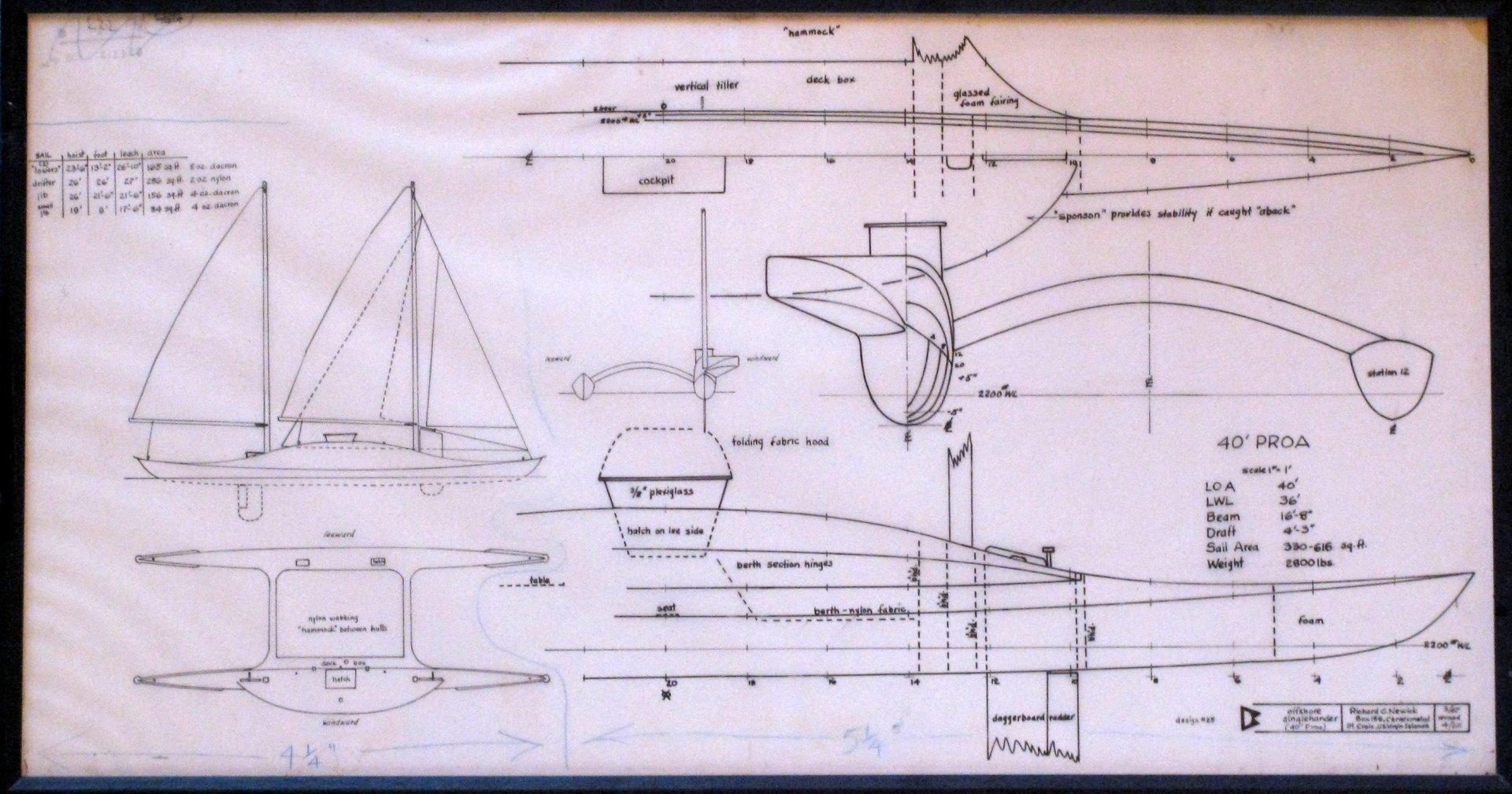

Cheers 40 foot proa (3200 lbs displacement) schooner 27 foot high 170 mm square timber at partners 95 mm square at tip, walls 35 mm tapering to 16 mm at tip.
Azulo 40 foot proa (3000 lbs displacement) schooner 32 foot high mast aluminium 152 mm at partners tapered to 75 mm at tip with 4.8 mm walls.
Grand PHA Tiki 46 foot (20,000 displacement) biplane 46 foot high wood, 280 mm at partners tapered to 100 mm tip. Timber 150 mm walls at partners, the top 42 foot 50 mm walls. Had a reefable wing sail then went to a junk rig on each mast.
Chris Whites 52 foot constant chamber tri Juniper (16,000 lbs displacement) Schooner 55 foot wood, 310 mm at partners tapering to 105 mm at tip. Chris sailed many miles under the freestanding mast rig before it was modified to a stayed wing sail ketch. His comments in the book “Cruising Multihull” about the rig change were the lack of control of the mast tip which caused sail shape changes. In light winds (below 12 knots) the freestanding masts worked well, but in moderate winds the sail shape changed as the mast flexed. In higher winds when the sail was reefed and therefore flattened, the combination worked well again.
Summary. Freestanding masts are possible and many have been built for multihulls. If you get a designer (EG Bernd Kohler) who understands freestanding masts or as with Rob Denny uses an engineering firm to assist with the design of the masts you will get a reasonable outcome. The build material appears to be secondary as long as it is good quality and well done, there are no short cuts here. Finally getting a sail maker who understands the dynamics of the mast and sail interaction is also important.

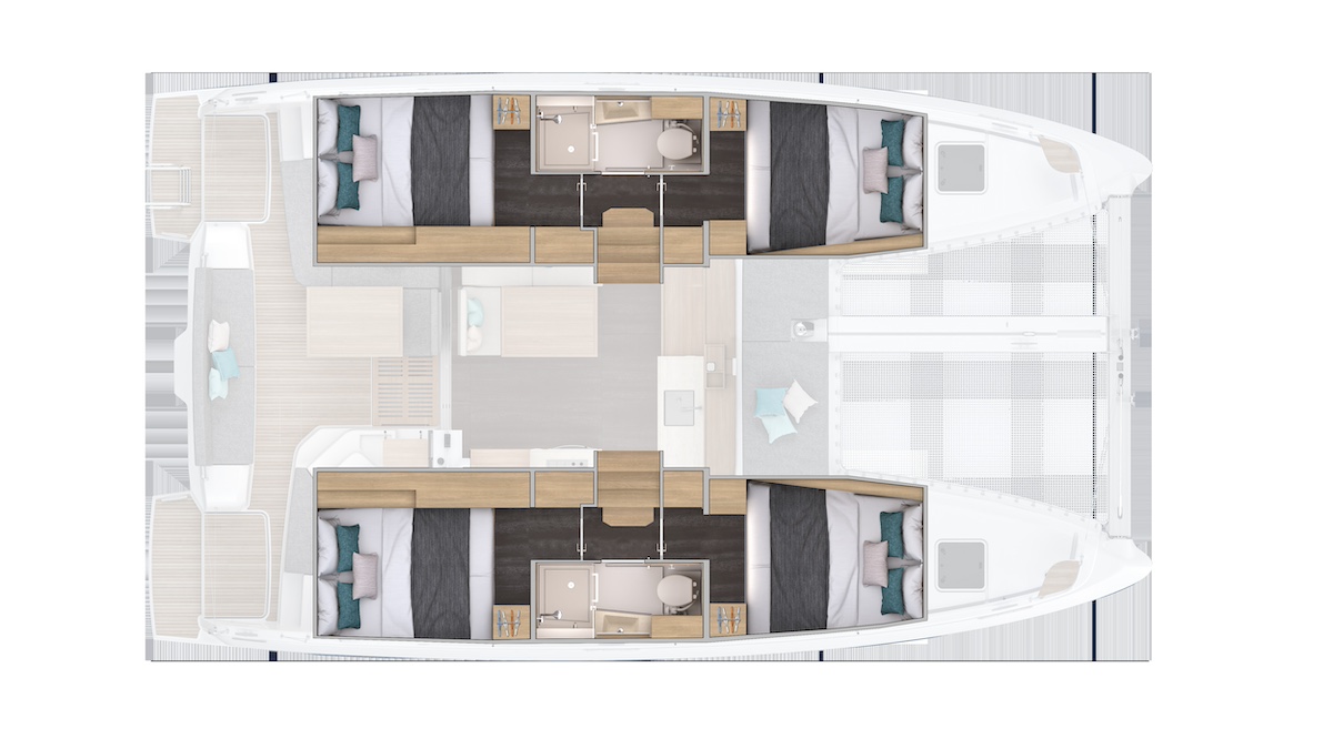

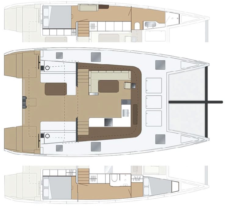

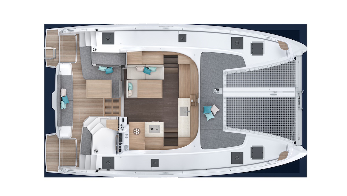

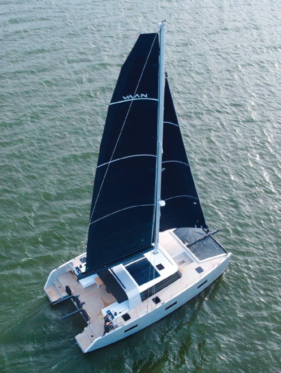

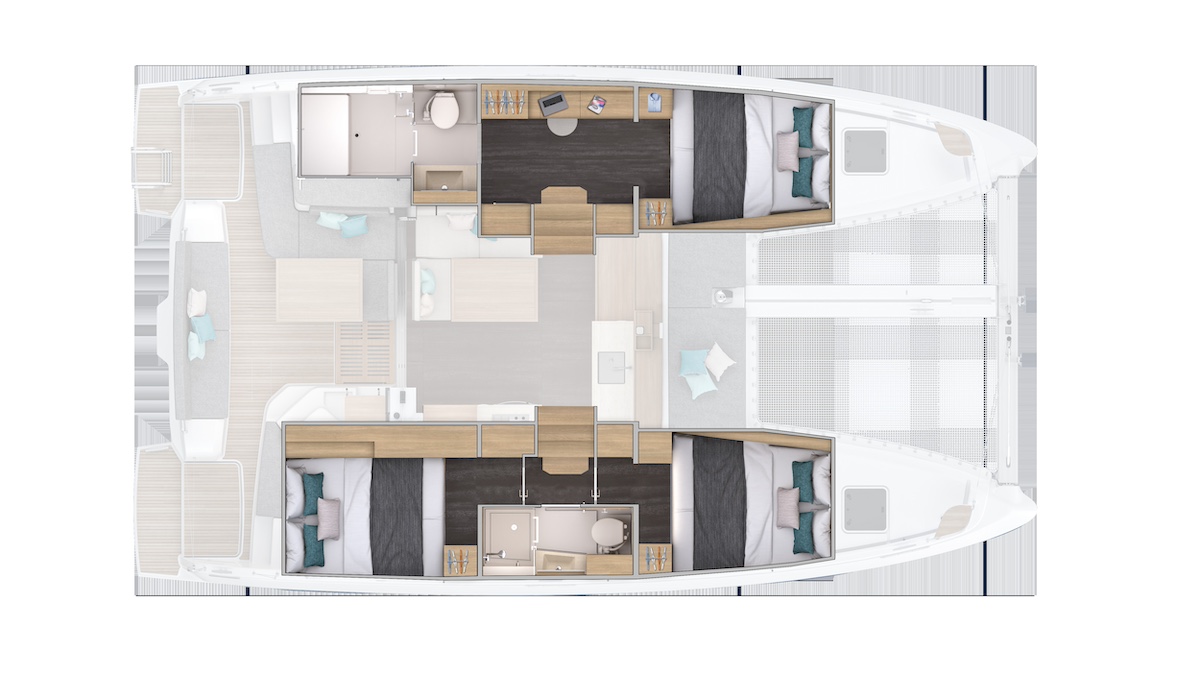

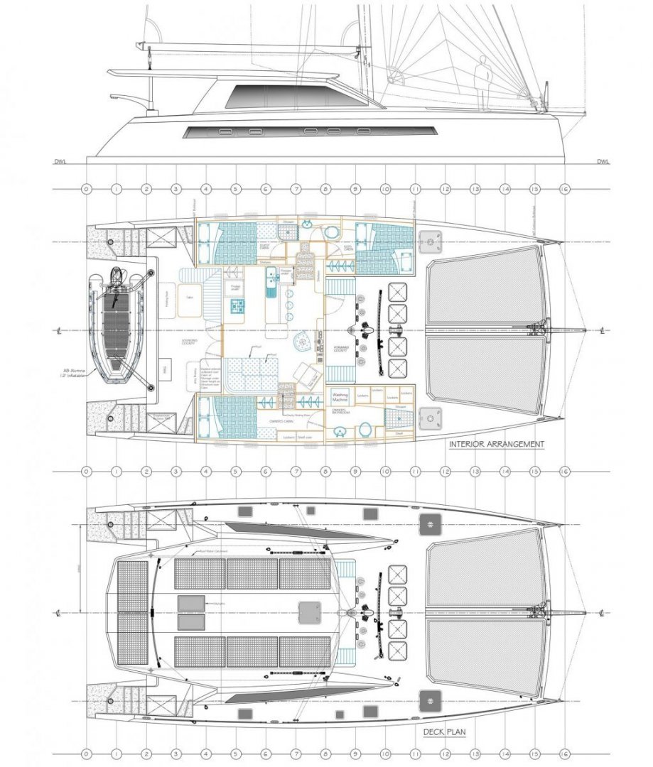

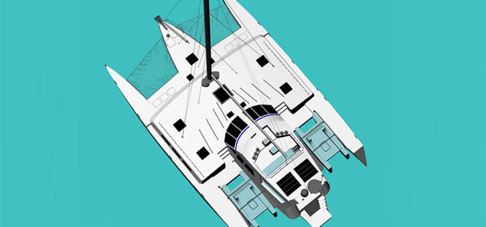

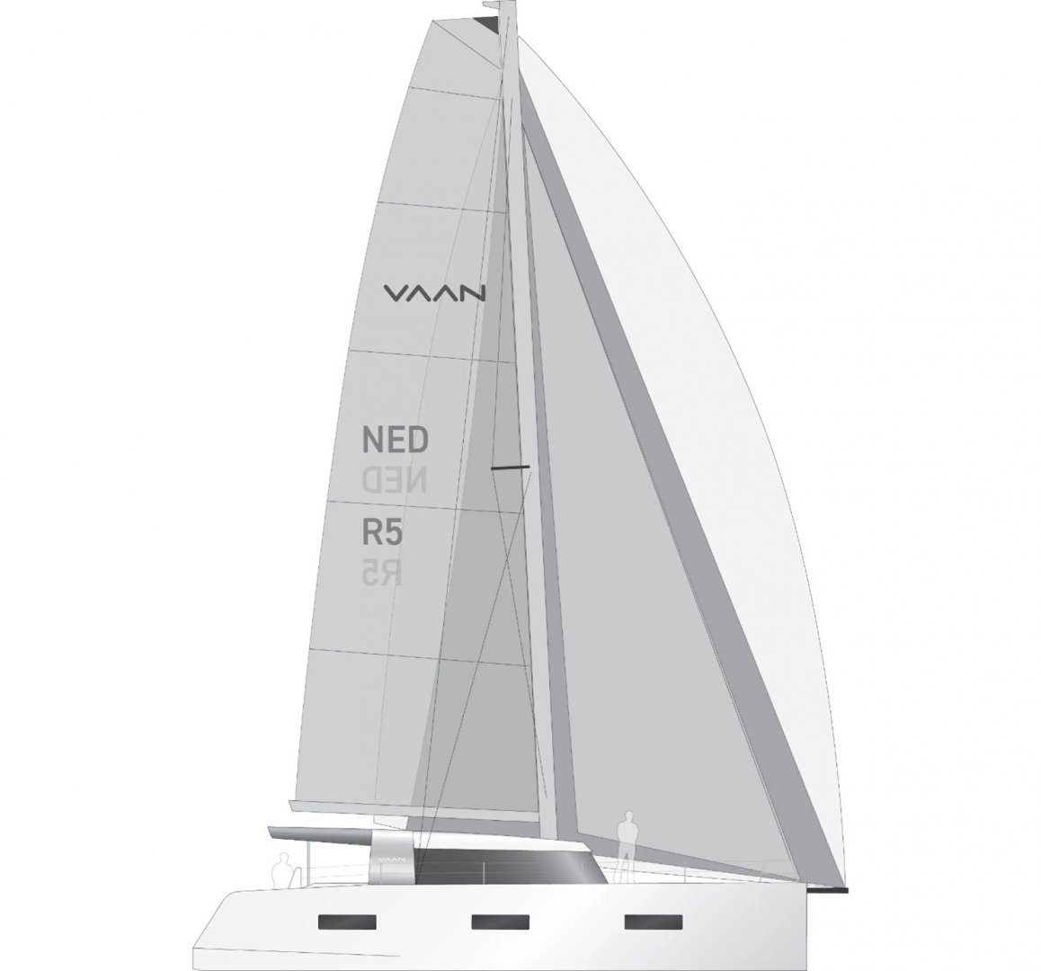

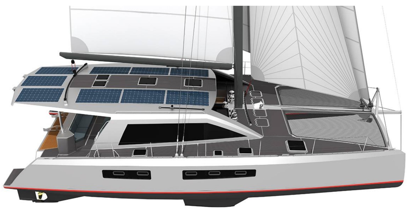

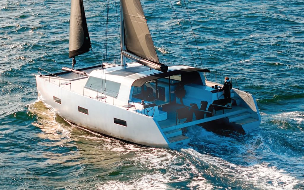

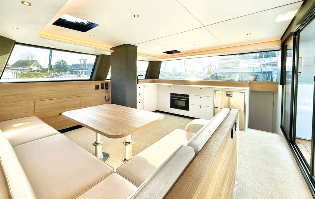

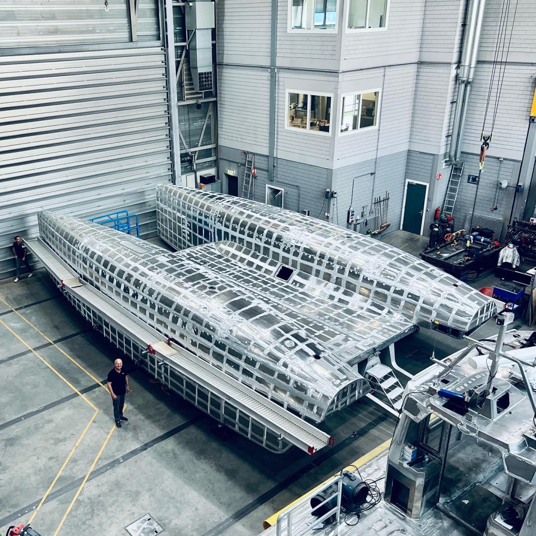

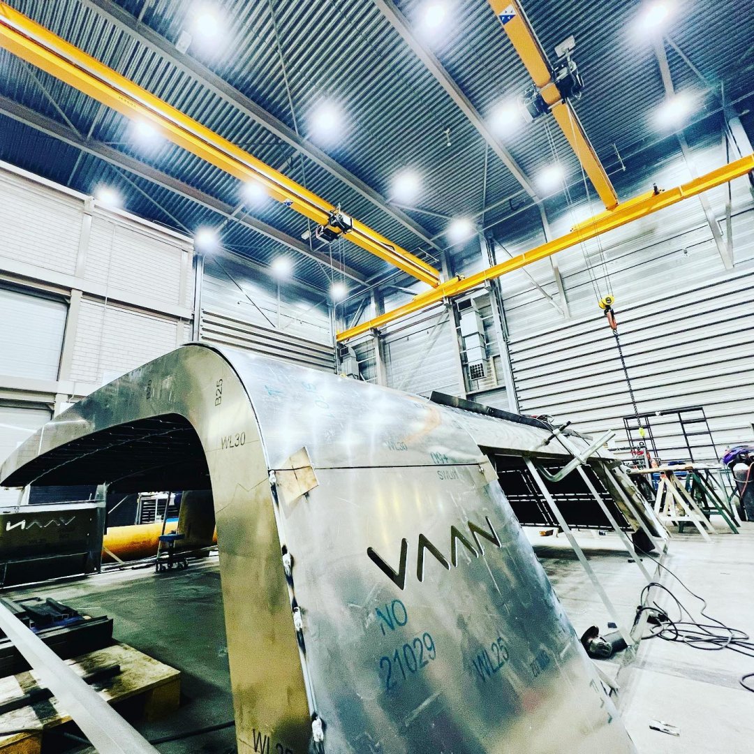

The VAAN R5 is a bigger version of the 42 foot VAAN R4. The cruising catamaran is designed and had naval architecture done by Dykstra Naval Architects. The engineering was done by Navyk. It is a premium fast cruising catamaran with strong environmental credentials.
The R5 is 49.25 x 26.25 foot with a displacement of 39,683 lbs. The 67 foot fixed aluminum mast carries a 883 square foot mainsail, a 484 square foot self tacking jib, a 1292 square foot Code 0 and a 1,851 square foot gennaker. The draft ranges from 4.4 foot to 6.9 foot depending on the option of a fixed keel or centerboard. The underwing clearance is 2.8 foot. The electric engines are 2x7.5kW electric pods supported by a 60KW battery bank with a generator of 15kW available if the 1800 watts of solar panels does not provide sufficient power. The energy storage is provided by a bank of LFP (Lithium Iron Phosphate) batteries. They have a slightly lower energy density (-14%) than conventional lithium ion batteries but are more reliable and slightly lower cost. They also offer greater longevity as they can withstand many more complete charge-discharge cycles. The figure of 5,000 cycles (instead of 1,000) before falling to 80% of their initial capacity is mentioned. They also present much less risk of fire. The Vaan R5 can motor for four to five hours, depending on conditions, at a cruising speed of between five and six knots before the backup generator kicks in.
The accommodation can be had in a 2 double berth cabins, 3 cabins or 4 cabin down below with toilet showers in each hull. The main saloon contains a large galley and seating in the main saloon with an attached cockpit with seating and table. Helming is available on each gunnel. The cockpit is very functional. The interior temperature is regulated by a reversible air conditioning system that operates on the principle of a heat pump, which is very energy efficient. Its coefficient of performance (CoP) of six means that for every kW of electricity consumed, it produces 6kWh of thermal energy (heat or cold). In a Mediterranean summer, the interior can be cooled using only the 1,800W of solar panels installed on the deckhouse.

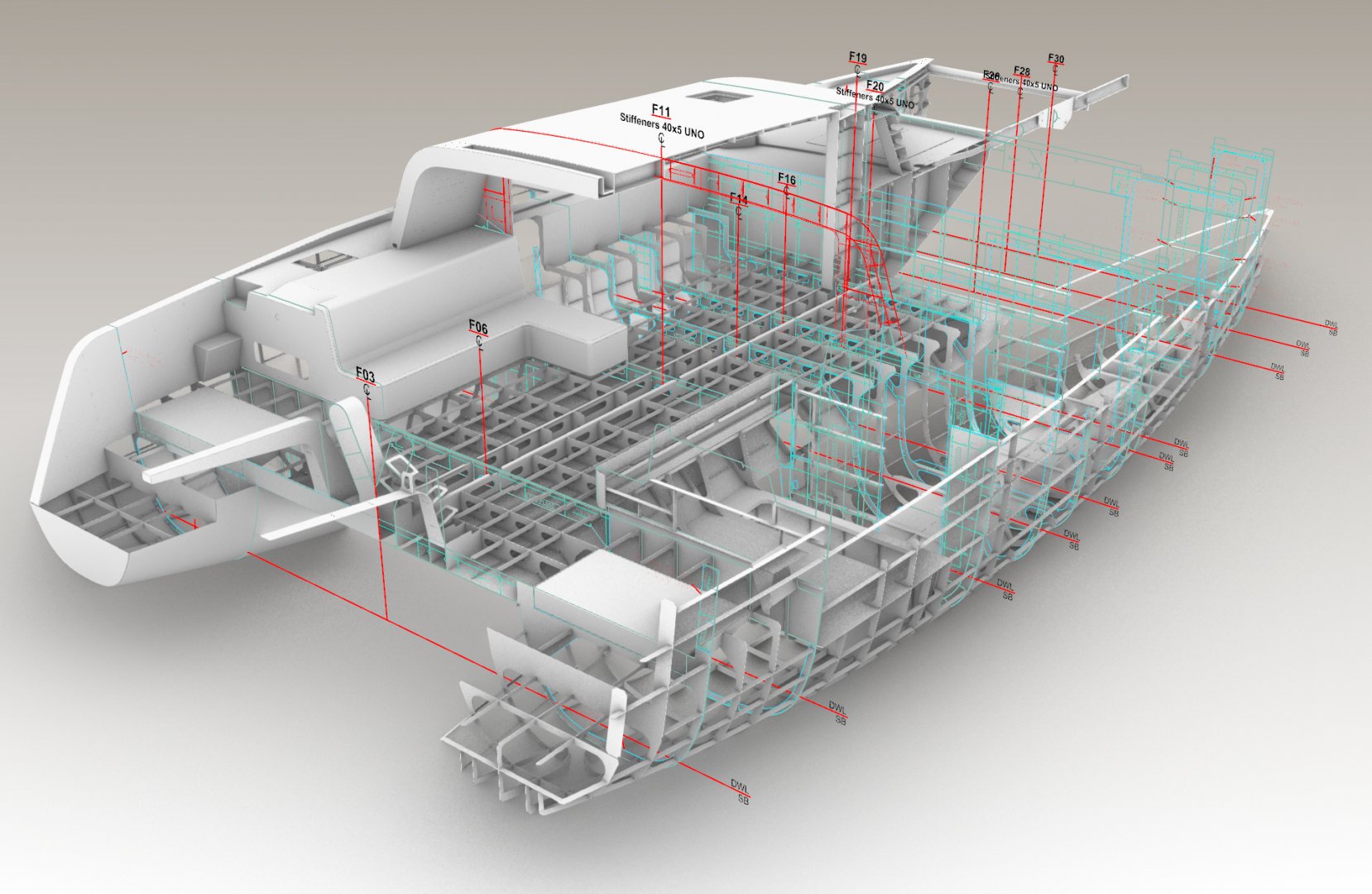

The construction is where this cat is different, not so much in the structure but the basic aluminum material. The material used is a combination of recycled aluminum and additives which bring the mix to the equivalent 5082 grade aluminum. This requires significantly less energy to produce than a new batch of 6062 aluminum for framing and skin panels. Also, the aluminum can be recovered at end of life and reworked into new product again. The structure is frame and stringers (see attached jpegs) with 10 mm keel plates, 7 mm hull skins and 6 mm decking. The windows are double glazed as the underlying structure is very rigid. The interior is created from either recycled materials or environmentally sourced products.
The performance of the cat according to a test in 10 knot winds was good. The cat could tack through 90 degrees and hit speeds of 7 knots. The designers say that 10 knot averages are possible.
An interesting design for those who want an environmentally aware long term cruiser. At end of life the majority of the cat can be recycled. The jpegs give the idea.

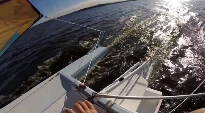

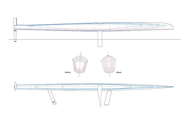

This is a very short one about a small biplane catamaran designed and built by Gerald Bannick. Gerald built in 2012 a biplane cruising catamaran named “Cactus Island” that is 45 x 28 foot. Gerald needed a tender for the Cactus Island. The “tender” is 15 x 9 foot with a biplane rig of 13.5 foot wing masts. Each wing mast and sail has about 60 square foot area for a total sail area of 120 square foot. The sails are reefable.
The intention was to put foils on the boat and had a central aft T foil with forward foils. I do not know if the foils were installed or if the cat has flown under sail. The outboard IS 2 hp.
I do not know the construction, but Gerald has built several large boats in foam glass and ply. He has also rebuilt several houses. All I know is of the 2 boats he has built that I have seen, they were well built. The tender looks like a plywood structure.
The limited jpegs give the idea of the cat. I hope someone from Queensland can add any details of its sailing capability and performance. The final jpegs are of Cactus Island catamaran which has 2 interesting mast builds. More on that tomorrow.

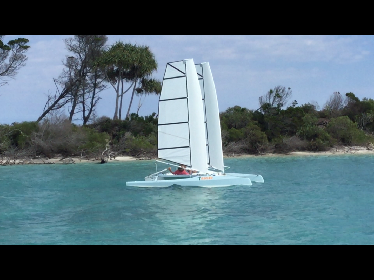

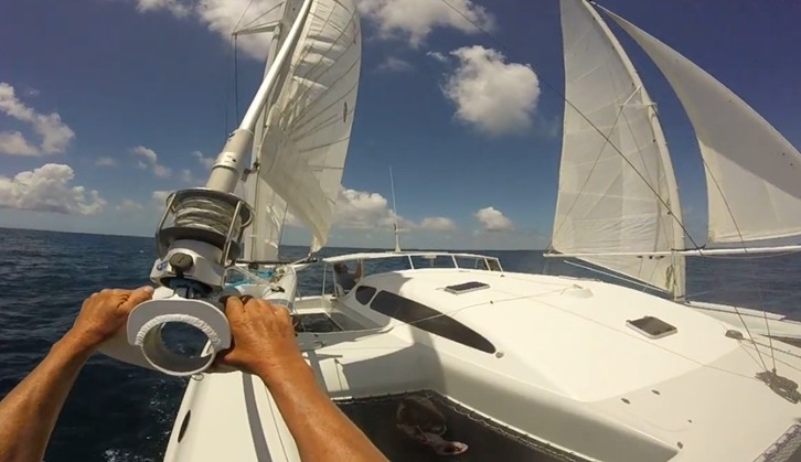

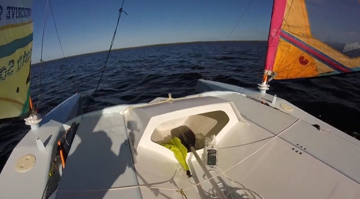

An adjustment of items. I have found more jpegs and information about the biplane small cat (named Tassie) from yesterday. Gerald Barrink built the cat around 2013/14 and initially powered it by a 2 HP outboard. The next development of “Tassie” was to put 2 windsurfer masts on the cat with about 60 to 70 square foot sails on each mast. The windsurfer rigs had a diamond with mini spreaders placed at the mid point to stiffen the top section of the mast and a roller furling drum placed near the bottom of the mast but due to windsurfer sails having battens it looked as so they were not reefable. Also, the cat had a kickup leeboard placed on the insides of the cat hull to improve upwind performance. To quote Gerald: “'Tassie" hits between 9 and 10kts on her second sail in 8kts of wind.”
About 3 years ago Gerald next development was to put 2 wing masts with reefable sails. The masts are 16 foot high and are sailboard carbon fibre masts with reinforcements in the lower sections of the masts. There were foils also installed. After initial development Tassie sails well on all points, tacks and manoeuvres well. About 2 years ago it was sailing well but had not been on foils to my knowledge.
As the jpegs show Tassie sails well under each rig. But Tassie other skill is being able to be towed by Cactus Island whilst cruising at 16 knots offshore (last jpeg). There are several video’s of Tassie sailing under both rigs on Youtube. Use Tassie and Gerald Barrink should find them.
Tomorrow I will do an article on the 45 x 28 foot Cactus Island masts.

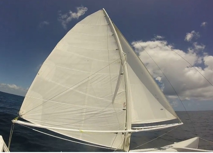

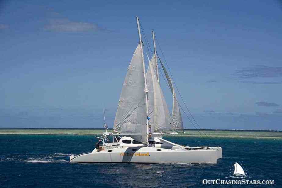

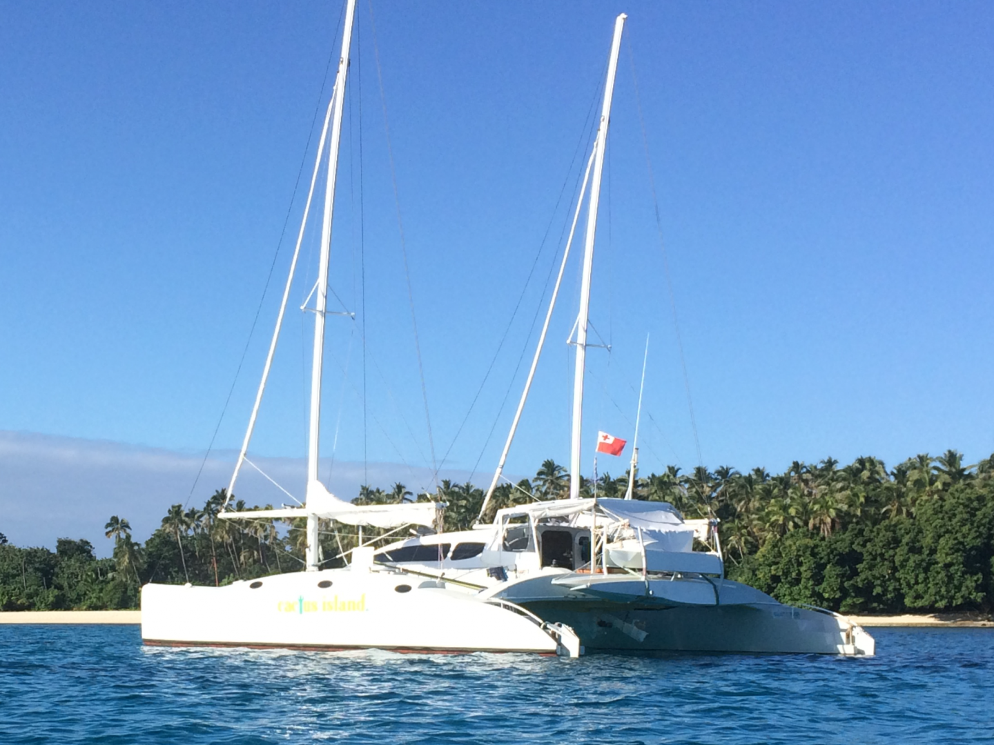

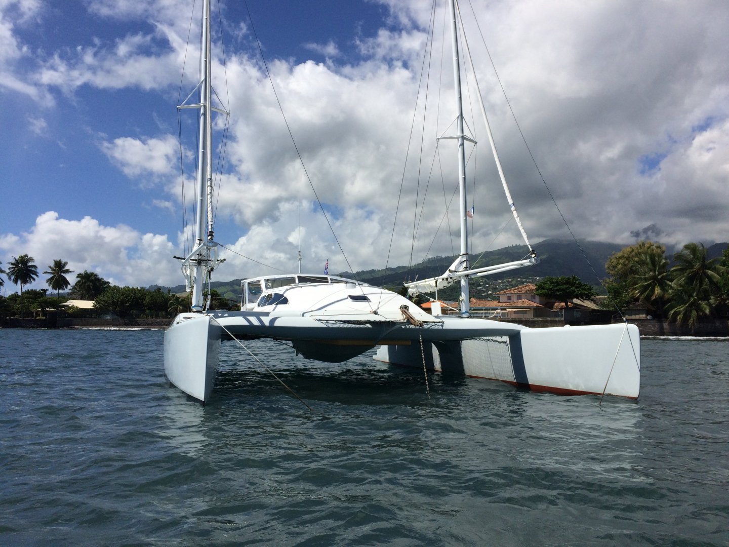

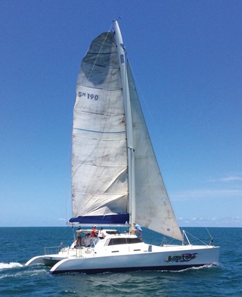

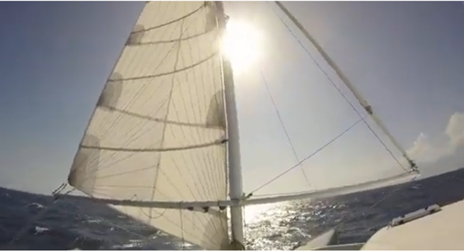

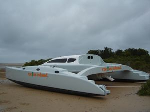

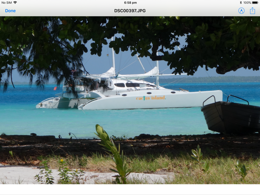

Gerald Barrink designed and built a radical pod fast cruising catamaran, Cactus Island, launched 2012. It has done many transocean trips at a good speed. The most radical feature is the home made biplane rig that has served the cat well. It is an easily handled vessel that sails well on all points.
Cactus Island is 45 x 28 foot and weighs 10,000 lbs. The two 46 foot long masts with 40.2 foot above deck are freestanding with balestron booms. The mainsail on each mast is 330 square foot with a 120 square foot furling jib on each mast. The total sail area is 900 square foot. The rudders can be raised as can the daggerboards.
The accommodation is in a central pod with a double berth cabin forward, a main saloon that has a dinette with seats (convert to berths either side of a central walkway) and a galley either side of the walkway before the cockpit. The hulls have a loo and some berths and storage.
The construction is mainly foam glass with some plywood bulkheads etc. Now we get to the masts and booms. A baleston rig has a free standing mast and a boom that has the free footed mainsail attached at the rear and the jib stay attached at the front of the boom. The entire boom (and the sails by default) can swing around the mast. Result a smaller rig can be more efficient as the jib mainsail combination can always be set at the “optimum” angle of attack to the wind.
The freestanding masts are simple in concept and relatively cheap but need to be done well. They are constructed from two 23 foot lengths of 150 mm diameter aluminum tube with 4.75 mm walls which were internally sleeved together to form a mast, to which he laminated divinycell foam up to the hounds, then tapered the foam from 20mm at base to nothing at the hounds. Then laminated carbon uni's (toray 6oz) at 12 layers up to a metre above the deck bearing tapering down to 1 layer at the hounds. This was consolidated with double bias glass, one layer after 6 layers of carbon then another after 12 layers, also one layer over foam before the carbon. All the laminating was done by hand (no vacuuming etc, all very low tech). Because the tubes were joined he decided to put spreaders at the join (for diamond wires) as the 46 foot tubes seemed quite floppy. In hindsight this was probably not the best way to go as the diamonds transfer all the loads below the spreaders so it bends at the lower half of the mast instead of from the top down as a full tapered carbon tube would. Despite this, the masts work well and appear strong, being only 40' above deck helps a lot in this respect. He has been out in 30 knots and hit by a few big gusts without any scary noises or abnormal bending happening. The masts weigh about 170 kg each.
The booms are 2 aluminum tubes about 75 mm outside diameter with a spreader at the mast which also carries a small jib track that allows the jib to self tack, The booms are held down fore and aft by wires that lead to the mast base on deck. Because the rig is balanced the sheet loads of the rig (basically the main sheet) are low.
The bearings are pvc pipe of around 10mm wall which were machined so the inner and outer bearings had about a 1 mm clearance. The inner bearings were then glued to the mast using a straight edge to align them. He made a conduit out of 3 layers of d/bias glass using some larger pvc pipe as a mould, the outer bearings were then glued to the conduit in situ on the mast which allowed the bearings to align. When cured the conduit was then removed and fitted to the boat knowing that the bearings were aligned. So, to do it this way you need to build the masts before fitting outer bearings to the boat. The bearings are 80mm high and I have fitted s/s grease nipples (3) around each set, Innox makes a grease which is suitable for use with plastics. They spin freely but the top bearings (which are more highly loaded) start to make noise when under load. Stainless steel shims at the top inners stopped this noise.
Beefing up deck and sole had the conduit pass through what would be mast bulkhead (if standard rig) which is quite substantial giving it plenty of support sideways. To support the mast forwards and at 45 deg he heavily glassed tapering timber ribs (internal only) on the outside (deck) and glassed heavily (uni's and d/b) about 750mm out from mast. Also, the decks core is removed for around 500mm around mast and replace with ply. The main things to be aware of with beefing up decks and sole is that the major loads on freestanding rigs at deck level go sideways and forwards with smaller loads going aft and at sole level the loads go backwards and sideways with smaller loads going forward and there are small compression loads.
Cactus Island only sailing weak spot is about 15 degree range on a beam reach. One rig blankets the other rig. A small course adjustment generally solves the problem and speed is maintained. It sails well upwind and with the 2 rigs across the cat very well downwind without a spinnaker. Speeds of up to 20 knots have been achieved and extended periods of 10 to 15 knots have been done.
This is an unconventional but very good cat capable of taking its crew comfortably across oceans. The jpegs give the idea and there are some Youtube videos of Cactus Island sailing. And yes, there is a whale in the background of CI d boom end jpeg.

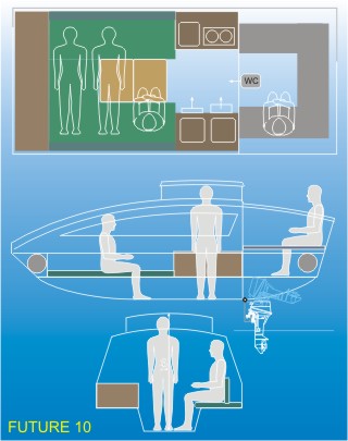

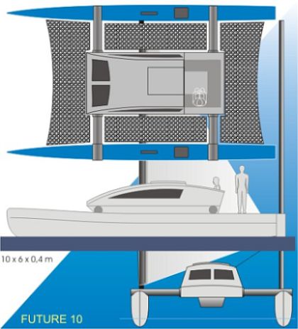

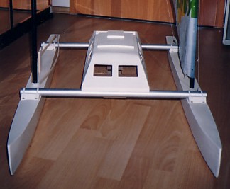

This is again a short item about a home designer that thought about his idea for over a decade before professional designers produced similar boats. The design was an attempt to produce a fast simple easy to handle cruising catamaran that could be built at home then assembled near the water.
The Future Catamaran is a 32.3 x 19.5 foot biplane cat that weighs about 3,360 lbs. Each 29.5 foot carbon fibre mast carries 215 square foot sails. The length to beam of the hulls is 19 to 1. The draft is 1.3 foot over the hulls and rudders. No mention of lateral resistance. The hard chine hull shape is simple.
The good part of this design is the pod. It contains a double berth, seating and a small table, a small gally and with a raisable roof next to the galley provides full headroom. The cockpit is small but effective for 4 people. The hulls have storage space.
The build is listed as “Plywood planks keep the cost in limits and strength is achieved with a pinch of carbon fiber and aramid.” The crossbeams are aluminum tubes about 250 mm in diameter. The masts will be home built solid carbon fibre. There is little further detail available.
The performance of this cat would have been interesting if it was built. The simple calculator I have says it will reach near 20 knots and average about 9 knots over extended periods.
The German guy had some good ideas and was starting down a reasonable path but I do not think it was actually built. The jpegs give the idea.
Another simple approach to a trailable cruising catamaran on a budget. This is a close to land cruiser for 2 which is simple to build, is practical to sail and accepts the reality that a motor can help to get home. Let’s call it a sailor with a powerful enough motor to get home in a reasonable time. The design was done by Jeff Gilbert (I do not know if he still does design work) as a concept and a development of his Hot Chilli 15.5 foot design.
The Alleycat is 20 x 8.2 foot with a weight of 2240 lbs. The 20 foot mast is wooden carrying a100 square foot mainsail and a 60 square foot self furling jib (on a home made furler). The length to beam on the hulls is about 12 to 1. The draft is 1 foot over the hull and 2.5 foot over the kick up rudder. Alleycat hulls are full slab-sided Dory with a little styling curve in the tunnel. This is for ease of build and interior comfort plus shoal ability. Daggerboards are Hot Chili style (kicking up from behind side rungs not shown in the drawing). The bridgedeck clearance is 1.5 foot. The 15 HP Honda 4 stroke (or similar) will provide a 14 knot peak speed and a cruising speed of 10 knots in relatively calm seas.
The accommodation is good for its size. The bridge deck headroom is 4.3 foot with 6 foot headroom in the hulls. There is a double berth on the bridgedeck with enough space in the galley hull to act as a seat with a folding table. The table hull has a small galley aft with additional space for preparing food and full headroom. Aft in the other hull is a stand-up toilet area in a closed compartment. Between the hulls on the bridgedeck is a lifting roof that allows full headroom at anchor.
The build is not fully specified but it is a plywood with timber stringer and frame support. The hull bottoms, underwing and main bulkheads are 12 mm plywood. Hull outsides are 9 mm plywood, hull inner sides are 6 mm plywood with the decks and cabin are either 6 mm or 9 mm ply backed by stringers and deck beams. If good quality plywood is used exterior glassing only needs to be done from the keel line to about 200 mm above the waterline. The mast can be two 50 x 100 mm planks of timber glued together and rounded a little with a sail track placed on the back edge. A set of diamonds and 3 wire stays should be sufficient to hold the mast up. Cheap, fast to build and effective. A tabernacle will allow the mast to be folded for trailering or motoring.
A good little package that if sailed correctly will take you on a long cruise if kept within sight of land. The only jpeg gives the idea.

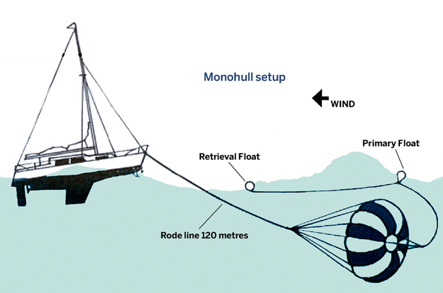

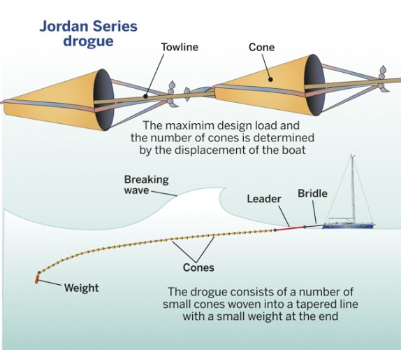

The following is from “Sackville” from the Farrier website blog. He is a very experienced guy who has written many very good items on cats and tri’s he has owned. I am quoting his work.
First rule of cruising is: don’t enter unknown harbors or channels at night. Crews have broken this rule and occasionally paid a horrible price.
What to do instead.
1) Trip planning. Depart so that you will arrive with plenty of daylight. Or choose a different destination, eg anchor off a beach that you can safely approach in the dark, and tackle the channel or harbor the next morning.
2) If on a monohull, heave to 10 miles offshore and wait for dawn. Monohullers have been safely doing this for the past 200 years. If your monohull won’t heave to, it’s not a suitable boat for cruising.
3) If on a multihull, deploy the parachute anchor 10 miles offshore, go to sleep, head in at first light. I’ve done this a few times, works fine, but quite a bit of work.
4) Slow down! When you’re 1-2 days out, check distance to go, calculate speed needed to arrive in daylight, reduce sail area to meet that speed, arrive in daylight.
5) Under small sail, slowly reach back and forth 5-10 miles offshore until dawn.
I’ve used all of the above multiple times.
I’ve used the parachute anchor in survival conditions (3-day storm off the African coast with 55 knot winds and 15’ seas). My 40’ cat only drifted 10 miles after 48 hours anchored. Many solid waves came onto the foredeck, up the windows, over the coach roof, and half-filled the cockpit. Damaged the Bimini, the gps antenna, and damaged the self-steering. As waves hit, the parachute line would stretch and the boat go backwards, so quite a lot of abnormal loading on the rudders. Mine were fine, but something to consider. The sterns yawed so much that I got seasick in my aft cabin - you need to rest amidships.
In 1988 I got a couple of drogues for my F-27 and tested them. They did not work! When the boat accelerated, the drogue would get pulled out of the water, flying up into the air, all drag suddenly ending, the boat accelerating more, then when the drogue re-entered the water, a sudden, huge braking, putting a tremendous load of the 2 aft cleats used for the bridle. Boat speed was oscillating in an unnatural and alarming way, making crew-work dangerous.
I added chain, this improved things a lot, but it made it hard to deploy and retrieve. I concluded that the best drogue for an F-boat would be the Jordan series-drogue, but I never got one because the sailing I was doing was not distance cruising and I prefer to keep my F-27 moving faster, at a speed more in tune with the speed of the waves.
I did carry a couple of drogues on my cruising cat, including a large variable-geometry one from NZ, the same one that Peter Blake used during the Round Australia bicentennial race on his 60’ Tri Steinlager 1. He deployed the drogue off the stern and reached back and forth between Oz and Tasmania in a Force 10-11, thereby avoiding a pitchpole he said. I ended up never needing mine.
Weather forecasting is so good nowadays that most of these safety tools are no longer needed. Racers take risks that non-racers never would. If caught out in really bad weather on your F-28R, one option is to hand all sail, raise the foils, go below until conditions moderate. In some conditions it’s better to steer downwind under bare poles. One morning approaching Martinique from Venezuela, got to within 15 miles of the coast when a big squall hit. We ran off downwind under bare-poles for an hour or two, it took the rest of the day to claw back those miles! That’s why I never give an ETA. Sackville
The jpegs are of a sea anchor and drogue setup. The final jpeg is what heavy weather is really about. 25 knots winds and 3-meter seas is a good sailing breeze, 50 knot winds and 10-meter seas is heavy weather.

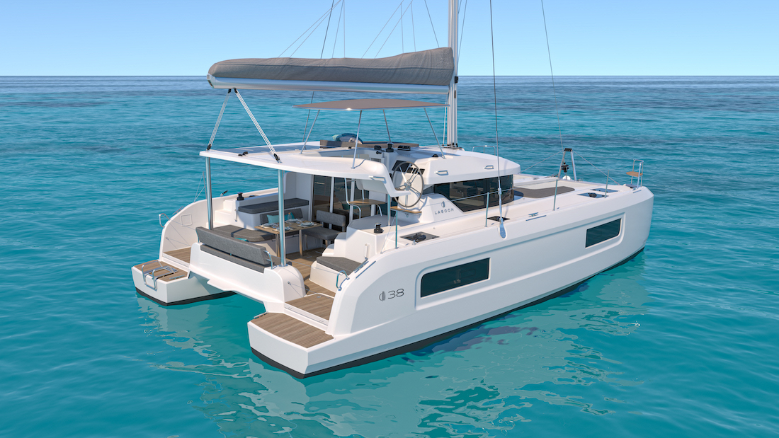

The following is the latest update to the Lagoon 380 series of cats. The Lagoon 380 variations have sold around 1000 boats so it is meeting what people want in the compact cat with big accommodation market. The naval architects are VPLP, exterior design is done by Patrick le Quement and interior design is done by Nauta Design. This is some serious design talent with good reason. The overall boat sales market fell by 16% in 24/25 and some French cruising catamaran builders lost money in 24/25. Any investment in new product needs to be profitable. The Lagoon 38 is basically a new cat with new hull shapes, a different (taller) rig and new construction techniques using hemp materials instead of fiberglass in non structural parts. With initial construction is done at the Vendee facilities, its debut hull was done at the Construction Navale Bordeaux (CNB) shipyard.
The Lagoon 38 (a brand of the Beneteau Group) is 37.4 x 21.9 foot for the hull with a 43 foot overall length with prodder etc. The weight is 22,529 lbs. The 50 foot fixed aluminum (optional carbon) mast carries a 540 square foot mainsail (optional square top mainsail 599 square foot) with a 237 square foot self-tacking jib and a 581 square foot Code 0. The hull length to beam is about 7.3 to 1. Draft is 4.2 foot over the fixed low aspect ratio keels. The standard engines are two 29 HP diesels. The Lagoon 38 solar setup generates up to 1,420W of energy, thanks to the strategically placed solar panels on its transom and coach roof.
The accommodation has a choice between a symmetrical four-cabin layout with two heads or a three-cabin design featuring a master suite in the port hull. The beds boast a generous 1.8m width, a market first for sub-40-foot yachts. The main saloon has an interior and exterior living space combining the main saloon and cockpit into one unit by the use of large sliding glass doors. The large galley and internal seating provide comfort for harsh weather. The sailing controls can be done from the flybridge on the cockpit roof. This boat is about charter work or sailing accommodation comfort, not about racing.
Performance test reviews say things like: “We left port with 20 knots and almost immediately 30 knots were blowing and some gusts of 32. Even so, we sailed with the full mainsail and the self-tacking jib. The idea was to find a place with less wind, but it was not possible, so we sailed downhill. We maintained a course of between 100 and 130 degrees apparent and the speed was maintained at all times above 8 knots, although at some point we exceeded 10 knots”. Another report said it tacks through 100 degrees in moderate conditions and one other report said they motored back to port in preference to tacking upwind in a light breeze. Translation. This cat will sail on all points but is a 50% of windspeed type of boat. A safe cruiser but not a racer.
The construction has been upgraded to the latest environmental standards for Lagoon. The Lagoon 38 is manufactured under strict quality and sustainability standards, with ISO 9001, ISO 50001 and ISO 14001 certifications in environmental management and energy efficiency. Its structure uses vacuum infusion molding producing lighter weight and higher composite quality, incorporated eco-friendly materials. Fiberglass has been replaced by hemp fiber in non-structural parts, the wood comes from FSC-certified forests, and the upholstery is made from recycled materials.
The jpegs give the idea of what is a compact modern global cruiser.

The concept of this trimaran design is an offshore cruising media studio capable of full production anywhere in the world with the crew, camera crew and editing crew enjoying living, cruising and working together. This design would also be ideal for use as a live aboard charter vessel for exploring, diving or other similar marine activities. The designer is Harold Aune with Matthew Graham the Naval Architect.
The Aune 64 is 67 x 40 foot that weighs 43,000 lbs and a displacement of 63,000 lbs. The maximum overload displacement is 73,000 lbs. The mast is 82 foot aluminium with 1,600 square foot upwind sail area. The length to beam on the main hull is about 8 to 1 and the length to beam on the floats is about 13 to 1. Draft is 3 foot over hull, 5 foot over low aspect ratio keel. The prismatic coefficient 0.522 (low for a tri main hull this size). Engines are two 200 HP diesel engines are designed to cruise, with one engine operating, at 9-10 knots operating at the top of the torque curve, and up to 16-18 knots maxed out with both engines operating. Under sail the tri is estimated to be capable of daily averages of 300 miles.
Construction is composite/cold moulded wood with composite foils. Now we get to a few of my thoughts. The weight of 43,000 lbs is very light for this size of boat. The prismatic coefficient is 0.522 which is low. Most reasonably fast multihulls have 0.58 to 0.63. The prismatic coefficient indicates how full the boats ends are in comparison to the size of the midship hull shape. Generally, the fuller the ends the faster the boat can sail on average.
The accommodation is vast. There are seven inside living or working areas. Each of the five staterooms features a double berth, work station/desk and chair, full sized hanging locker, dresser drawers with a large private adjoining head and shower. The main saloon work area has a large galley and seating area plus adjoining areas that can be used as work or lounging areas. There is high regard for personal space, privacy and comfort. From my experience people who work together don’t always want to live together especially in limited space. 10 people on a 64 foot boat have “limited” space.
I hope the boat was built but I have not seen any build jpegs. The conceptual design is attached.

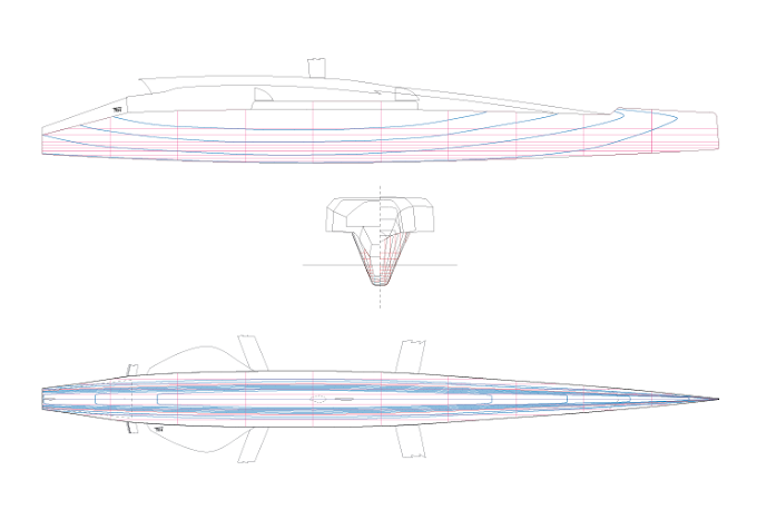

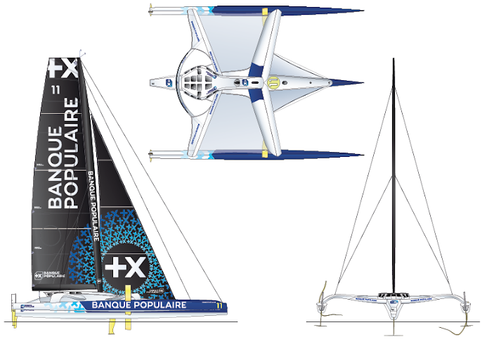

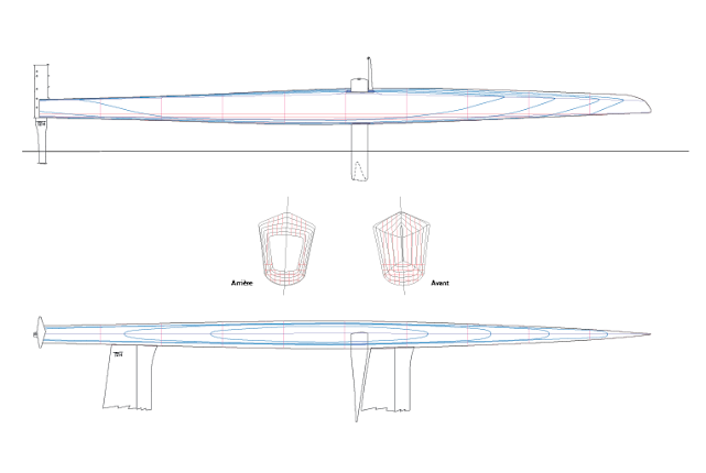

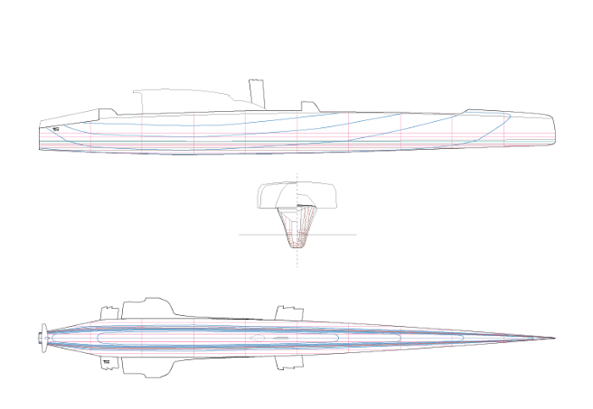

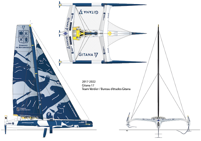

A short discussion about the shape of speed. The jpegs below done by François Chevalier and Jacques Taglang are a close approximation of the hull lines of 3 Ultims. The rules for the Ultim class are: Maximum overall length: 32 m (105 foot), Maximum beam: 23 m (75.4 foot), Air draft: 120% of the longest length. All tris below are close to maximum size possible within the rules.
Gitana 17 Compared to earlier trimarans, many modifications have been done, such as the fairing of the arms, the appendages and the aerodynamics in general. The arms are oriented towards the front of the floats, in order to reduce the impact in heavy seas. The cockpit, forward of the aft boom, is inspired by the latest IMOCAs.
Banque Populaire XI is a development of the previous tris by VPLP. Lighter weight, structurally improved and easier for the crew to handle.
SVR-Lazartigue created a surprise in his first appearance. A flush deck, with three places to steer on sight, two cockpits on each side aviation-style, behind the mast foot, equipped with AC50 type steering wheel, and a central one behind the aft arm. For this Ultim, VPLP started from scratch, with the approval of François Gabart, who wanted to renew the genre. The deck offers a flat surface that allows the boom to be lowered flush with a plate effect, as on the multihulls of the America's Cup.
Each of these tris have a main hull with a length to beam of between 22 to 25 to 1. The length to beam on the floats of Banque Populaire XI and SVR-Lazartigue are 22 to 1. Gitana 17 floats length to beam is 28 to 1.
As all 3 of these tris are foilers the length beam ratios are less relevant for performance. The major virtual of narrower hulls is less surface area (less weight) to build and the hulls ability to push through a seaway at speed when punching into wave tops etc. The downside of narrow main hulls and floats is a need to build extra strength into them to resist torsional (twisting) movements caused by lifting foils on the floats and rigging stresses across the entire platform. EG the loaded cap shroud trying to pull up a float stern whilst the forward part of the other float is being lifted by foils or bow buoyancy. The carbon fibre monsters are engineering marvels.
Next each of these designs are trying to minimise aerodynamic resistance which is helped by small hulls. Remember these tris are capable of averaging 36 plus knots over 24 hours (1000 miles in a day) with peak speeds near 50 knots. If they are fine reaching, these tri’s are going into a 60 to 70 knot apparent wind speed (40 knot boat speed with EG 35 knots of wind speed). Aerodynamic and minimization of wind drag matters. As mentioned above VPLP really studied this aspect with SVR-Lazartigue.
Please understand the hull shapes here are designed for foil supported trimarans weighing about 35,000 lbs and driven by 3,800 square foot up wind and up to 8,500 square foot down wind.
Your 50 foot cruising tri would weigh about the same with about a third of the upwind and downwind sail area. The hull shape of your 50 foot tri would have a maybe 10 to 1 length to beam on the main hull and 15 to 1 length to beam on the floats to support the weight and is highly unlikely to have foils.
Thank you François Chevalier and Jacques Taglang for providing some insite into the secretive world of high performance hull shapes. The jpegs give the idea.
