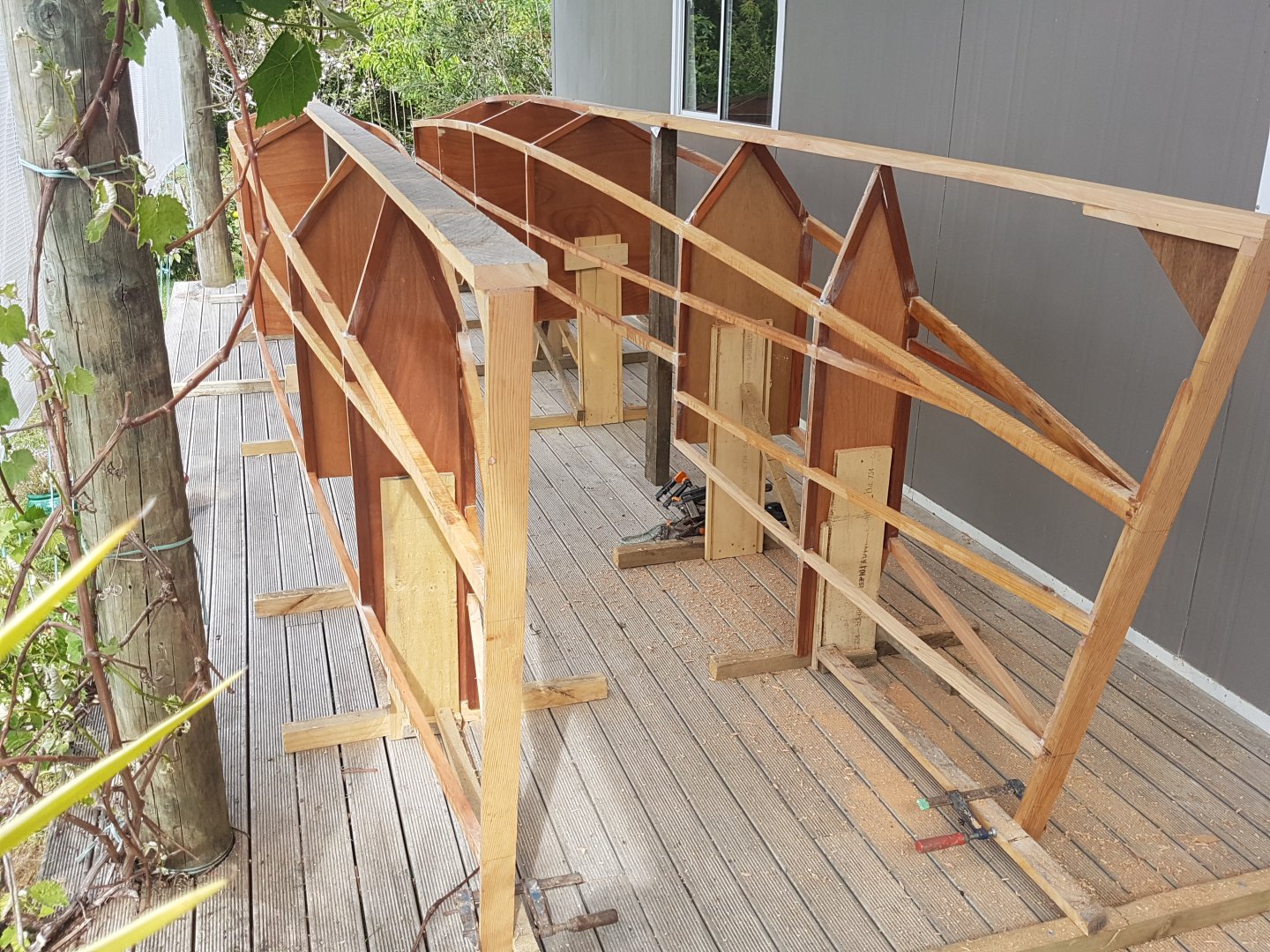

    The final Bernd Kohler design for now is the Eco 7.5. It is a bridgedeck cruising catamaran that filled the slot between the ECO 6 and KD 860. The cat is 24.5 x 14.75 foot and weighs 1650 lbs it displaces 3100 lbs. It carries 305 square foot of sail in a sloop rig. There is a Gunter rig option for those who have to pass under low bridges etc. The hulls L:B is 9:1, in short a reasonable cruiser.
    Its build specifications are similar to the Eco 5.5/6 but with some mild upgrades. EG The planking for the chine hulls has a constant radius and is tortured plywood in some spots. The hulls are 6 mm plywood and have biaxial glass 340 gr/m2 and one layer 200 gr/m2 glass fabric. The roof is 2 layers of 4 mm ply and forward under wing is likely to be 3 layers of 4 mm ply. The under wing is 12 mm ply. The attached sample PDF plan gives more details of the structure. Many copies of this cat have been built globally and owner reports I have read indicate it is a good boat that sails well and is capable of coastal passages.
    When you look at some of the build photo’s please remember the boat has a reverse bow and the hulls are built upside down.

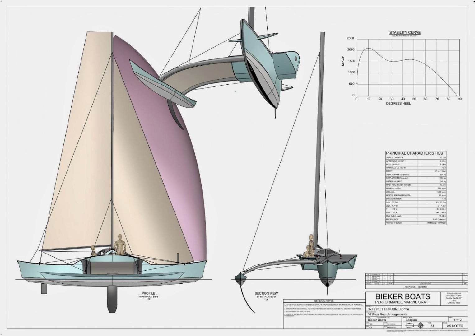

  13. catsketcher
    Joined: Mar 2006
    Posts: 1,315
    Likes: 165, Points: 63, Legacy Rep: 790
    catsketcher Senior Member
    Thanks (again) for another great series of posts. I am interested in the stability curve for the Bieker proa. It must be one of the very few multis that doesn't drop off consistently after max moment. I guess that is the effect of the pod coming into play.
    I got to go out on Russel Brown's proa in 2001 or so but we only went out for a motor. Beautifully built boat.
  14. oldmulti
    Joined: May 2019
    Posts: 2,591
    Likes: 1,678, Points: 113
    Location: australia
    oldmulti Senior Member
    Catsketcher. I got to speak to Russell when he was in Monty's yard in Queensland. A nice guy. He was modifying his proa by putting uni carbon fibre on the cross arms to minimize the "vibrations" caused by the float bursting thru wave tops. Asked what he would change, he said nothing beyond making the main hull 45 foot long and a chine hull bottom. A really good sailor and a fun boat for those capable of sailing it.
