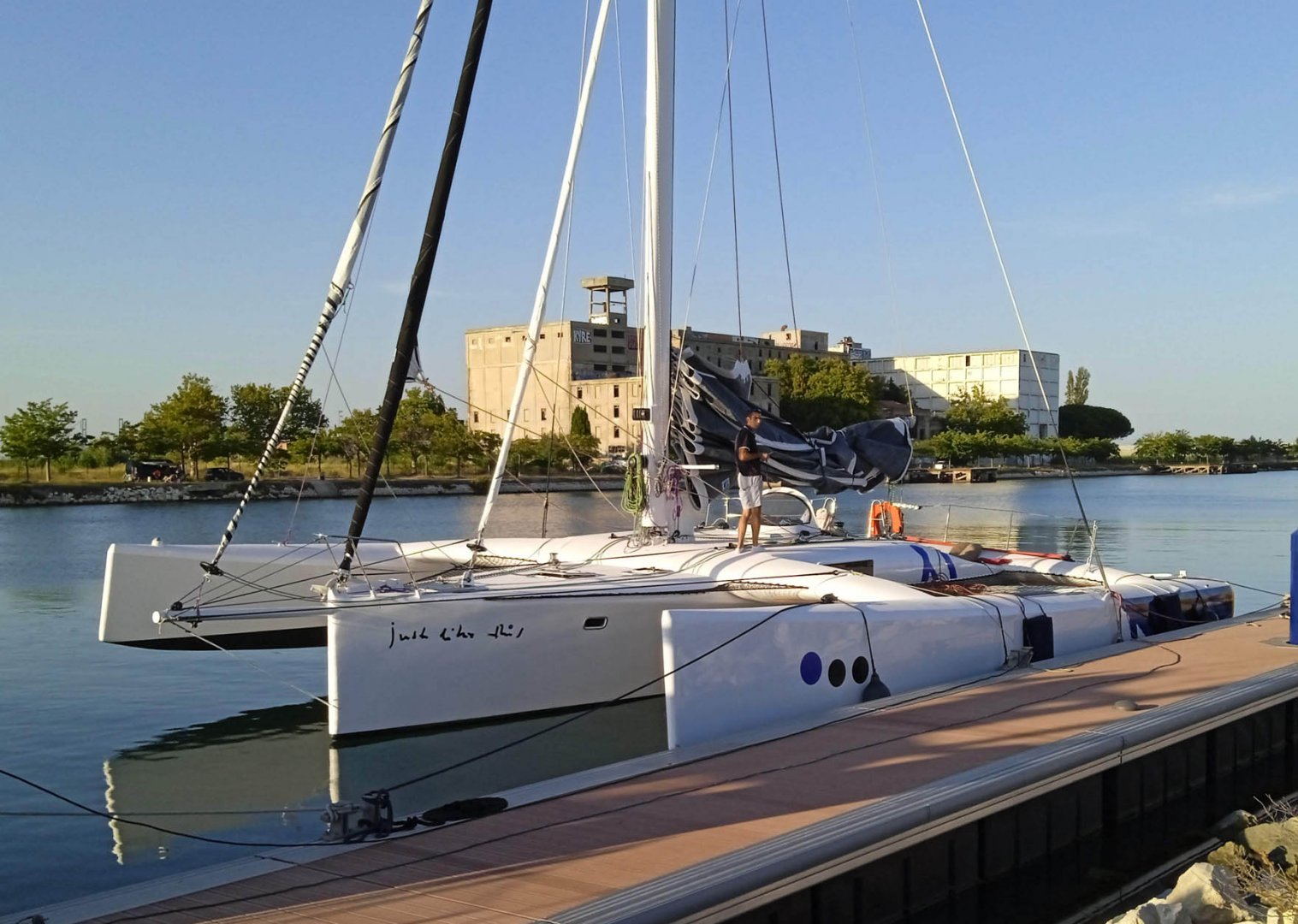

    Ever heard of the DH 50 catamaran by Dudley Dix? Dudley was asked for a 50 foot catamaran that CRW-Con in Edenton, North Carolina could build on spec for a potential customer. Dudley said he could extend and modify a Dix 470 design. Result The DH 50 (no it is not a DH 550 although it shares a lot of structure in common).
    I cannot be sure about the following but Dudley said it is a Dix 470 extended so the numbers may be the DH 50 is 50 x 25.33 foot weighing 25,000 lbs and carrying 1100 square foot of mast head rig main and jib. This is basically a fast cruising cat with eg 4 double berth cabins and a main saloon containing the galley and seating.
    If the design follows the Dix 470 structure, the hulls are 22 x 44 mm WRC stringers at about 225 mm centre lines on 12 mm ply bulkheads and 18 mm ply bulkheads for attachment to the main cross beams. 9 (10) mm ply covering the majority of the hull with radius chines. The chines are 3 layers of 3 mm ply over a short former then cut to size to fit the hull shape. The decks are either 3 x 3mm ply or 9 mm ply depending on the deck cabin curvature on very closely placed deck beams about 225 mm centre lines on cabin roof or deck stringers on fore and side decks. The underwing is 9 mm ply or forward 3 x 3 mm ply BUT it has an internal framing matrix and another layer of plywood on the inside for a total thickness 60 mm. There is Styrofoam inserts between the stringers in the underwing.
    The cross beam structures are 18 mm plywood with 2 layers of 600 gsm biax on either face and an additional 2 layers of 600 gsm biax at 45 degrees on the joints between the 18 mm hull bulkhead and bridge deck cross beams. There is additional 44 mm wide by 88 mm deep timbers on the bottom and top flanges of the 18 mm ply beams. The rudder shafts are 73 mm schedule 80 stainless steel pipe. They are put inside a 90 mm PVC pipe wrapped in 8 layers of 450 gsm biax tape. Why the detail on the structure, because bthe Dix 430, Dix 470 and DH 550 have very similar wooden structures.
    I do not know any performance figures but the numbers indicate 10 knot averages and near 20 knot peaks. If anyone knows anything more about this build please advise.
    The jpegs give the idea. The first 2 are of the Dix 470, the rest are of components of the hull and underwing build.

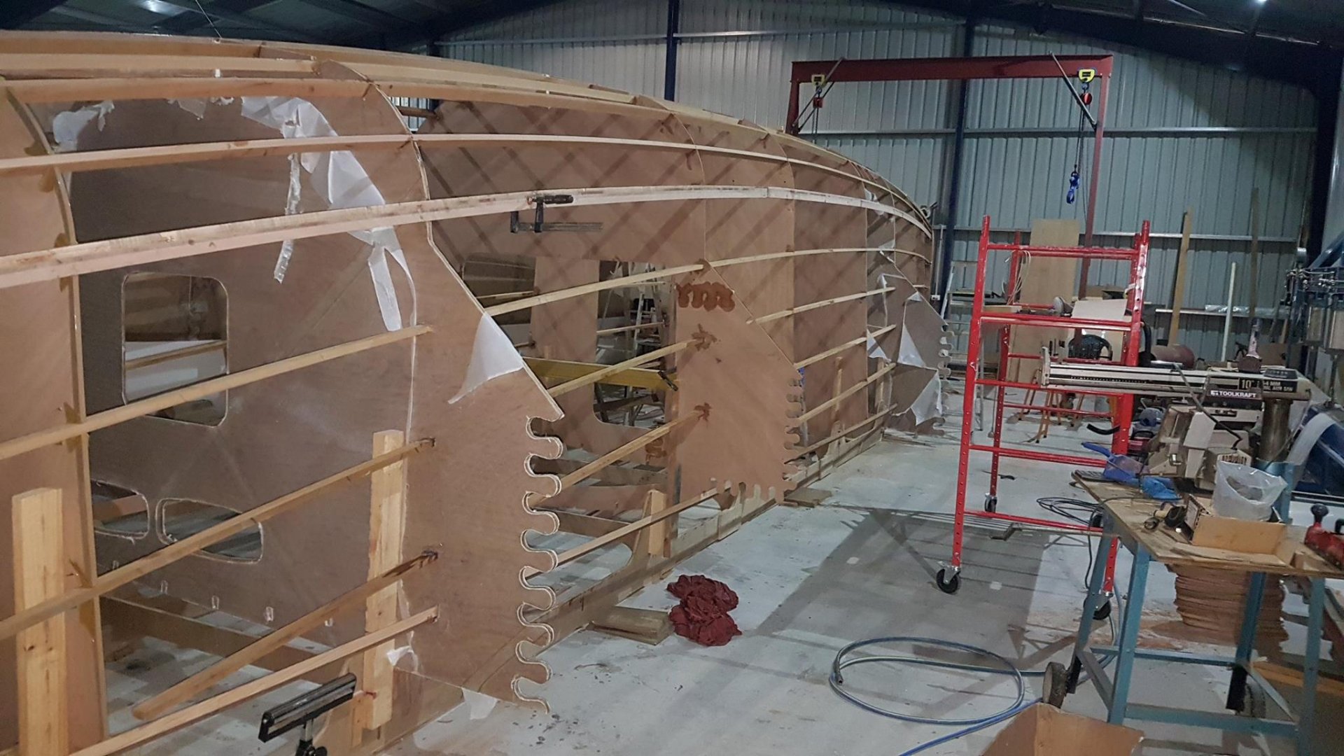

    The DH550 catamaran was designed by Dudley Dix as a family cruiser. He now have a new version of the DH550 , named the DH550 Charter. It was commissioned by a charter and has features that are better suited to charter service, in the cabins, bridgedeck accommodations and rig. This version has four equal double guest cabins, each with en-suite heads and shower. There is also a compact single crew cabin in the bows of each hull and a shared crew heads with shower in the starboard hull.
    The DH550 Charter is 55 x 28.6 foot with a weight of 27550 lbs. The fractional furling rig has a high fixed aluminium mast with a vertical furling mainsail and jib of 1293 square foot. There is an optional more conventional rig of 1435 square foot. The length to beam of the hulls is 8 to 1. The draft over the fixed keels and rudders is 3.4 foot. The power is 2 x 50hp diesels.
    As mentioned there are 4 equal double berth cabins in the hulls but the saloon is smaller than the DH550 cruiser version with more emphasis on the outside deck area. It has two galleys, one internal and the other in the cockpit. The forward cockpit, a working area in the cruising version, is changed to a social area with seating and folding table. The working cockpit has moved aft to above the outside galley, with helm and engine controls. All sail control lines, except halyard and reefing lines, are led to a pair of electric winches mounted on the cabin roof. This cockpit has large cave lockers to keep the ropes tidy and out from underfoot. This cat lives up to its name of a charter cat, guests first with space to view the world.
    The construction is ply and timber with glass sheathing as required. To give an idea of the materials required to build a cat this big, look at the following list.

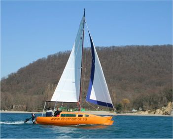

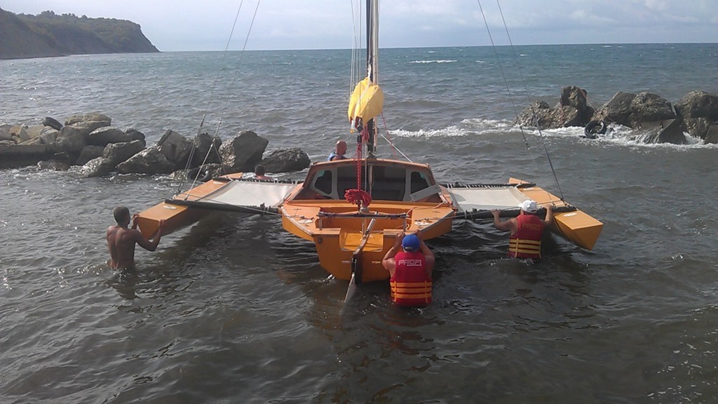

    An update of the Threefold 6 is designed by Dudley Dix to be a safe small cruising trimaran to be used as a day sailor or gunkhole cruiser. The accommodation is simple with 2 wing berths, a forward berth, a small galley and a small seat area. It has 4.5 foot of head room but with the moving hatch, when open will allow 6 foot headroom at the galley. It is a plywood timber build.
    The Threefold 6 is 19.66 x 16.25 foot in sailing format with a dock beam of 10.9 foot and a trailing beam of 8 foot. The weight is 990 lbs. The 27.5 foot mast (could be a Hobie mast) has a mainsail sail area is 152 square foot and the genoa is 113 square foot. The length to beam of the main hull is 5.5 to 1 on the 18.33 LWL. The draft is 0.66 to 2 foot. Engine can be a small outboard or electric trolling motor.
    The performance of the Threefold 6 is best described by Oleg Zelinskiy built in Russia. “In November 2008 he went out in extreme storm conditions to test his boat. With winds of 15-22m/s (30-40 knots) and gusting to 32m/s (65 knots), they sailed with storm jib and deeply reefed main. He reports that she handled perfectly, even with seas washing over the deck through to the cockpit. She achieved speeds of 15-17 knots and was responsive and under full control at all times. He says that stability was perfect and there was no hint of the boat ploughing in. Oleg is very satisfied with his testing of the boat in storm conditions.” And “In September 2009 Oleg reported that in 15-25 knots of wind he and one other crew had sailed 15 miles in one hour, with speeds sometimes exceeding 20 knots.” Brave.
    The tris construction is plywood, timber and an aluminum cross beam structure. The materials list is as follows:

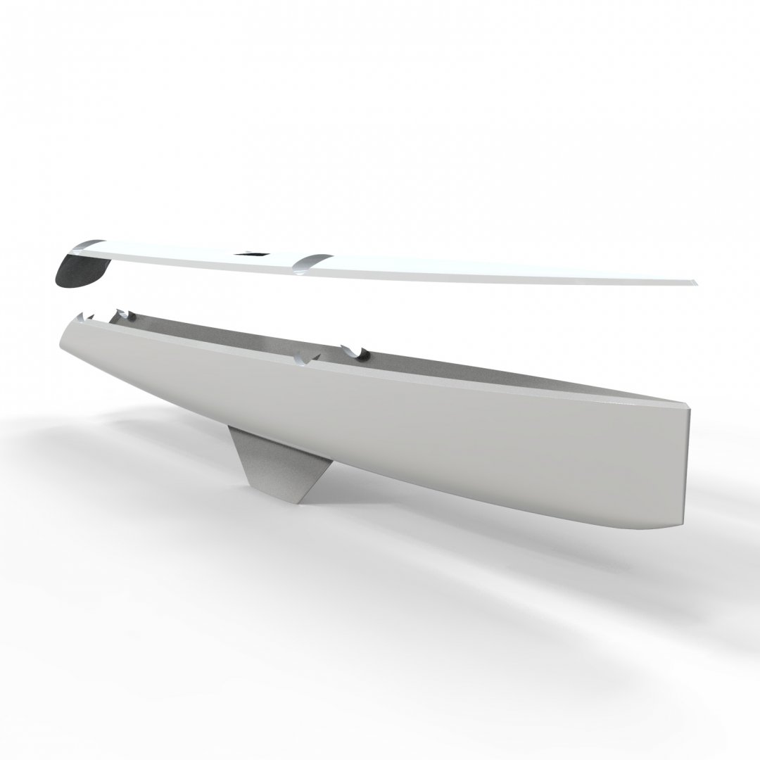

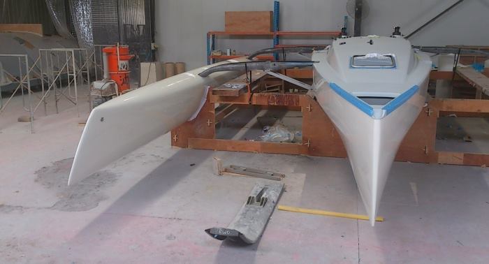

    Cruickshank Design Studio in Western Australia had naval architect Erik Lerouge design a pocket cruiser suited for the Australian coast and its estuaries. The pocket cruiser is named the Pulsar 20. In 2024, the design went into production in Fremantle Western Australia.
    The Pulsar 20 is 19.6 x 16.9 foot and can be disassembled to 7.5 foot. The weight is 1,120 lbs and the displacement is 2,130 lbs. The carbon rotating mast is 31.5 foot (spar requires no diamond spreaders) carries a fractional rig with a 205 square foot mainsail, 97 square foot jib and a 420 square foot spinnaker. The length to beam on the main hull is 6.25 to 1 and the length to beam on the floats is 13.8 to 1. The draft is 1.12 foot over the fin keels on the floats. The power is a 1 KW electric outboard.
    The beams are bolt on: The beams and floats are designed to be light and easily manageable, secured with just a few bolts. Each beam is made using prepreg epoxy/carbon in a vacuum autoclave moulding process, weighing only 20kg each. This reduces weight, complexity and cost of folding systems according to the builder.
    The accommodation is 2 single berths and an area between with shelving and storage for a minimal galley. A porta potti can be put under a berth. There is 4.6 foot headroom but with an open hatch you can stand full height.
    The boat is sold as a kit or fully constructed and is basically foam glass with vacuum infused e-glass and Kevlar in grounding areas in the hulls. The beams and mast are infused carbon fibre. The components are listed below.
    Main Deck two moldings- 8-10mm PVC foam core fiber glass and epoxy vacuum infusion molding .
    Main hull- 8mm PVC foam core fiber glass and epoxy vacuum infusion molding. Reinforced grounding zone Kevlar
    Side hull- 6mm PVC foam core fiber glass and epoxy vacuum infusion molding. Reinforced bottom/keel Kevlar.
    Side hull deck- 6mm PVC foam core fiber glass and epoxy vacuum infusion molding. Reinforced beam sockets Kevlar.
    Rudder- PVC foam carbon fiber and epoxy vacuum infusion molding
    Composite Spar- Innovative spreader less Spar 9.6m wing section carbon fiber and epoxy vacuum infusion molding.
    Beams- Prepreg epoxy/carbon vacuum autoclave molding, only 20kg
    Bulkheads/internal joinery- PVC foam core fiber glass and epoxy vacuum infusion molding.
    Bowsprit-Prepreg epoxy/carbon vacuum autoclave molding. Deck fittings-on request
    Entrance hatch/ ports/side hull hatch- PMMA/plexiglass- flush mounted ports and entrance hatch. storage hatches on side hull decks ABS plastic
    Boom- Aluminium
    The jpegs give an idea of the design and the kit components. An interesting pocket cruiser design.

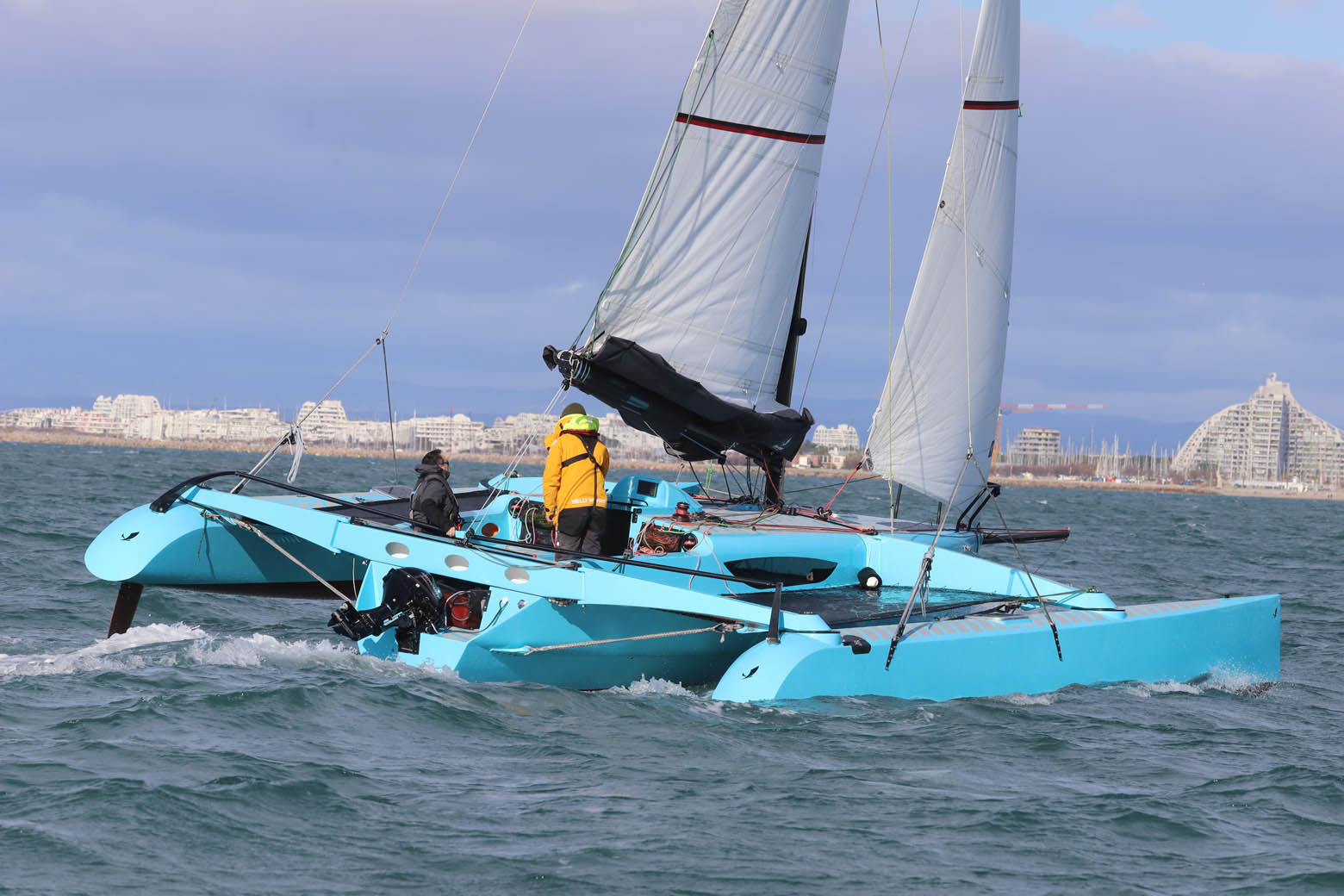

    In 2022 White Tip (company) commissioned Yacht Design Collective to design a trimaran. They then asked Cape Performance Sailing in South Africa to build the tri on a production basis starting in 2025. The first of the 3 initial orders was done by Thomas Wilson's new regatta school, the White Tip Race Academy, based in Haslar, near Portsmouth in southern England. So, if you want some fast sail training this may be the place to go.
    The CAPE-WT 10M is 32.9 x 27.5 foot and can be folded to 11.5 foot with a Farrier type folding system. The “displacement” is 4,630 lbs (more likely weight). The rotating (assume) carbon fibre mast carries a 452 square foot mainsail, 312 square foot genoa and an asymmetric spinnaker of 1017 square foot. the draft ranges from 1.4 foot to 5.95 foot over the float based daggerboards. Power is with an outboard.
    The accommodation is 2 double berths, a separate toilet shower area and the main saloon which contains a galley down and minimal navigation aft with a seat table combination forward which can convert to a single berth. The main saloon has 6 foot headroom. The cockpit is large and capable of sailing with 6 people.
    The aim of this tri is to be a high performance racer cruiser of which the designer/builders claim its capable of 30 knots. Seacart 30’s have a very hard time reaching 30 knots and Seacart 30’s are lighter and capable of carrying more sail. When I read a real test, performance report, I will accept 30 knots otherwise my guess is maybe 25 knot peaks and 10 – 12 knot averages in good conditions.
    The construction by CAPE, if it follows the same structure as a 30 foot monohull racer CAPE build, is infused e-glass vinylester resin. There will be some carbon fibre in the cross beams and other stress points and foils. CAPE knows how to build a light fast boat that is structurally sound.
    Yacht Design Collective also have designed a lot of the latest Corsair tri’s and understand what is need to get a good cruiser racer, so hopefully the CAPE WT10 will perform very well.
