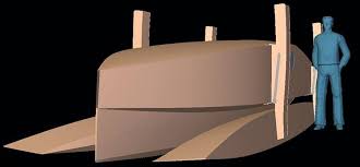

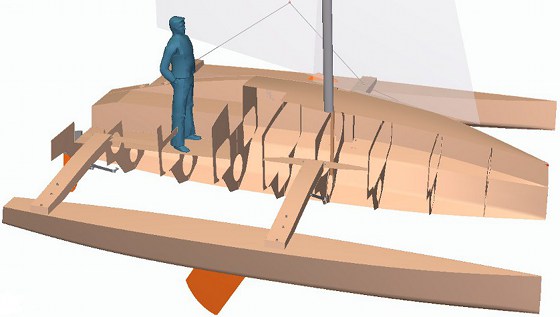

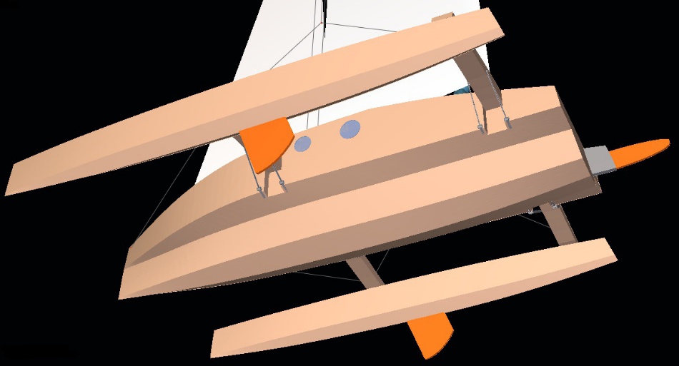

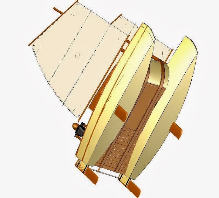

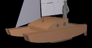

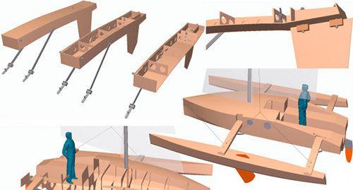

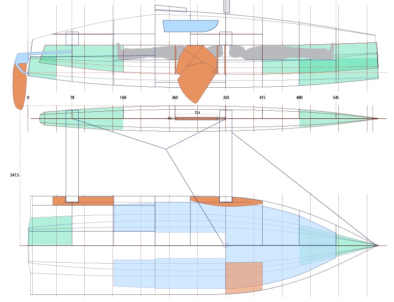

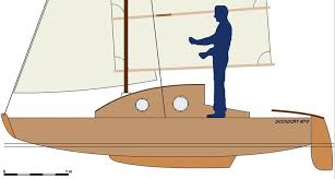

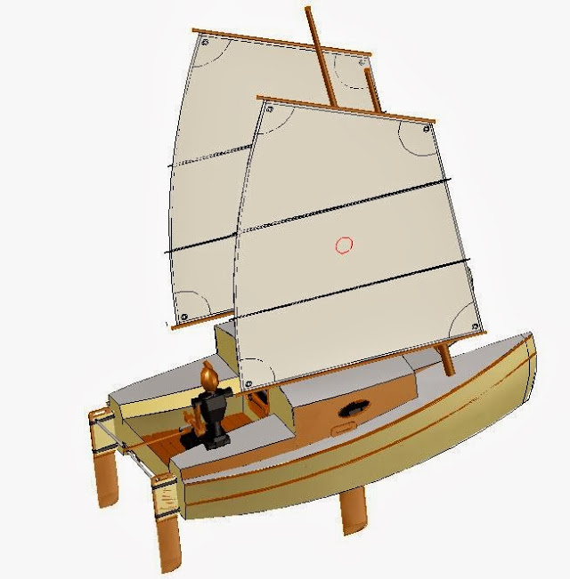

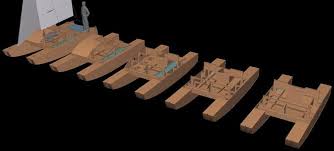

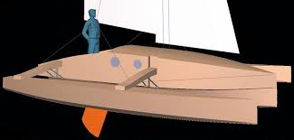

    An interesting designer is Jerome Delaunay. He has mainly designed scow monohulls for river and bay sailing. He did a Scow cat 3D study which is 15.4 x 8 foot displacing 1350 lbs with 10:1 hulls. Jerome did not complete the plans as he though a mono would have more room. But the Scowcat looked interesting even with those blunt bows.
    Jerome also did a full design of a good little plywood trimaran that is trailable. It has Farrier type folding built in ply and uses water stays. The Triops 620 is 20 x 16.4 foot that folds to 7 foot. The tri weighs 1000 lbs and displaces 1700 lbs. It uses a hobie 21 rig of 250 sq foot of sail. It requires 27 x 6mm plywood panels that are taped together with a minimal of stringers. Plywood bulkheads are every 600 mm. There is a T foil option on floats for those who have a need for speed.
    Finally his 420 scow monohull design is free to download. His site is Plywood sailboats plans, pocket cruisers sailboat plan, plywood epoxy boat, DIY boats, junk sail http://www.nautline.com/sailboat_plywood_plans.php

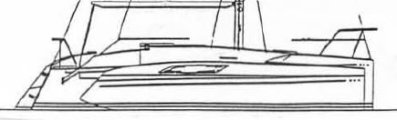

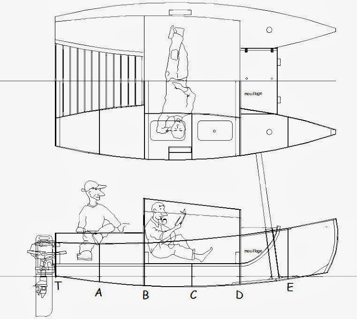

    Catkadec is a partially conventional small catamaran from France 14.5 x 8 foot weighing 1100 lbs with a biplane rig of 190 square foot (4,46m x 2,50m; 2 x 8.85m², displacement unloaded +/- 500kg, draft 0,15/0,75m). Catkadec is for people with a cruising ambitions but short on money. Simple, fast to build, junty in style and interesting to sail on bays or rivers. It has 7 : 1 hull ratio to carry the weight as this boat will reasonable in performance but not fast. It has a simple rig that can be home made. The wood mast is 14.5 foot above deck 90 mm at base and 50 mm at the tip with 95 square foot of junk sail per rig. The masts could probably 90 x 3 mm aluminium tubes. The majority of the boat is 6 mm plywood with 4.8 mm ply on hull sides. The crossbeams are 150 x 50 mm on transom, cabin and forward bulkheads. Don’t overload this boat as the underwing clearance is only 200 mm. A bit of fun. plan de catamaran http://www.boat-et-koad.com/plan-de-mulitcoques.php

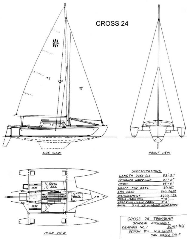

    Norman Cross is a trimaran designer who was in in aerospace then designed a series of plywood tri’s of which thousands have been built in the 70 – 90’s. Some of his tri’s were advanced and fast for there time. His cruising boats were big and comfortable and very well liked. There are some people today who would build a Cross tri if plans were available. To give an idea of his faster designs I will show you 2 boats The 32 R and 36 R. Both were racing boats which featured Cross’s special fin keel approach which gave a lot of his boat’s good windward performance. Attached is a PDF explaining the theory of the fin keel and how it is integrated with a main hull. The 32 R displaces 5500 lbs is built mainly from 6 mm ply and double moulded 3 mm ply for 6 mm thick hulls. The 36 R displaces 8000 lbs is built mainly from 9 mm ply and has 3 layers of 3 mm ply double moulded for 9 mm thick hulls. Crossfire was Cross’s personal 32 R tri and was very successful race boat in California. It was built after the Newport Esanda race changed the rules to demand 4 crew on a boat. Cross sailing a Cross 24 foot tri had won the previous year with 3 people. Mono people got mean in those days when cheap small ply tri’s embarrassed them. Sorry but your going to have open PDF’s for the study plans etc.

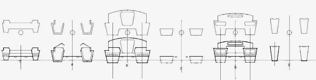

    The following PDF is the hull lines and table of offsets for a 30 foot multichine main hull and floats of a trimaran. The boat was designed by Leonard Sussman, a man ho designed many light fast tris and did several production tri’s. The design was done for solid glass hulls so could be adapted for ply or foam glass. If there is any further interest I can add to the design details but a lot is given in page 12, comment number 179. TTLF asked for the lines sorry I took so long to deliver the lines.

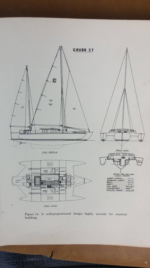

    Norm Cross developed many hard chine trimaran designs that were simpler to build than the round bilge models. In the 30 to 40 foot range they ranged from spacious cruisers such as the 10.5 meter, a moderate cruiser like the 37 or an all out racer like the 39 R hard chine racer. The 39 R has simple clean lines but one owner in cruising mode said it was not fast unless it was driven hard. The 39 R appeared to have a “hump” speed that needed to be pushed through. The 10.5 meter proved to be a popular design because of the accommodation but it would only be a reasonable performer due to its displacement for its length and its wide mainhull waterline beam for its length. The forward table would be interesting in a seaway. There were several 37’ built but most were extended to 40 plus feet to provide sugar scoops in the stern that helped their motion. The ketch rig was also upgraded to sloops on several. The 30 foot design was a popular model and was done as an alternative to Piver’s 30 footer. There is also a partial construction plan of the 30. PS this is only part of Cross's design range, it was very large from 18 footers to 80 footers.

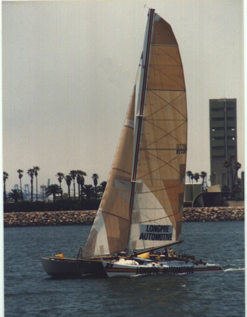

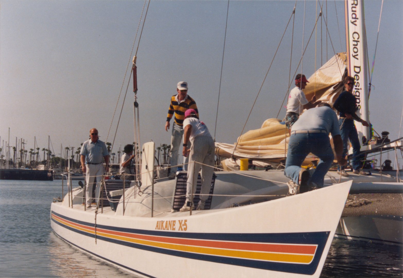

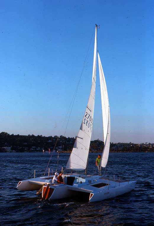

    Aikane X5 was a 62 x 31 foot racing cat that weighed 10,000 lbs and displaced 14,000 lbs. It carried 2000 sq foot of sail. It was a CSK design that successfully did transpac’s etc. It held the record at 6 days 22 hours averaging over 14 knots. Finally it was converted to a charter yacht and was wrecked in a Hawaiian storm. The interesting part of this cat was its low tech build and its asymmetric hulls. It’s low tech build was with cold moulded plywood hulls (about 10 mm thick) on timber stringers and frames with aluminium crossbeams initially. The crossbeams were converted to timber carbon fibre at the same stage as an 80 foot Randy Smyth designed wing mast rig was installed. After this X5 did most of its record setting. The asymmetric hulls were over 15:1 length to beam but Roy Seaman, (son of Warren Seaman of CSK) and helmsman on Aikane X5 when it broke the TransPac record was not a big fan of asymmetric hulls. His said that up to a certain speed they make sense. Aikane X5 was capable of speeds above 30 knots. Roy claims that at about 25 knots the boat would 'shudder'. The Randy Smyth designed rig was very powerful and wanted to push the boat faster than 30 knots, but the hulls, being asymmetric, wouldn't go through the water as efficiently as the rig needed. It was a planning issue...he said the hulls wanted to 'break out', but couldn't because they didn't plane at all, like a D-section hull would ala Tornado, Nacra, etc. Roy said asymmetric hulls are great for cruising, not having to worry about skegs, boards, etc and having a very shallow draft. Although, you cannot load up an asymmetric hull as much as a D-section hull.

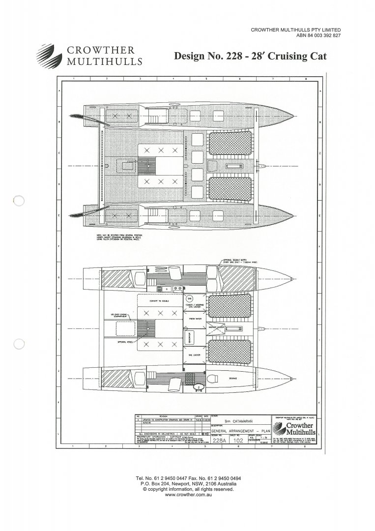

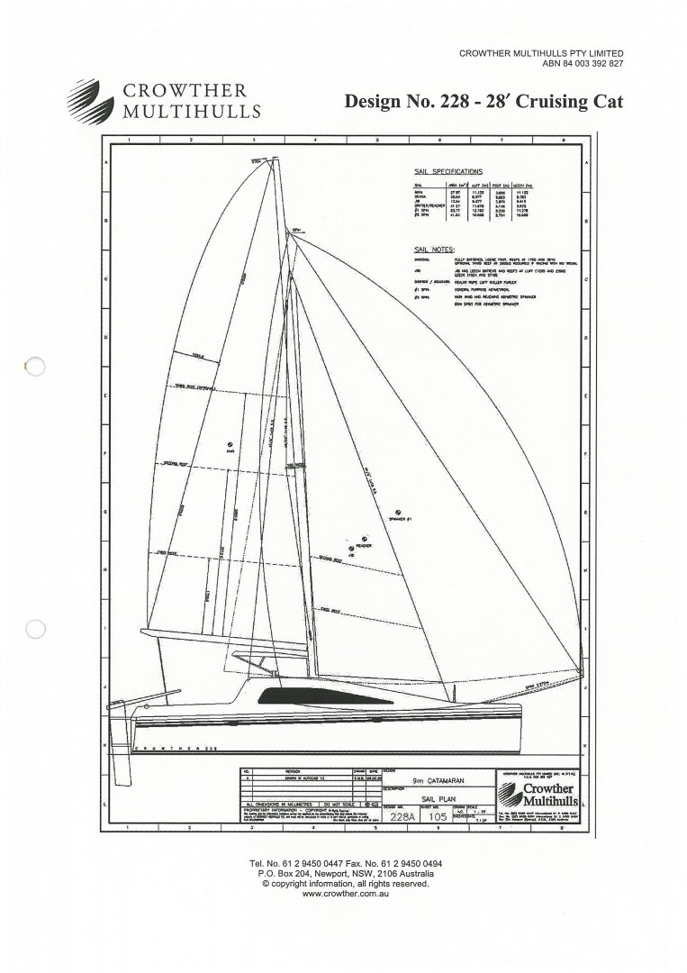

    We will now do a series on Lock Crowther catamarans from 28 to 60 feet. There will be a 28 foot cruiser racer, 40 foot racer, 42 foot cruiser, 50 foot racer, 58 foot cruiser and 60 foot racer. All these boats were designed before 2000 but the glass layups, foams etc are still relevant. We will start with design 228 a 29 x 18 foot tube cat that weighed 2500 lbs and displaced 4500 lbs. The 39 foot fractional mast carried 520 square foot of sail. The hulls could be foam glass or strip plank WRC. The foam glass hulls and decks were 650 gsm triax outside 15 mm H80 pvc foam 550 gsm biax inside. The outside laminate was doubled below the waterline. Bulkheads and underwing were 650 gsm biax both sides of 15 mm foam. The cross beams were box sections with foam glass web faces and top and bottom unidirectional E glass flanges. The strip plank hull version was 550 gsm e glass biax inside and out of 12 mm WRC. 550 gsm e glass is used either side of 12 mm duracore in bulkheads and wingdeck. The same cross beam structure’s as in the foam glass boat. The whole boat is taped together with 550 gsm 200 mm wide tapes. The daggerboards and rudders were WRC shaped and glassed over with 550 gsm biax. One boat named Piglet was successful in racing in Queensland and made a fun short term cruiser.

    garydierking Senior Member
    I built the timber crossbeams that replaced the aluminium pipes on the X5. There was no carbon fibre in them just spruce timber and birch plywood. The hull asymmetry was so subtle that you wouldn't have noticed it. Rudy always claimed that they steered better in a seaway with asymmetric hulls.
