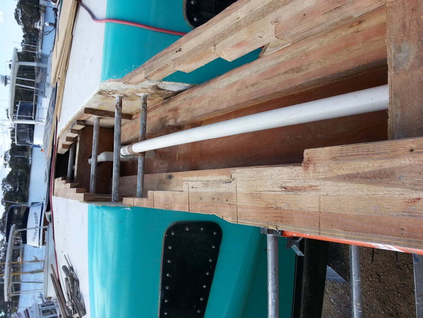

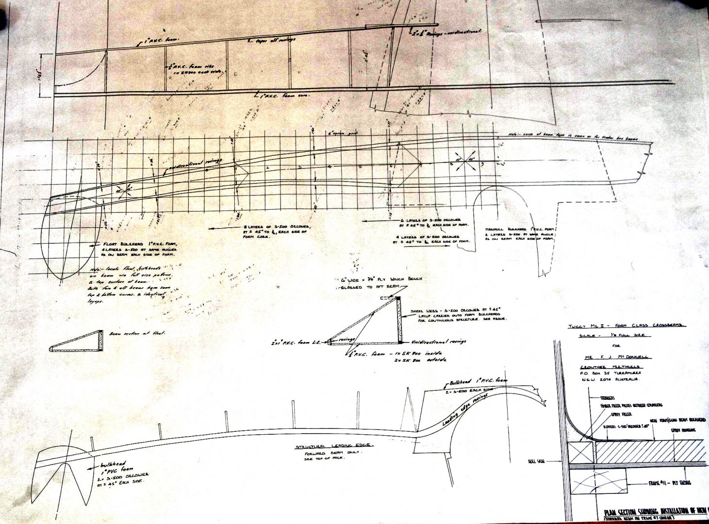

    Trimaran crossbeam structures are an interesting area. Many famous designers have had a broken trimaran cross beam in their past EG Derek Kelsall wrote a book about a 35 ft racing trimaran FT and its cross beam troubles. But in this post we will talk about the crossbeam changes in design for a Twiggy 32 x 29 foot 4200 lbs displacement tri with 680 square foot of sail. The boats righting moment is 55,000 foot lbs. The original design had a plywood wood box beam with water stays, The beam is 255 x 380 mm box with 12 mm ply fore and aft faces. Top and bottom faces 9 mm ply. In each corner of the box is 5 layers of 19 x 45 mm laminated timber to a 45 mm high x 95 mm horizontal flange that goes full width of the beam. Two water stays of 8 mm 1x19 SS wire are attached to each side of a beam from just beside the float to 500 mm down the main hull. The beams were strong enough but were heavy. The twiggy the beams were upgraded to foam glass beams which were several hundred of kilo's lighter. The foam glass beam has a 25 mm divnylcell foam web with 5 layers of 500 gsm cloth on each face. The top and bottom flanges are 25 x 40 mm of uni directional glass in the centre tapering to 25 x 15 mm in the ends of the beam. When doing these unidirectional flanges DONT lay them up in one go. They need to be progressively laid up over 24 hours as one thick lay up builds up to much heat as it cures and often fractures the layup. Also each uni directional layer need to be tensioned to ensure the fibres are straight. Finally use epoxy in the flanges as it is "stronger" than polyester etc. On the front of the beam is a triangle of 12mm foam triangle with 2 layers of 500 gsm on each face. The triangle acts as a torque box. Attached is a photo of the original beam and a plan of the glass web form the web.
