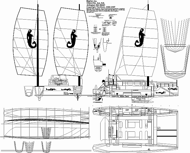

    Bigcat 1950. Just want to know if you are the same person who had plans for the following? If so did you go ahead with the project? We could all learn a lot from your experiences. The following is a write up I found.
    65' Catamaran, radius chine, wing sail
    Radius chine, wing sail, unstayed masts, vinylester, balsa, hard chine, full floatation, buoyancy, amateur construction, home built, vacuum bagged, vacuum infusion, resin infusion, junk rig, Polynesian, , laminating table, tandem rig, bi-plane rig, catamaran, multi-hull, polyurethane, shoal draft, balanced rudder, keel, skeg, Tim Dunn, Seattle. I have deleted the old web address for privacy but if you have a current web address to share, good.
  7. BigCat1950
    Joined: Nov 2018
    Posts: 20
    Likes: 1, Points: 3
    Location: Seattle
    BigCat1950 Junior Member

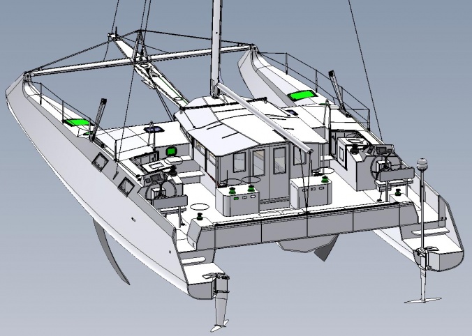

    Fujin is an interesting cat for several reasons. But its main reason is about where the edges of a racer cruiser design are. Fujin is 53 foot long and displaces 6120 kgs (13700 lbs). Its top speed was reported at 31 knots just before it capsized in a Caribbean race. The boat can partially foil. The boat has been rebuilt by Gold Coast yachts and is racing again. The designer and owner wanted a high performance cruiser. This they designed and got one and more. The interesting features are the raised bow pieces so forebeam can clear the water. The central pod to allow full headroom in the central cabin but keep the cabin profile low. The chine bow to add buoyancy but reduce width on deck to assist in recovery from a bow dive. The foils on the rudder and curved dagger foils to provide lift.

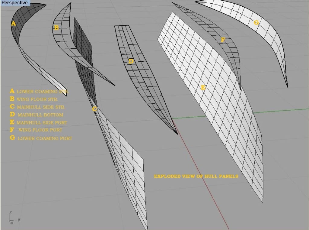

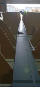

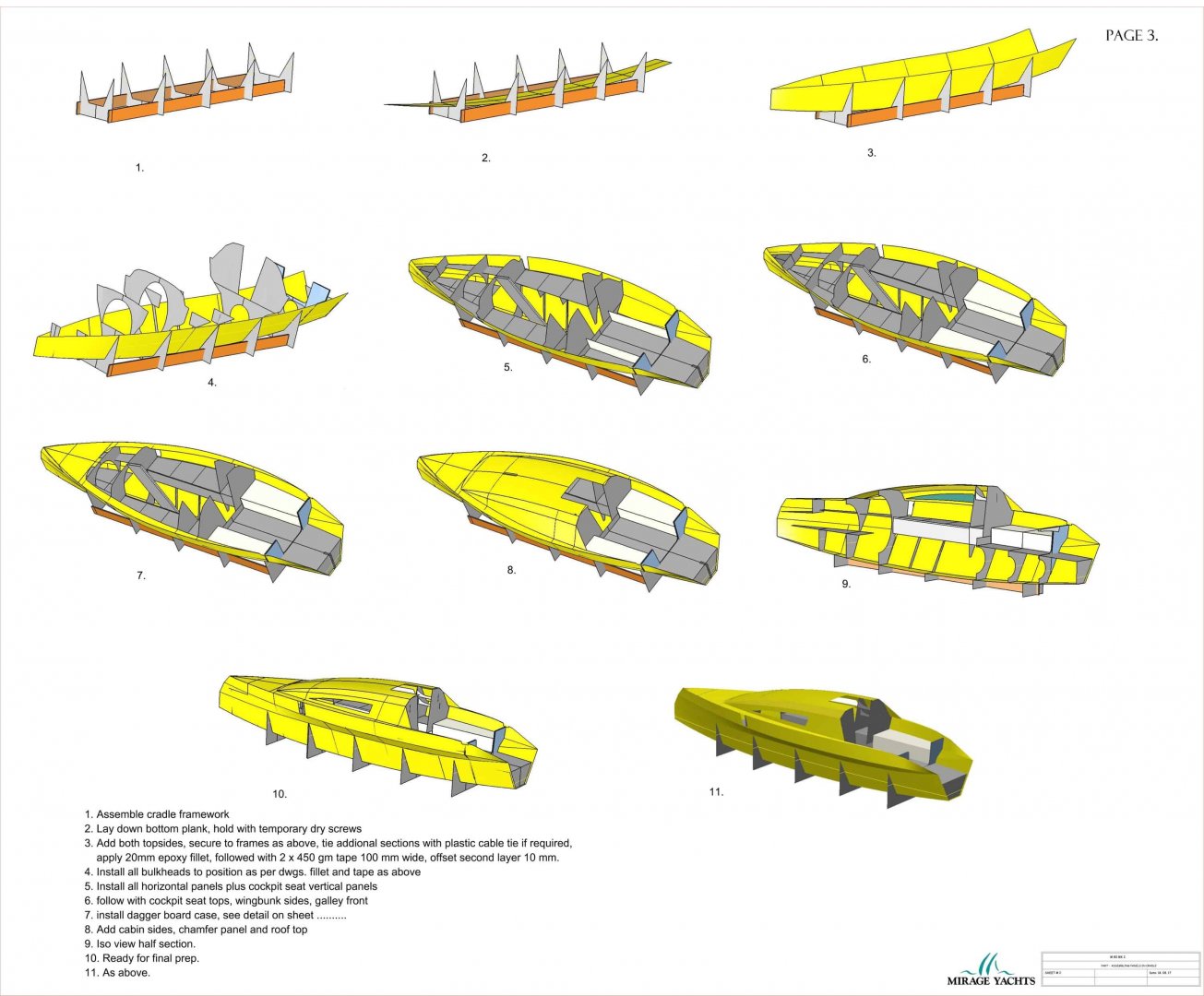

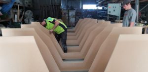

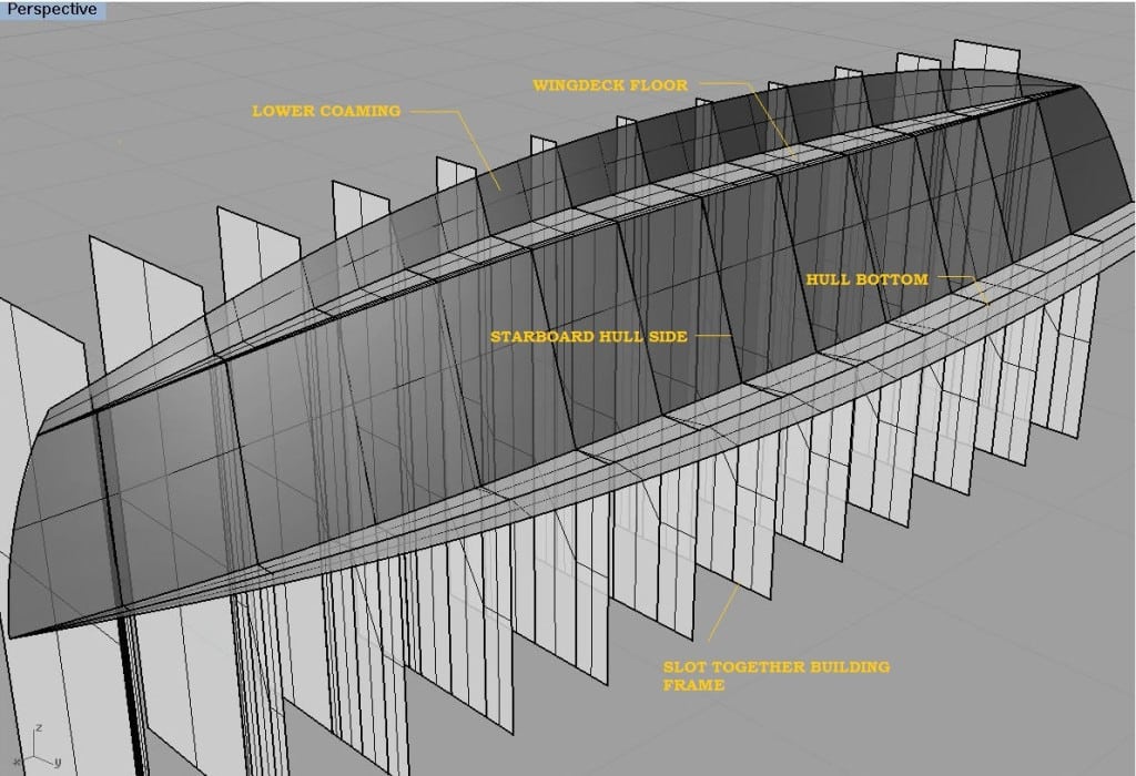

    For simpler multihull shapes that uses mainly flat panel materials there is a build method that is easier. I will use Wayne Barret M series of trimarans to demonstrate but many other designers use the same technique. The M series can be built in ply or foam glass. The M60 gives an idea of the shape of the boat and its main hull. First you cut out frames in MDF, set up the frames then cut out the panels for the boat then put the panels into the frames and tape the interior joints. Insert bulkheads next and tape them in. By now you have strong structure that can be taken off the frame rolled over and the outside finished. The designer needs to provide accurate patterns for each panel that will inserted into the frames.

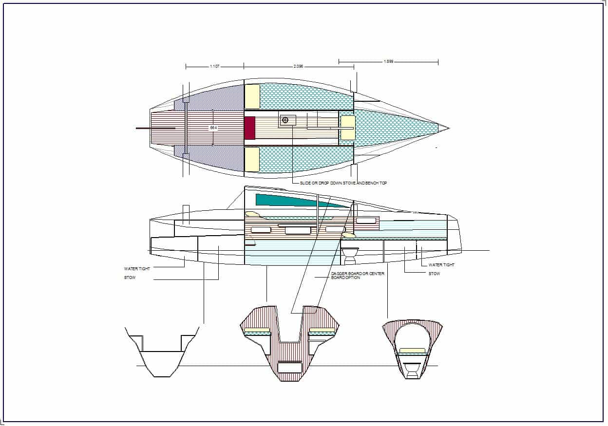

    For those that like ultra high performance multi's the Seacart 26. This boat is less high tech than its larger sister Seacart 30. The 26 is more of a day sailor. A fun design.

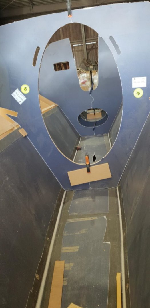

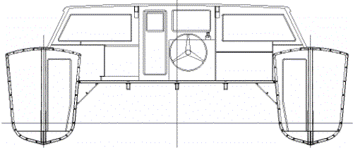

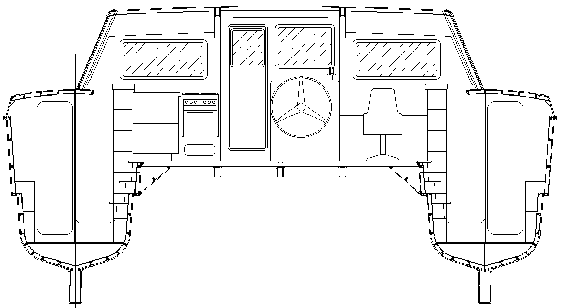

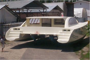

    Following from the post about the M series of trimarans build approach I will show another designers approach. Kurt Hughes has more rounded hull shapes for his boats and as a result uses slightly differing techniques. He resin infuses panels that are flat or nearly flat, places those panels in a MDF frame structure, then adds strip plank foam glass strips at chine joints giving a nearly round hull shape. The final glass layers on the chine is then done. Dudley Dix does the same with his cats but they are mainly plywood. The attached gives the idea. The first 2 pictures are of Dix 55 foot ply cat the last is o Dix 43 ply cat. The boat can also be done in foam glass.
  15. Slingshot
    Joined: Aug 2019
    Posts: 22
    Likes: 3, Points: 3
    Location: South pacific
    Slingshot Junior Member
