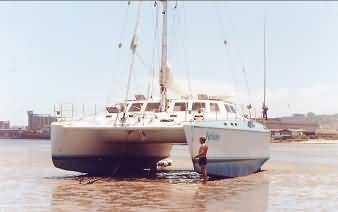

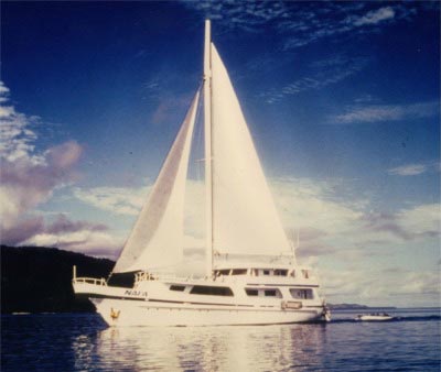

    Fallado is an interesting cat designed by Harm Venema and built 1990. LOA 44 ft BOA 24 ft Bridge deck clearance 0.8 metre Draft 0.7metre Main 48m2 Genoa 45m2 Gennaker 80m2. The design and build contracts said the boat had to be capable of sailing around Cape Horn. The boat has sailed around the globe via the four Southern Capes. This is the toughest boat for its size I know. Fallado's has flat bottoms and is constructed as follows:
    - a superstructure built with West System. One inch duraKore (a sandwich of cross grain balsa and 1.5 mm hardwood on either side) sheathed in fiberglass and epoxy, 2000 gsm glass on both sides with Kevlar on the bottom and in stress areas.
    -a solid base to the hulls built up from 5 layers of 8mm strip planked cedar for a thickness of 40 mm with 2000 gsm glass and Kevlar layer. This is reinforced -five bulkheads, the three main ones are 82 mm thick, 8 mm plywood either side with internally framed 50 x 66 mm timber and foam. The main bulkhead is reinforced to allow for 40 tons of load.
    -the bridgedeck is built in the same way, 82 mm thick, 8 mm plywood either side with internally framed 50 x 66 mm timber and foam.
    -deck is 16 and 24 mm duracore and glass.
    - aluminium cross beams fixed laminated into the hulls, rather than hinged on by metal fittings, taking some of the load which would otherwise be taken by the hull bridgedeck connection, an area many designs have problems with.
    - a skeg in front of the rudder giving protection to the rudders.
    - rigging features are over dimensioned for extra strength and durability. The 7/8 sloop rig has a diamond stayed mast with a slight bend achieved through two pairs of spreaders facing backwards and one facing forwards, making the mast less likely to pump in heavy seas.
    Performance. In 15 to 17 knots beam reaching it can clock 200 mile days. Depending on the sea state, the boat can keep an apparent wind angle of between 40 and 50 degrees, which compares with the average cruising boat. Fallado's designer wanted to incorporate daggerboards to enable Fallado to point higher to the wind; however, the 8 degrees improvement was not worth the hassle and were dispensed with.
    Fallado weighs about 11 tons, fully laden for an ocean passage. She is not a light weight designs. Look at the workshop the boat carries. It could repair almost anything.

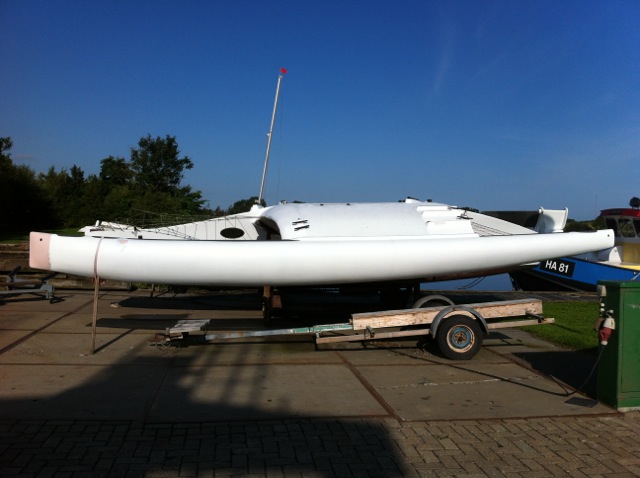

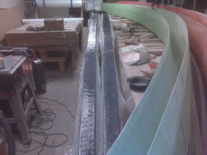

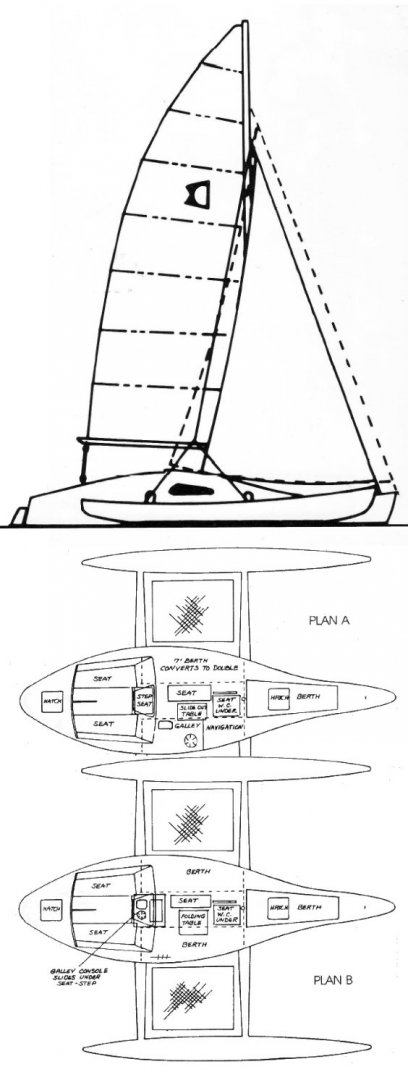

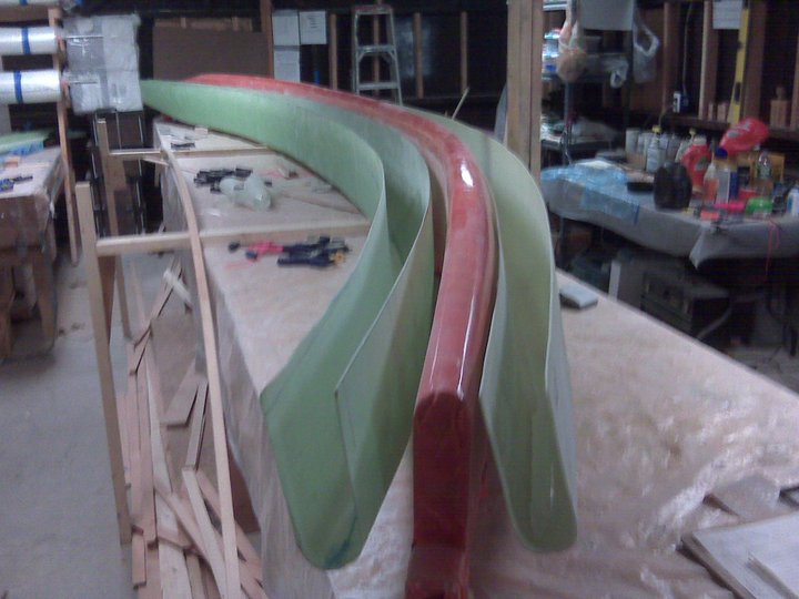

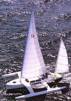

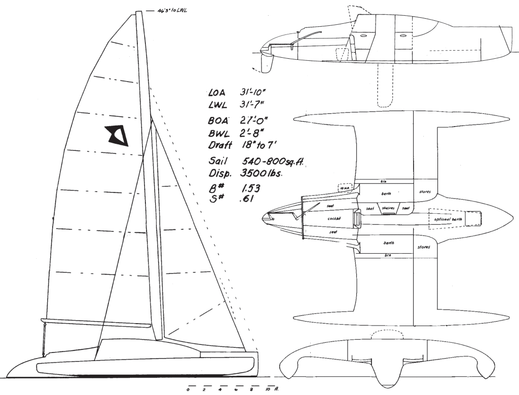

    Trea is a newick trimaran that is half way between Tremolino and a Val. She is 26 x 21.5 foot weighing 1600 lbs and displacing 2600 lbs carrying 402 square foot of sail. The boat was slowly being built in the US and I do not know if the design is in the water. The mainhull has 2 x 400 gsm double bias outside 9 mm airex foam 550 gsm biax on the inside. The float is the same structure but has a carbon fibre strip on the inside skin at the widest point the full length of the float to add stiffness fore and aft of the crossbeams. Decks are the same structure as the hulls. But now we go onto the crossbeams. These are structurally sound but very hard to construct. The cross beams ends in an I beam 75 mm wide and 66 mm deep. The I beam is constructed from 2 x C channels that are glued back to back. The C channels are made from 4 x 400 gsm biax laid into a mold. After the channels are glued then 4 or 5 layers of unidirectional 340 gsm unidirectional carbon fibre are laid on the top and bottom of the I beams. The fairings are then molded up for the forward beam. The fairing is 300 long x 68 mm wide D section that is 4 x 400 gsm biax. The rear beam fairing is 3 x 400 gsm biax. All the boat is done in epoxy and post cured in an oven for additional strength. There are waterstays on the crossbeams. The mast is 10 meters high wing of 300 x 175 mm in carbon fibre supported by 3 wires. Main is 306 sq feet, jib is sq 100 feet.

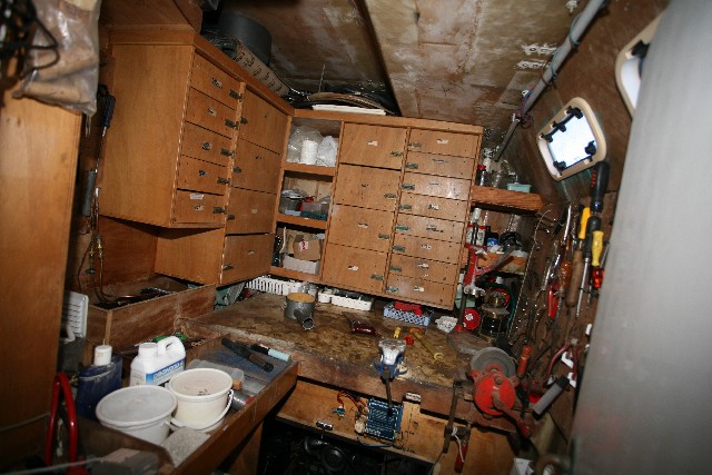

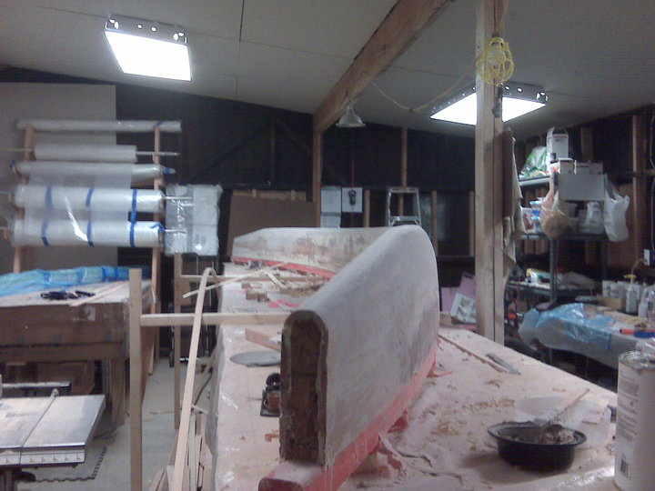

    Further Trea photos with the post curing oven that can "cook" a complete x beam or hull half at 40 to 50 degrees C. Also photos of a completed 28 foot version of the boat.

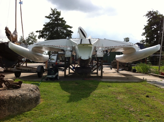

    Trea is interesting with the information obtained from the builders facebook account and a previous web site. I have done some calculations and are finding some inconsistencies between the claimed number of glass layers and the thickness shown in photos. Please take the information as guidance not a definite statement. The following is a collection of Newick’s work which shows his range of skills. Ms Patty was an earlier catamaran. Summersault 26 was a production tri. The Spark was a one off that was built several times. It performed well and was followed by a 35 foot version White Wings. The Val is the full wingdeck version with some detail of the Val wing mast. And finally Traveler a superb 48 foot cruiser. All works of design art that sailed very well.

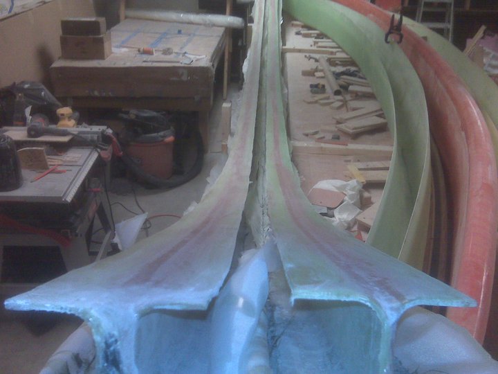

    This is the first in a short series on Carbon fibre, build processes and associated problems. Most of the words come from the web but reflect my view. A large yacht suffered the loss of its carbon fibre mast after only a few days in service. The mast was manufactured in two U-shaped sections adhesively bonded along the neutral axis (port/starboard line). There were various apertures along the mast to allow for access to hydraulics and rigging attachment. Each opening in the mast results in a change in the local stress. The stress directly above and below the hole is less than the nominal stress, however this is only a localised effect and diminishes with distance from the defect as the matrix redistributes load to fibres bisected by the hole. Effects like this are understood and can be modelled however this must be done early in the design process and details that are likely to cause stress concentrations should not be grouped together as they will have a cumulative effect in weakening the structure. The mast failed under considerable compressive load, induced by tensioning of the rigging and the mass of the mast and rigging itself. The failure occurred at an area containing a large number of grouped orifices that lead to a weakening of the structure at that point.
    Failure prediction and conclusions.
    In isotropic materials, failure can be predicted by assessing if a component will first collapse or suffer fast fracture; crack propagation can be predicted by stress intensity calculations based on linear elastic fracture mechanics (LEFM). LEFM assumes the materials properties are isotropic and the material responds elastically to loading, allowing for a small (in comparison to the crack length) plastic region at the crack tip. The theory hinges on Griffith’s energy balance which states that when the strain energy released by a crack’s growth exceeds the energy required to produce the crack flank surfaces, the crack will grow. In PMCs, there is rarely a single crack tip and the material is at best quasi-isotropic and so the calculation of critical crack lengths or stress intensities is unreliable, however the technique can be used to find the increase in toughness generated by certain failure mechanisms like fibre pullout and crack deflection.
    Cracks can propagate in a number of ways and their paths and interactions are controlled by a number of factors including the mode of loading, fibre/matrix interfacial bond strength and the environment of service. There are so many possibilities it is difficult to predict precisely the progression of a failure. In fatigue situations, it is usual to measure the damage accumulation rather than measure individual crack development.
    The reasons for failure can be very wide ranging, but there are several problems to which carbon fibre structures can be particularly prone. Due to the brittleness of the reinforcement, failure mechanisms that increase toughness of the material such as fibre pull-out are less effective as the fibres break before significant crack bridging can be achieved. Delamination (where cracks progress between adjacent plies) often results from an impact and can occur several plies beneath the surface where it may go unnoticed. In tension, the presence of these splits will often cause no problems but in compression, they can cause premature buckling of the structure.

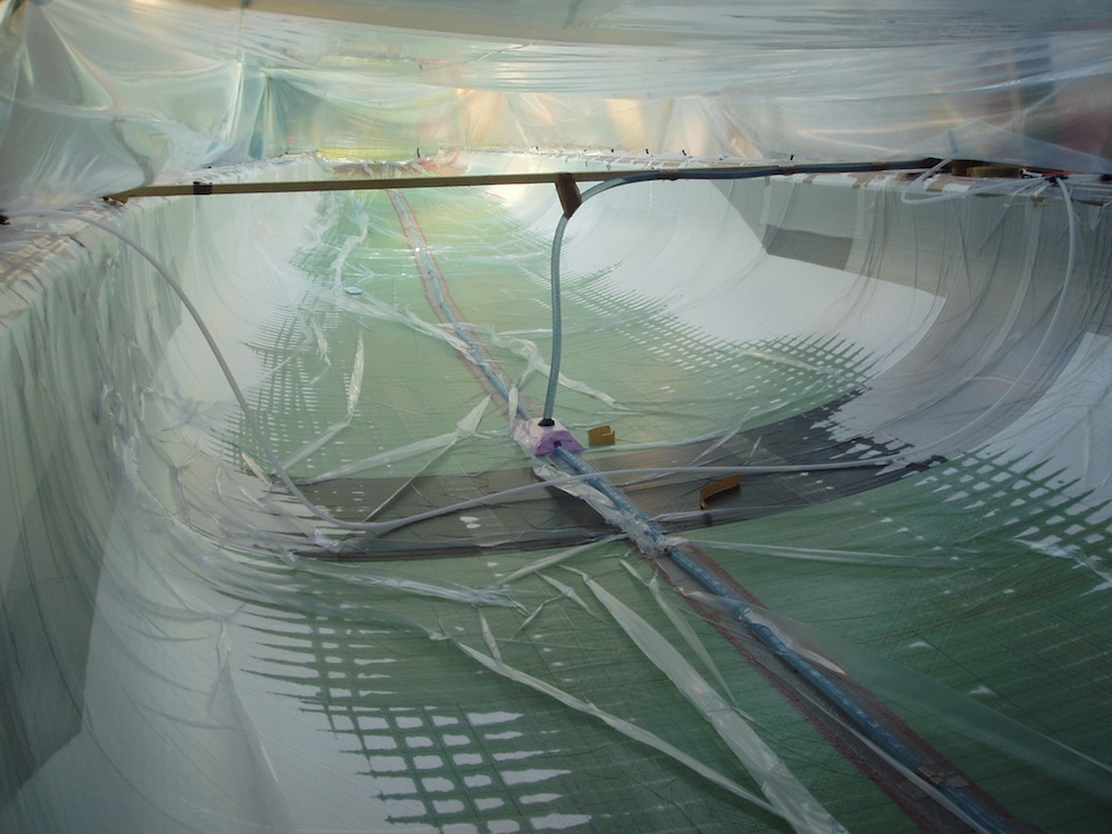

    Attached is a view of resin infusion process of a outrigger for a 43 meter (141 foot) power trimaran. I would love to own the hose and fittings contract for the vacuum bag.

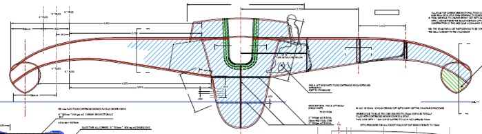

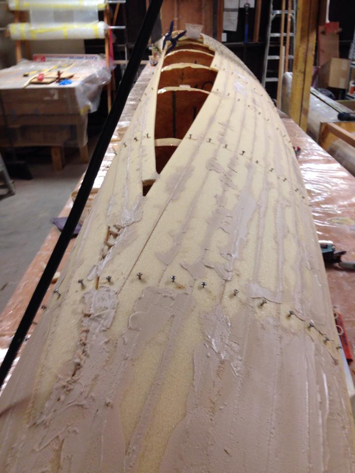

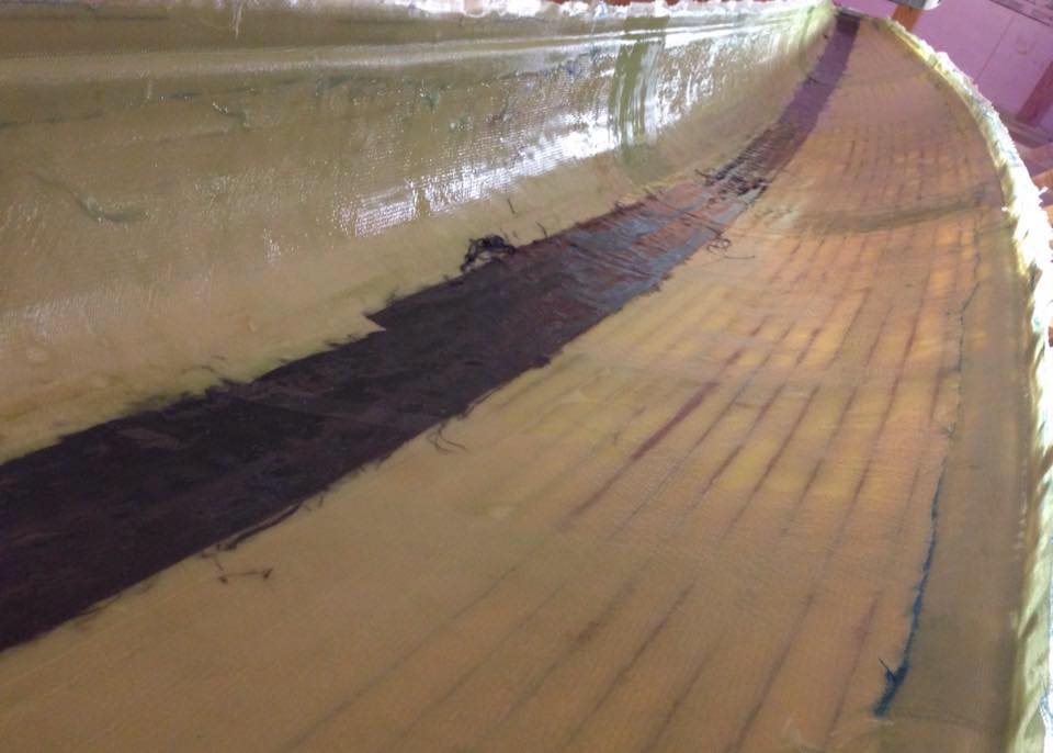

    Adding to our knowledge of the R42 Grainger trimaran. It is a project that explores the boundaries between a high-performance cruiser and a lightweight racer with a fine main hull with just enough creature comforts below decks to cruise and race. ATL did this write up.
    Construction
    Engineered by Composites Consulting Group (CCG) to Category A Offshore, the R42 designed by Tony Grainger, is the latest high performance trimaran under construction at Australian Custom Multihull Yachts at The Boatworks on Queensland’s Gold Coast.
    The mould frames and strongbacks are made from 16mm MDF that were CNC machined by ATL Composites from electronic cutting files. The cutting files provide slots for fast assembly and the building forms are stabilised by locking the joints with epoxy fillets. The beams are symmetrical about the athwartships axis, so one set of female tools can be used to build all of the beams. The primary beam is a box structure that sits inside the fairings. The fairings are non-structural, so the laminates are quite light.
    The main hull planking material is made with DuFLEX Composite Panels with a 15mm Divinycell H80 structural IPN foam core with 200grm carbon unidirectional laminate on each face. The DuFLEX panels are manufactured under heat and positive pressure by ATL Composites to ensure a consistent laminate with a high fibre ratio. The panels were supplied in 1200mm x 2400mm sheets with the proprietary DuFLEX Z-joint on each 1200mm end.
    The panels are bonded with Techniglue R60 structural adhesive, supplied in cartridge packs, using ATL’s Z-Press which applies pressure and heat to the join, allowing the epoxy to cure in just a few minutes. The panels are progressively moved along until a panel of the full length of the hull is created. The full length panels were then ripped into strips of varying widths and planked over the temporary frames to make the hull shell.
    The planking has been reinforced with a combination of carbon fibre double bias reinforcements laminated with the high performance KINETIX R246TX Thixotropic Laminating epoxy under vacuum to achieve a high fibre to resin content to optimise the construction for weight and stiffness.
    In the more compound sections of the main hull, Divinycell H80 foam in a variety of thicknesses has been used to create the shapes, while H100 and H200 was used intermittently in specific high load areas, and then laminated in-situ with R246TX and a combination of KINETIX H160 Medium and H126 Super Fast Laminating hardeners
    The hull has been faired with Technifill XP R1160, a lightweight, pre-thickened compound that is easy to sand with no shrinkage.

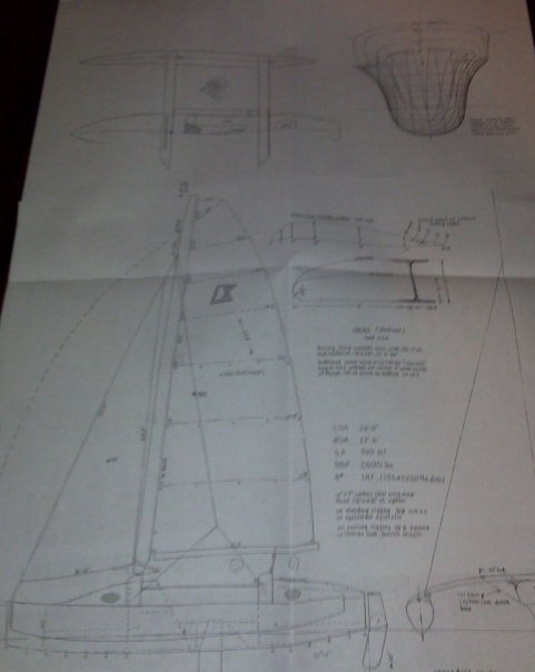

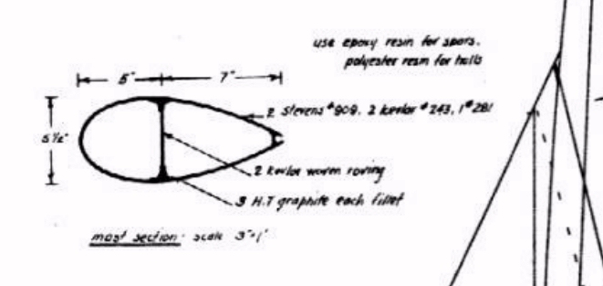

    Attached is diagrams of Phil’s 7 meter cat and a couple of Eric’s Freestanding masts

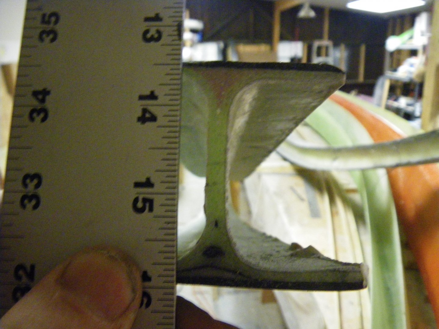

    Using carbon and foam to make 2.4m x 1.2m (8' x 4') panels, then taping them together does not make sense either from a strength, weight or labour point of view. Much less labour and weight if they had built a flat panel mould and infused the hulls.

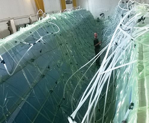

    Most of the plumbing on the 41m hull is unnecessary. Attached is a photo of a 20m half hull infusion using a single hose. Other pictures at Custom 20m/65′ – NORWAY – HARRYPROA http://harryproa.com/?p=726

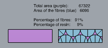

    Carbon is difficult to infuse because the fibres are much thinner than glass fibres, making it harder for the resin to flow. The flow is easy to follow, but that is not much help as you cannot see what is happening below the top laminate. The carbon laminate on the beams in the reference above is 20mm thick. The test pieces have infused easily, full length production starts next week.
    The max packing, with fibres touching is 91%, not 98. see attached.

    In reference to post 193 about Kevlar “not sticking” very well to resin according to John Shuttleworth. Cinderalla 11 now known as Lunar Mist is a 104 foot long 216,000 lbs monohull. This boat is built of composite construction of from the inner skin out 881 gsm triax, 2(1122 gsm triax), multiple 1800 gsm triax, 38 mm H100 divinycell. Outside layers from the core outwards multiple 1800 gsm triax, 450 gsm 45/45 biax, 2(600 gsm 0/90 kevlar glass), 881 gsm 45/45, 2(600 gsm 0/90 kevlar glass), 450 gsm biax. Yes this is the average, its heavier in some area’s. The entire hull was done in epoxy.
    Reason for this discussion, a very large area of the bottom glass delaminated at the 600 gsm Kevlar/glass layers. Most of the bottom had all the layers of Kevlar glass sanded off and replaced by additional reinforcement that was resin infused back onto the remaining bottom glass. Prior to replacing the glass they cut channels into the core layer to inspect the core and found water in the foam core which was cut into blocks to match the hull curve. They resin infused the core to fill any slots in the core and remove the water. This boat was built by very good builders who understood how to build big boats. The weak link appeared to be the Kevlar layers delaminating from the associated glass layers. John Shuttleworth statement appears to have some substance. Reference Professional Boatbuilder issue 126.

    I've known Jamie for years, used to steer his F40 catamaran (until we capsized it). Suspect panels was not his choice. See the last line of my previous post. Full length panels would have been better than 8 x 4's, infusing on a male mould would be better again, but infusing in a female mould would have been best.
    In the same vein as the broken carbon mast above, this is not a problem with infusion per se, but with the builders.
    Below the water should be clear gel coat so you can see what has happened. I would not use gel coat anywhere for this reason (and it's weight)
    If it didn't infuse, there is a reason, and this reason could/should have been sorted out before they infused. "Test everything new before you do it full size" should be written on every boat shed wall. Dry spots happen because the holes in the foam are blocked (or not made) or more usually, because the laminate wets out around an area instead of across it. There may be other reasons, there is not enough information. A thousand bucks worth of plumbing would not gave helped as presumably the visible surface was properly wet out. It is much easier to ensure infusion works on flat panels than it is with in hull complex curved shapes.
    I have also known Pete and Sari (Boatspeed builders mentioned above) for a long time, used to sail their boat as well and sold them their first wet out machine. But their reported comments about male moulding are wrong. It is like mandrel moulding a mast. The fibres when compressed under vacuum must conform to a shorter distance, so they kink. In a female mould they are straightened out as they conform to a bigger radius. My bet is the real reason was the lower cost of a male mould and ease of building. It is far easier to unroll wet cloth across a hump than into a hole.
