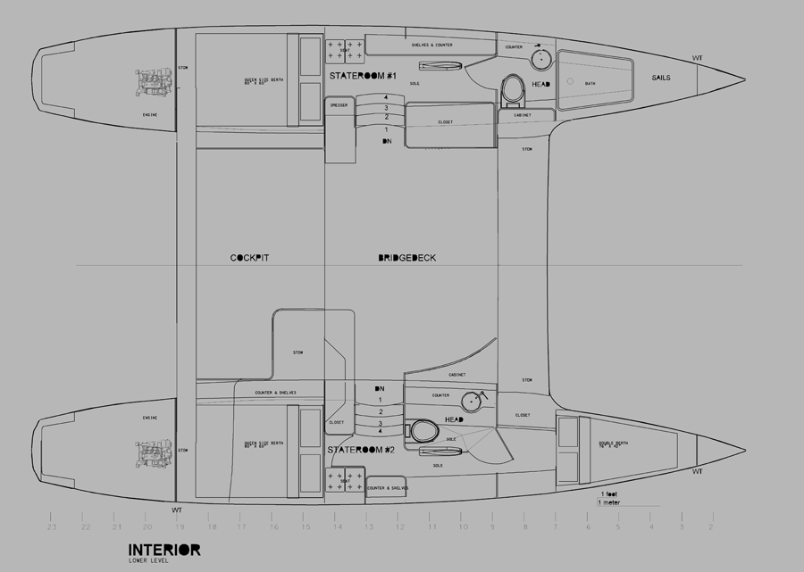

    oldmulti Senior Member

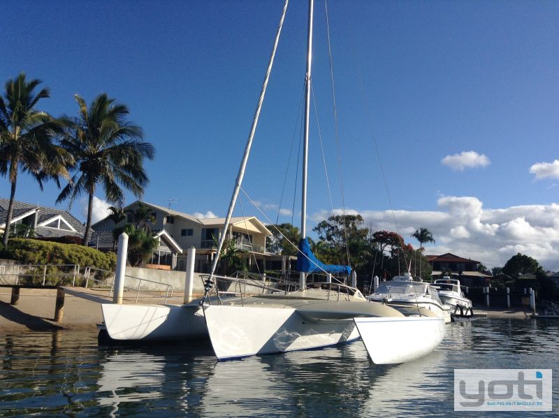

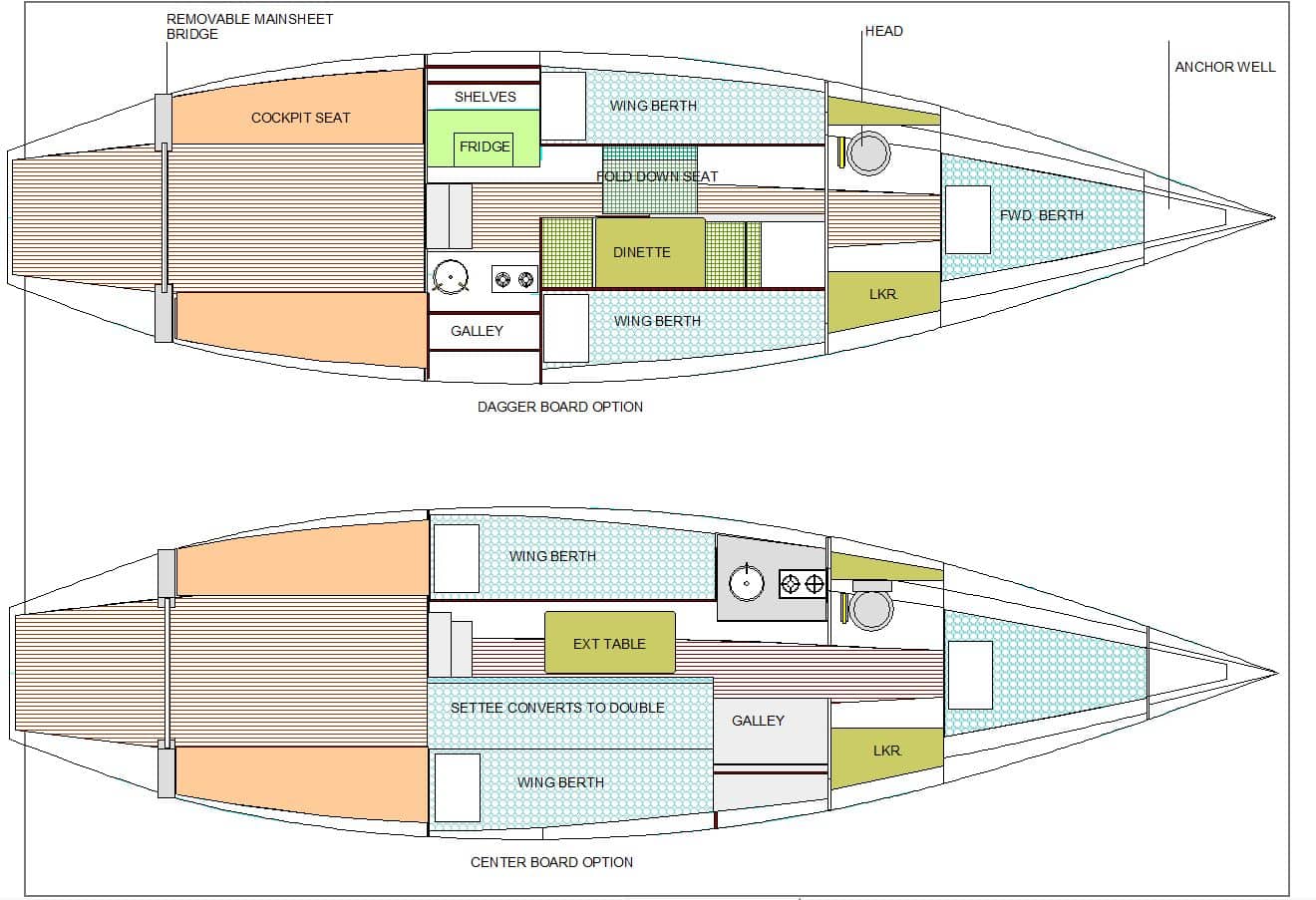

    I am often surprised of how much more accommodation is being squeezed into modern cats that can still sail well. Kurt Hughes often designs cats that have a good balance between sailing capability and space. His boats are not like EG the Lagoon 38 which have great accommodation but performance was not high on its list of priorities due to weight and hull shape. Hughes 37 (attached) is 37 x 25 foot 8430 lbs weight (actual structure weight about 5500 lbs) is lighter, has better hull shapes, has deep boards and an efficient rig to help it along. The Crowther Spindrift 37 shown previously in this thread has less accommodation, similar weight and a less efficient rig. I would suggest in a boat for boat race the Hughes cat may win but not by much. Now the real difference between the 2 boats is in the structure. The spindrift was 9 mm plywood decks, ply bridgedeck, all plywood crossbeams and hulls of 225 CSM, 600 gsm Woven rovings 225 CSM inside and outside 18 mm foam. The Hughes 37 is all foam glass construction with 1176 gsm triax 18 mm 756 gsm triax the maximum layup for most of the boat. The Hughes 37 is 5 foot wider than the Spindrift 37. The Hughes has more accommodation on the longer wingdeck etc. I would also suggest that the Hughes with flat panel foam glass construction for most of the boat would take less time to build.

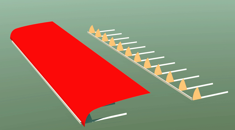

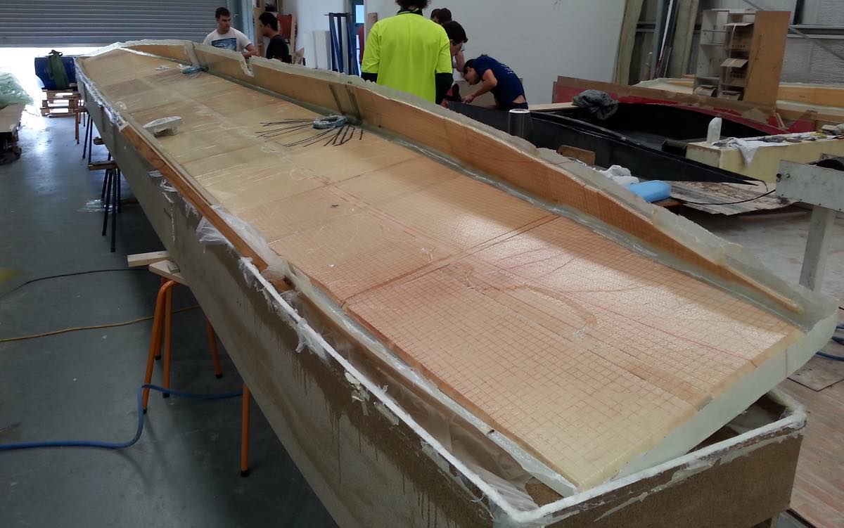

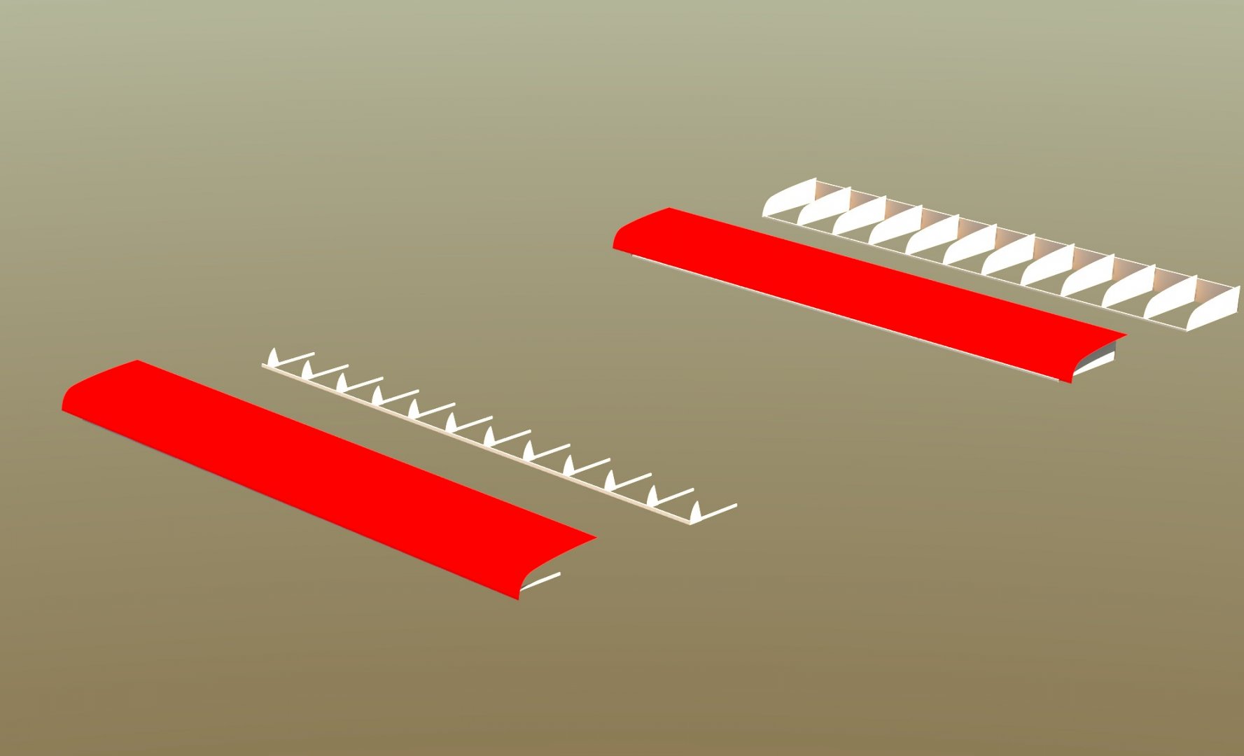

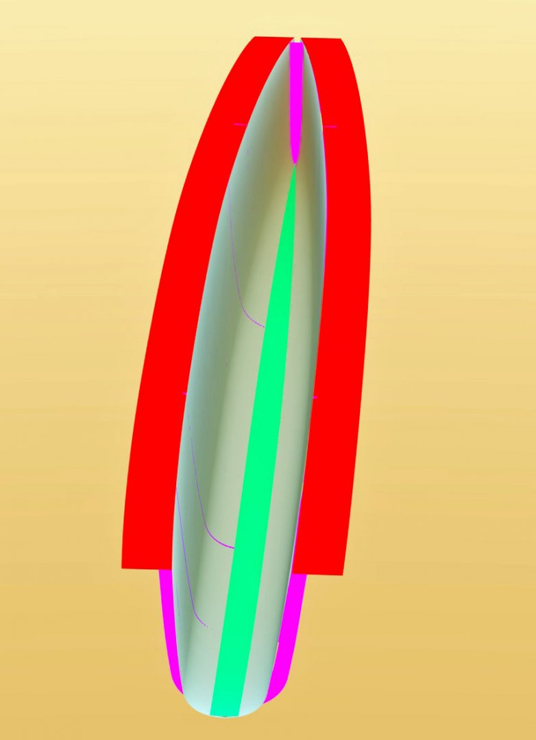

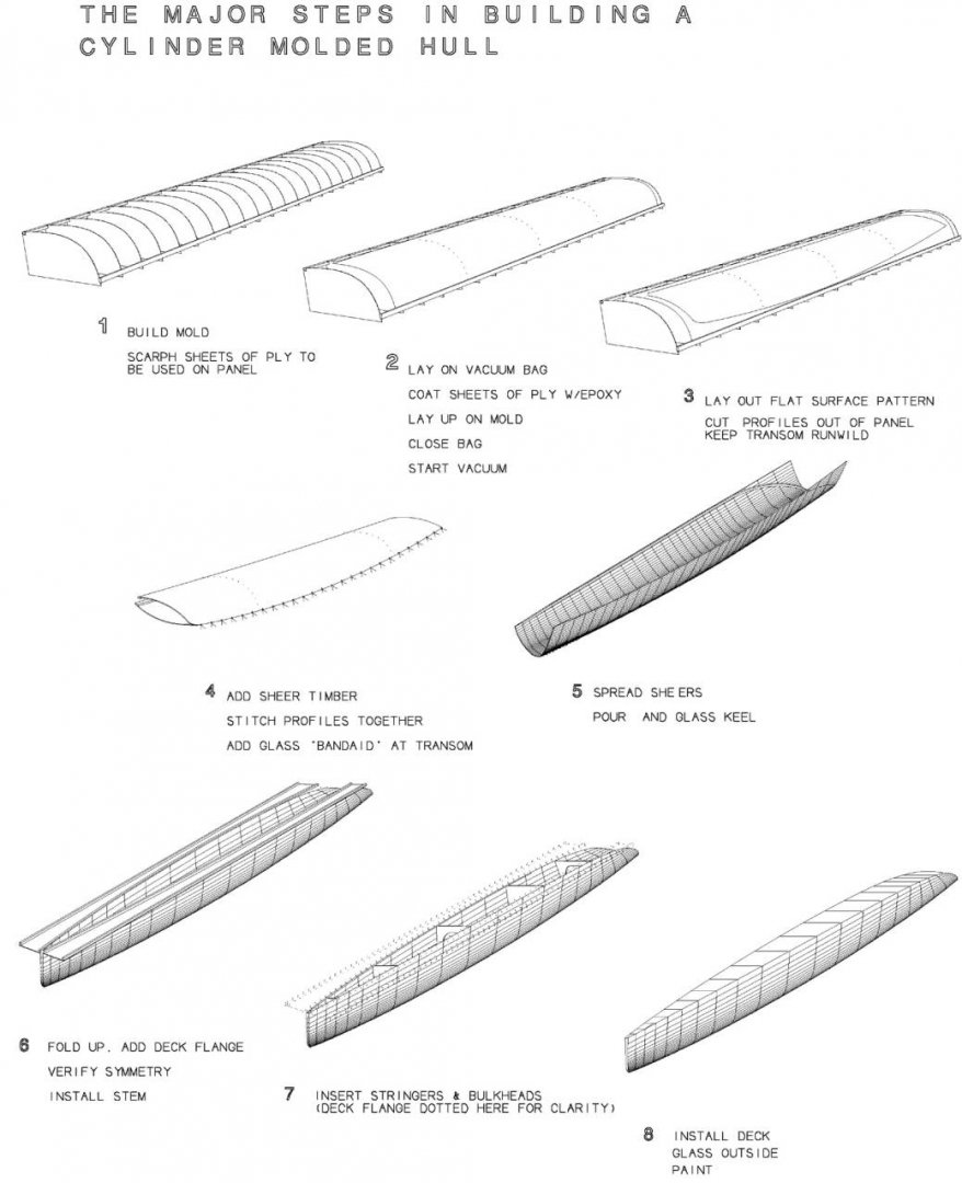

    Kurt Hughes, a multihull designer, has tried to simplify building small to large multihulls for the average person. He had a client say to him "if you need to curve plywood, curve plywood". Kurt created cylinder molding (attachment cylinder molding), where you get a simple mold shapes on a flat floor, put 2 (or 3) layers of thin ply on the mold shapes and glue them together under a vacuum bag. You now have a curved ply panel that can be tortured to hull shape more easily. This technique has been applied to multiple 12 foot to 60 foot plus cats and tris. Kurt then refined the technique to produce an air mold which minimizes the setup and mold material used. The air mold appears to have an unsupported edge but a temporary stringer is attached to keep that free floating edge consistent. The next step in this journey is many large cat builders want wanted cheap hull molds for foam glass cat hulls. As with a tortured plywood A class or Tornado ply cat you can use join the ply at the keel line then force the ply into a deck flange the shape of the gunnels to get a hull shape. The ply is now the shape of the hull but is clear on the inside of the hull. In short if the inside is waxed up it can be used as a hull mold. This is a cheap fast way to get a hull mold. Kurt Hughes site has more detail about cylinder molding. Air molding is listed in his blog. CYLINDER MOLD MULTIHULL CONSTRUCTION https://www.multihulldesigns.com/pdf/cm/CYLINDER%20MOLD%20MULTIHULL%20CONSTRUCTION.htm

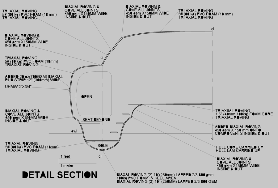

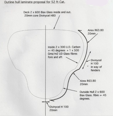

    Most designers have there own views on how to build a multihull. Designers often work from different starting points. Example the attached diagram is the proposed hull layup for a 52 foot cat. The majority of the glass/carbon fibre layup is at 45/45 degrees with on 1 layer of glass laid fore and aft. The designer of the layup is an excellent designer who has designed the hull to meet all forces required to hold the boat together and the said boat has done many miles of ocean sailing. A second well known designer criticized the layup saying that there was insufficient fore and aft glass fibres to handle the global hull forces due to the majority of 45/45 of glass fibers in the layup. The second designer was working from the principle of a cat hull needs about 70% of its structure for and aft and about 30% of its structure laterally. As most people have worked out a lot of plywood boats have a 50/50 structure. Aggressive strip plank WRC boats with only glass unidirectionals around the hull has about 85 % fore and aft 15% laterally. Yes the second designer may be correct in his assessment of the layup not being optimal but the original layup designer produces good boats, they may not be perfect but they work well. Trust your designer if they have results to back them up. Finally, triaxial glass cloths 45/45/0 has effectively 66% fore aft strength 33% side strength, good for hulls.

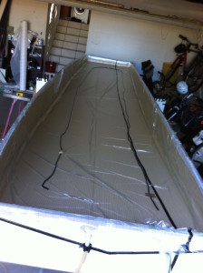

  11. trip the light fandango
    Joined: Apr 2018
    Posts: 448
    Likes: 88, Points: 28
    They're always good reading
    I suppose chines affect the resale value, as you have noted previously, of that tiny fraction of people who aren't time poor, still physically able and can actually build a boat,[the dream]. Making a cheap mould as described in your other posts and doing a lay up in fibreglass with a flare in the transom similar to a Farrier could be worth investigating, not me I don't think. However using tube aluminium cuts out a lot of work so the design of this 30footers beams, housing/connections are intriguing. Reading previous posts it looks like two lengths at 3mm is the minimum wall thickness for a 10 ft span, so 5 or 6mm for a single beam?,.. whereas something like a Hobie 18 mast is nearly 2mm. Can you shed any light on beam wall thickness Oldmulti? thanks again for sharing your knowledge, it's much appreciated. I did check up at an aluminium supplier about 6061 and losing tensile strength with welding,.. they were unaware of it.. I've only tried one so far.

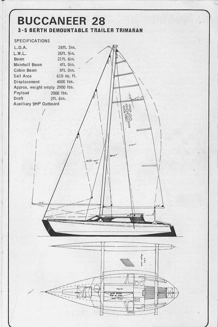

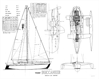

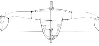

    Next is a plywood trimaran. The trimaran plan is for a 28 foot tri that could be easily be extended to 30 foot. The structure of the tri would be the same for a 30 footer. So I will use the full plans for the Buccaneer 28, a high performance tri with aluminum cross beams. The plans are available at MediaFire https://www.mediafire.com/folder/aaltgc3owsb1u//Buccaneer%2028 If you want to have timber cross beams another tri of the same general size and displacement has a forward beam with fore and aft 9 mm ply webs, 240 mm high in the middle, parallel over the mid 1.5 meters and tapering at either end to the thickness of the flanges. The top and bottom flanges are 2 layers 140 x 19 mm clear oregan. The cross beams bulkheads are 30 mm thick every 700 mm with the cross beam bulkheads at gunnel edges of the main hull and floats 100 mm thick. The rear beam is the same structure but the webs are only 200 mm high.

    TTLF I have just discovered I only have a paper version of the lines and other stuff. I will get them scanned in and loaded up in within a week. Sorry about the delay.
