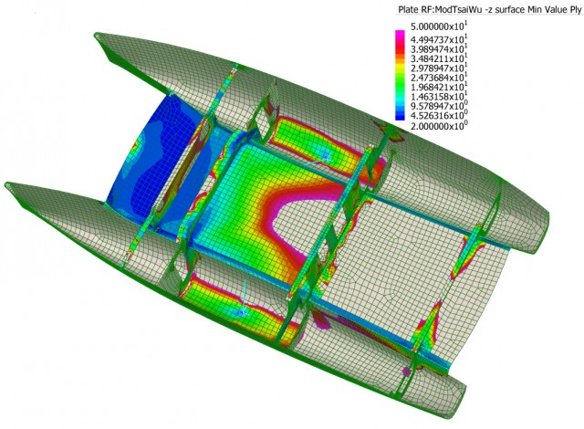

    Sailhawaii (who is thinking about a new 42 foot cat). The following is an example of a 46.5 x 23.5 bridgedeck catamaran that displaces 12000 lbs and has 110,000 foot lbs righting moment. It carries 1256 sq foot of sail. The cat is a high performance cruiser that has done many open sea miles and has had several copies built. I will not name the design. The cat has a rear beam, main beam and a forward wing deck beam to form a box to handle the twisting loads. The main beam is 1 meter high with a 25 mm airex foam core. Under high compression area's eg mast a solid timber insert replaces the foam core. The core is doubled at the edges where flanges are attached. The web faces are 4 layers of 17 oz (550 gsm) unidirectionals laid 45/45 degrees on each face for a thickness of about 4 to 5 mm. The top flange is 80 x 50 mm epoxy unidirectional solid glass, the bottom flange is 40 x 50 mm epoxy unidirectional solid glass. The forward beam and rear beam are the same basic structure, that is 25 mm core with the same web faces. The top flange is 43 x 25 mm epoxy unidirectional solid glass, the bottom flange is 43 x 25 mm epoxy unidirectional solid glass. The attachments is an example of the cross beam layout.

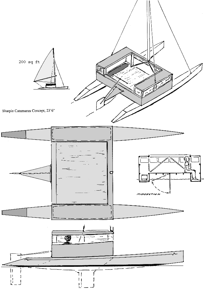

    For those who like a simple life the following 2 designs are about as basic as they get. Square hull shapes work as long as they are relatively light. Fine ends work if well designed, but a designer needs to be able to distribute the buoyancy correctly. Mr Toad is a proven design that is cable of more than you think if you want a basic camp catamaran for minimal cruising. 6 mm ply with 200 gsm cloth over will get you a pretty easy to build boat. The second boat is a Phil Bolger special. Phil was one of the most logical, original designers around. Do not assume he produced pretty or fast boats but they often did there job very well. His 8 foot Brick design is a gem. Phil also designed a 40 foot cat called Eagle which is a charter cat in Alaska. Back to Phil's 23 foot cat. Notice the integrated central foldable keel. The central rudder etc. Again 6 mm ply etc will get it built. Mr Toad will really sail well, Phil's 23 foot cat will keep you amused as you work it out.

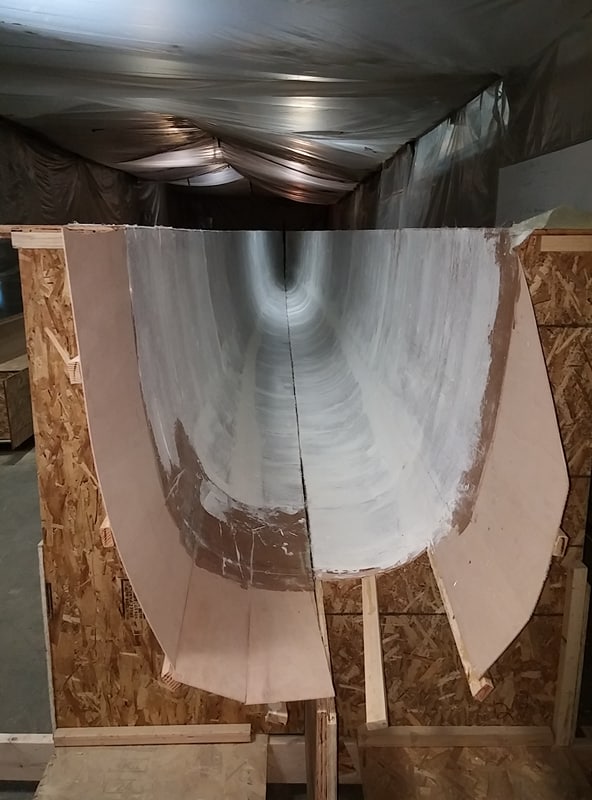

    Solid glass hulls are usually only done is small boats but also are done in bigger boats. EG the underwater hull bottoms of Lagoon 38's are up to 12 mm of solid glass. Also earlier Outremer cats had solid glass hull bottoms etc. There are reasons for doing a solid glass hull, but initially I will discuss how to create a simple mold. Easiest is a flat surface which is well waxed and glass laid directly over it. Next option is to actually make a hull shaped mold. You build a virtual full sized boat then a reverse glass mould is taken then you lay fiberglass into that mold for the hull. Painful. Better to build a series of mold frames and then push EG plywood into the frame molds to form the shape of the hull. This can be hard chine or round bilge. The attached photo's are of a 60 foot cat hull mold with 4 mm ply lining. Once you have several layers of glass in the mold it will strong enough to have the full hull weight in the structure. Notice the use of filler to smooth some plywood cuts in tight bends. This mold could be used for solid glass or foam glass construction. More later.

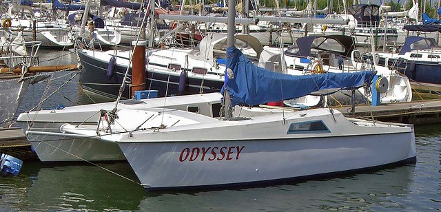

    Next we will talk about 10 meter glass cats. A builder did a TIKI 30 30 x 16.4 x 4400 lbs with solid glass hulls has a 2(225 gram CSM) + 750 gsm biax + 1100 gsm qudax. The hull has bunk tops, floors etc to stiffen it. The decks were foam glass. Next is a charter cat that has been used as a high performance sport cat. The Rush 10 is a tube cat 33 x 18 x 3200 lbs x 540 square foot. The hulls is 600 gram CSM 820 gsm Woven Rovings 600 gram CSM. There are glass reinforcing strips internally and externally in the keel area. Now the fun begins. There is little accommodation or furniture in the hulls so the hulls are reinforced with vertical foam half rounds every 800 mm covered with 600 gram CSM. There is also a full length stringer half way up the hull. The deck is the same base layup with 25 mm lateral ribs every 400 mm. A 60 mm internal flange at gunnel level joins the hulls and deck together. This boat is light and fast. upload_2019-7-24_8-34-0.png

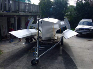

    I've built some small ply/glass thingys like a 21 foot kayak trimaran and am now looking to do a 16 foot tri as a basically larger Weta as I found them a bit small and slow. I want something I can sail myself or 2 up and do some solo camping/raid type stuff.
    I love speed and want it to be decent so I'm looking to use the rig off my Spitfire F16 cat (tough to single hand and wholly impractical for any longer trips really) and am interested in using a foam/glass build so I can get some nicer shapes - my wife hates my lashed up isoskiffmaran test bed and refuses to go out on it, especially since we completely smashed it in half in very heavy weather...
    Anyway, I am just wondering if you had any thoughts on the thickness of Airex T92 (as recommended by the supplier) to use in the floats / main hull and the glass weight / layups for the new project?
    I've started a thread here with some rough shapes that are evolving and will be looking to make a test float on that to see how a taller, larger volume hull compares.
    I'm perfectly happy to bin it once done as it is just a test before moving on to a final evolved shape but it will help me get to that final shape.
    I'll be going to test sail an Astus 16.5 next month in France but I can't really justify the cash (wife has just spent it on a new kitchen anyway) and enjoy the building/tinkering bodging process.
    Any thoughts you have would be most helpful and gratefully received - the point being I will test it to destruction anyway.

    Vantage. Your done a lot of research and I can only give some directional hints. I am not a boat designer. The Astus looks a good boat but has limited accommodation, so I will assume you want speed over internal space. This means a weight of 200 kg or under so a relatively light weight structure. Now the choice. How much money do you want to spend and how long do you want it to last? If it really is a test boat build it in 4 mm ply with 200 gsm glass on outside. If you want a longer term boat then thicker foam and thin skins will be lighter but less resistant to knocks. A 16 foot foam glass boat boat could be 200 gsm 10 mm foam 200 gsm BUT you will have to build it well as skins this thin can be porous unless well filled and painted correctly. A class cats have hulls of 200 gsm cloth 9 mm corecell 200 gsm cloth, the most extreme is 165 gsm kevlar 5 mm foam 195 gsm cloth inside with 8 mm foam around daggercase and main beam. A more conservative 16 foot boat is the Scarab 16 (attached drawing and material sheet) is 400 gsm double bias 10 mm foam 400 gsm double bias. This hull layup is used on Scarabs up to 22 feet. The Scarab 16 folding beam is a simple approach.The plans are also cheap at $150 australian. This boat probably has to much accommodation but the plans will give you a real lead as to how you can built a light long term boat. The hull shape (eg round the bilge chines) and cabin could be modified (eg cabin could be lowered and sides narrowed to the main hull gunnel line to reflect more of what you want. The Scarab 16 weighs less than an Astus 16.5. The Spitfire 16 rig will work. The Scarab 350 is not what you want but is a nice small building guide. Also the Scarab 16/18 build guide has been posted earlier in this thread. I hope this helps.

    Old multi, thanks those are really useful guidelines for me work against - I will lash up a test float and see how I find the process and if it seems worthwhile.
    I'll do the float in 200/10/200 so reasonably light and then beat the crap out of it and see how it stands up before I spend any real money or time on the main hull.
    I can easily do it in ply if it seems pointless/too hard/expensive and I could just then look at 400 below the waterline and deck/seating areas with higher load.
    The folding element of the scarab is good - I've already done a few lash ups in the garage to trial some folding geometry here and here which took a few minutes so that end will be no problem.
    Yes, I'm not looking for any cabin/cuddy as pointless for us - I'd rather have a quickly collapsible tent that actually has some space in it across a tramp and the main hull, will weigh only a few pounds and can be left at home when not needed.
