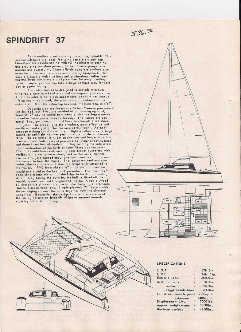

    Deck structures on bridgedeck cats vary from just a wing deck to a full size full headroom bridge deck cabin. In the early days full headroom bridge deck cabins only happened in 40 foot plus cats. In under 40 cats they had cabins that had roof hatches or under 5 foot headroom. The spindrift 37 had a large hatch that provided full headroom at anchor and a low profile while sailing. If this is well done it can work very well. I have enjoyed sailing in light weather with the bridge deck cabin roof hatch up allowing a nice breeze through the boat. The latest combined cockpit/cabin bridge deck cats are taking advantage of the same features. The plans below gives you the specifications for one cat.

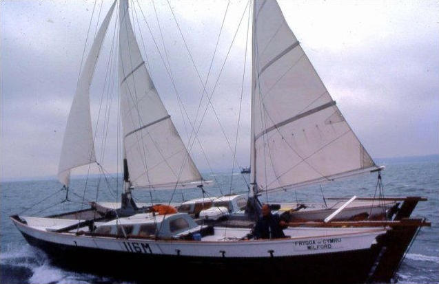

    For Wharram lovers. A Narai cat 40 x 19 feet 13000 lbs displacement with 600 sq foot of sail was normally built in plywood , timber with 4 solid timber crossbeams. This boat was re engineered by a builder to be basically fiberglass. The hulls which were designed as 9 mm ply were replaced 5 mm solid glass (a combination of CSM and woven rovings) with the same ply bulkheads and timber stringers. The fiberglass panels were laid up on a flat floor then cut to size and glued to the wood stringers prior to the stringers being glassed over onto the fiberglass sides. Decks were done the same way. Next came the cross beams which were redesigned to be solid glass tubes. Please remember the Narai only has 7 feet of unsupported beam between hull gunnels so these beams suit this design only. There are 4 beams spread along the hull. Each beam is 165 mm outside diameter with 9.5 mm walls. The beams are unidirectional e glass with 45/45 glass wraps around the tube about every 3 mm. Additional 45/45 wraps were added at gunnel support areas. The beams were engineered and supposedly were shown to Wharram. The boat initially worked but I do not know its longevity.

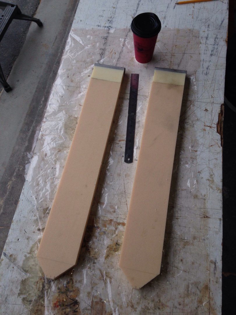

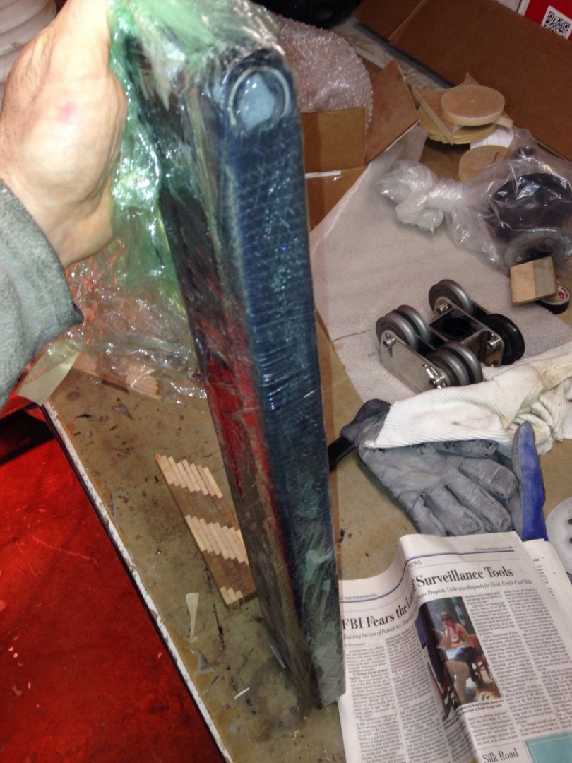

    Carbon composite chain plates done by home builders are becoming more common. They are lighter stronger and have minimal corrosion problems. Some designers do them well. Ian Farrier was one such designer. The following blog of a F36 being built February | 2015 | F36 #005 Ravenswing – Trimaran Building https://cartersboat.com/2015/02/ three quarters way down the page describes his approach to building the carbon fibre composite chain plate for the main cap shrouds for the tri. It contains carbon fibre layups for the composite chainplates. Look through his blog as it contains many hints about building a foam glass trimaran.

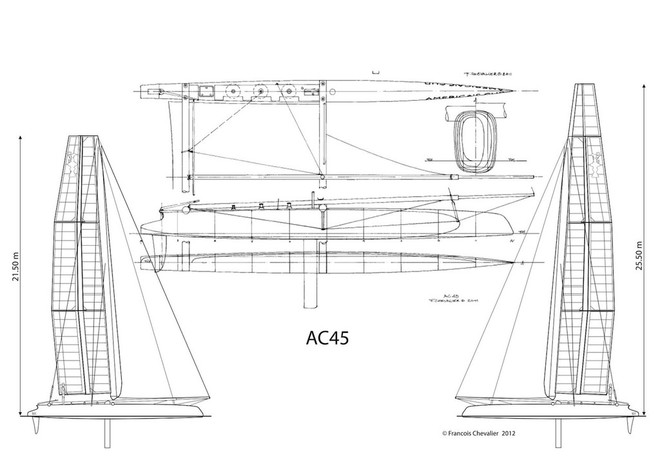

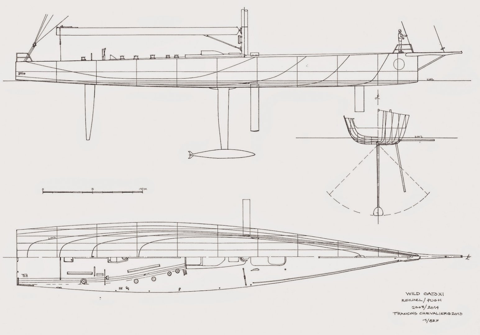

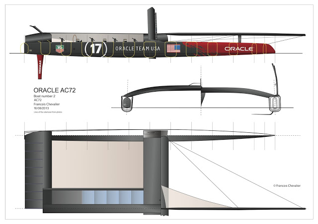

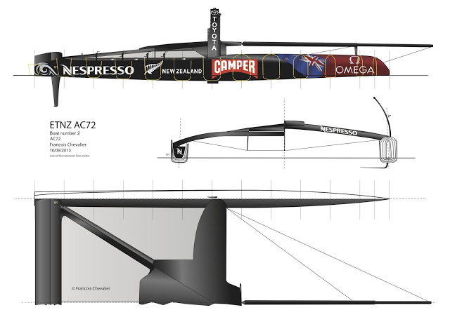

    Modern AC hull shapes for foiling cats are heavily influenced by foils that lift the hulls out at about 10 knots of wind speed. But the hulls still have to work in displacement mode below 10 knots of wind speed so they basically have to be efficient. Notice the similarities of shape. Fairly flat bottoms, fairly full shapes in the ends, minimal rocker and have a narrow hull beam for their length. Wild Oats monohull has won line honors 9 times in the sydney hobart yacht race. It has a fairly flat bottom, fairly full shapes in the ends, minimal rocker and have a narrow hull beam for their length. Comanche is considered the fastest 100 foot monohull in the world. It appears to have a wide beam but its waterline beam is fairly narrow under all states of heel. Again it has full ends, flat bottom and minimal rocker. All of these boats have very low displacement for their size. Wild oats gains stability by the DSS foil, Comanche by wide beam. The cats pushed stability by wide hull separation. Each of these boats have very large sail area for there displacement and stability. A fast hull shape characteristics appear consistent. Yes, higher displacement boats for their length with lower sail area to displacement have rounder hull shapes to minimize wetted surface area.

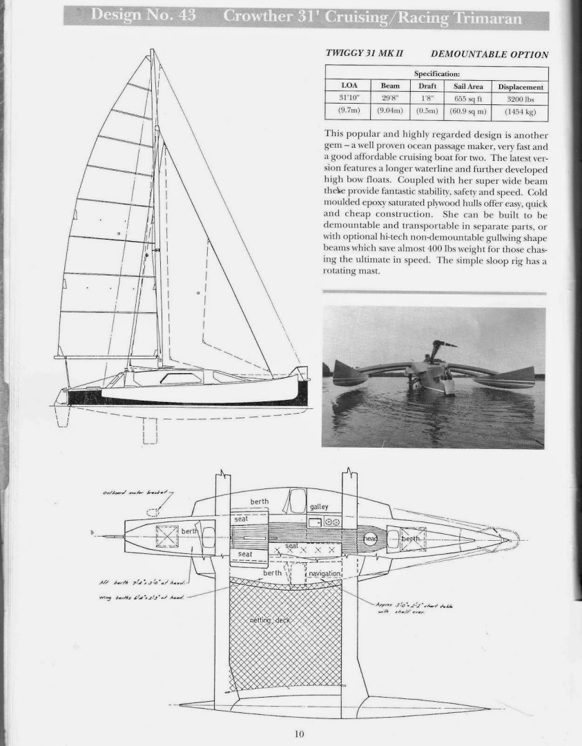

    Bruceb, There were no waterstays on Twiggy's with fiberglass beams. The beams were stiff enough as originally designed but depended on good building as their safety factor in the design beams were lower than most other Crowther designs. The tension in the top flange of most Crowther designs are built with a tension of 19,000 to 26,000 lbs/square inch. Twiggy's top flange was built with a tension of 38,000 lbs/square inch. Unidirectional glass/epoxy (with 65% glass to 35% resin) has a tensile strength of 120,000 lbs/square inch. Normal Crowther fiberglass beams have a safety factor of about 5 to 1. Twiggy's beam safety factor is about 3 to 1. The above assumes you are using S glass unidirectionals in the beam build and a good quality epoxy. The numbers you find for the strength of resin glass unidirectionals varies according to the type of glass (E or S), the manufacturer of the glass and the type of resin (epoxy, polyester etc). The attached PDF will give an idea of the effect of fiberglass to resin ratio's on the strength of a laminate. Build using the designers specified materials and everything should be OK.
