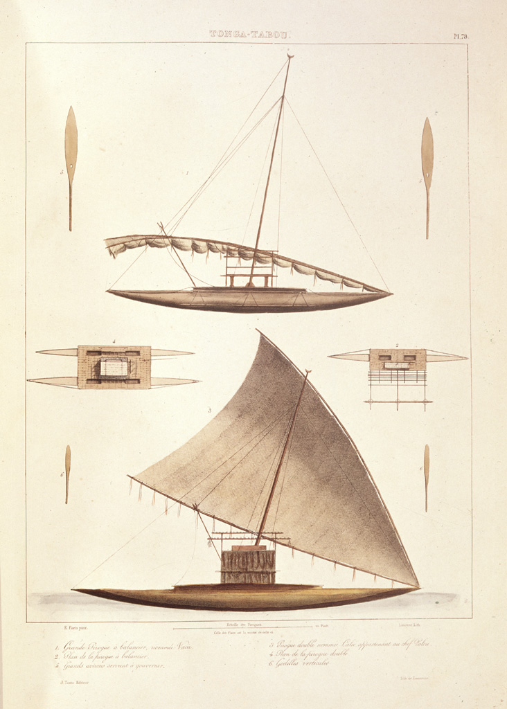

    Just to stir the pot ...
    Switching from outrigger to 2 (more or less equal) hulls was traditional doing in Melanesia.
  15. Pondlife
    Joined: Nov 2015
    Posts: 18
    Location: Kent
    Pondlife Junior Member
    That was the sort of thing I was thinking. On reflection the practicalities like upwind performance and resale would lean me towards a well known designers plans. I find it difficult to do the sensible thing, but have seen alot of unique builds that the owners are struggling to sell and not getting a fraction of what they paid to build.
