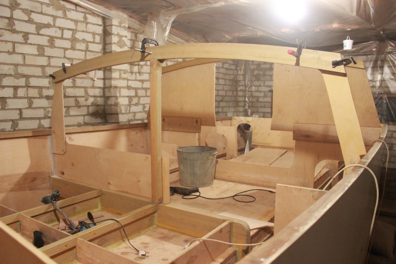

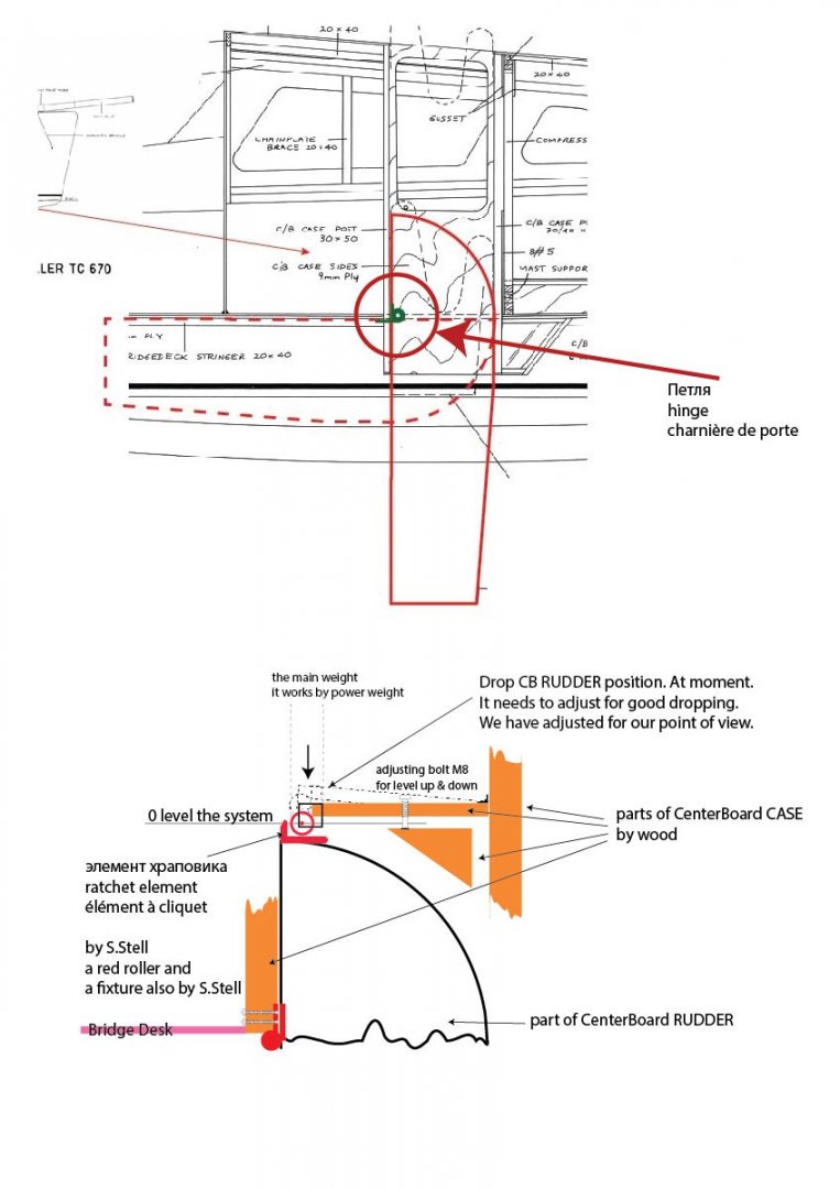

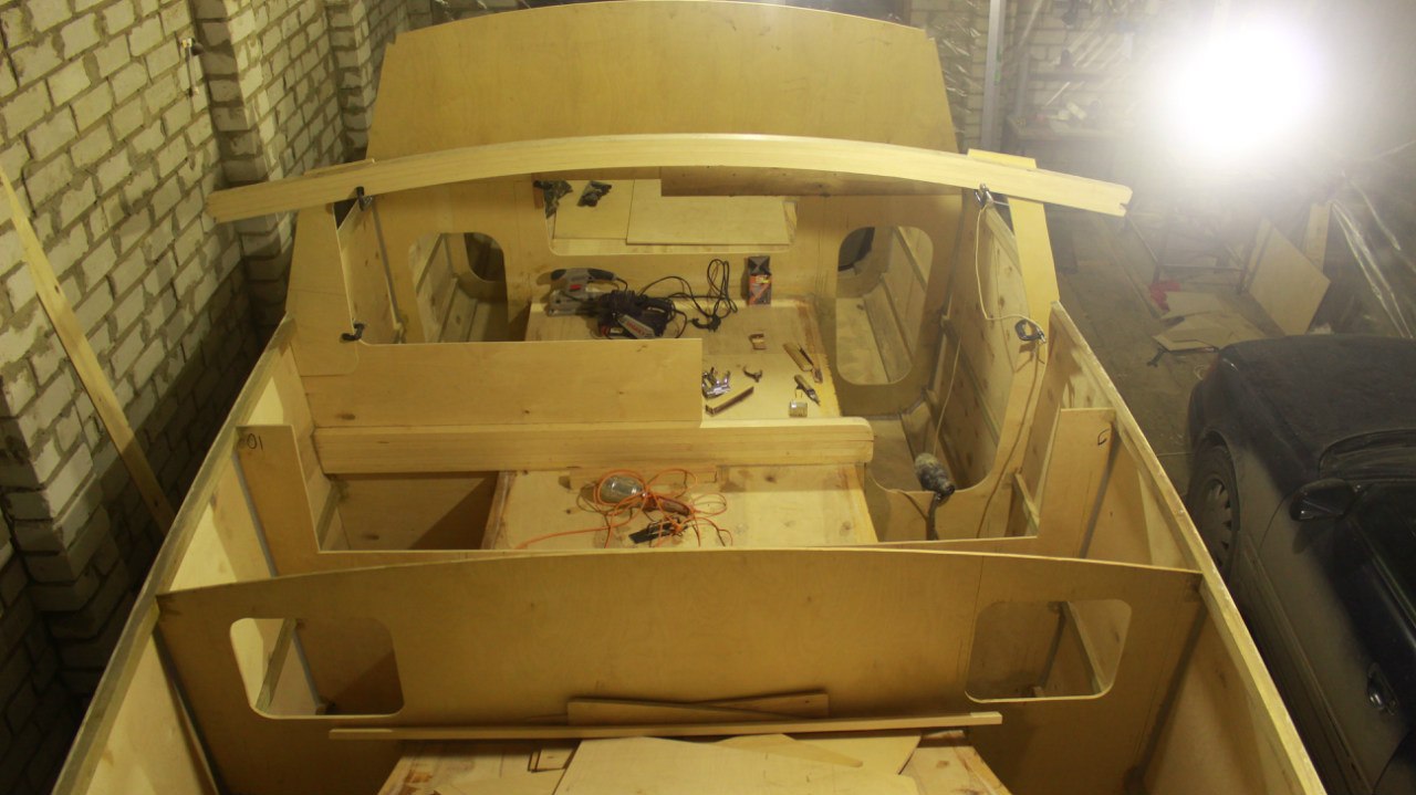

    Builder45 Look up a cat from Mike Waller TC670. It will give an idea of how large cat designers handle the loads. There is a russian web site about the build of a TC 670 that shows many detailed build photo's (2 photo's attached). The mast compression appears to go thru the middle of the cabin at the front of the central daggerboard case. But the front of the Double bunk (on left side photo) attached to the daggerboard case has a small cross beam attached and under the underwing has several very deep fore and aft underwing stringers that attach to the fore and aft cross beam structures. The Richard Woods design site is down at this moment but in the plan update section is a plan update for a Flicka 35 cat cross beam shows the beam under the front of a seat. The beam goes between the inner gunnels. Big french cat designers know how to discretely disperse the loads along and across the wing deck structure. It doesn't need to be very deep just very well designed.

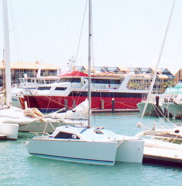

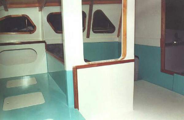

    There was another instances where I was proposing to place a mastaft rig onto a kit boat design called the Solitary 40. This is the 'mast base' I was proposing for that conversion,..
  9. brian eiland
    Joined: Jun 2002
    Posts: 4,962
    brian eiland Senior Member
    Here is that Solitary Cat with original rig, then mastaft one...
