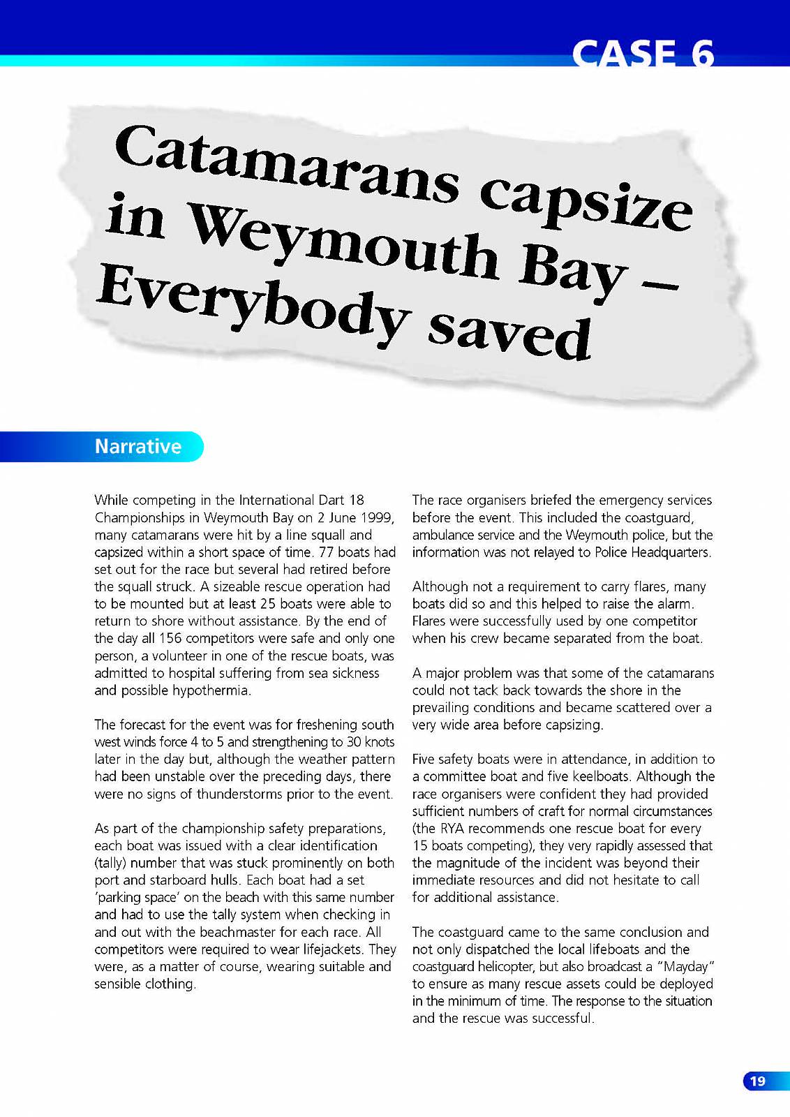

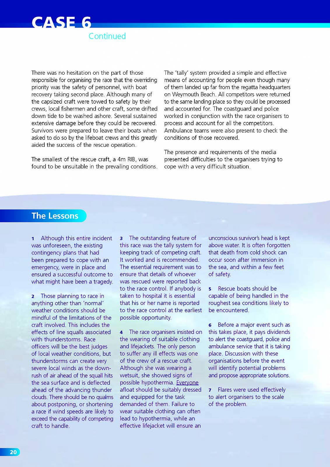

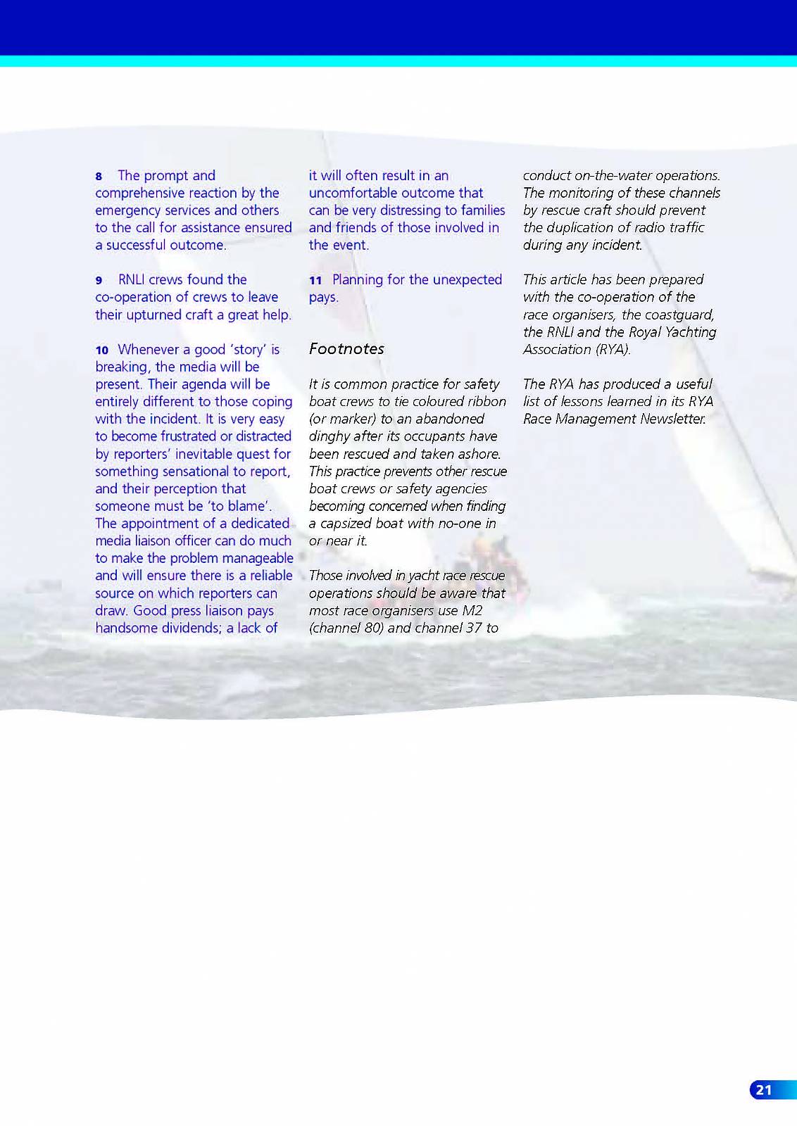

    Here are a few sobering reports:
    and
