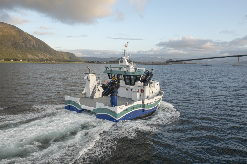

    We know some monohulls are designed for rough seas, but what about the workboat catamarans that we see servicing windfarms etc. way up around Norway and far north places.
    I never see anything about how they perform in sever conditions. Anybody out there know?

    @Ad Hoc replied in another thread that those vessels are not designed for those conditions.
    I’ll venture VCG is too high and the l/b too low to make sure they don’t ever get abeam.
    But the thread title is all wrong because you are not comparing two capable vessels against each other.
    And, probably a self righting vessel is safer, and not really something multihulls generally offer.
    Ad Hoc likes this.

    When Lock Crowther paid for a testing study on capsizing of power multihull's the general conclusion of the study was a power multihull would only be under threat of capsize if the wave size was greater than the beam of the power cat. That was assuming the power cat was running parallel with the wave faces. Any deviation of course to run from or point into waves improved your safety. This study was done as Lock started to design larger power cats for charter and ferry work. Translation a power cat with a 26 foot beam should be able to handle 26 foot seas.
    The following is a generalization as there are many variables like water depth and fetch to build the waves but EG in 30 knot winds you will get 16 foot waves, in 50 knot winds you will get 32 foot waves. Finally a well designed power cat with good hull freeboard and underwing clearance as well as a low centre of gravity will be better than a multistory beer barn.

    I'mmmm... not sure it works that way. Maybe in pure rigid body kinematics... I'd love to see the analysis, but all I can find is hearsay on the said study. So I'm with fallguy and Ad Hoc on this, it is never that cut and dried in survival conditions.
    In my experience cats or tri's, and even SWATHs fail structurally long before they flip (EDIT to add...due to waves). It is the nature of the beast...a well designed cat/tri/SWATH has to be built long and light with good deck clearance, leading to structural issues with the demi-hull to cross deck connection. And head on into the wave face also has it's issues with submarining and wave slap.
    Remember, in typhoon Iniki a 40' cat was picked up and speared through the bridge of the 82' monohull USCGC Point Harris and made her a constructive total loss.

    Powercats are very capable of being in heavy seas, but the one above less so.
    Many cats are far safer than monohulls, but they max out at upside down or falling apart, as others mentioned.
    The thing about catamarans is they are super stable. They are great options for rough seas and wide work spaces while offering economical operating costs.

    That shark cat design : looks quite similar to the one above ,except heavy cranes causing higher center of gravity.
