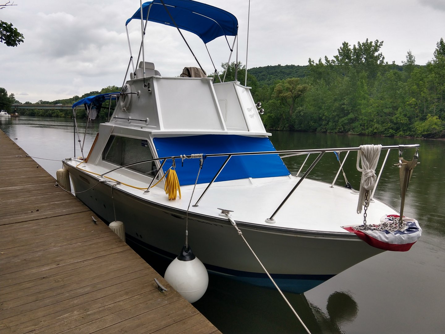

    IMG_20180803_161047747_HDR.jpg Here's a photo of the bow of my boat. You can see the anchor hanging there. Typically I just tie the line off on the starboard cleat. That's worked fine over the past few years.
    I recently built a nesting pram and have been wrestling with how to store it on the boat. I could store it aft but I'm considering keeping it on the fore deck. It will fit up there and I'll still have room to walk around it.
    I have an idea as to how I might launch and retrieve it. That's not why I'm posting this though.
    First some information. She weighs about 7,000 lbs. 25.5' LOA. Beam 10.5'. The boat, not the dink. :confused:
    If I store the dink up front, it's going to make dropping anchor and tying it off on a cleat more difficult.
    A couple of years ago I saw a mid-40 foot boat that had an interesting anchor rig. The boat had a bridal that attached to the topsides on both sides of the bow. The boat was docked and I noticed that the bridal was just tied off to the bow railing as the bridal stayed permanently attached to the topsides.
    Looking at the picture of my boat the cleat, or attachment point on the starboard side would be pretty much right below that front railing stanchion or base that has the dock line attached to it. It's about 40" from the deck to the waterline there. There would be an identical cleat added to the starboard side. I'd probably locate them a foot or two below the deck. Of course I'll leave the existing cleats on the deck for docking.
    I've looked around online but haven't been able to find any boats with this set-up.
    If any of you have any advise of comments I'm all ears. I'll have to check to see how thick the laminate is in that area. If I do this I'll make up a substantial base for the cleat and a strong backing block. Stainless steel machine screws, structural washers/nylocks and bedding.
    Thanks in advance for any thoughts.
    Just trying to solve the "dinghy dilemma".

    There would be a couple of difficulties with the anchor rode. First, to adjust the length you would have to untie the end of the rode from the bridle and then re-tie it. Secondly, retrieving the anchor is going to require some gymnastics to get around and over the dinghy. A small pulpit with an anchor roller would let you handle the anchor without having to work from on top of the dinghy.

    Hi Gonzo. I see what you mean about the length of the rode. Not as easy as just shortening it up and tying it off on the cleat. As for the gymnastics, when the dinghy is in the stowed position it's up by the windshield and I can get around it pretty easily. It's 57" x 50" x 21" high when nested.
    I like the pulpit idea but I have a conflict there. You may think I'm crazy but here goes...... I'm still in the experimental stage here. I can assemble the pram on the fore deck. My idea is to install a trailer roller about 6" forward of the bow, like a bow anchor roller but wider. If I make up a plate with a couple of slots I'll be able to adjust the roller forward or back. It's 44 inches from the deck to the waterline. I'm going to install a 3' stainless steel boarding ladder (will fold back and stow on deck) and can install a couple of rollers on the ladder. I'll block the ladder so that it extends down at about 45 degrees. The assembled dink weighs 70 pounds and the bow handhold ends up about 2' above the water. I think I can put a line on the dink, pull her up up onto the roller at the bottom of the ladder, wait for her to center herself and then simply haul her up onto the deck. I don't know if this is going to work, I don't know if I'll need maybe a 2:1 block (I could use the bow rail as a lift point as I've tested it with 200 lbs of load) so I'll have to see. 70 pounds isn't that heavy.
    I hope this makes sense. The reason that I want to move the attachment points for the anchor is because when she swings sometimes the rode crosses the deck between those two forward bow rail stanchions. Not a problem when the deck is clean but with a dingy up there it could pose a problem. Another solution might be to just install a skene bow chock and just keep the line tied to the existing cleat but routed off the starboard side of the bow.

    You can make that bridal a continuous loop. Do your anchor set, and retrieve, safely from aft cockpit, where it is easy and secure to stand, kneel, or sit. When anchor is set out, rotate continuous bridal around to where the boat rides well, bow into wind and sea.
    Offshore commercial vessels sometimes have provided, a standby buoy to hang on. We lasso the crucifix cleat on the buoy, alongside amidships, then hang off by the bow with a long floating poly rode. Trying to lasso from the bow, is fruitless.
    A different mooring certainly, but there is no reason other than silly tradition, for you have to be on the foredeck to handle the anchor.

    I have used bow anchor bridles for several reasons. Mostly because like your boat the bow cleats where set wide or too far aft.
    1 Set anchor using one of the existing cleats.
    2 hitch bridle line to the anchor line just forward of the cleat.
    3 rove the other end of the bridle thru the other cleat and make fast
    4 ease anchor line to match the bridle.
    As pointed out, it does complicate things a bit
