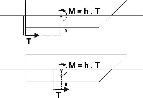

  4. TANSL
    Joined: Sep 2011
    Posts: 6,565
    Location: Spain
    TANSL Senior Member
    Figure explains why I believe that nothing differently happens in both cases.

  7. TANSL
    Joined: Sep 2011
    Posts: 6,565
    Location: Spain
    TANSL Senior Member
    Is it more clear now?
    R does not change, T does not change, h does not change, will change M?
  8. Kailani
    Joined: Apr 2013
    Posts: 113
    Likes: 8, Points: 18, Legacy Rep: 59
    Location: Hawaii
    Kailani Senior Member
    What about the force * distance from the green arrow?
  9. baeckmo
    Joined: Jun 2009
    Posts: 1,259
    Likes: 222, Points: 63, Legacy Rep: 1165
    Location: Sweden
    baeckmo Hydrodynamics
    Tansl, you have to consider the sum of moments from both the horizontal and the vertical composants and their levers, when you calculate the trim moments. In your example you only consider the horizontal forces and their levers!
    Put in another way, you take the moment from the resultant times the lever from its action line to the center of resistance.
    This gives an increase of the nose-up moment in your lower picture, just as Mr E and Gonzo have noticed.

  10. TANSL
    Joined: Sep 2011
    Posts: 6,565
    Location: Spain
    TANSL Senior Member
    Kailani and Baeckmo, you are quite right, one should not forget that moment. But the vertical component is so small (the angle should be about 3-7 degrees) which, in my opinion, its effect varies very little.
    Green force = between 0.052 and 0.12 times R
  11. baeckmo
    Joined: Jun 2009
    Posts: 1,259
    Location: Sweden
    The vertical composant depends on shaft angle as you noticed and also on the velocity gradient under the hull surface. But the lever connected to the vertical composant is far greater with propellers aft than for the midships arrangement. Again, this is NOT the significant issue, it is a secondary consideration.

    TANSL: you need to consider the thrust vs CG position in your calculations.
  14. TANSL
    Joined: Sep 2011
    Posts: 6,565
    Location: Spain
    TANSL Senior Member
    GONZO : frankly, I do not see why.
    To evaluate the effect of changing the position of that force, in the trim of the ship, just consider its position in relation to the center of gravity of the waterplane.
    But if I'm wrong, any clarification will be helpful and will be greatly appreciated. Thanks
