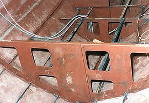

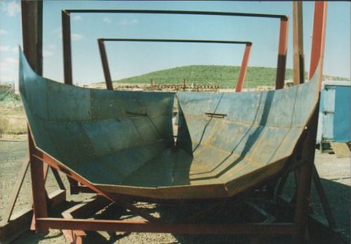

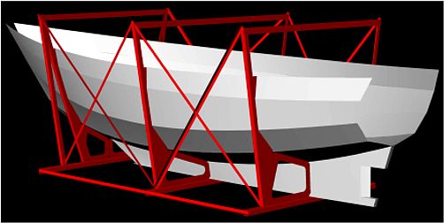

    So lets start with the steel hull portion. I have suggested a 'frameless' hull construction,.... subcontracted out. This South African fellow did a bit of steel hull boat building, and prevously posted a lot of discussions over on Boatdesign.net. He has now retired from boatbuilding, but he has left a website up.
    Final painting & delivery | Steel Boatbuilding
    Here is some portions of his frameless discussion:
    Building Upright or Upside Down | Steel Boatbuilding
    Plating a Multi Chine Hull | Steel Boatbuilding
    ...look down the page
    THE V/D STADT FRAMELESS CONSTRUCTION METHOD
    COMPLETE BUILT - DIX 43 | Steel Boatbuilding
    six guys in his crew including himself
    If we doubled that build time of his for the 'frameless hull method', it would still make financial sense, wouldn't it? ...and notice that his 3 wk figure includes the deck which he claims is a real time consumer.
    I would be hoping NOT to use a steel deck,...for a number of reasons, including big weight addition, and future maintenance issues.
    This was one of his early postings that got my attention,...look down to WynandN
    Frameless Construction - Page 2 - Boat Design Forums
    ...18 working days to build the 34' hull and deck (and I think he did his own panel cutting by hand rather than computer cut)
