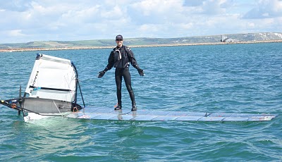

    Moth on Foils!------Euros-Day 4
    You can't get closer than this! From the Euros site:
    "The American Bora Gulari and the Australian Nathan Outteridge are still leading the championships, and there is a tie between the two athletes for the first place on the general ranking. As Nathan Outteridge says it, tomorrow is the last day, but three races are still to be sailed and there is still a long way to go! The conditions are fantastic on the lake and the competitors sail their boat to the extreme, at speeds regularly exceeding 25 knots! The concentration is at its maximum and must remain as such up to the last race of the championships. The third position is also under heavy competition: only two points separate the Swiss Arnaud Psarofaghis, the British Simon Payne and the Australian Scott Babbage ! "
    Day 4 video: http://www.youtube.com/watch?v=WJXjBA1oEbQ&feature=player_embedded
    (images from euro site/click and click again...)

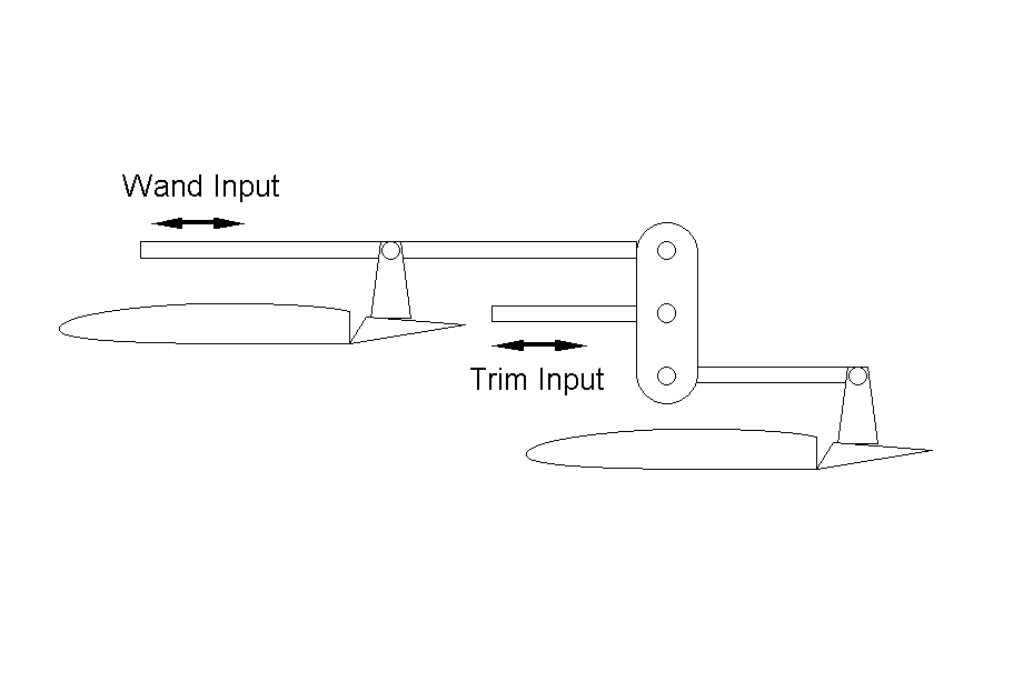

    Well, on day 4 most of the way thru a Moth championship the regatta is TIED! On Day 5 Outteridge wins by 2 points! What one of those guys might have given for an edge-just a bit more speed....
    Now, look at the video below but this time only watch the wand: every time the back end of the wand moves up the mainfoil flap moves down; every time the wand moves down and forward the mainfoil flap moves up. Can you say flap up, flap down as fast as the wand moves? Can you move your finger that fast? The wand is held against the water by a shock cord so it takes energy to move the thing as fast-and as much-as you see the wand move in the video. This particular video is one of the best illustrations of wand movement ever photographed ,in my opinion.
    You've got a flap moving up and down a lot and it is taking power away from the boat to do that.
    In the early days the wand was necessary because the boats had a lot of refining still to be done. But the time is now to dump the wand and use manual altitude control. It won't be easy initially-it will take a lot of practice and ingenuity to make a viable system. Perhaps using a system that links the main foil and rudder foil at an adjustable mix ratio-something like that was suggested by Tom Speer a long while ago.
    I believe the boats and the sailors are so refined at this point that the next logical speed improvement is to learn to sail without the wand. And if one of those two guys that are tied were to spring a "wandless" surprise on the other what a leap forward for the class!
    Tom, what do you think? Mal?
    PS-the 26' Mirabaud uses manual altitude control finding it a big help particularly when it's rough.....
    Watch the wand:
    http://www.youtube.com/watch?v=HTqtEvTjlaE&feature=player_embedded
    Toms illustration of a system to control both foils simultaneously- for wand input-just replace with manual input(?):

    Doug, you are assuming that all that dithering is bad. You may be in for a bigger challenge than you think if you try to remove that highly evolved wand from the system. Engineers have been intentionally adding dithering devices to control systems for years. They can often prevent cyclical control problems more easily than damping systems. This appears to be particularly true in servo mechanisms where the dither can be applied to the servo, but damping would be applied to the driven system after the servo. I'm thinking that this is the case here. The damping of the height control system would seem to come from the tab itself. I suspect a refined dither would have a lower energy budget. You might try an experiment where you retain the wand and only use its dither to flutter an otherwise manual height control and see what happens. This is probably the exact opposite of what most would try to do. Welcome to a rather weird corner of the engineering universe. The wiki on dither is mostly about its uses in digital systems, but it does mention a couple famous mechanical dithers.
    1 person likes this.
