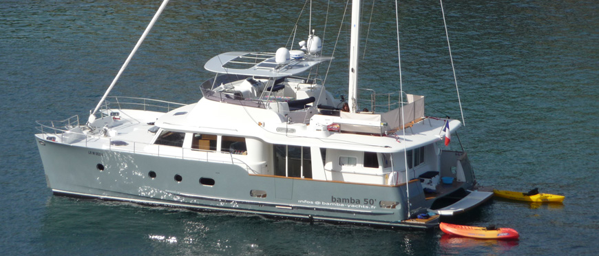

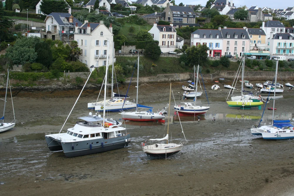

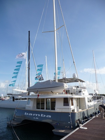

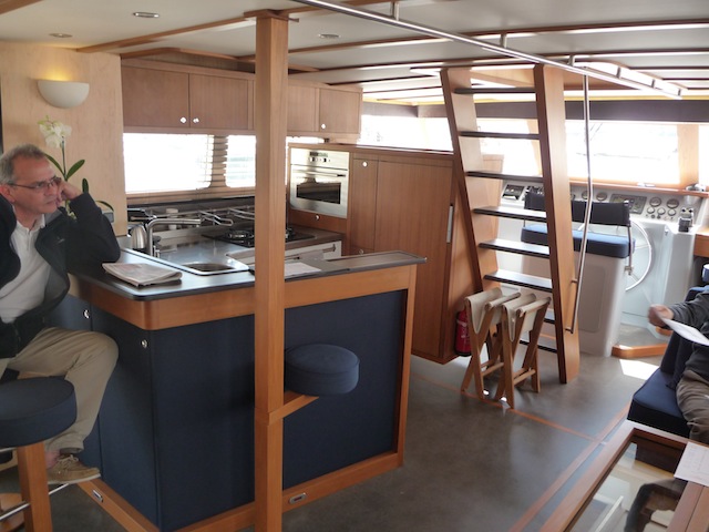

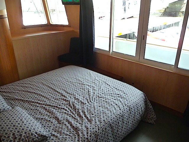

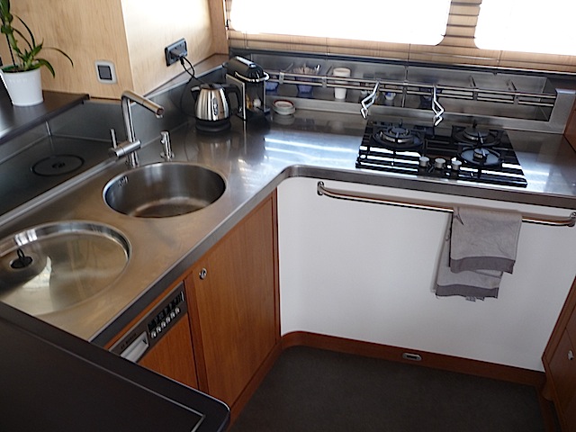

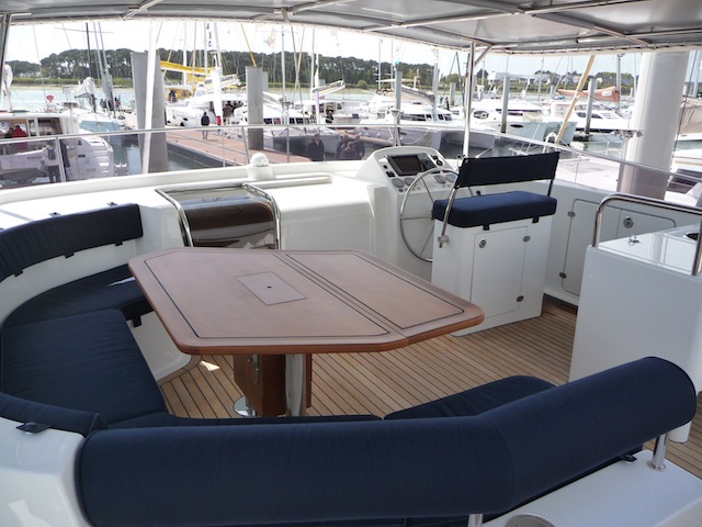

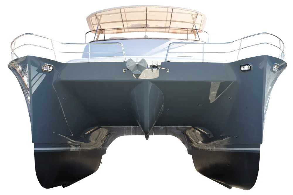

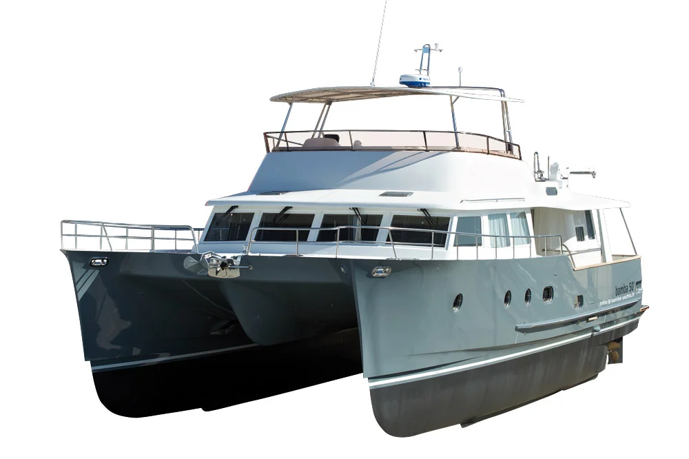

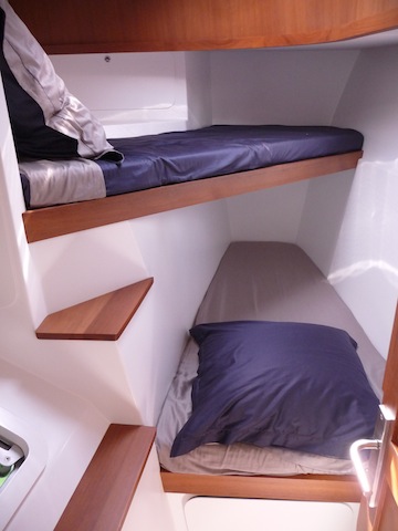

    Sail-Assisted Trawler/Power Cat, BAMBA 50'
    Here is another sail-assisted power cat that looks to be a real comfortable live-aboard, go anywhere motorsailer. and it happens to sport an optional sailing rig, an AftMast one at that.
    Lets see I think I've touted both of these ideas,....aft mast rigs, and motorsailing catamarans....;)
    BambaYachts - individually built and with external project management
    I think I even detect some sort of wave splitter up front?
