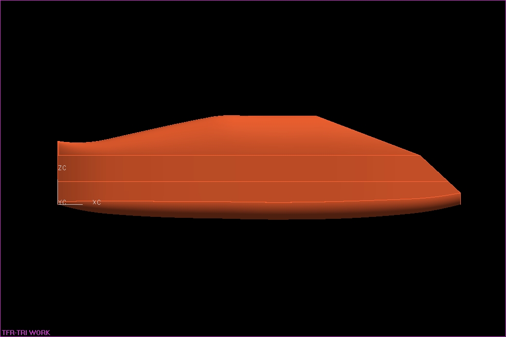

    I really don't know how heavy to make the keels and how to attach them to the hulls. The hull bottoms I propose are 3/8 80 kg sqm divinycell or similar with 600 gsm 45/45. I had thought to fillet around the keel and tape them to the hull, maybe 3 layers gradually down to one layer to spread the force. As for the keel no idea. Maybe 3 layers of the 600 gsm no foam ? I don't know if that would be rugged enough to too heavy ? Too light ?
    The problem as always is while I can calculate material strengths I don't understand the loads properly. The hull proper should not twist, that's the critical part. If you make it strong enough not to twist it won't break in bending in this small size. What I don't understand is the worst case scenario for the keels. Holding the weight of the hull while still is no problem, but that isn't strong enough to survive an impact, especially from the side.

    What does 3/8 mean ?
    Stub keels get good reinforcement from having frames and side to side ribs glassed in internally. It stops the big hole in the hull warping and twisting.

    From Ed Horstmans foam fiberglass construction . boat , 20' - 30' foam 3/8" , FRP thickness .110 , app. weight / ft / sq 1.00 to 1.25 . Boat , 31' -35 ' 1/2 " foam . As a note the tristar 31 calls for 5/8" foam . Using only only one layer 45/45 glass is most likely not enough glass , triaxal may be enough . Keel area is three times hull thickness o/s to 18" above keel , inside keel can be built up a number of ways with foam or glass only . Ed,s book is good , as well as the how to on bateau web site . To get any near thickness on glass i will have to use mulitple layers of 45/45 and 0/90 , I will still be under the weight of 24 oz woven and two layers 1.5 oz mat .

    I had planned to use 3/8" on vertical and curved surfaces and 1/2" on horizontal surfaces like cockpit floor and cabin roof, extra stiffness to walk on. The Farrier F82 (and other boats I know of in this size range) uses a single layer of 600 gsm each side but I guess there is a lot of curvature and shorter spans. ? Dunno. I thought it was adequate...it is only 23' long and 9'6" wide.
    rberrey FRP thickness .110 , app. weight / ft / sq 1.00 to 1.25. 0.110" ? 1 - 1.25 pounds a square foot ? Sorry to be a bother, I think everyone can see some of us are used to metric and others inches and pounds :) and the terms can be confusing... "the how to on bateau web site ", may I trouble you for a link to this ? I've not seen it.

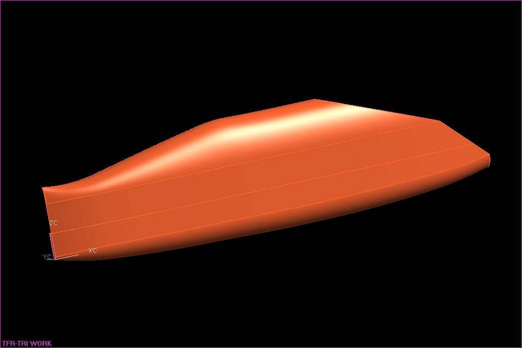

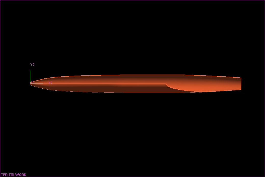

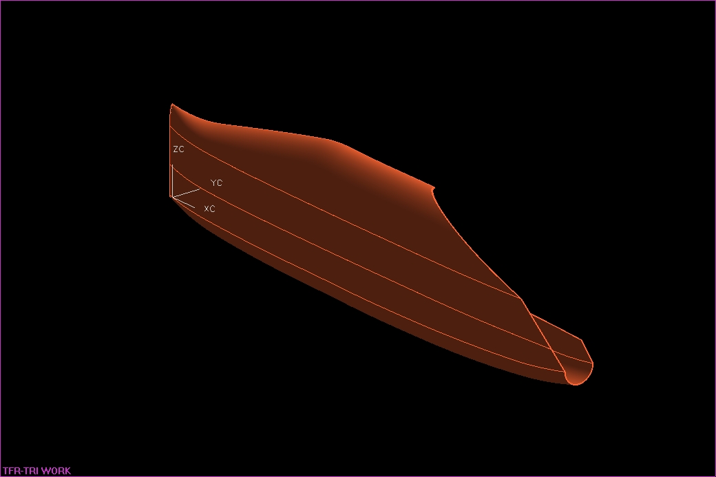

    I've smoothed the cabin and tweaked a few things but I'm not satisfied. You will see a dip between the bow frame and the next one, that is an artifact of the smoothing my package has done and I'll want to get it out later. Also I'm thinking I've gone a bit overboard on prismatic, I think that second frame needs to be a bit slimmer...anyway still very much a work in progress..By the way it's orange because it's easier to see the curves in that colour, in case anyone was wondering...

    Too heavy mate - a boat this size can be built in 1/4in ply no worries. It all comes down to unsupported span distances. You can build lighter weight structure by using lots of stringers and frames then a thin skin doesnt have to span far. Or you can span further and use thicker plating but it will end up heavier at the end of the day.
    For the really large spans that need to be stiff - such as the bridgdeck floor for example (nothing feels cheaper than a springy floor) you can investigate the use of ply sandwich panels. Personally - i think that 1in XPS foam with 1/4in ply skins would be upto the task. Ive made a table like this and it was stiff as hell and felt very tough - i doubt it would have had delamination issues as it was all bonded with thickened epoxy. If its good enough for truck trailers, caravans, structural insulated panels etc i reckon it should be good for small boats...
    Mini keels on bob oram cruising cats were made from 4 transverse frames of 1/2in ply. Then wrapped around these with 9mm ply to get the foil shape bringing the skins togeather at the trailing edge. The front of the foil could not bend that tight so curve was laid up in fiberglass then glassed over the whole lot joining to the ply skins. Alternately you could use bending ply for the leading edge radius and glass over it once you have the shape. Internal transverse ply frame to ply skin junctions all filleted and taped from above before bonding the entire minikeel to the bottom of hull, again filleted and taped to hull and using bonding angles where you cant access on the inside when you offer it up. Good enough for a 6 tonne cruising cat...
