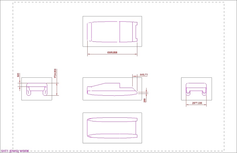

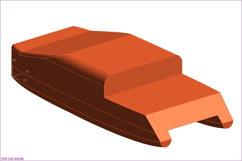

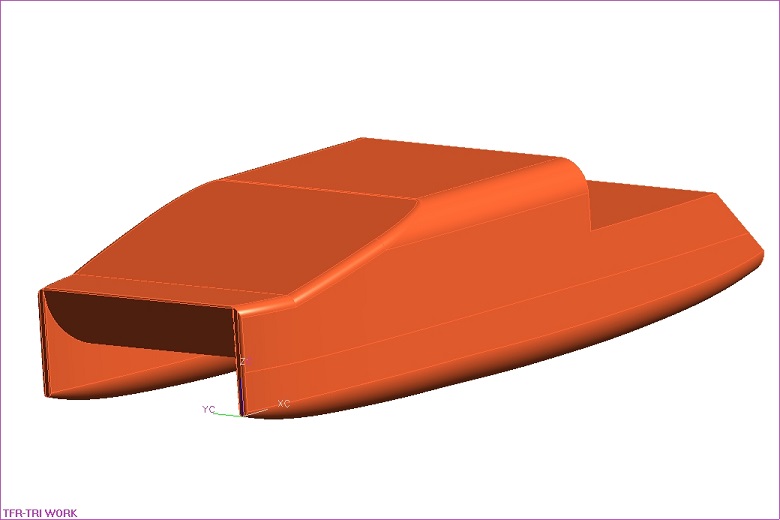

    I've been busy but finally got back to doing some modeling. Here are a couple of views of the hull plus a really rough drawing showing some dimensions. It actually looks pretty good so far.
    I've been doing some measurements and calculations to do with trailering and launching a cat with open deck and LAR keels. The local ramp only falls 1 in 10, so you'd have to push it out a LONG way to get it to float. Even with boards the trailer wheels are an issue. So I had another close look at the tristar 24, which is about 12' on the trailer and oversize. That's ok but I've emailed Mr Horstman twice this year and no reply. Maybe he doesn't want to talk to me or maybe he's not supporting his plans anymore, or maybe he's sick. I don't know, but I'm reluctant to spend $880 on plans which I'd modify anyway if he's not available.
    Conversely I've done a lot of clacs on this boat and everything just seems to fall in to line. So far....
    As previously mentioned 7 metres long, 2.9 wide, 1.75 headroom atm. Divinycell 3/8 on vertical surfaces 1/2 on horizontal with 600 gsm 45/45 both sides.
    Be aware I've got a lot more bits to chop out and finesse on the model, but I thought I'd post this for any comments ?

    Thank you for sharing your ideas with us. Is the design program able to give numbers about centers and displacement of the hulls? I fear the hulls are a bit too slender for the cabin and the accomodation??? within 7m length.

    The cad package I used for this is a mechanical one and isn't as convenient for boat modeling as it could be, however it does give me a very accurate volume to whatever waterline I nominate. Using RD water = 1 the displacement is about 1150 or so kg with the transom and bow just touching the water. I'm still working out what the boat will weigh, but I think 600 - 700kg is a reasonable range. For now I've got a 600 beam on 7 m length. I could increase that to 700 for 10:1 but it actually makes them more buoyant than I think is ideal. Maybe I'll settle on 650 or something. I want about 500 kg carrying capacity, I think that's reasonable for a coastal cruiser, so when I know roughly what it will weigh I'll tweak it for that. Also the prismatic is high. I'm not sure how high but probably about 60 or so, which should help with hobbyhorsing.
    I have not added the LAR keels yet which of course will change everything. My thinking atm is 2.5 tapering to about 1.8 and 450 high. Probably the thing I am least confident about right now is the layup of the lar keels. I want to make them strong and rugged but don't want to add unnecessary weight.
    I'm looking at something similar to a tornado rig. Either way it wants about 20 - 23 sqm of sail.
    Progress is slow. There are many many calculations and decisions to make and I have other things I need to get done in life, so I apologize for that.
    Next I want to get the cabin and accommodation closer. I'd like as nice a spaces inside as I can get within the envelope, but I'd like to make it acceptably pretty (not something I'm good at) and of course consider windage.
