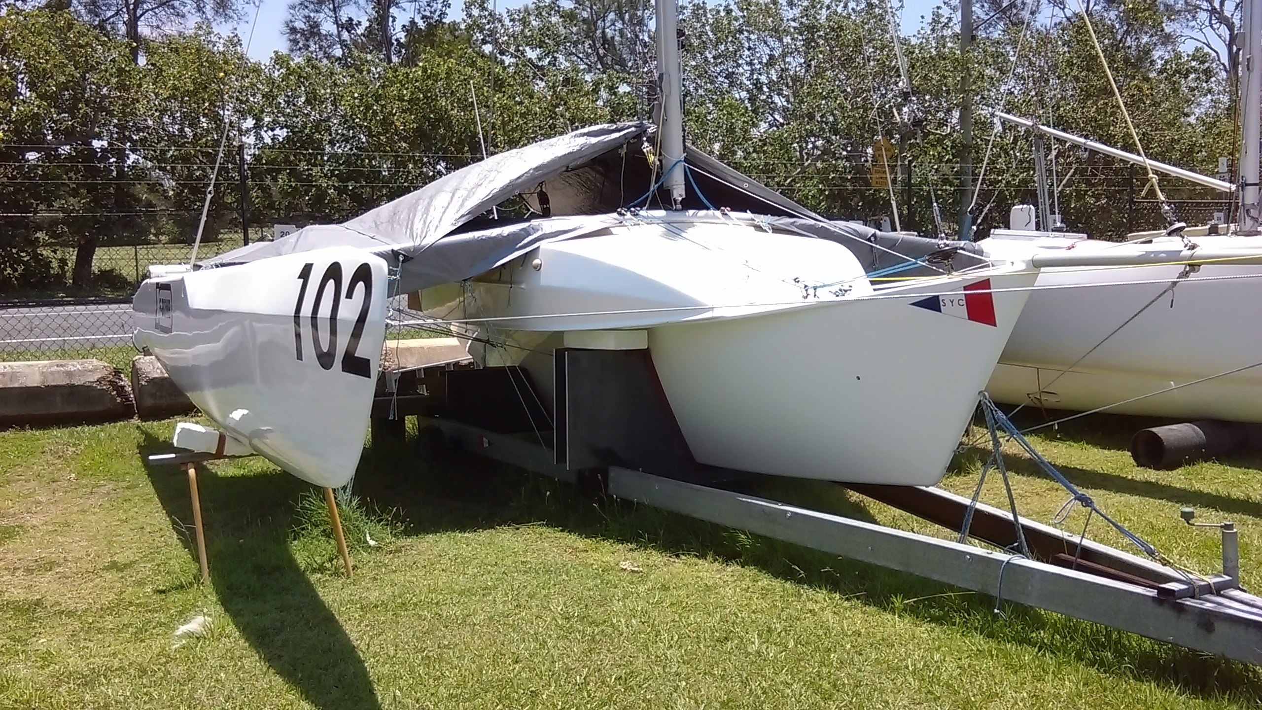

    There is another way to get headroom in a sango. Make the optional bolt on coach roofs for the hulls taller. I don't know how Mr Woods would feel about it, but elf has 1.8 headroom and the roofs could mimic the profile of the cuddy.

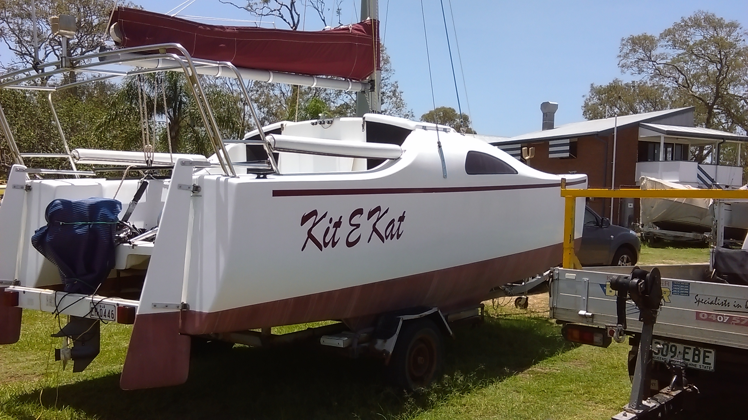

    As usual my opinion is worth what you paid for it, and here it is.
    I had a J5. In my opinion the side decks are dangerous and your far better off without them.
    The problem on mini bridgedeck cats like this is that the side decks are barely more than toe rails, or else they encroach on the cabin too much. They are too narrow for stanchions and in any sort of water the chances of you slipping and falling off are just huge.
    In my opinion (again) your better off without them so there is no temptation. Going over the top on a boat like that is not hard provided it's designed with that in mind, and you take advantage of the cats large beam and large flat cabin top to make a safe move forward.
    Again this is what they did with the little barrier and I think it was an improvement on the jarcat/red barron etc
    Attached should be a photo of a little barrier. The trimaran I include because I am pretty sure I used to own the center hull of that boat. It was a modified tremolino, it's interesting what they did with it...
