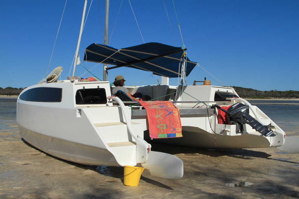

    Here are a couple of shots of the 7.3m at Wathumba in Fraser
    Interesting little story. We were motoring into Coongul creek 20 miles away from where these pictures were taken and saw a nice Easy. It had a good yacht designer on board and as we went by he didn't wave much or seem too interested in our boat. As it was the first cruise on the boat I was pretty excited to be out and slightly dampened in my enthusiasm by the reserved response.
    We met the designer and his wife when we were walking around at low tide. We talked a bit and said we were from Newcastle in NSW. He said
    "What boat do have?"
    "We have the little cat up the creek" I replied
    "Oh okay - and where did you come from?"
    "We came from Urangan"
    "When did you leave Newcastle?" I then had to think a bit as it was Tuesday.
    "We left on Sunday"
    "No, not when did you leave Urangan, when did you guys leave Newcastle?"
    There was a bit of a quizzical look at us. Could we remember the days of the week? Then it gelled on me.
    "Our boat folds up on the water. We drove her up to Urangan and it took just over one day - we launched her at Urangan on Tuesday"
    He was much more interested in the boat then and asked if he could have a look over her. I took that as a compliment as the boat obviously didn't cry out FOLDING CAT - BEWARE!
    cheers
    Phil

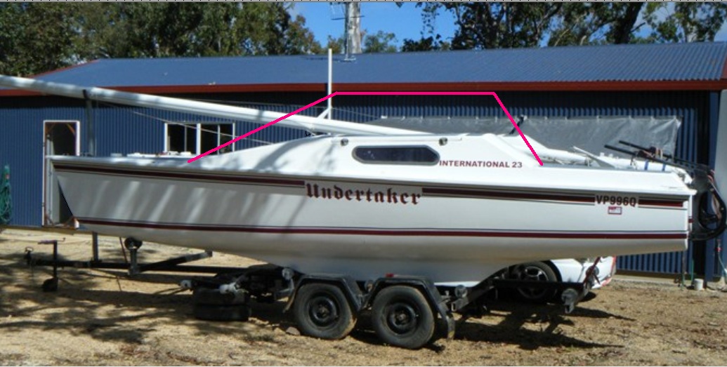

    I've had another crazy thought. A crowther international 23 has almost exactly the hulls I was thinking of. There are a few around in poor condition. If I could get one at the right price I could build a new connecting structure, cockpit and push the headroom up as far as I dare.

    You would think all these years of cad I'd be better at this. Anyway this is a really crude picture showing roughly what an international 23 would look like with 6' headroom amidships. It's clunky, but not as awful as one might at first suspect...
    Obviously I stole the photo from the internet. I hope the owner doesn't mind...
