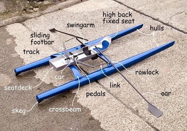

I thought of a rowing system where the seat stays stationary, but the rowlocks move. the rowlocks can be on a bar so that they all move at the same speed. If a pulley system is used the direction of the rowlock movement can be reversed. this will allow the rower to face fore ward. The oars will stay at 90 degrees to the hull throughout the stroke.
I can't think of a way to make this work. The oarlock has to be attached immovably (fore/aft) to the hull in order to serve as a fulcrum to transmit the oar's motive force to the boat.
Clmanges, have a look at the brilliant Ro-cat - instead of a sliding seat they have a fixed seat with sliding outriggers controlled by the rower's feet.
description of the ROCAT rowing catamaran http://www.rocat.org.uk/boat/description.htm
You can download a video of the Ro-cat underway here -
ROCAT - downloads gallery http://www.rocat.org.uk/galleries/downloads.htm
Thank you very much for this. It is wonderful to see that my thinking can be a reality, I wonder when they thought of that. Dudley Dix said it was done long ago. I took it one step further. Maybe I should share that with them.
It had been done.
