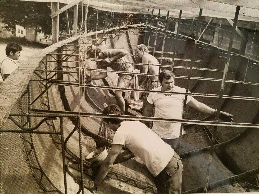

    Mustafa Umut Sarac in the first post indicates $100 for a concrete truck. That may be the price where he is, for typical poured concrete with a large fraction of stone mixed in. A ferrocement hull should be made with a very rich mixture of mortar, with no aggregate stones, and double the amount of portland cement. Mixing up a concrete truck with that stuff would be far more expensive.
    Then there is the thickness he mentions, far far below what is reasonable for a concrete hull. I did my college engineering thesis on ferrocement marine construction, with test panels constructed of 3/4 inch (19 mm) and 1-1/2 inch (38mm) thick test pieces. Test slabs were steam cured, and tested to destruction. The best panels used galvanized expanded metal lath, at about 5% steel cross section in the matrix. Chicken wire and hardware cloth tended to catastrophic failure in the testing machine. A few years later (1973) we made a 30 ft ferrocement sailboat, with large bilge keels to allow beaching, and it is my understanding that this boat is still in use (2018). A crew of 20 young men worked from sun-up to sun-down to plaster the hull, and the steel and wire mesh work took months of preparation for plastering day. The 3/4 thick panels were considered appropriate for a 30 - 40 foot boat, more or less.
    Making reasonable panels, 10mm thick, with the concrete truck (holding several yards of mortar, ready to start hardening) standing by to make the pour, would have the requirement of about 50 skilled workers ready to try to make the panels with success. Mustafa Umut Sarac obviously has little practical experience in this matter, and should make a panel about 10 inches x 50 inches x 3/8 inches (250mm x 1250mm x 10mm) just to get a small perspective about his ideas.
