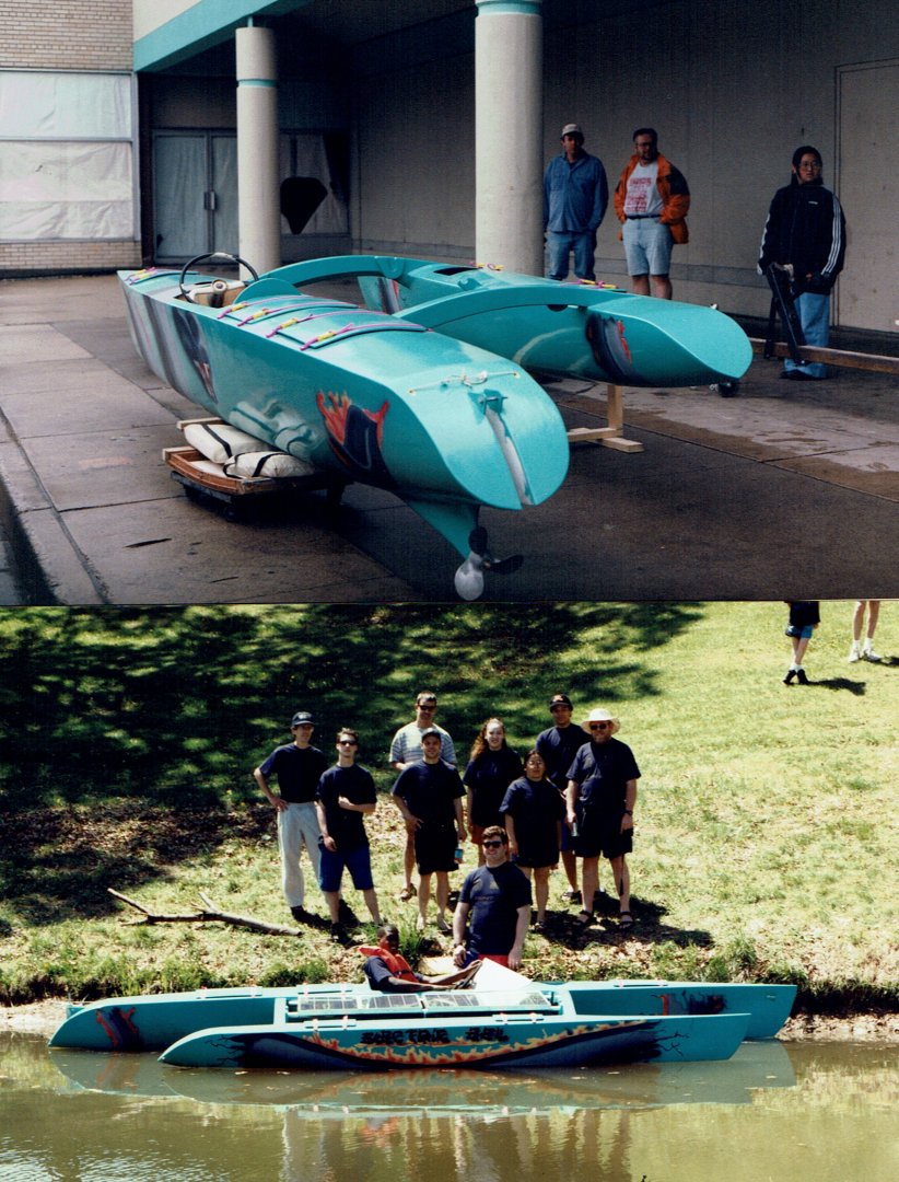

    New to forums and little late to the game, but this is a great thread. Attached pics are from a 1996-97 design/build with a group of high school students for a solar/electric boat competition in the Midwest. We called it a proa at the time, but let's go with 'outrigger' ;)
    FWIW: 4mm tortured ply vaka @ 20' LOA. Ama was 3mm tortured ply, scaled down from vaka 2/3 in all dimensions yielded 30% vaka displacement . IIRC, vaka design displacement was ~ 550 lbs. Ama ~165 Lbs. We had one 65 lb Group 27 battery as 'ballast' in ama - other battery was in vaka. 8'-4" beam for trailering = ~2.4 L/B ratio. Kick-up rudder with wheel steering, drum, cables, and quadrant. Surplus ThermoKing series-wound DC motor and Minarik 60 Amp DC controller run as 24 VDC system. Max 1.9 HP at motor for short duration. No reverse, which sucked (we were on a tight budget). Handily won the MN state competition that year for top speed and endurance. I eventually sewed a Cordura tramp with aluminum tubes, which replaced the PV panels, and allowed for a passenger.
    After taking it on Lake Pepin in 2' chop, I recollect being a bit nervous. Not sure why, because in a s sea kayak I would have been fine. Expectedly, quartering waves were much more comfortable. Fine enetrey + no spray rails made it wet. The plexi 'windshield' helped. Having ability to adjust ballast ama would have helped. There was ample reserve displacement. I'd think having to screw around with altering that would be a abit of a PITA? I dunno - maybe not so much if your heading was consistent for a while. I recall the asymmetrical roll due to ama lifting and dropping.

    Had you built a tortured ply hull before? Sure looks like you know what you're doing. Very nice looking boat!

    Russel Brown - First tortured ply boat. First design/build ever actually, but had experience with wood/epoxy construction for sculpture and worked alongside a a really good boatbuilder/teacher - Brad Buxton. HAd made a couple aircraft ply models based on Gougeon book. Gota lot of good tips off a Kurt Hughes Cylinder Mold video that made controlling the process easier. Main hull was still scary, 'cuz we were pushing for a pretty full bow and stern to gain a high CP. Definitely designed for the task at hand. I'd think it would need a flatter run and less rocker for more HP and speed.
    More apropo to OP, perhaps: With one battery in the float, one in main hull, and a pilot, the boat sat right on its lines. If the the outrigger/ama has sufficient displacement to carry water ballast, how simple do you think it is to add and remove ballast? Our float had plenty of reserve. It was probably good for 125% of total loaded displacement at deck level. I'd think the ability to easily adjust ballast ratio on a power outrigger based on wave height would be essential. But maybe not? The hulls could side-slip along the surface because you don't need boards?
    BrendanfromNZ - I like the last layout, and get the concern with beam placement re. intrusion on main hull. If the outrigger gets longer, could the front beam run under the aft end of the Master berth? Gives you a full-width bulkhead to tie into.
