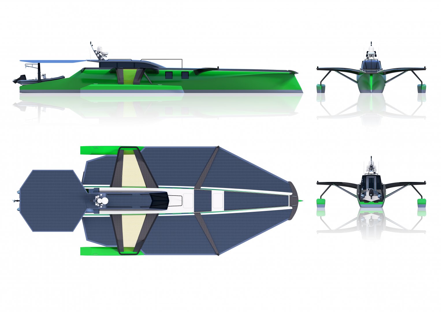

    Hi all.
    I find myself in quarantine in a foreign country, 14 days with nothing to do but draw boats and drink beer.
    So I have revisited a concept thats been bouncing around my brain for a few years
    I've been around the design spiral a fair few times with this, but keep coming back to a power tri, or proa. Factors that influence this decision include;
    Rough water capability (NZ to pacific islands)
    Economy of operation (1L/nm max)
    Economy of build
    Single diesel on shaft
    Stability at rest
    Fast cruise speed (10knots) to reduce passage time
    Basic accoms for 1 - 3 + persons
    1000 nm range +
    Fast build time
    Trailerable components (nice to have)
    12m length to gain cat 1 for passage
    Plan is to take the boat north to the pacific islands for 4 months, with a couple of mates every winter. Fishing, kite surfing, surfing and spearfishing (in that order). Month of just the boys, then a month each with family flying up.
    Must be aluminum, as thats my trade. Good around sharp coral and very fast to work in. No paint, simple outfit, sensible electronics,
    Dimensions I've worked to are;
    Length w.l. 12m
    Beam w.l. 1.2m (10:1)
    Beam o/a 5m
    Draught 0.4m approx
    immersed transom (Tennant style)
    Design weight around 3500 - 4000kg
    40 - 50 hp shaft single diesel
    Ama 5m x 0.3m beam ( adjustable ballast)
    I'll post up a pic, before this post gets too long, then come back with some questions for you all.
    Cheers
    Brendan

    Your drawing isn't definitive, but why do you want am immersed transom ? I didn't think Tennant had such a thing ?

    Tennant had a cool transom design that worked to reduce squat. I remember building a couple of his hulls years ago. Top half was a full immersed hard edged transom. Below that was canoe body tapering away to where the horizontal shaft exited. Wish I could remember the term for it.
    I didn't get to drawing up the underwater side, but had a good starting point;
    Beam 1.2m
    Draught 0.4m
    Area coef 0.85
    Pris coef 0.65
  4. BrendanfromNZ
    Joined: Apr 2020
    Posts: 49
    Likes: 5, Points: 8
    Location: New Zealand
    BrendanfromNZ Junior Member
    My biggest concern is the single drive unit in the main hull. Will this pull to one side? or can the drive line be slightly offset or angled to compensate.

    Proa has very unpleasant roll motions... I can probably understand sailing proa (sail is damping the rmotions), but power proa??

    As a matter of similar idea, but a stabilized mono... Not a proa.
  8. BrendanfromNZ
    Joined: Apr 2020
    Posts: 49
    Likes: 5, Points: 8
    Thanks Alik,
    that power tri looks epic!
    My design started as a tri, but I felt by going to a single Ama, increases the stability, by increasing the Ama to roll centre distance.
    I.E.
    Proa 5m roll center to Ama
    Tri 3m roll center to Ama
    Therefore could reduce the Ama volume compared to the volume of two Amas

    I think you're nuts, a stabilized monohull would be infinitely better.
    But to answer your question: offset propeller shaft aligned with an offset diesel.
    You'll need to tow test the finished hulls or calculate where the centre of effort will be for it to track straight without rudder correction.
    The offset will aid in roll stabilizing this beast.
    That's a lot of aluminum cost for a prototype.
    But it sounds like you're all set to go.
