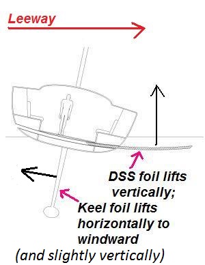

    The new Beneteau is not designed to be a "foiler". It's odd foils only develop lateral resistance-not vertical lift. I think that this is their way to attempt to cash in on the foiler craze without actually having a boat that foils-and to avoid paying a royalty to Dynamic Stability Systems.
    From Yachting World:
    "These novel looking foils are designed to replace the traditional weighty ballast tanks used on past Figaro models. Described as ‘asymmetric tip foils’ they work by creating side force to supplement the skinny keel and reduce leeway while causing minimal drag. An important factor is also that they are able to retract within the boat’s maximum beam."
    "The foils are not designed to lift the boat out of the water"
    I think the change in Mini rules is a brilliant update to keep the "Proto" state of the art-it will produce some extraordinary boats.
    I think Hugh Welbourn's first DSS Mini could be interesting but I'm afraid its time is past with the rule change and his new boat, done to the modified rules, is likely to make a much greater impression with the Q23 "Flying DSS" foils :

    Doug L. you need to read up on "Design Failure Mode Effects Analysis" and consider the full effect of the foil angles. Having the foil reach over the top, above the water line makes total loss a fail-safe condition. On a healing boat DSS has a negative contribution in the vertical plane -which results in drag.

    "Foil Assist" generally means a foil designed to lift some percentage of the boats weight. The Beny doesn't do this-or very little.
    Most DSS boats are designed to heel to one degree or another. The biggest exception I've seen is CQS designed with a straight foil parallel to the water when the boat is level. However, their foils also have flaps-which is another first for DSS.

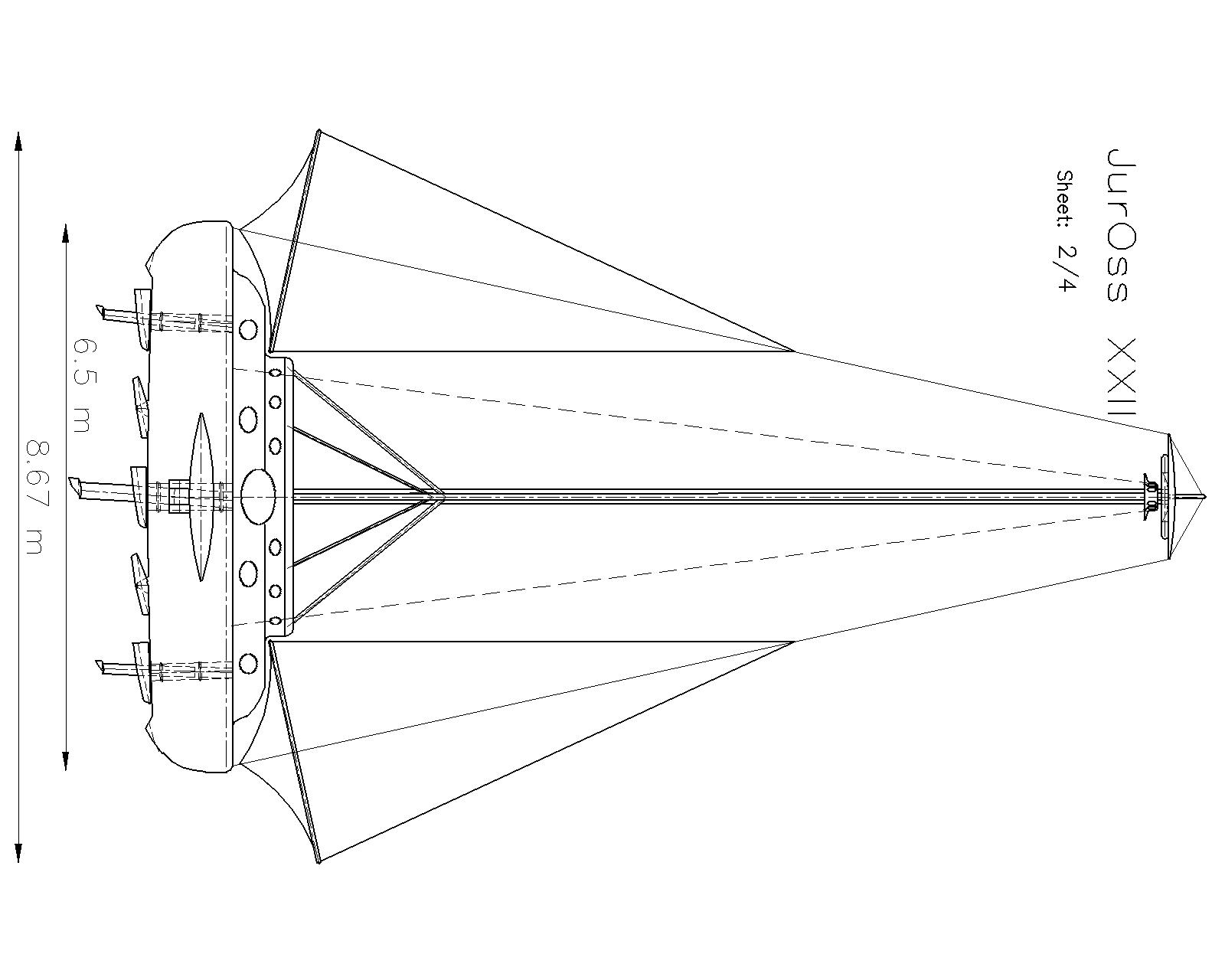

  8. Konstanty
    Joined: Mar 2016
    Posts: 95
    Likes: 4, Points: 8, Legacy Rep: 10
    Location: Bydgoszcz Poland
    Konstanty Junior Member
    How does it fit in the rules of mini 650 transat ?
    How does fit this monohul proa in the rules of mini 650 transat class? That is the question. :?:
  9. Konstanty
    Joined: Mar 2016
    Posts: 95
    mini650proto.jpg One more

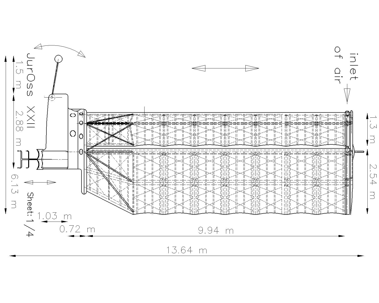

    1.) that if they want to go to this much beam, they are going to have to include multi hulls, especially if they allow lift foils at the end of cross beams. A DSS system with the same width is likely to impart far less RM for the same drag as lift foils on the end of cross beams. For this reason, it may be easy to argue that a well designed float may be just as effective. And a whole lot cheaper
    2.) A boat with lift foils at the end of cross beams and a narrow scow-like hull may prove superior. The hull can be designed to plane. Such a design could eliminate a vast web of complexity, and need far less control lmput to keep it going.
    3.) As far as I know, Benteau is still in business. Perhaps building just a few of these innovative designs keeps them in the public eye, even though the vast majority of their customers will never buy such boats.
  11. Konstanty
    Joined: Mar 2016
    Posts: 95
    mini650proto v.2.jpg One more version
