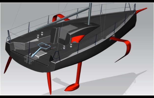

  14. Skyak
    Joined: Jul 2012
    Posts: 1,461
    Likes: 147, Points: 63, Legacy Rep: 152
    Location: United States
    Skyak Senior Member
    This rule conversation is interesting -I didn't think there was any change in what's legal. Then I just saw this story
    http://www.yachtingworld.com/yachts-and-gear/102174-102174
    This looks to me to be exactly the technology flow to production you look for from a development class.
    I will post more later but for now I just want to scoop Doug L. on a major foiler program.
  15. myszek
    Joined: Jan 2013
    Posts: 109
    Likes: 50, Points: 28, Legacy Rep: 22
    Location: Lodz, Poland
    myszek Senior Member
    With 6.5m total beam, a heeling/righting moment is not an issue at all. You can balance all the hedrodynamic and aerodynamic forces and moments, if only the rig is not too tall. You don't need a wide hull, nor a swinging keel.
    You also needn't restrict yourself to foil-assisted boats, the hull flying is quite possible. The 11m high mast and 100m^2 of canvas is not reasonable, but the aerodynamic drag reduction will be meaningful.
    The light weight is crucial for the hull-flying foilers. Narrow hull allows to save some weight, but the ballast should not be too heave as well. The large angle stability restriction links the mast height with the ballast mass, so again, the mast shouldn't be too high.
    As a result, instead of a 3m wide hull built of hi-tech materials, 400kg swinging keel and 11m carbon mast, you have, say, 1.5m wide hull, 200kg fixed keel and 8m carbon mast. Plus foils, of course.
    What will be more expensive and complicated? I am not sure...
    Doug, have you more information about the Arkema's wingsail? This is the most interesting point of the design.
