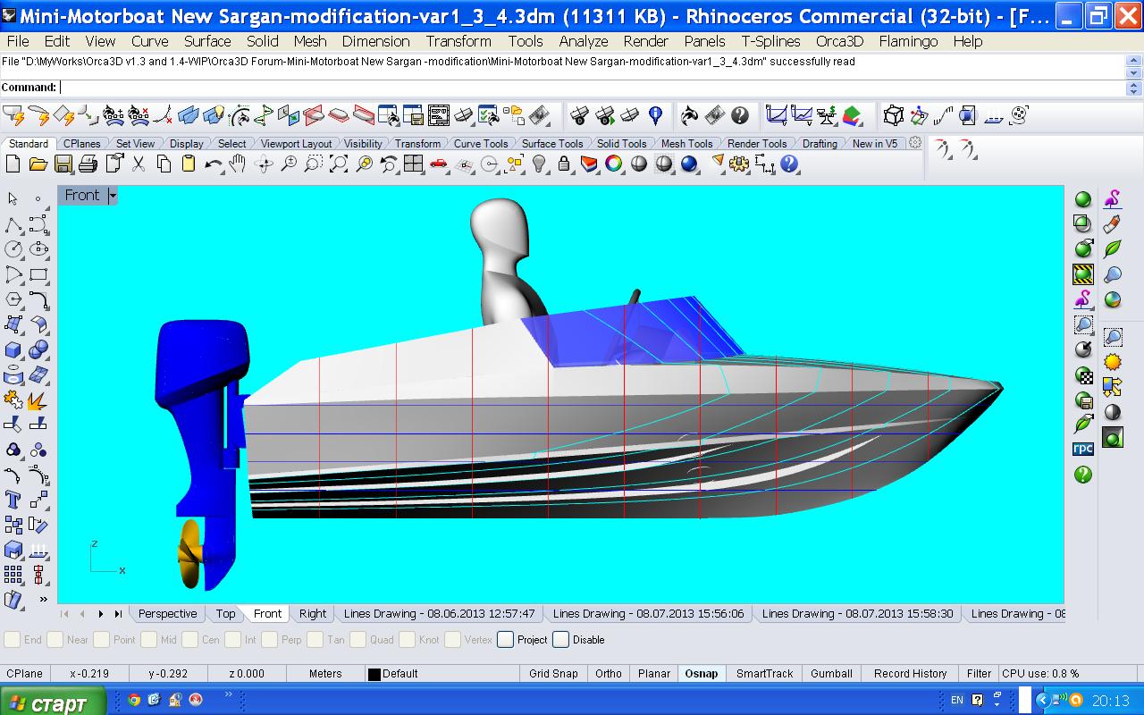

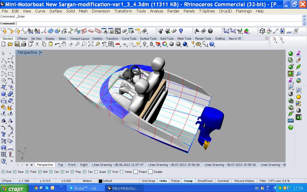

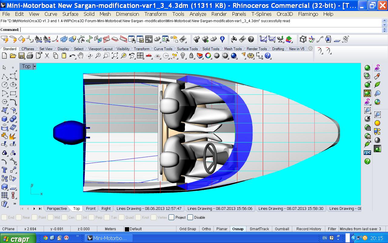

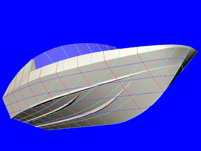

    Hi friends of Boat Design.net,
    I want to show you modification which I has made as much as possible coming nearer to data of offset table of the original version of motorboat "Sargan" published by D.A.Kurbatov in his book "15 designs of vessels for amateur construction ”, 1985.
    For deriving the faired hull contours it was necessary to make small changes in some ordinates. In outcome the Breadth overall was received not much less / on 27mm/.
    I have shown characteristics of the original boat.
    The model which you now see has the following characteristics:
    At total displacement D=250,71kg in a salt water on an even keel, displacement condition floating, the draft is T=0,216m.
    In this condition / in departure- water-line of rest / data are the following:
    Loa=2,7m; Boa=1,273m; Amidships depth/Х=1,35m from AP/-H middle=0,543m
    Lwl=2,438m; Bwl=1,067m; Breadth on a bilge at transom- B chine=1,04m
    Cb=0,435; Cwp=0,817; Cx=0,701
    LCB=0,861m from AP; VCB=0,144m from BL
    Deadrise of the bottom at transom = 17 deg as on the original.

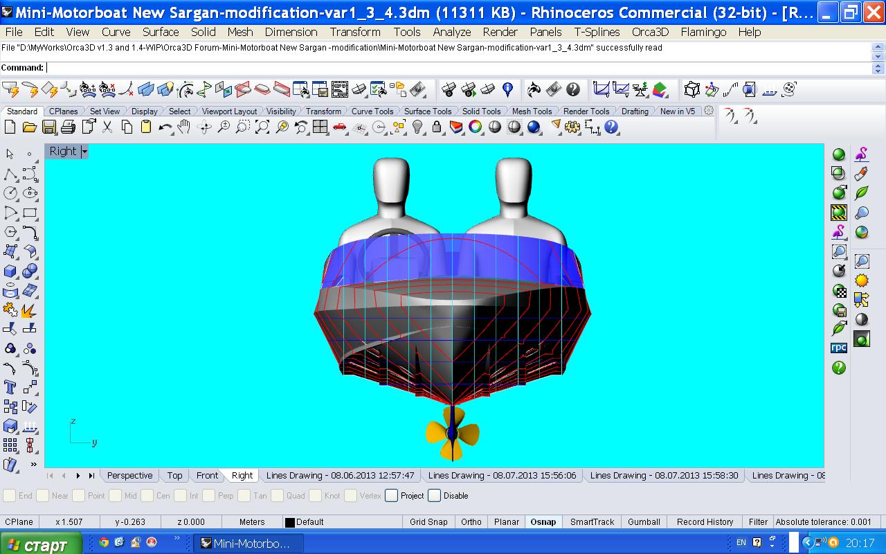

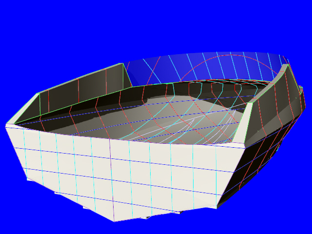

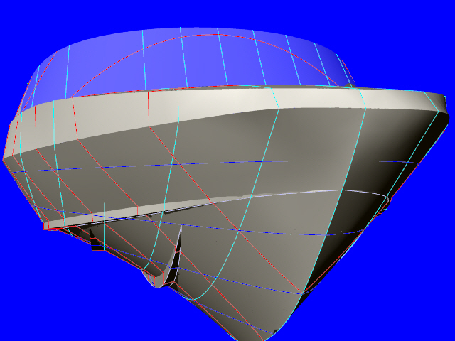

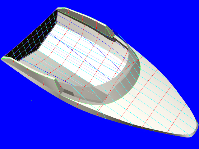

    On figures 1-4 and 13 you will see different images of the model.

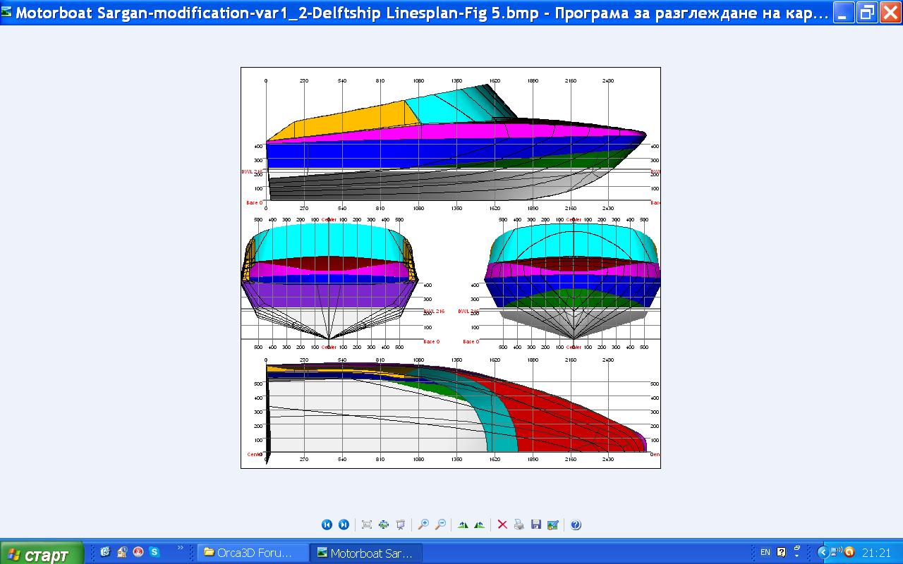

    On figs 5 you will see the Linesplan of the boat without the bilge spray wedge and without planing steps it is carried out on program Delftship Professional.
    On figs 6 you will see the Linesplan of the finished model of the hull it is carried out on program Orca3D.
    The Offset table you will see on figs 7.

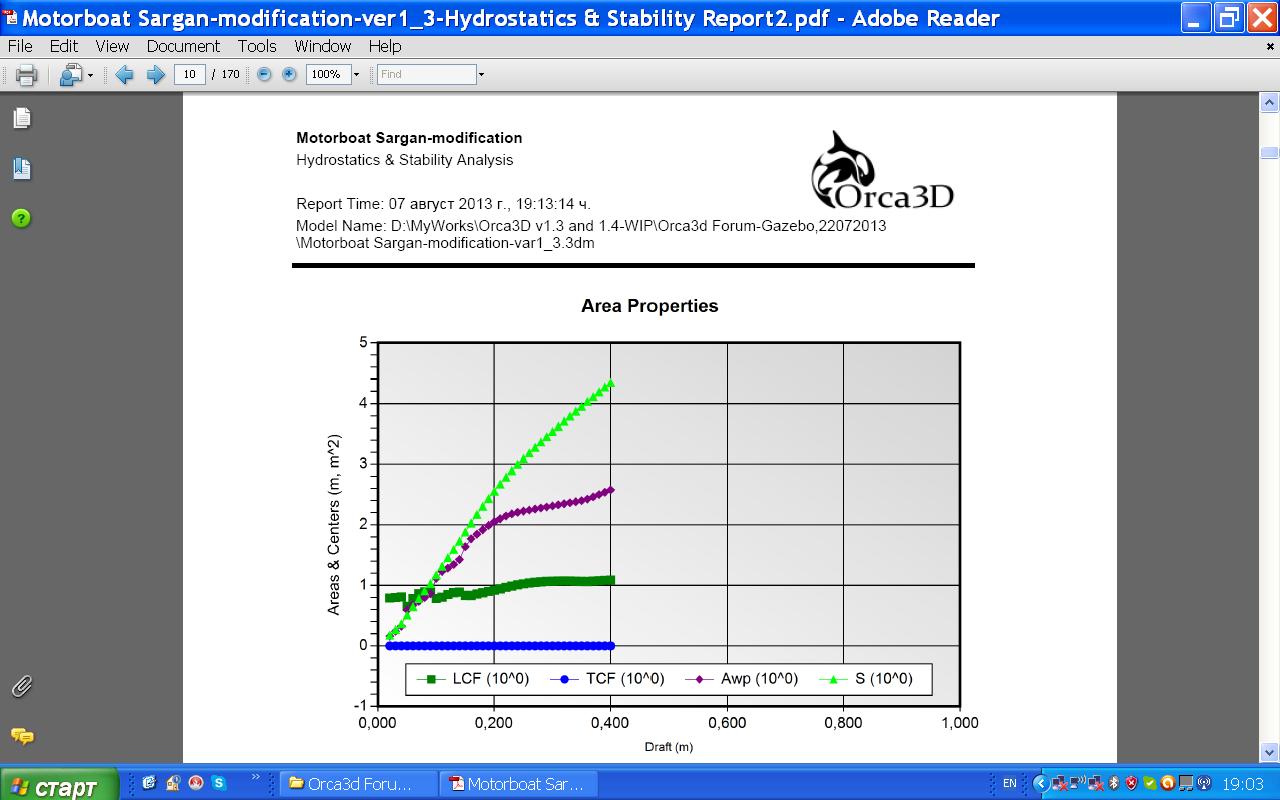

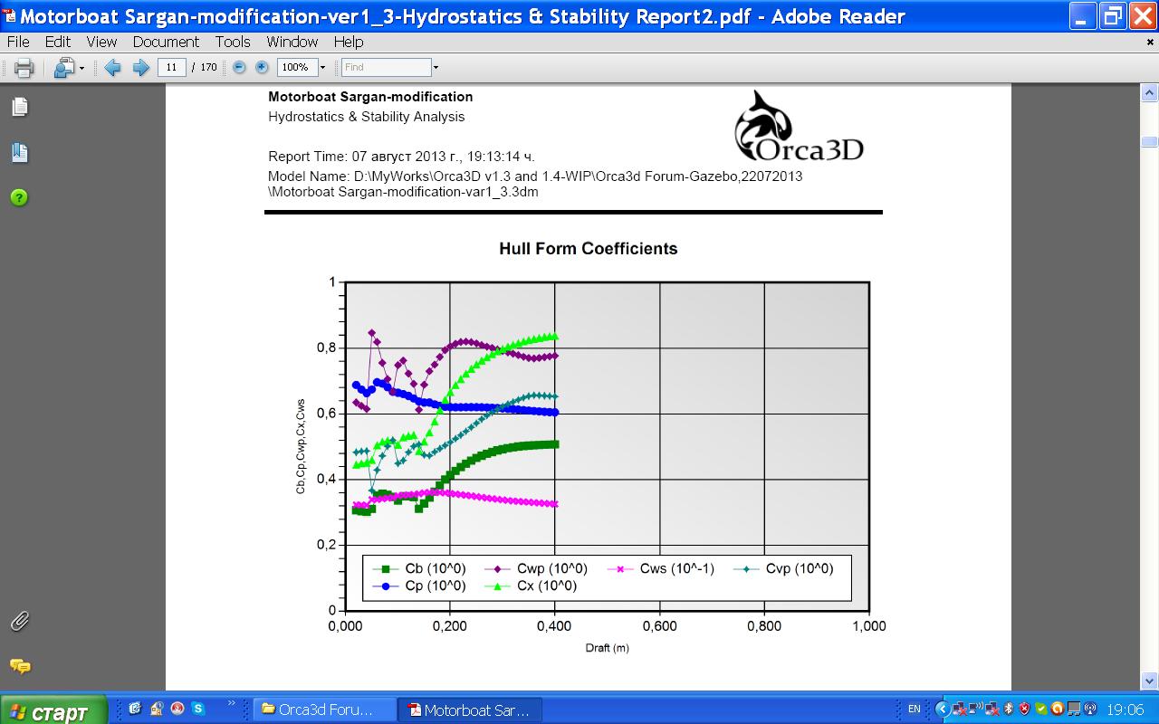

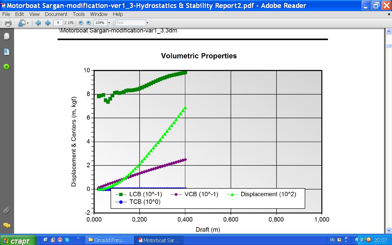

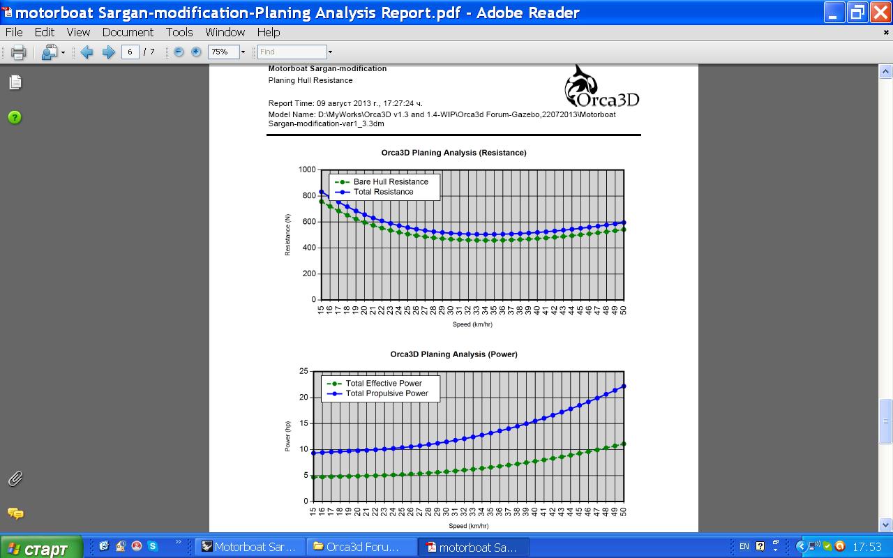

    On figures 8,9 and 10 you will see hydrostatic curves of the motorboat at a zero trim for different sizes of the draft up to 0,4m from BL.
    On figs 11 are shown forecast sizes of the resistance, speed and power at the following input data:
    LCG=LCB=0,861m from AP; VCG=0,35m from BL
    The axis of the propeller of the suspended motor is accepted on Z = - 0,175m from BL;
    Point of application of the thrust on the axis X = - 0,25m from AP;
    Shaft Angle to BL =0 deg;
    The minimal rate of speed15 km/h;
    Maximum rate of speed 50 km/h;
    Design speed 27 km/h;
    Reserve at account of resistance =10 %
    Propulsive Efficiency=50 %
    Outcomes of account of speed/power:
    At 27 km/h- N total=10,8hp; Running trim=6,948 deg; Volumetric Froude Frv=3,029
    At 50 km/h- N total=22,2hp; Running trim=2,927 deg; Volumetric Froude Frv=5,609
    And at two speeds forecast Orca3D gives ОК.

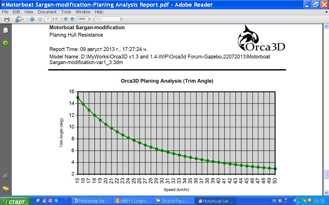

    On figs 12 it is shown the schedule of the running trim angle of the motorboat.
    On figs 11 it is visible that the smallest resistance R bare=458,8 N is received at speed 34 km/h and
    N total=12,8 hp; Trim = 5,04 deg; Volumetric Froude Frv=3,814
    If the Volumetric Froude number is => 3, it means that the motorboat enters in a condition of planing.
    Accounts on speed and power show more acceptable longitudinal stability at speed 45-50 km/h.

  4. Alexanov
    Joined: Feb 2003
    Posts: 222
    Likes: 29, Points: 38, Legacy Rep: 10
    Location: Norway Sola
    Alexanov Senior Member

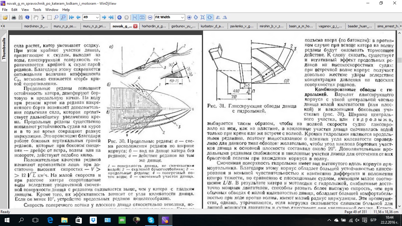

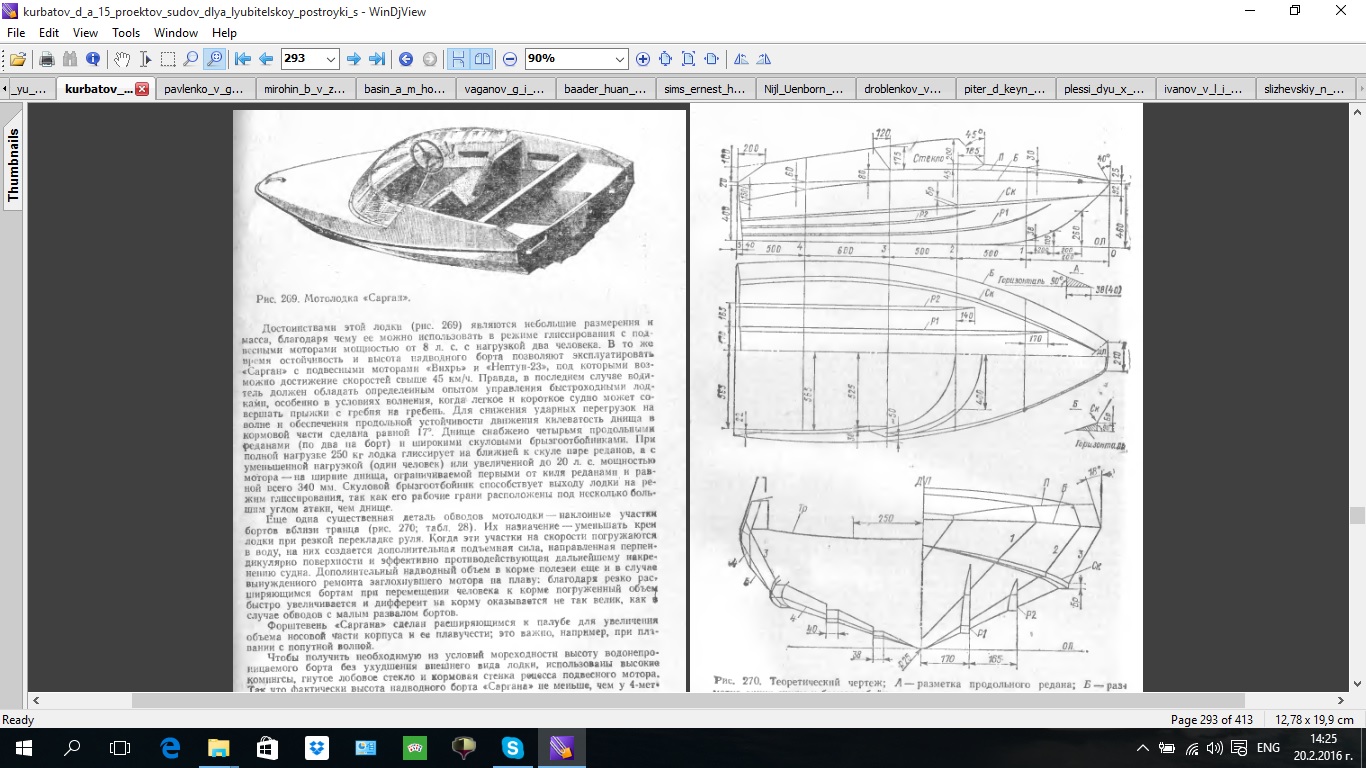

    Hi, look's nice, but I am not sure about position of the longitudional redans at hull bottom. They will works better if you place them along watrlines.
  5. Rabah
    Joined: Mar 2014
    Posts: 247
    Location: Bulgaria
    Rabah Senior Member
    Hi Alex,
    I enclose the file of the body line of the original boat.
    Arrangement of the planing steps /redans/ is linked with the breadth of the planing plate of the bottom.
    At a total load 250 kg the boat glides between the planing steps which are on the short-range to the bilge.
    There is also a case when the boat glides at breadth of the gliding plate 340mm limited to the first planing steps from keel - at a diminished loads /one person / or enlarged up to 20 hp capacity of a motor.
    I have not changed arrangement of the planing steps as the boat after the construction has been tested and has shown good seagoing capacities. It agrees with the author at 23 hp the speed of the boat will be from above 45 km/h.
    __________________________
    NA Razmik Baharyan

    Hi Alex,

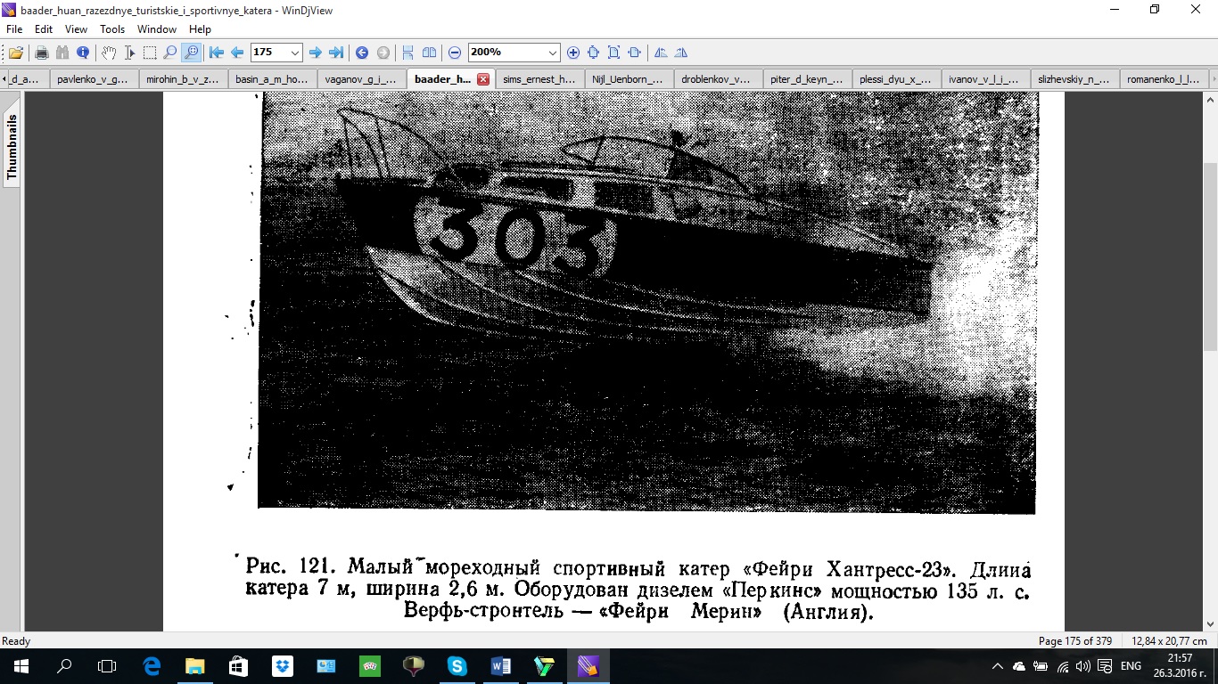

    Basically your note is exact. I have seen „ Guide on motorboats, boats and engines “-1982, under edition of Novak G.M. There the arrangement of planing steps is specified as you write - see the file. But all the same I think that the most exact solution for their arrangement depends on test in actual operational condition or by means of model tests. Certainly the cheapest version is to trust in the original.
    _____________________________
    NA Razmik Baharyan
  7. Alexanov
    Joined: Feb 2003
    Posts: 222
    Generally they should be located to cross stream lines with maximum angle. And it should be perform after model test.

    Hi All,
    You look at the photo the proof for arrangement of the longitudinal planing steps/redans/ of the planing motorboat in planes parallel CL. The motorboat is built in UK.
    NA Razmik Baharyan
